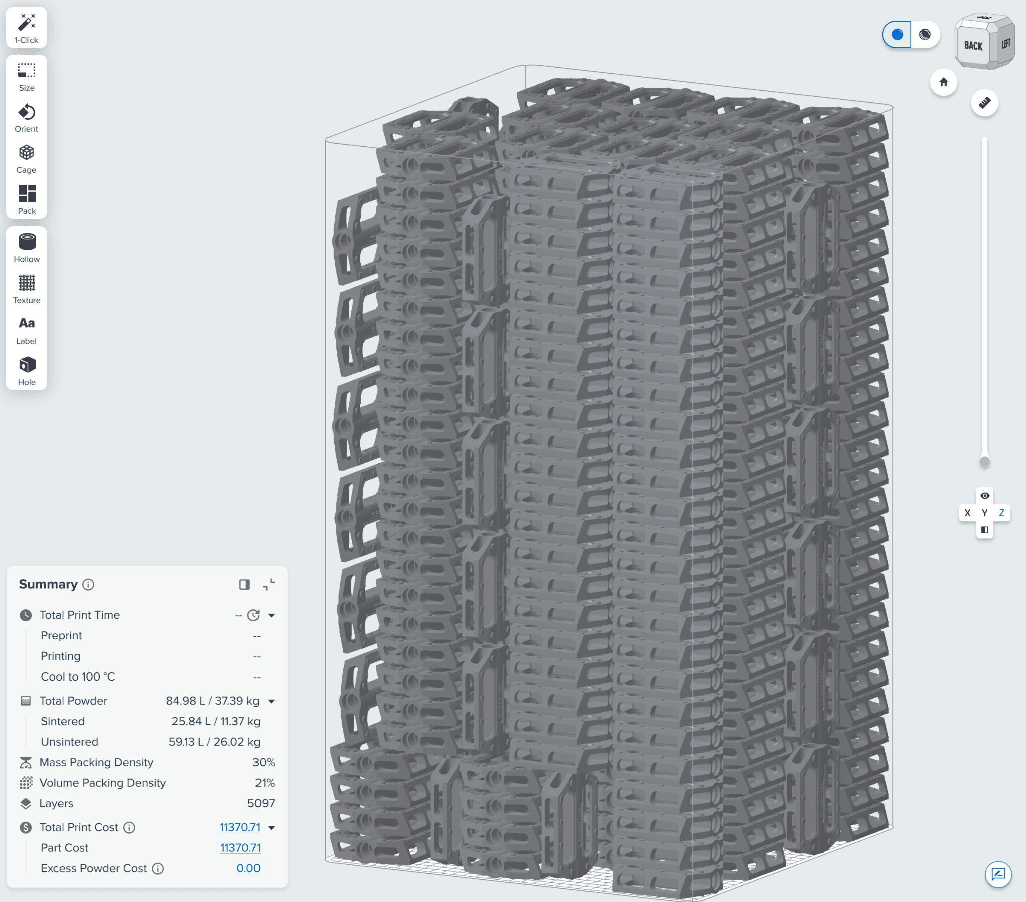

Powder Usage and Packing Density Calculations in PreForm
PreForm calculates a number of useful statistics related to powder consumption and build volume utilization, displaying these values in the Summary flyout. Here, we clarify what these values represent and how they are calculated.

Packing Density
Volumetric
The pre-shrinkage volume of sintered models divided by the build volume
(This excludes powder outside of the build volume to match competitor calculations)
VPD = Vs,pre / Vu,BV
Packing Density
Mass
The mass of sintered models divided by the total mass required for the print
(This includes all powder for the print, so that mass estimates stay accurate)
MPD = ms / mT

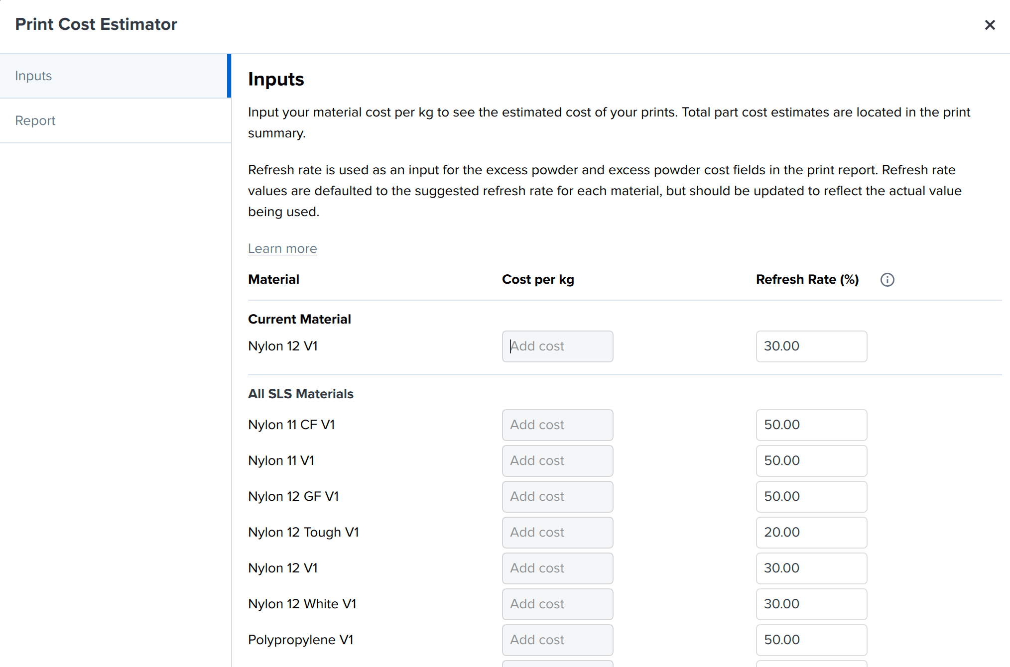

Cost per part is a mass calculation as powder is priced and consumed by the kilogram, not the cubic centimeter. In PreForm, users can enter their refresh rate and powder cost, as powder discounts are available for bulk orders. Once this information has been input and models added to a build, a cost per part will be calculated based on how much powder a part will require.
Print Cost Estimator
The Print Cost Estimator in PreForm uses cost per kilogram of powder, refresh rate, and the mass of powder required for a part to determine the cost per part. The refresh rates in the Print Cost Estimator are the recommended refresh rates for Formlabs materials.
