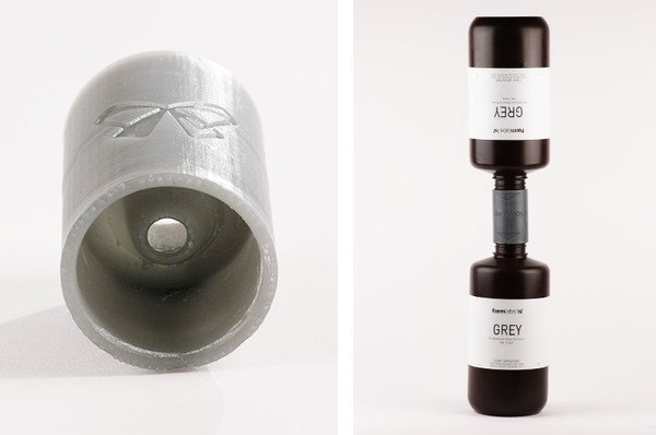

After thinking about how restaurants deal with nearly-empty containers, our designer Will modified the design of a ketchup-bottle joiner and printed the model on our Form 1s. The Form Funnel helps safely transfer that last bit of resin into a new bottle, so you can get more out of each bottle of resin. Here's how to make your own:
Print the Form Funnel and clean it up like you would with any other Form 1 model.
Wait until you have a bottle that no longer easily pours, but still contains a bit of resin.
Place the Form Funnel on a fresh bottle of resin with the arrows pointing down.
Quickly turn the nearly empty bottle over and nest it in the Form Funnel.
After approximately 20 minutes, your remaining resin will have drained into the fresh bottle, and you’re ready to go!
