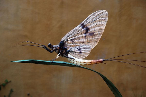

We were blown away when we first saw the incredibly life-like insects by Austrian artist and model-maker Klaus Leitl posted on our forums. His insect models—printed on the Form 1+ SLA 3D Printer—are scaled some 30 times, with some measuring up to 53 inches (135cm) long, and comprised of up to 22 printed parts.
In the following interview, he shares his techniques on achieving his beautiful, showcase-quality prints on the Form 1+.
Mayfly; Ephemera danica; Length 135 cm including antennas; without antennas 40 cm; printed in 9 parts; antennas, wings, and grass made of different materials.

My post-processing techniques are very simple: I use 2k epoxy glue to glue the individual parts together as needed. I think that the 2k epoxy glue holds better than laser (or light) cured resin. I sand very little and only where necessary, for instance, around the support structures. My models don't require a lot of sanding because I remove liquid resin residues from the models in the IPA bath using a soft brush which also makes the surface a lot smoother.
The color which I apply with an airbrush (Schmincke, artists' colors) does the rest, and of course a suitable finish coat which is extremely important depending on the model. For this, I use a regular water-soluble acrylic coating (matte, satin or gloss), the same as 2K automotive paint (high-gloss or matte) or enamel varnishes. The very last step is adding hair and the final assembly of the model.
