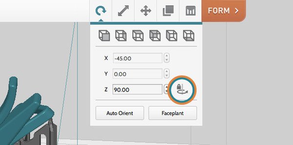

We’ve got another software update for you from our growing development team. PreForm 0.9.2 wraps up a few nice features to make preparing and printing your models even better.
The button circled above limits rotation so that your model only spins about the z-axis. With this type of rotation, you don't need to re-generate the support structures each time you move the model. This especially helps when you’re placing multiple models on the build platform — packing is a lot less time-consuming!
