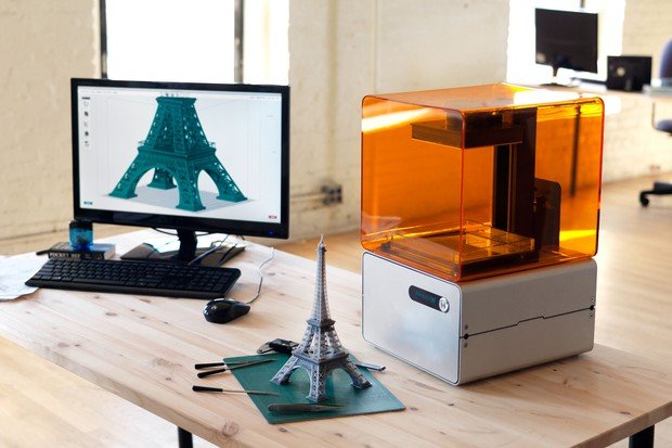

While printing, the Form 1 is whisper quiet — it can sit unobtrusively on your desk. It does, however, make a few unique sounds — particularly when starting a print.
Many of you have wondered what these sounds are. To give you a better idea of what’s going on inside of your Form 1, we’ve recorded a machine as it starts up and gets ready to print.
