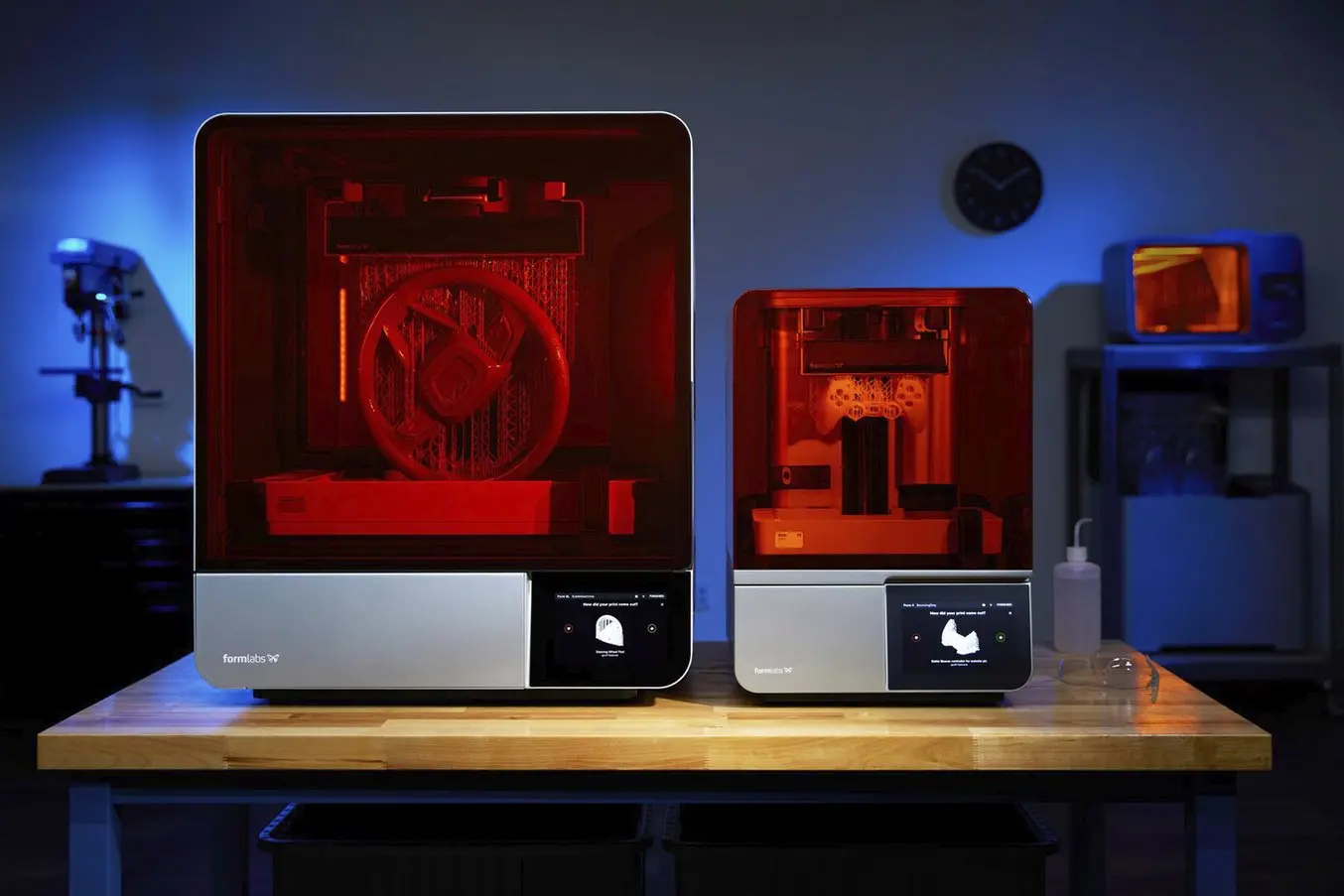

Welcome to the Form 4 Series Training
Congratulations on your new Form 4, Form 4B, Form 4L, or Form 4BL printer! Learn everything you need to get up and running quickly and successfully with your printer through our training videos and support articles.
To get started, create a Dashboard account to prepare to register your printer after it is unboxed and set up. Dashboard allows you to remotely monitor your prints and printers, track material usage, and explore past and future Formlabs purchases. For detailed instructions, refer to our support article.
