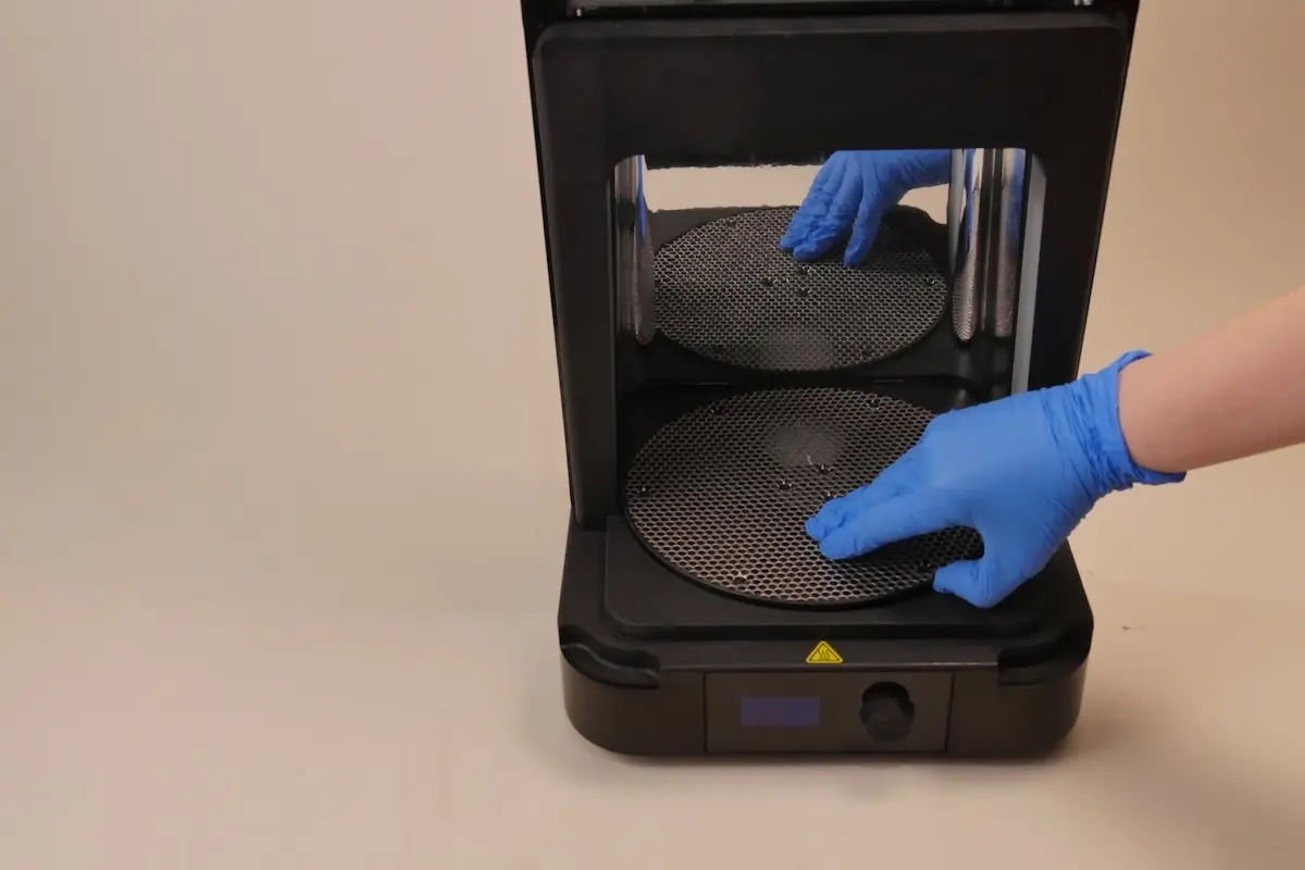

Step 3: Open the cover
Lift the cover. Allow the cover to rest on top of the unit.

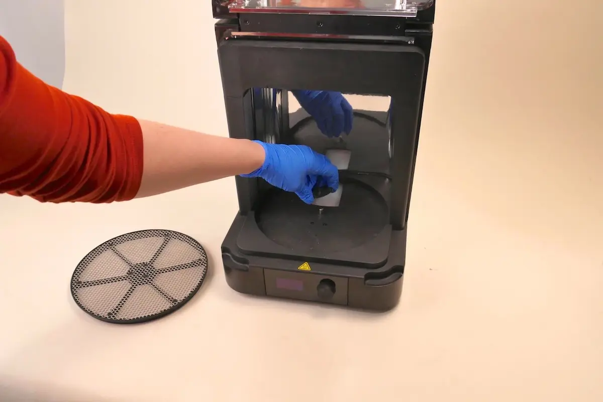

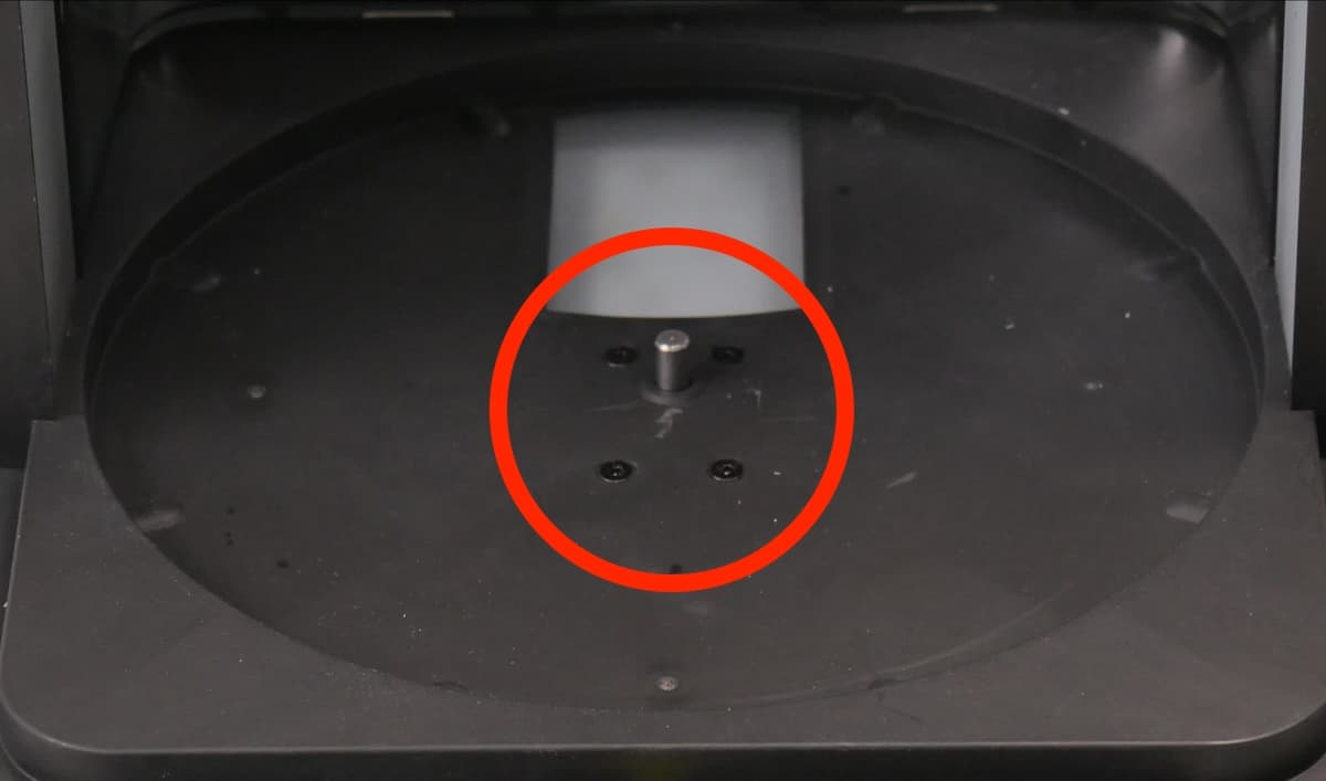

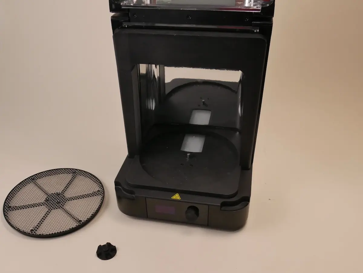

Step 4: Remove the turntable and coupling
Remove the turntable. To remove the coupling, twist the disc to the left and pull up.
Set aside the turntable and coupling for reassembly.

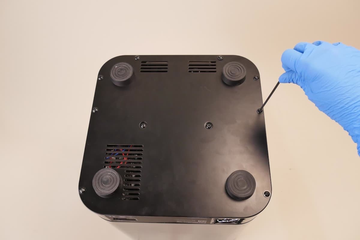

Step 2: Remove the outer screws
Turn the 2.5 mm hex key counterclockwise to remove the eight screws around the bottom plate edge. There are two screws along the top edge, three screws on the left edge, and three screws on the right edge. Set aside the bottom plate and the eight screws for reassembly.
NOTICE:
Do not remove the two screws in the center of the bottom plate. The center screws secure the base assembly.

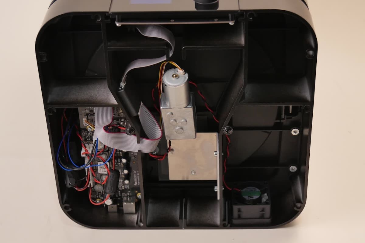

Step 3: Remove the screws holding the motor assembly
Turn the 2.0 mm hex key counterclockwise to remove the four screws that secure the motor assembly to the base.
Set aside the motor screws for reassembly.
Step 4: Turn the unit over
Turn the unit over so that the base faces up.

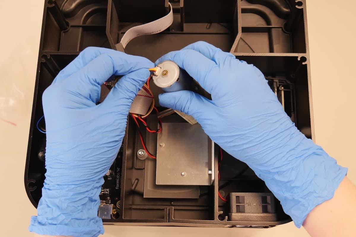

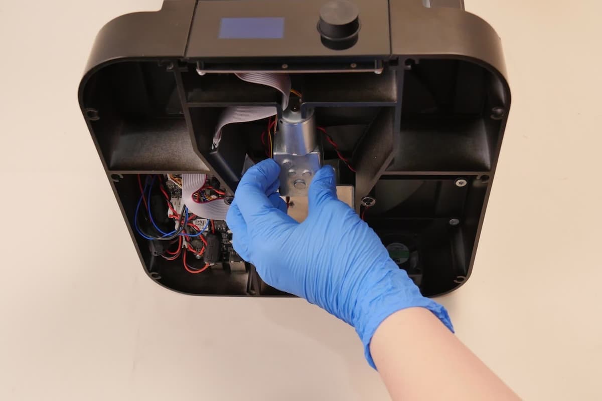

Step 5: Remove the damaged motor assembly
Pull towards you to remove the damaged motor assembly.
Step 6: Disconnect the motor cable
Disconnect the motor cable from the back of the damaged motor assembly.
Step 7: Connect the motor cable to the new motor assembly
Connect the motor cable to the new motor assembly. Ensure the cable connector is fully seated.
Step 9: Insert the new motor assembly
Push evenly to slide the new motor assembly into the slot in the base.
