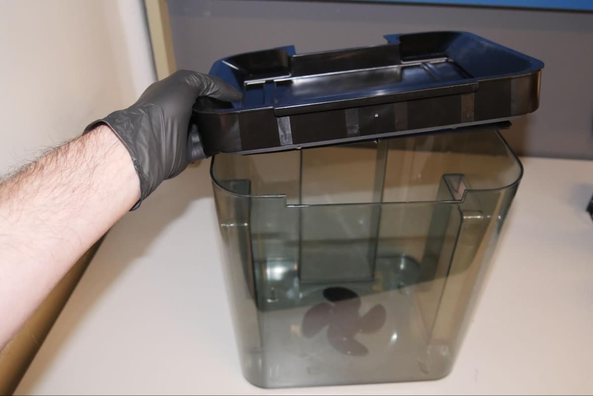

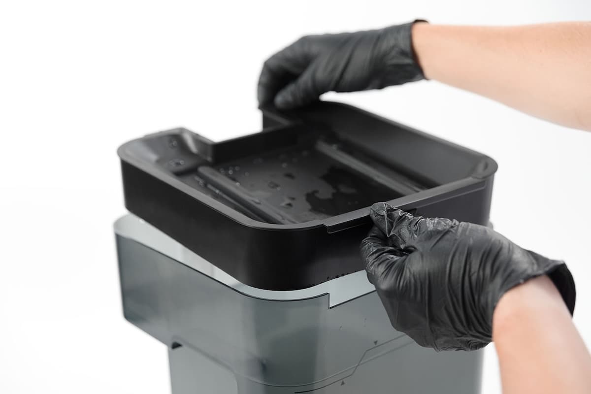

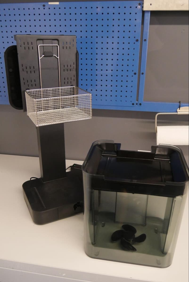

Step 2: Remove the wash bucket and inner lid
Remove the wash bucket from the base and set the bucket aside on a stable, flat surface. Lift the inner lid to remove it and set aside.

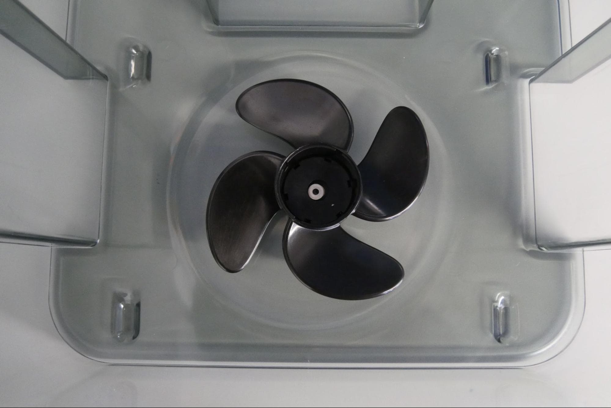

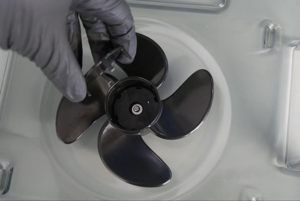

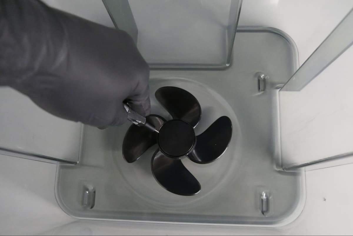

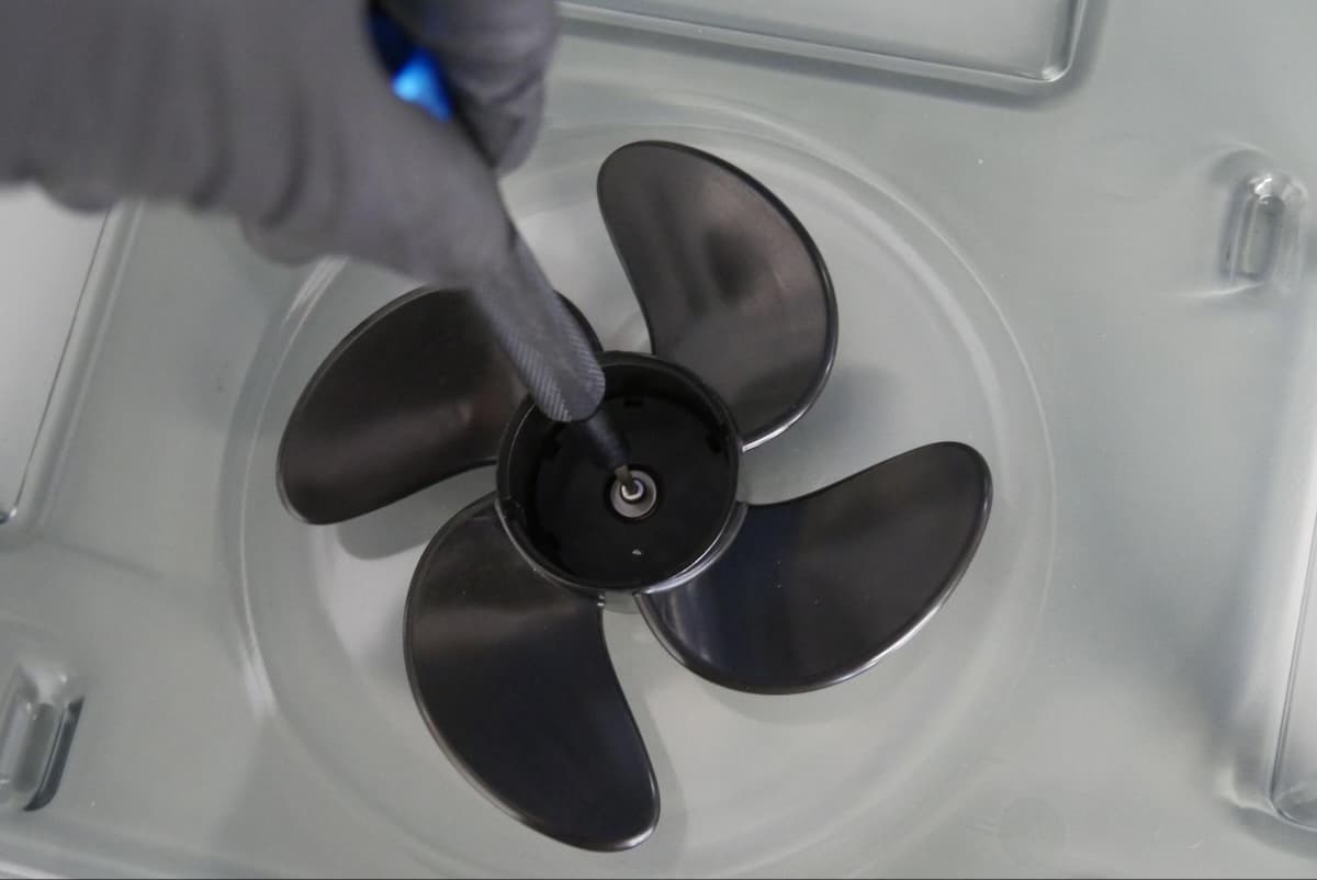

Step 1: Remove the impeller cap
Using a small flat-blade screwdriver or other similar tool, pry the cap loose from the impeller.

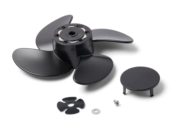

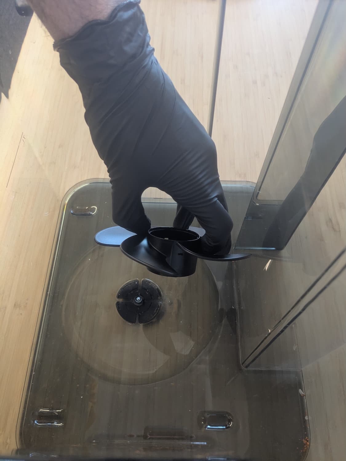

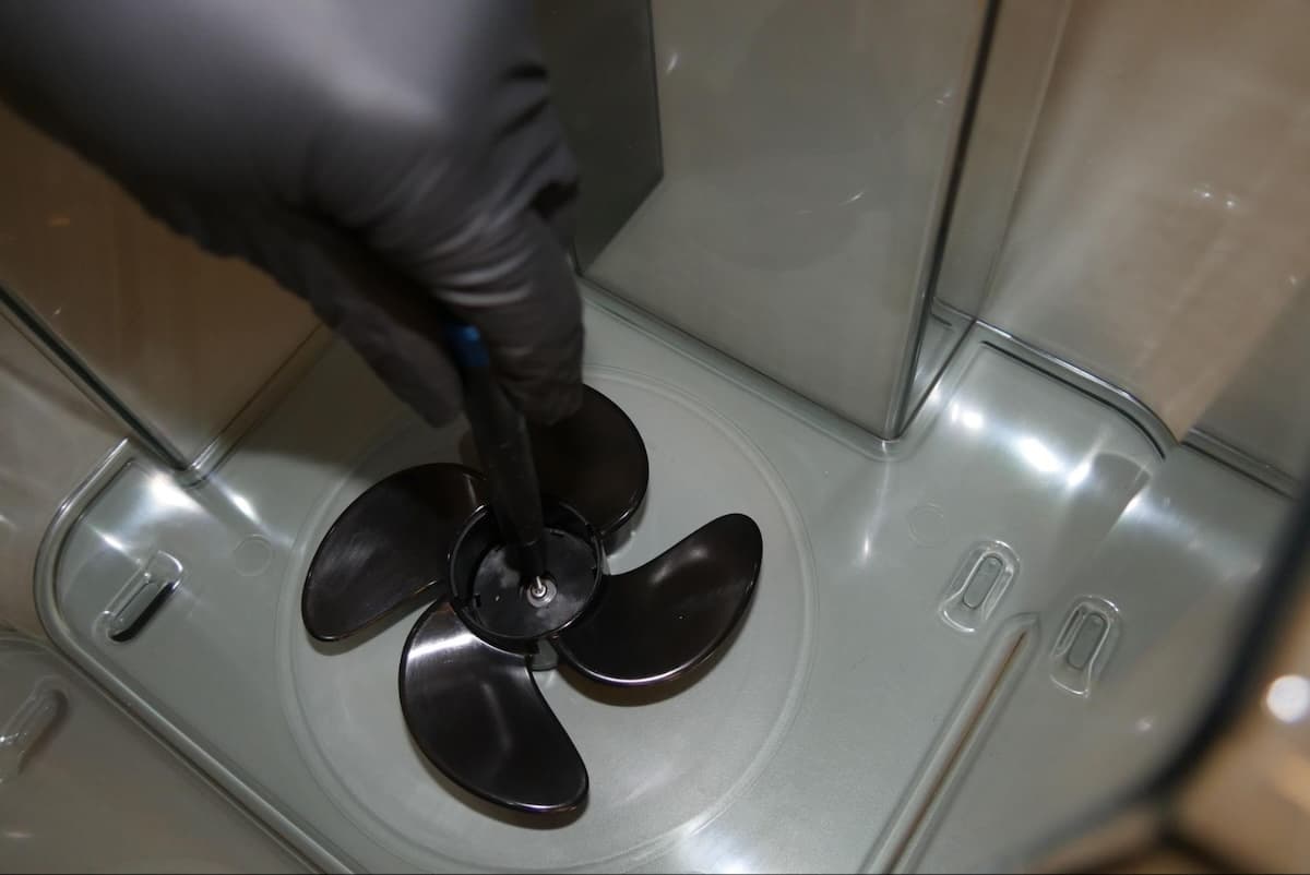

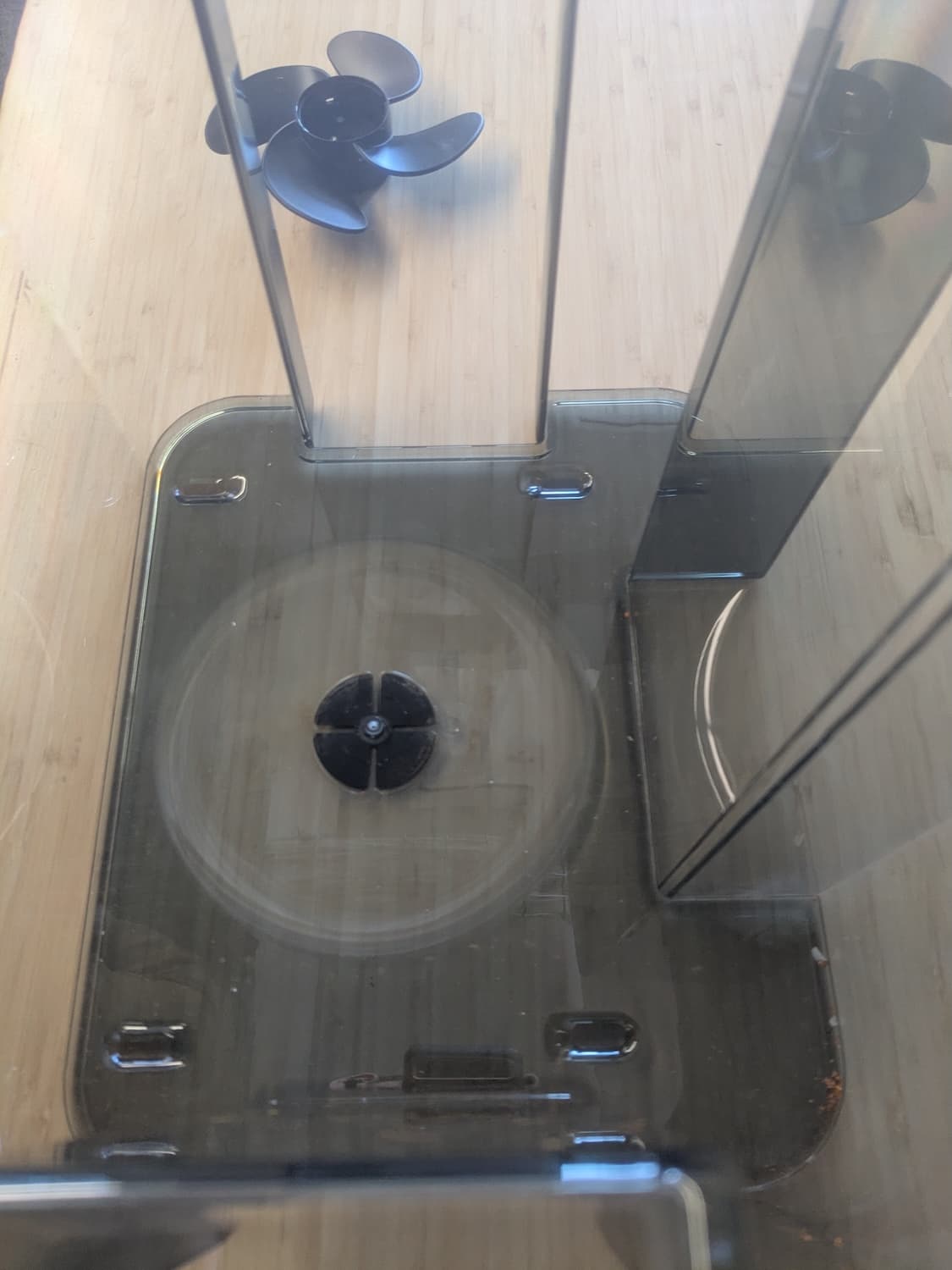

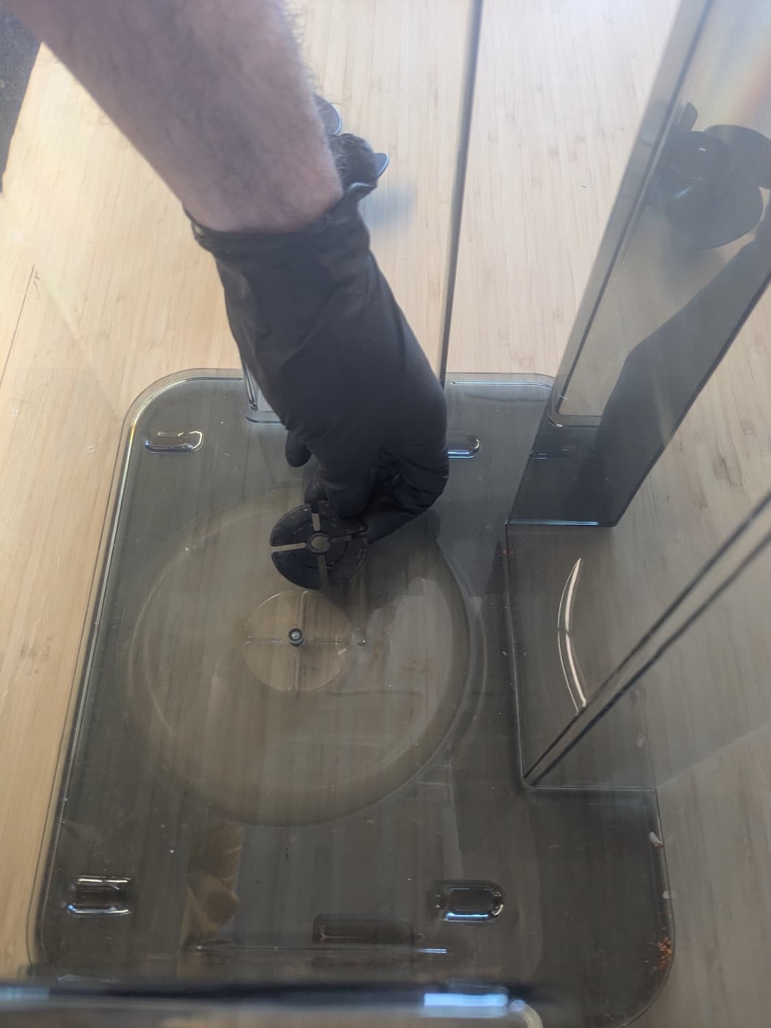

The impeller is secured by one screw with a washer. Use a 2 mm hex driver to remove the screw. Remove the washer, the impeller, and the flat four-lobed bearing below the impeller. Set the components aside for disposal.

The wash bucket has an engraved depression shaped to hold the flat four-lobed bearing. Place the new bearing into this depression. Insert the new impeller into the wash bucket. Align the impeller’s screw hole with the corresponding screw hole in the wash bucket. The impeller should sit flat against the bottom of the wash bucket.

Place the washer onto the impeller’s screw hole. Thread the screw into the Form Wash impeller’s screw hole. Using a 2 mm hex driver, tighten the screw until finger tight. Take care to not overtighten or strip the plastic threads in the wash bucket.
