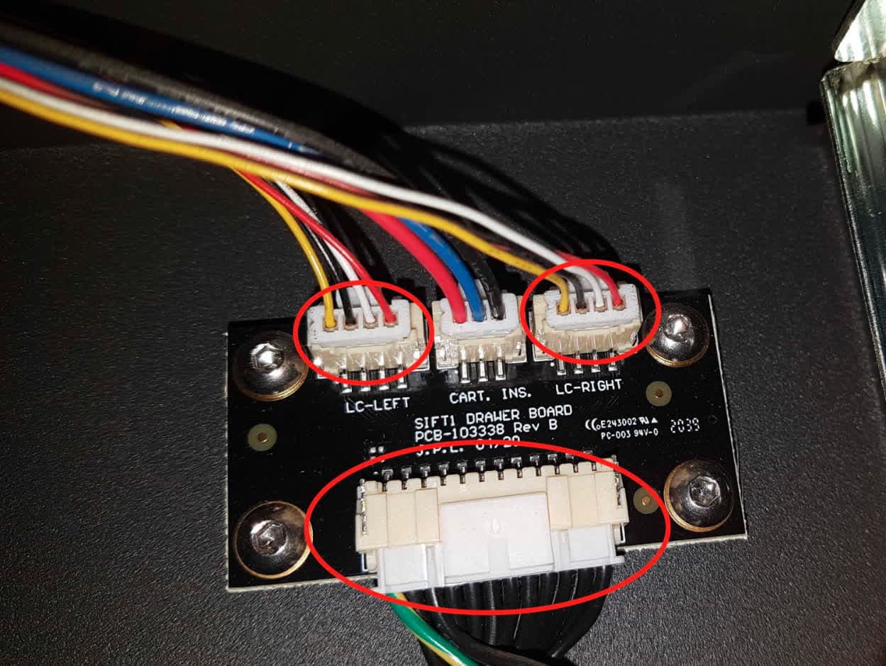

- Locate the small circuit board behind the cartridge drawer. Unplug and reseat the three cables shown here. Squeeze the plastic tab to unplug each connector; do not pull on the wires themselves.
