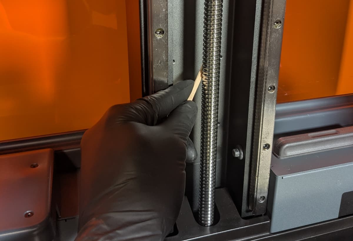

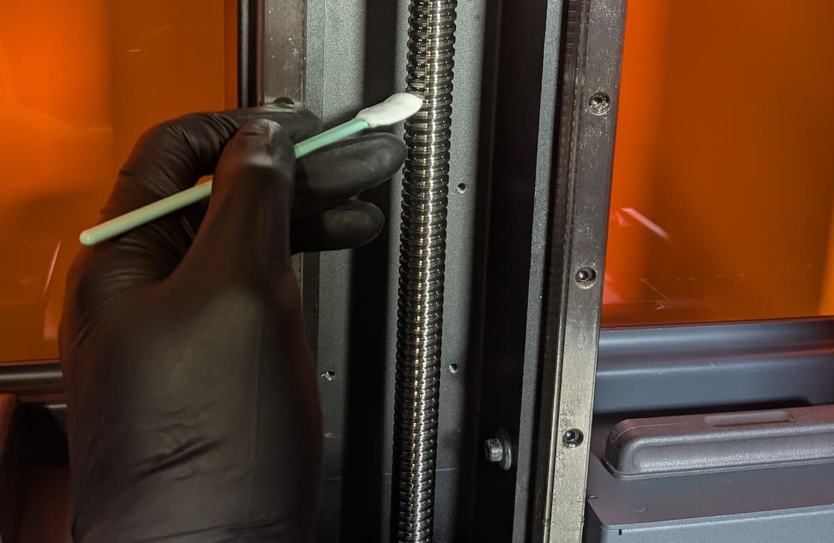

Step 2: Clean the Z-axis lead screw threads
Cleaning the Form 4L Z-axis lead screw threads
Use a soft brush, swab, or other similar tool to clean out the Z-axis lead screw threads.

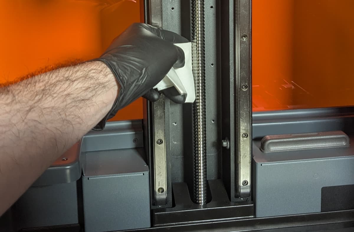

Step 1: Prepare the applicator
Place a small amount of grease on the tip of an applicator such as a tongue depressor or paint stirrer.
Step 2: Spread the grease along the lead screw
Applying grease to the Form 4L Z-axis lead screw
Using the applicator, spread the grease along the Z-axis lead screw.

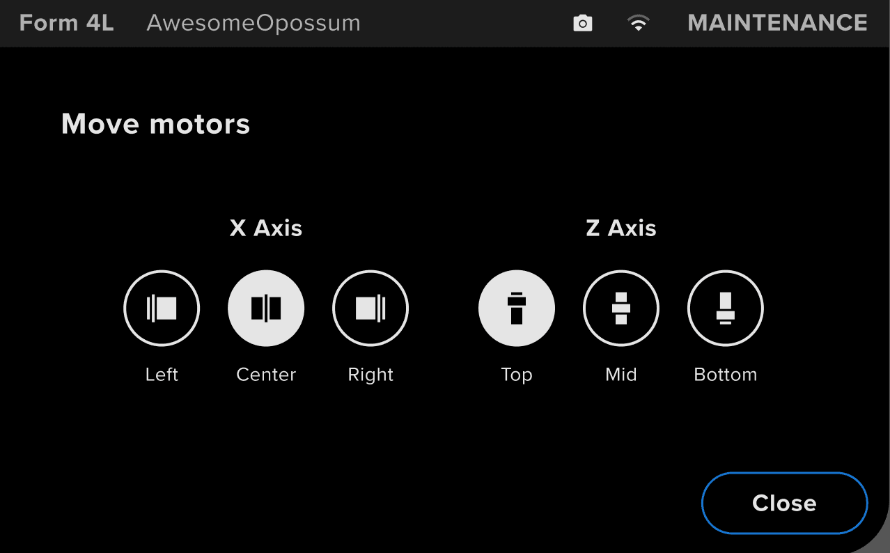

Step 2: Test movement along the Z-axis lead screw
On the touchscreen, tap Settings > Tools > Move motors. The Move motors screen appears. Tap Bottom to move the build platform mount towards the bottom of the Z-axis lead screw. When it reaches the bottom and stops moving, tap Top to return it to its home position. This will further spread the grease along the lead screw. Ensure that the build platform mount moves smoothly, without making noise or stalling.
Form 4L motor movement menu
