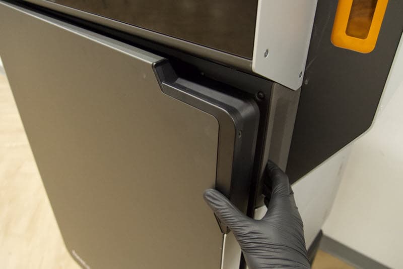

  1. In the bottom right corner of the touchscreen, drag the Unlock Door slider. The print enclosure door unlocks.
  2. Open the print enclosure door.

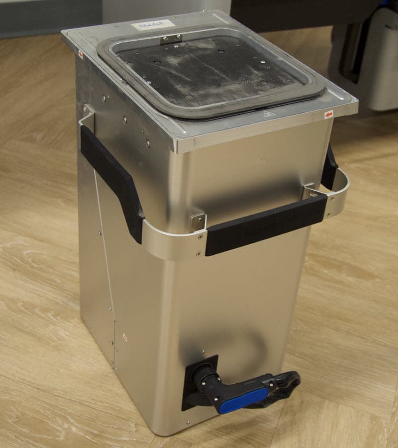

  1. If there is a build chamber in the printer, remove it before continuing.

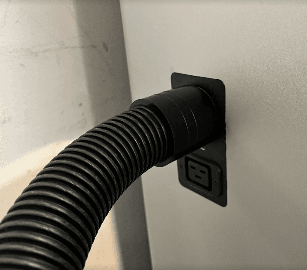

  1. Remove the vacuum hose from the port on the side of the Fuse Sift so that it can reach inside the Fuse 1’s print enclosure.

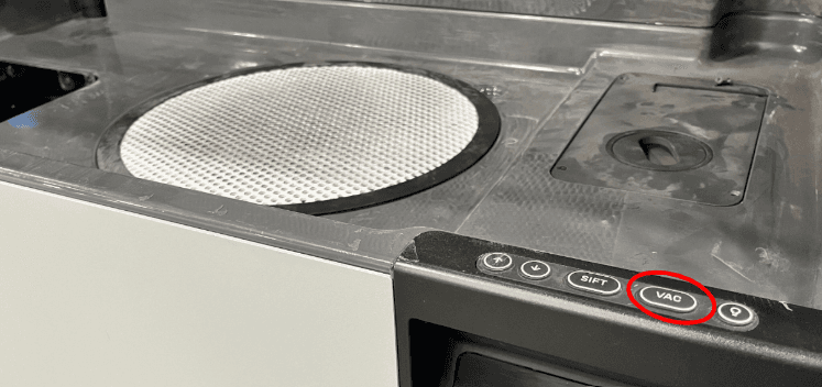

  1. Push the Vac button on the Fuse Sift control panel or tap the vacuum hose icon on the Fuse Sift’s touchscreen. The vacuum turns on.

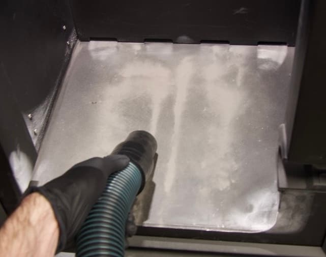

  1. Use the vacuum hose to clean the bottom of the print enclosure and remove all powder. Avoid touching the gaskets around the print enclosure door with the vacuum hose.

  2. Close the print enclosure door. Press firmly to ensure that the door is fully latched.
