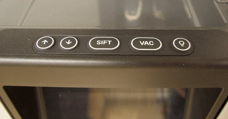

Step 2: Turn on the vacuum
Push the Vac button on the Fuse Sift control panel to turn on the vacuum.
A zoomed-in view of the control panel above the touchscreen

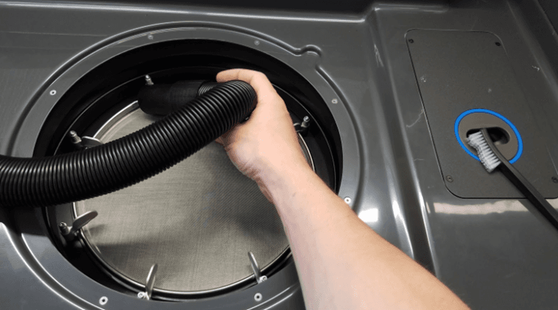

Step 4: Carefully vacuum the mesh
Without touching the mesh, use the vacuum hose to remove debris, clumps, loose powder, and other obstructions from the sifter mesh.
Someone is holding the vacuum hose against the mesh beneath the grate
Step 5: Turn off the vacuum
Push the Vac button on the Fuse Sift control panel to turn off the vacuum.

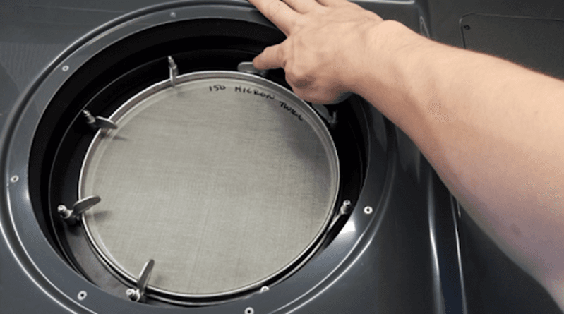

Step 1: Remove the mesh
Turn the turnbuckles to release the sifter mesh.
Someone is reaching out to turn the turnbuckles and release the mesh
Step 2: Remove and inspect the mesh
Remove the sifter mesh and inspect it for clogged powder.

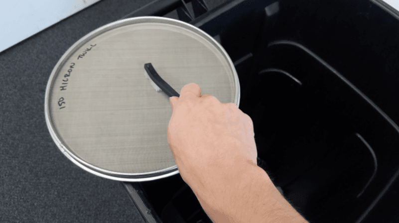

Step 3: Place the mesh over a trash can
If there is powder clogged in the sifter mesh, place the mesh over a trash can to begin removing the stuck powder.
Step 4: Brush the mesh
While the mesh is over the trash can, use the double-sided brushes to vigorously brush and remove the stuck powder.
Someone has removed the mesh and is brushing it over a trash can
