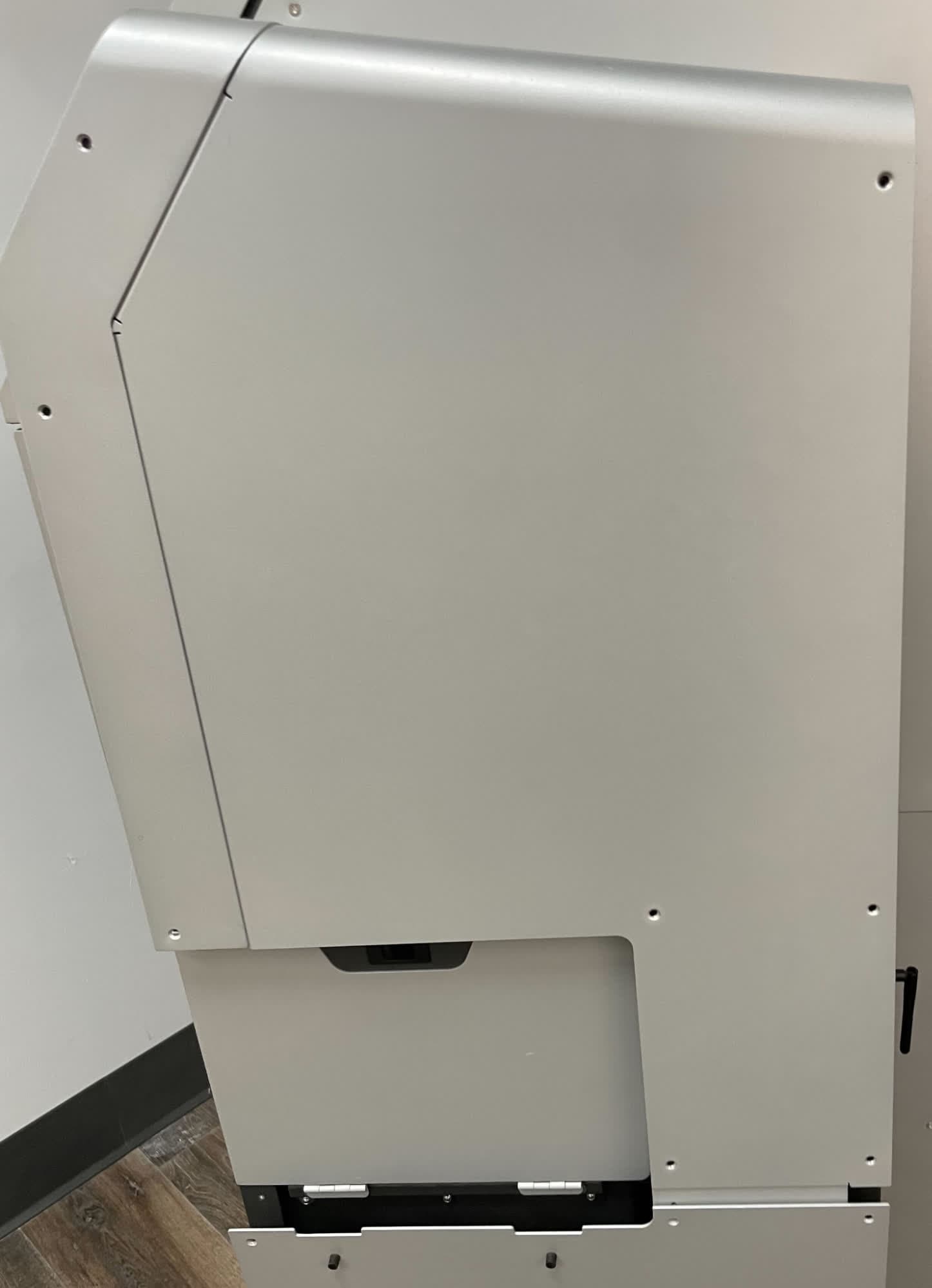

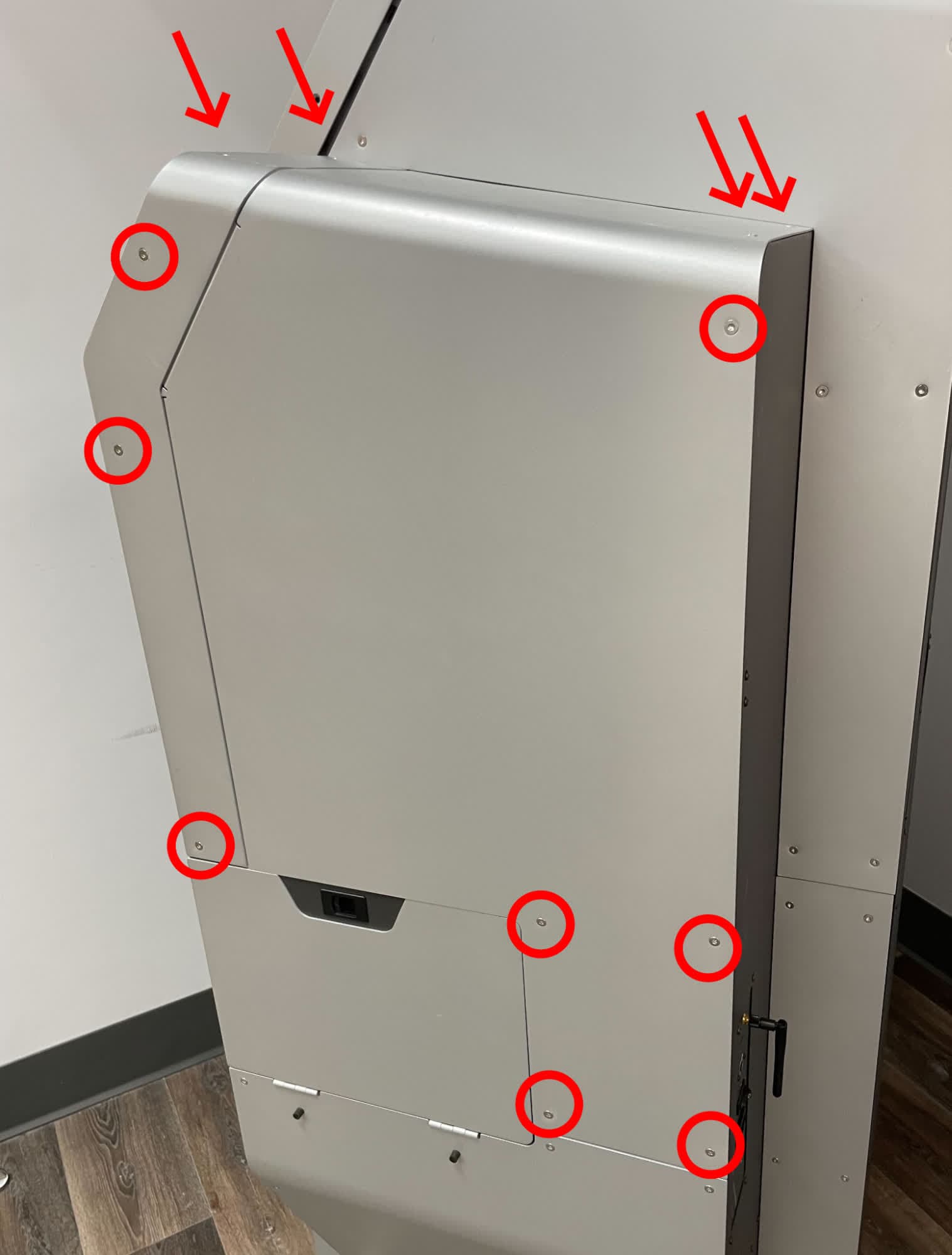

The air metering valve is located in the sidecar on the right side of the machine. Using a T20 Torx driver, loosen and remove the 12 T20 Torx screws securing the upper sidecar panel to the Fuse Blast. Set the screws aside.

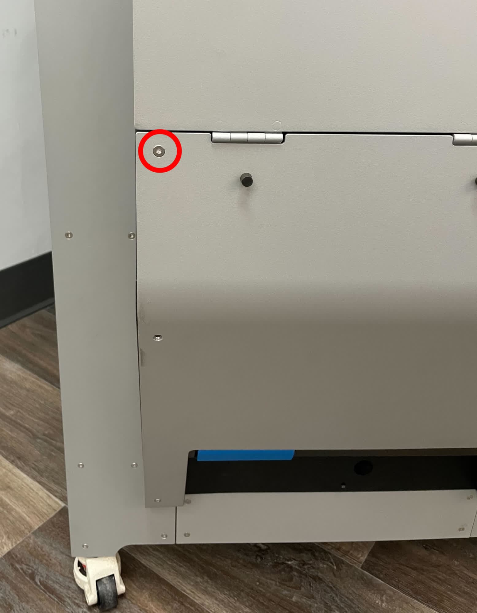

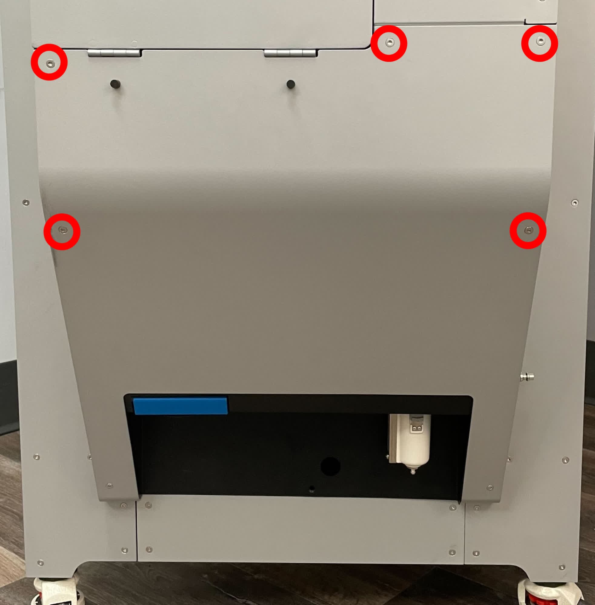

The lower sidecar panel must be moved slightly to free the upper sidecar panel. Using a T20 Torx driver, loosen and remove the five T20 Torx screws shown above. Set the screws aside. Do not remove the two screws at the bottom of the lower sidecar panel.

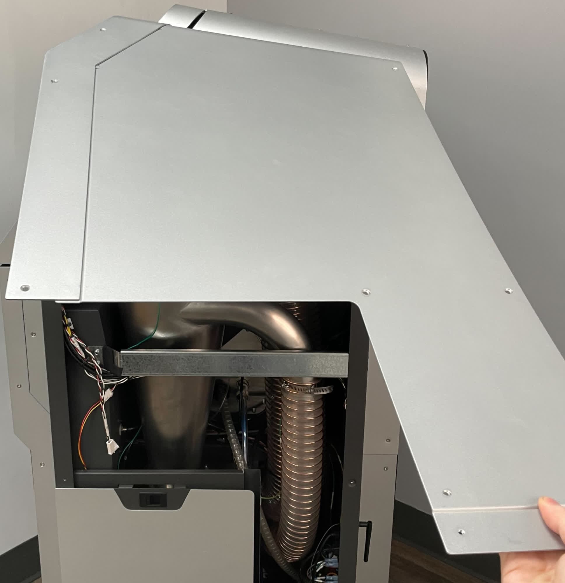

Step 3: Remove the upper sidecar panel
Untuck the bottom of the upper sidebar panel from behind the lower sidecar panel. Rotate the panel upwards until it is horizontal. Once it is horizontal, pull forward to disengage it. Set the upper sidecar panel aside.

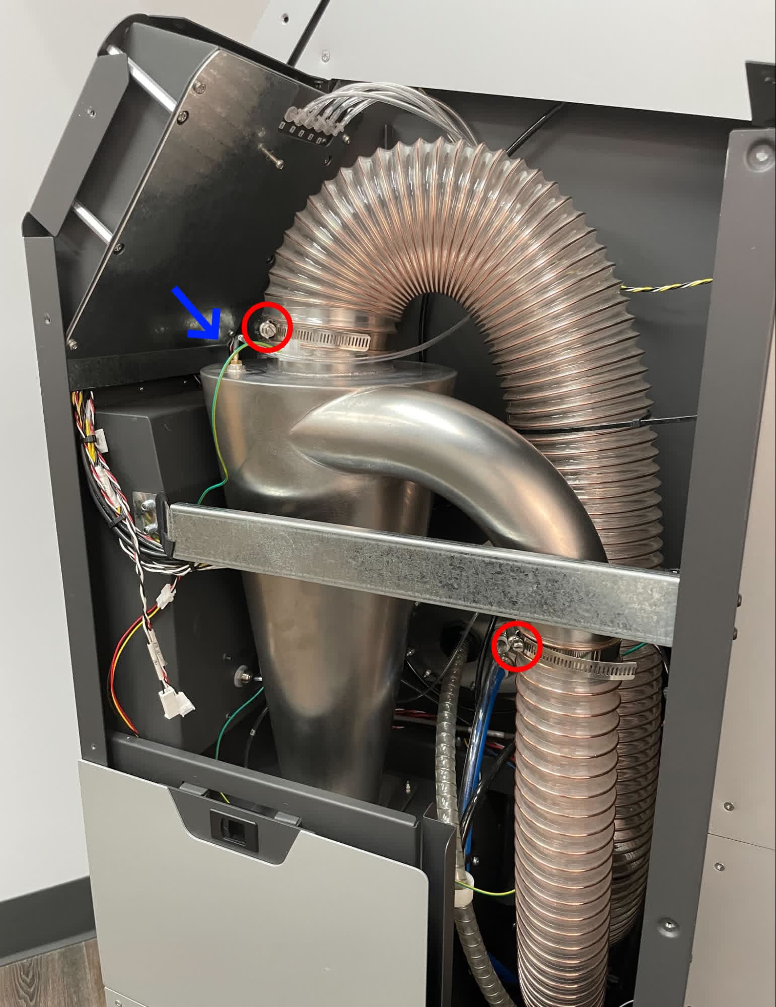

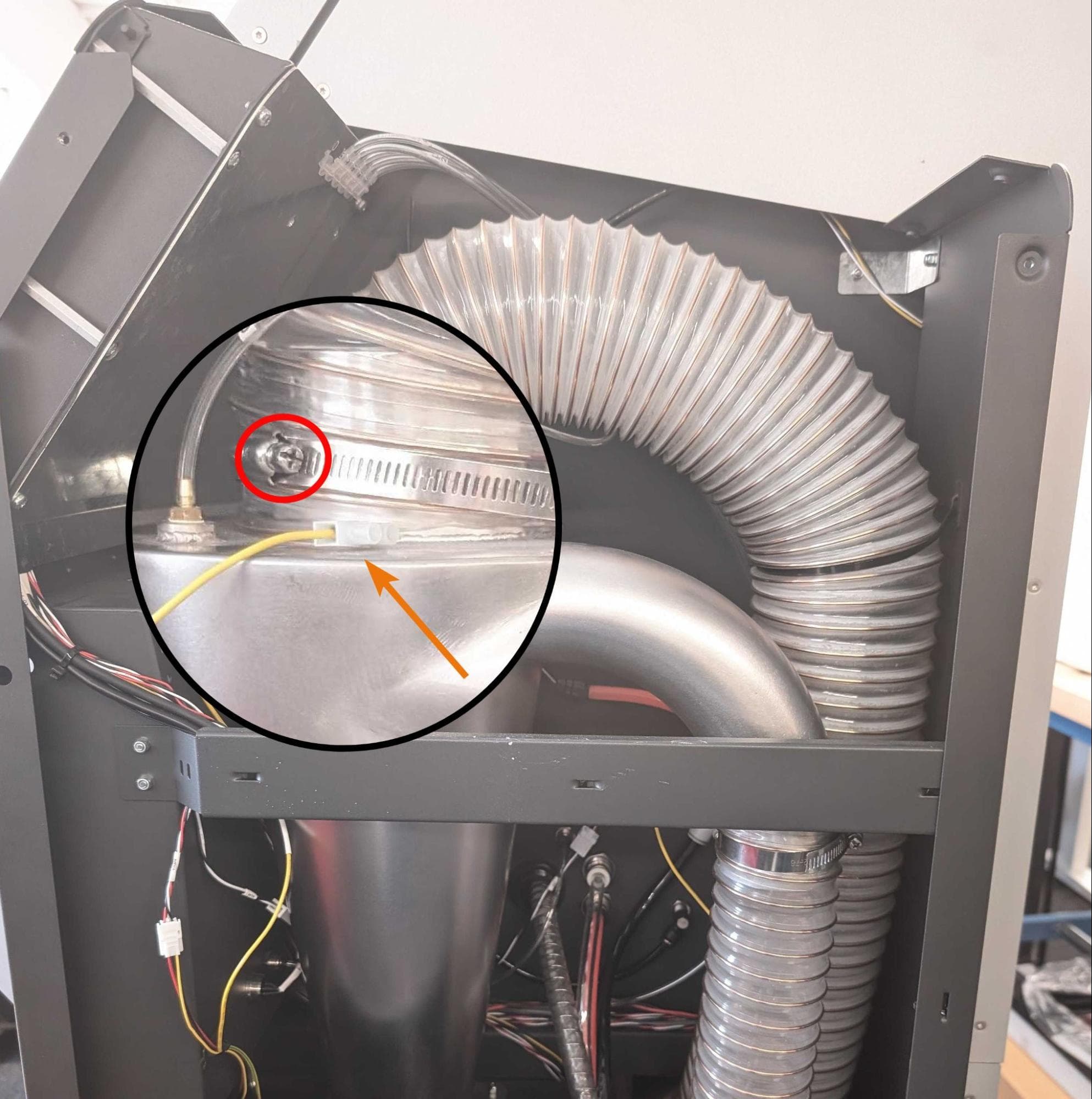

Using a small flat-blade screwdriver, loosen the hose clamp from the top of the cyclone separator. Gently lift the tubing off of the cyclone separator and drape it to the side. Be careful not to break the grounding connection to the tubing.
Continue to Disabling the Wi-Fi hardware . If you find it difficult to to open the electronics box and access the motherboard, return here and remove the entire cyclone separator.

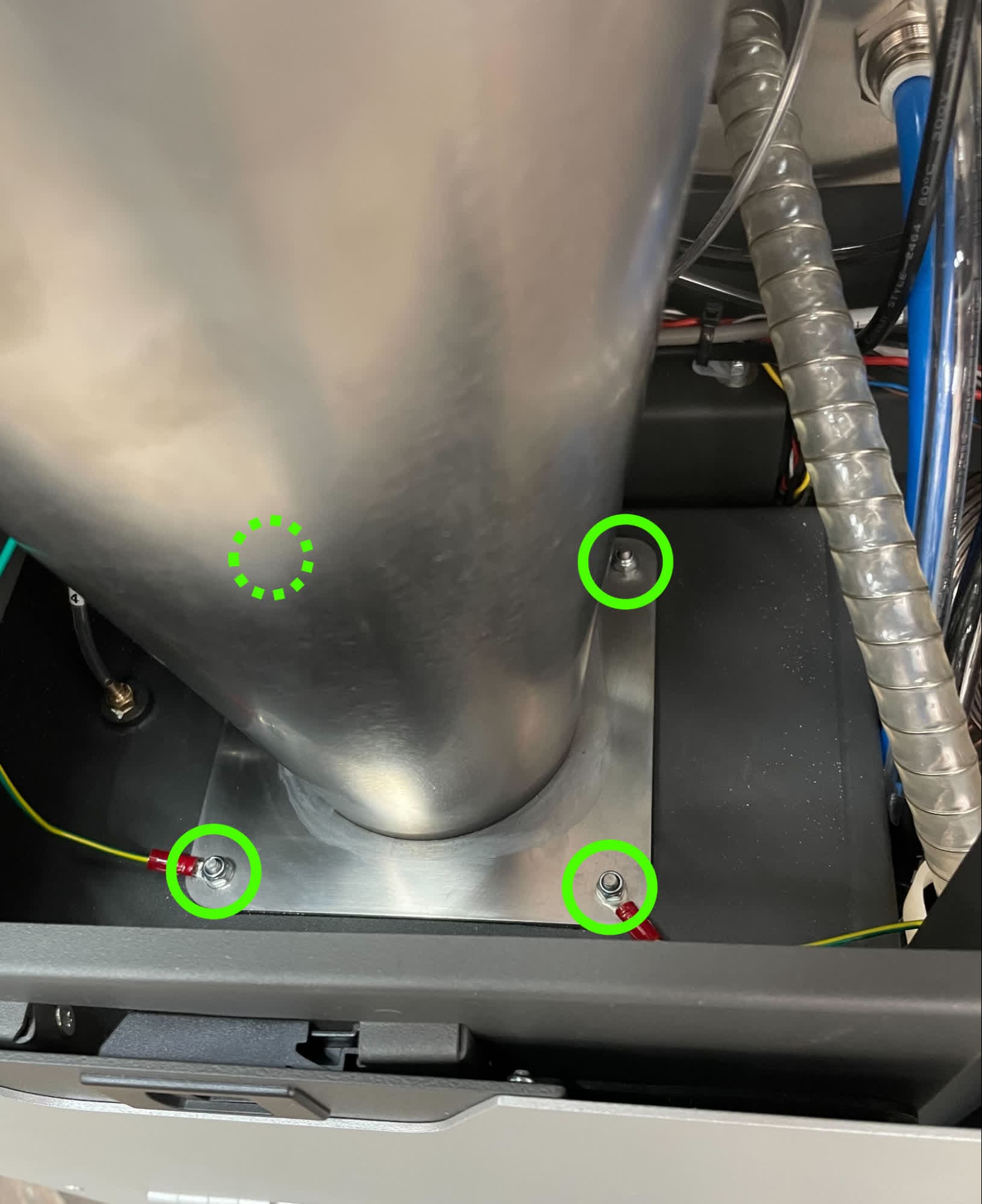

Using a small flat-blade screwdriver, loosen the hose clamps from the cyclone separator. Pull the pressure tap hose off of the cyclone separator. The pressure tap is located close to the front of the machine. If the pressure tap tube is difficult to remove or has deformed from use, it can be cut at the barbed fitting with a utility knife.
Using a 7 mm nut driver or box wrench, loosen and remove the four hex nuts securing the cyclone separator to the Fuse Blast. Set the nuts aside. Move the two grounding wires out of the way of the cyclone separator.
Remove the cyclone separator and the gasket below it from the machine. Set them aside on a clean surface.

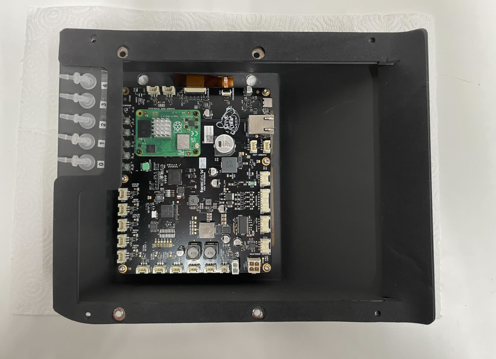

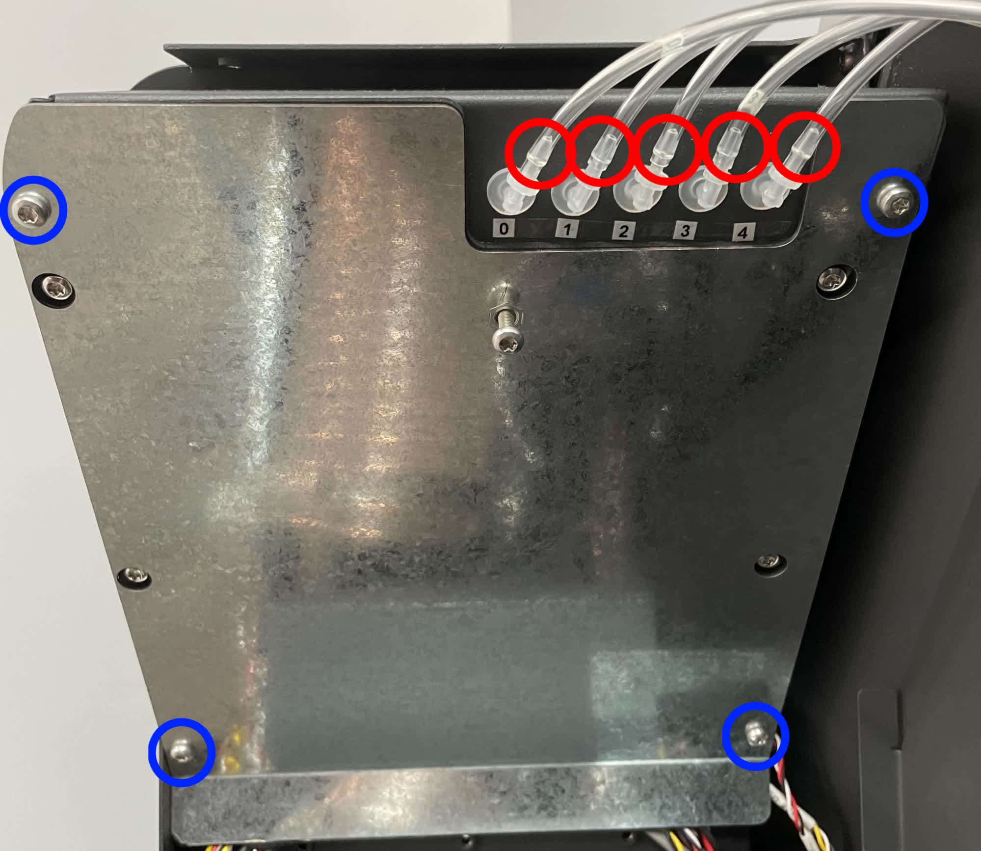

Using a T20 Torx driver, loosen and remove the four T20 Torx screws securing the electronics box cover to the machine. Set the screws and the cover aside. Take care not to damage the five pressure tap tubes connected to the electronics box.

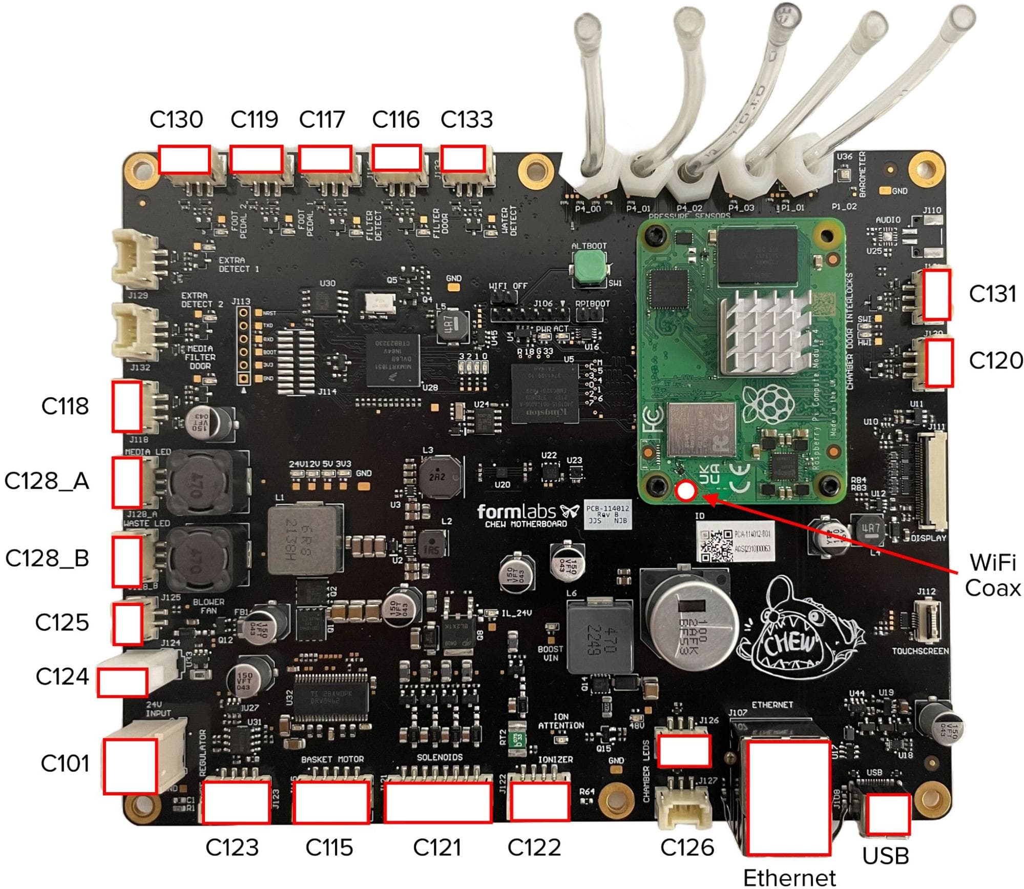

The Fuse Blast motherboard has a header labeled Wi-Fi OFF, located near the top of the board. Place a 2-pin jumper (0.1 in / 2.54 mm pitch) on the header to disable Wi-Fi on the machine.

Place the cycle separator gasket on the cyclone separator mount, aligning the holes in the corners of the gasket with the threaded posts.
Place the cycle separator on the gasket, aligning the holes in the corners of the cyclone separator base with the threaded posts.
Mount the two grounding wires on two of the cyclone separator posts. Thread one 7 mm nut onto each of the posts. Use a 7 mm nut driver or box wrench to tighten the nuts until they are secure but the gasket is not fully compressed.

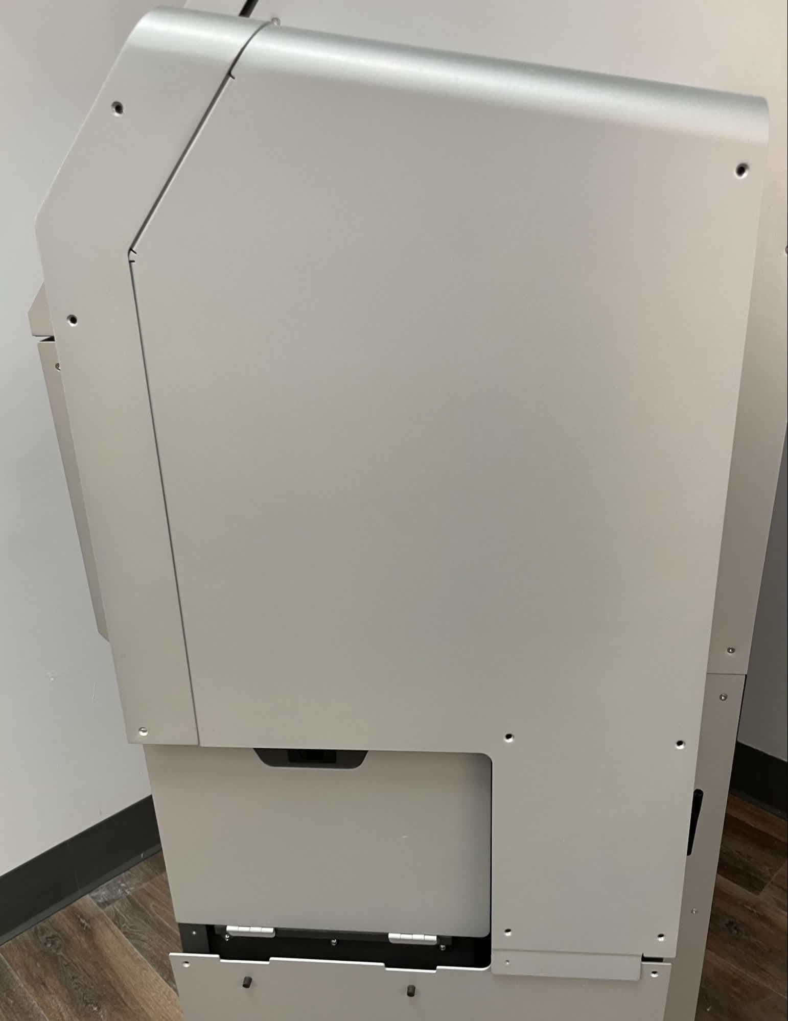

Insert the upper sidecar panel horizontally such that the flange tucks under the upper panel. Rotate the sidecar panel downward, then tuck the lower flange under the lower sidecar panel.
Thread one upper sidecar panel retention screw into each of the 12 screw holes in the upper sidecar panel. Use a T20 Torx driver to tighten until snug.
Thread one upper sidecar panel retention screw into each of the five open screw holes in the lower sidecar panel. Use a T20 Torx driver to tighten until snug.
