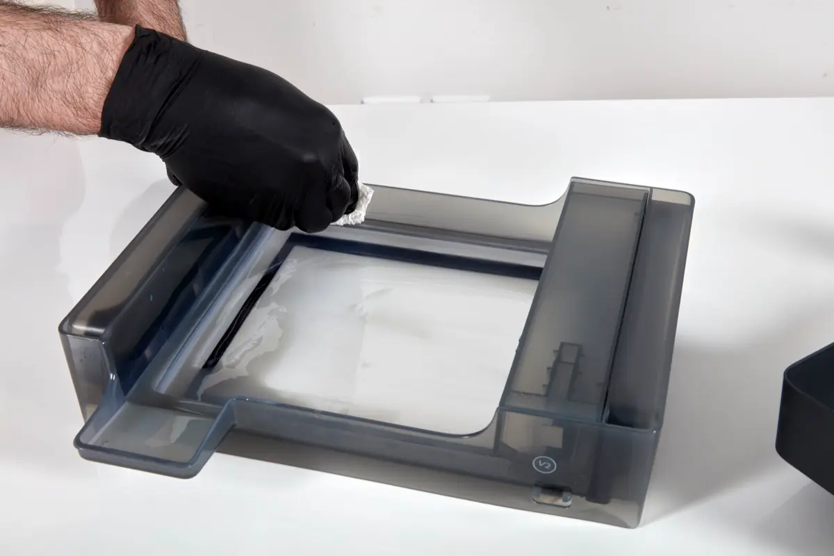

  1. Use a paper towel to wipe any remaining resin off the old resin tank.

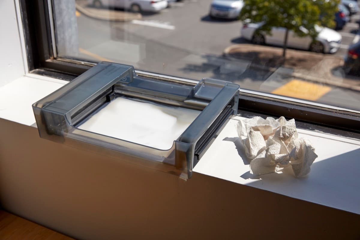

  2. Place the old resin tank in sunlight (a window sill is fine) or UV light to cure excess resin, and dispose of properly once cured.

Form 3 resin tank is wiped by a gloved hand and a paper towel.
Form 3 resin tank left on a window sill to cure excess resin.
