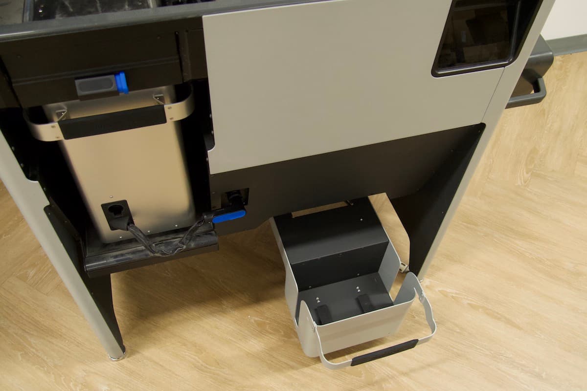

To insert a powder cartridge into the Fuse Sift:
  1. Pull the handle at the bottom-right of the Fuse Sift to slide the cartridge drawer open.
The Fuse Sift's cartridge drawer is open

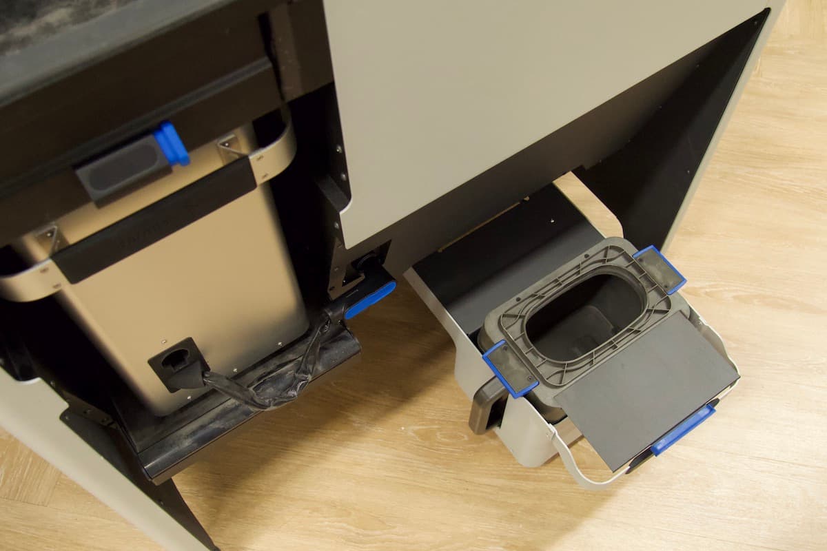

  1. Insert an empty cartridge into the cartridge drawer with the cartridge valve facing upward and the cartridge knife handle pointed away from the Fuse Sift.
  2. Pull the cartridge knife handle and fully open the cartridge valve.
The Fuse Sift's opened cartridge drawer with an empty powder cartridge
Note:
Ensure that the cartridge knife handle is not resting on the cartridge drawer frame. Resting the knife handle on the drawer frame will prevent the Fuse Sift from accurately weighing the cartridge and dispensing powder properly.

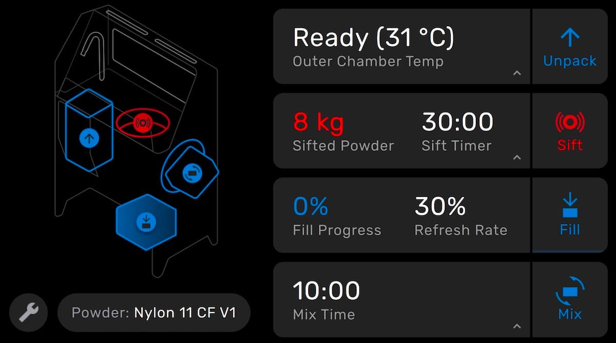

  1. On the touchscreen, check that the Refresh Rate is set to the desired refresh rate.
    • To change the refresh rate, tap Refresh Rate. The Refresh Rate screen appears. Use the touchscreen to adjust the ratio of fresh to used powder.
The Fuse Sift's home screen
Notice:
Be sure to select the correct powder refresh rate for your material and print environment. Decreasing the amount of new powder too far may result in print quality defects and increase the likelihood of print failures.
  1. Tap Fill. The Fuse Sift dispenses powder into the inserted cartridge. The vacuum also turns on to capture any loose powder in the workspace.
  2. After approximately one minute, the cartridge is filled and the vacuum turns off.
  3. Open the cartridge drawer.
  4. Close the cartridge valve and remove the cartridge from the cartridge drawer.
Note:
To partially fill a powder cartridge, tap Fill again to stop dispensing powder.
