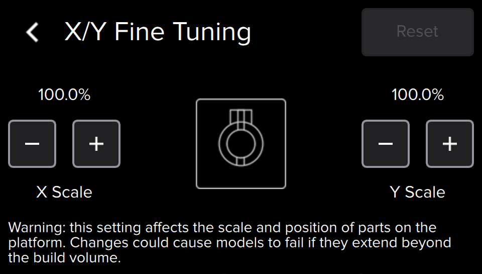

Correcting stretched or compressed prints
If printed parts appear stretched out or compressed on the build platform, change the X or Y Scale values to adjust the laser’s path and compensate for the distortion of parts. Increasing the scale value widens the laser’s path, while decreasing the scale narrows the path.
Correct compressed parts
Stretch the laser’s path along an axis
  1. Ensure that the Form 2 is not running a print job and is currently Idle.
  2. Tap the printer icon on your printer’s touchscreen. The Your Printer screen appears.
  3. Tap Settings. The Settings screen appears.
  4. Tap X/Y Fine Tuning. The X/Y Fine Tuning screen appears.
  5. Stretch the laser’s path along an axis:
    • Tap the + button under X Scale to stretch the laser’s path along the X-axis and increase the value in increments of 0.10%. The maximum X Scale value is 105%.
    • Tap the + button under Y Scale to stretch the laser’s path along the Y-axis and increase the value in increments of 0.10%. The maximum Y Scale value is 105%.
  6. Tap < to save your changes and return to the Settings screen.
Correct stretched parts
Compress the laser’s path along an axis
  5. Compress the laser’s path along an axis:
    • Tap the - button under X Scale to compress the laser’s path and decrease the value in increments of 0.10%. The minimum X Scale value is 105%.
    • Tap the - button under Y Scale to compress the laser’s path and decrease the value in increments of 0.10%. The minimum Y Scale value is 95%.

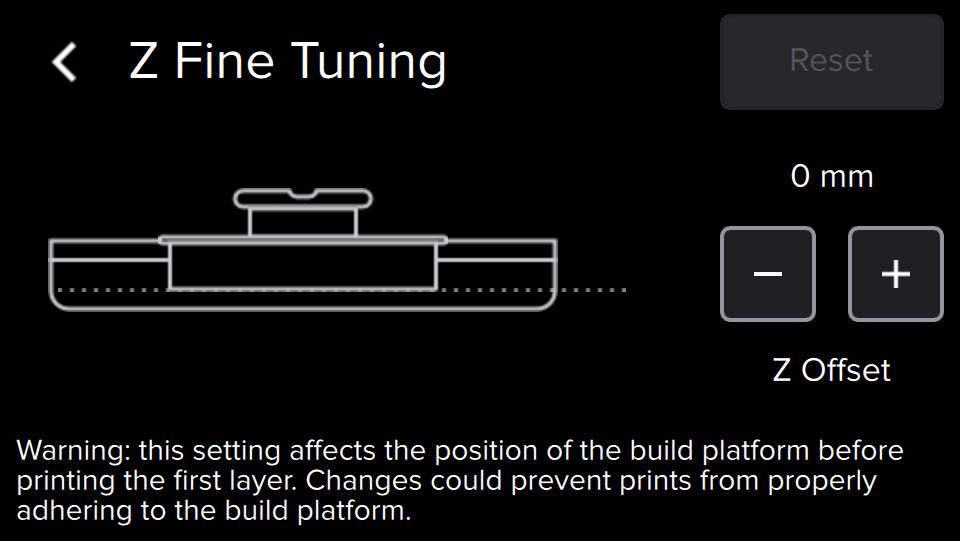

Correcting overcompression
Printed prints are sometimes shorter than their intended design. The Z Fine Tuning setting changes the height of the build platform above the tank’s elastic layer before the first layer adheres to the build platform. This dimensional inaccuracy is referred to as Z-compression, and can be adjusted by raising the build platform.
Tip:
Adjust the build platform height in increments of 1.00 mm, then print small models to test the change and continue to adjust the value until models print with consistent supports and rafts.
Raise the build platform
  4. Tap Z Fine Tuning. The Z Fine Tuning screen appears.
  5. Tap the + button under Z Offset to raise the default position of the build platform and increase the value in increments of 0.10 mm. The maximum Z Offset value is 2.00 mm.
Correcting non-adherence
Prints that complete but leave the build platform empty are the result of non-adherence. The Z Fine Tuning setting changes the height of the build platform above the tank’s elastic layer before the first layer adheres to the build platform. Small adjustments to the build platform height can help models adhere and build correctly.
Tip:
Lower the build platform
  5. Tap the - button under Z Offset to lower the default position of the build platform and decrease the value in increments of 0.10 mm. The lowest available Z Offset value is -2.00 mm.
  6. Start by changing the Z Offset value to -1.00 mm. Print small models to test the change and continue to adjust the value until models print with consistent supports and rafts.
  7. Tap < to save your changes and return to the Settings screen.
