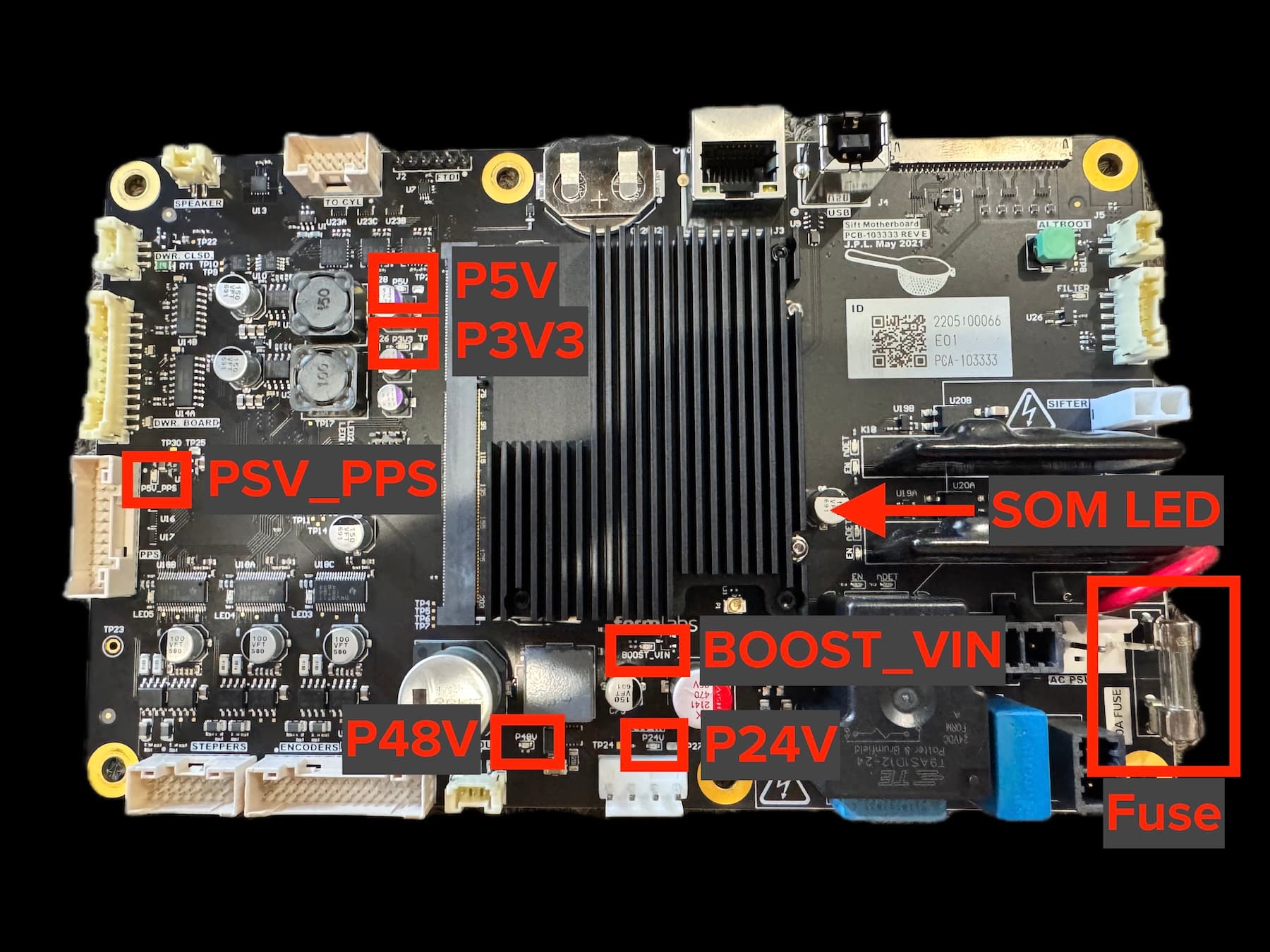

  2. If the Fuse Sift does not appear in PreForm, check the status of the power LEDs on the motherboard while powering on the machine. Follow the instructions in the guide Fuse Sift - Replacing the Motherboard [EN] to access the motherboard. Refer to the flowchart below to identify if the issue is with the display, motherboard, or the system on module (SOM).
    1. If you determine that the motherboard should be replaced, it is available for purchase on the Formlabs Store. To replace the component, follow the instructions Fuse Sift - Replacing the Display Assembly [EN]. Instructions for replacing the SOM start from step 15.

  1. If the power LEDs are all lit properly, the issue may be that the display cable is not properly seated. If the motherboard cannot communicate with the display, the machine will not fully boot. Locate the display cable connector, positioned next to the USB and Ethernet ports on the motherboard. Carefully remove the display cable and inspect the pins on the display cable connector to ensure that none of the pins are bent. If the connector is damaged, then the motherboard will need to be replaced.

Fuse Sift motherboard with marked power LEDs
