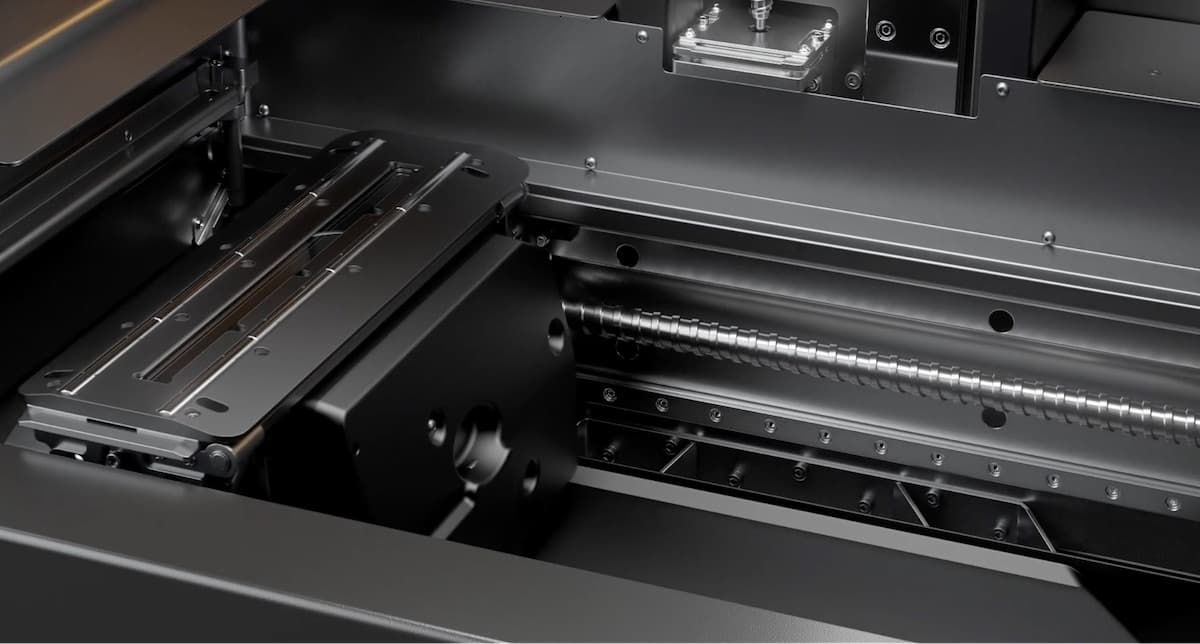

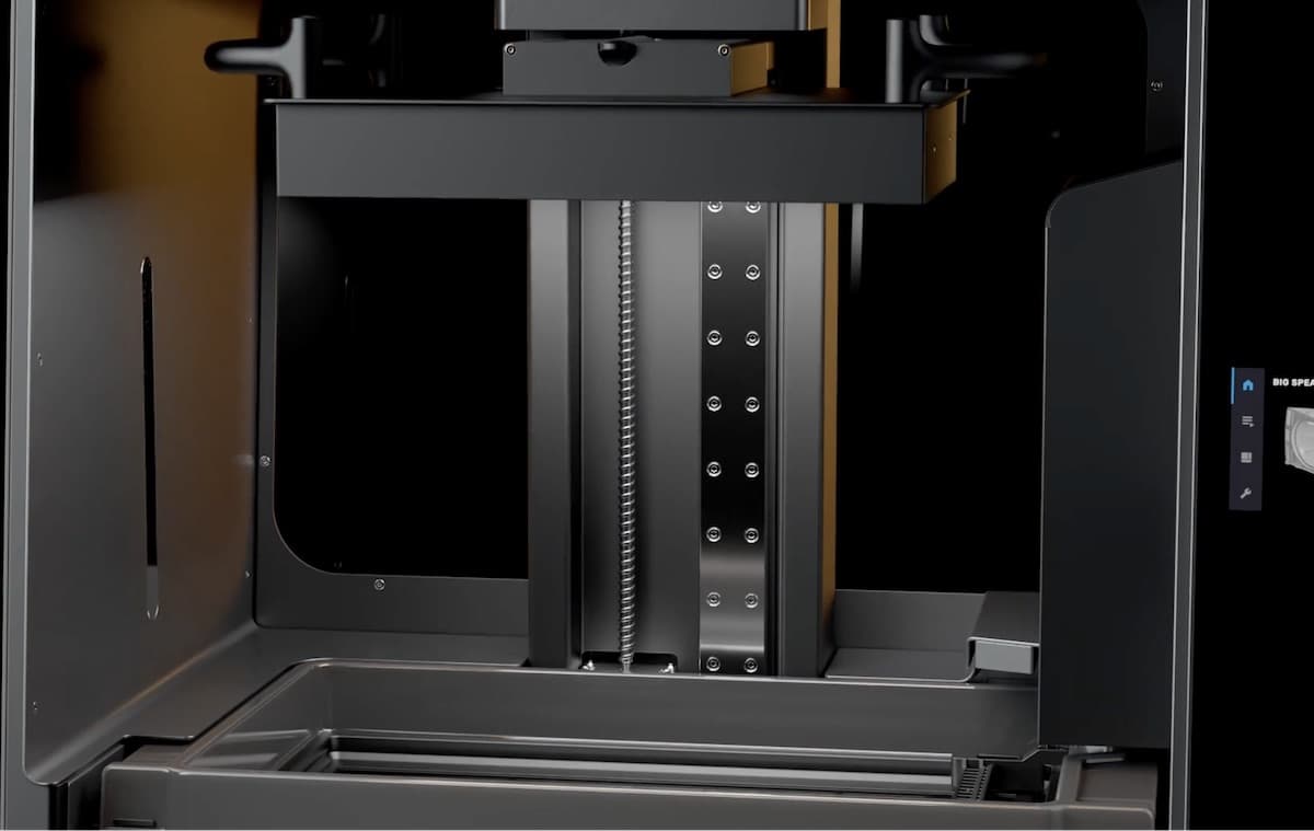

The Light Processing Unit (LPU) housing and the build platform carriage ride along the X-axis ball screw and Z-axis lead screw, respectively. Both screws must be lubricated for these X- and Z-axis components to move smoothly and quietly.

Periodically inspect the X- and Z-axis screws to ensure that the LPU housing and build platform carriage move smoothly and that there is no debris built up in the screw threads.
To inspect the X-axis screw:
To inspect the Z-axis screw:
