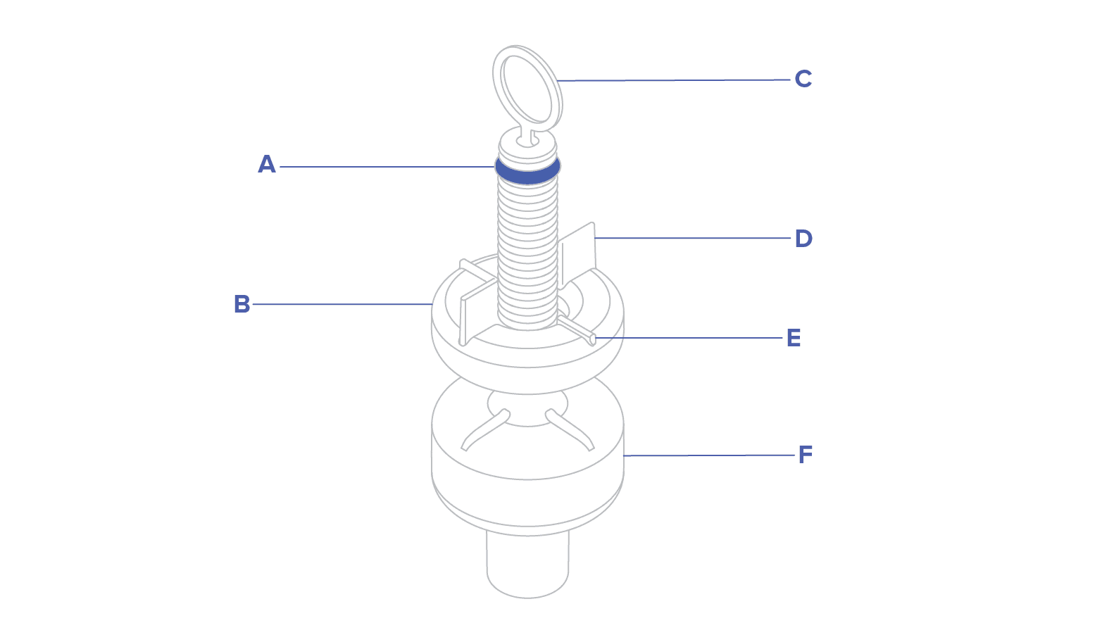

As the resin concentration of the IPA increases, the weight (F) on the hydrometer floats higher, and the stem and O-ring (A) on the hydrometer rise. When properly calibrated using fresh IPA, the O-ring (A) on the hydrometer should be level with the short wings (E) on the float (B). The hydrometer indicates when the resin concentration of IPA reaches 10–12%.

  6. Note the alignment of the O-ring (A) relative to the short wings (E) of the float (B). If the O-ring (A) is higher than the tall wings (D), replace the IPA.
Position of float in fresh IPA.
Position of float in used IPA.
Left: Position of float in fresh IPA.
Right: Position of float in used IPA.
