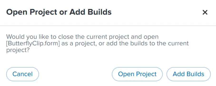

Starting with PreForm 3.62.0, PreForm supports projects—you can set up builds across different printers and materials, switch between them from the new project panel, and move parts freely as your project plan evolves. On PreForm 3.62.0 or later, opening a FORM file gives you the option to to open it as a new project (overwriting the current project and any builds it contains) or add the build or builds in the FORM file to your current project. Note that while you can open multiple model files at once, you can only import one FORM file at a time this way.

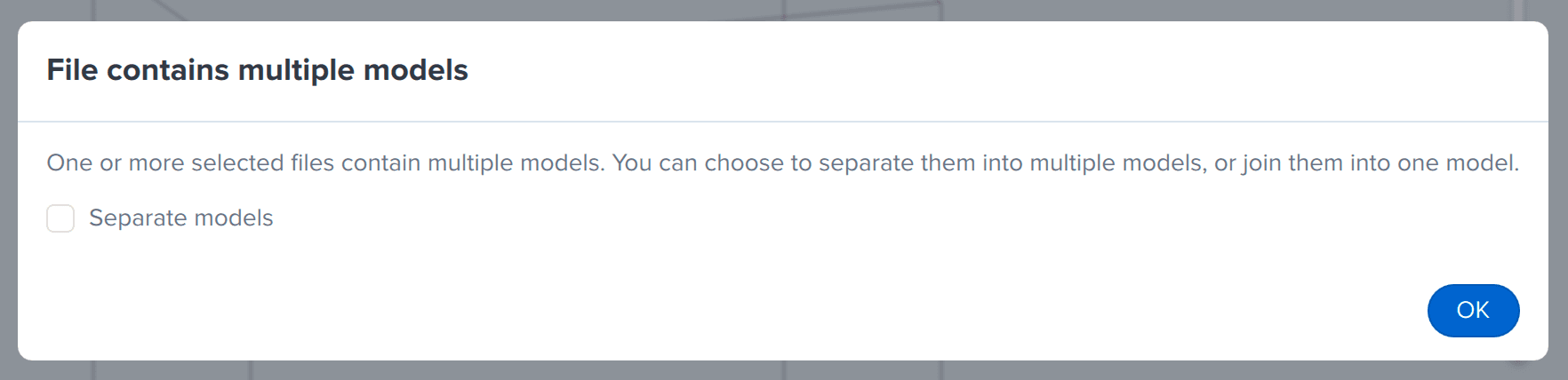

Importing an assembly into PreForm
Starting with PreForm version 3.52.0, you can import an assembly and print it either as a single part or as its constituent parts.
Note:
For PreForm to recognize your imported file as an assembly, it must be in a format that supports assemblies, such as STEP, SLDASM, ASM, or IAM. Your modeling software may allow you to export assemblies as a single part in a format such as STL.
To import an assembly into PreForm:
