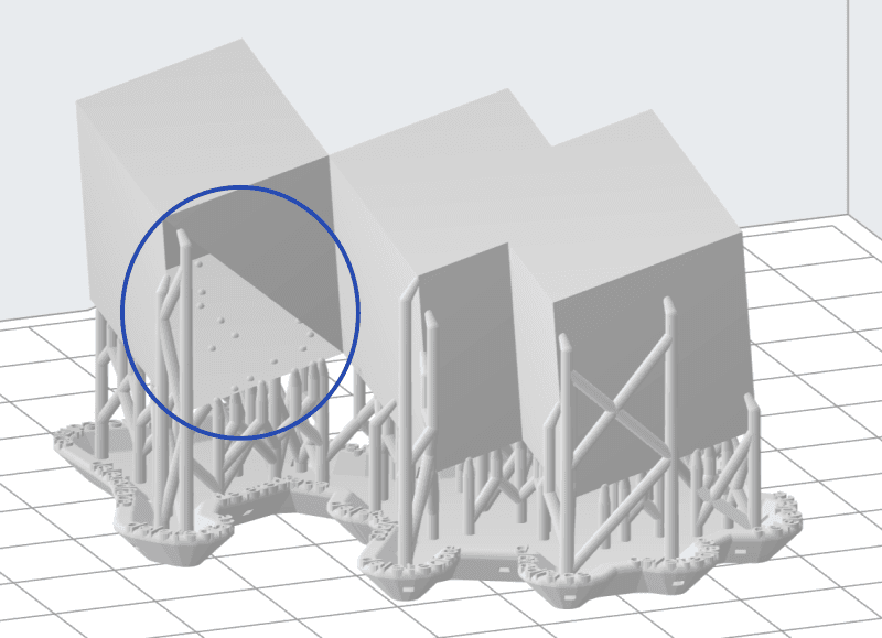

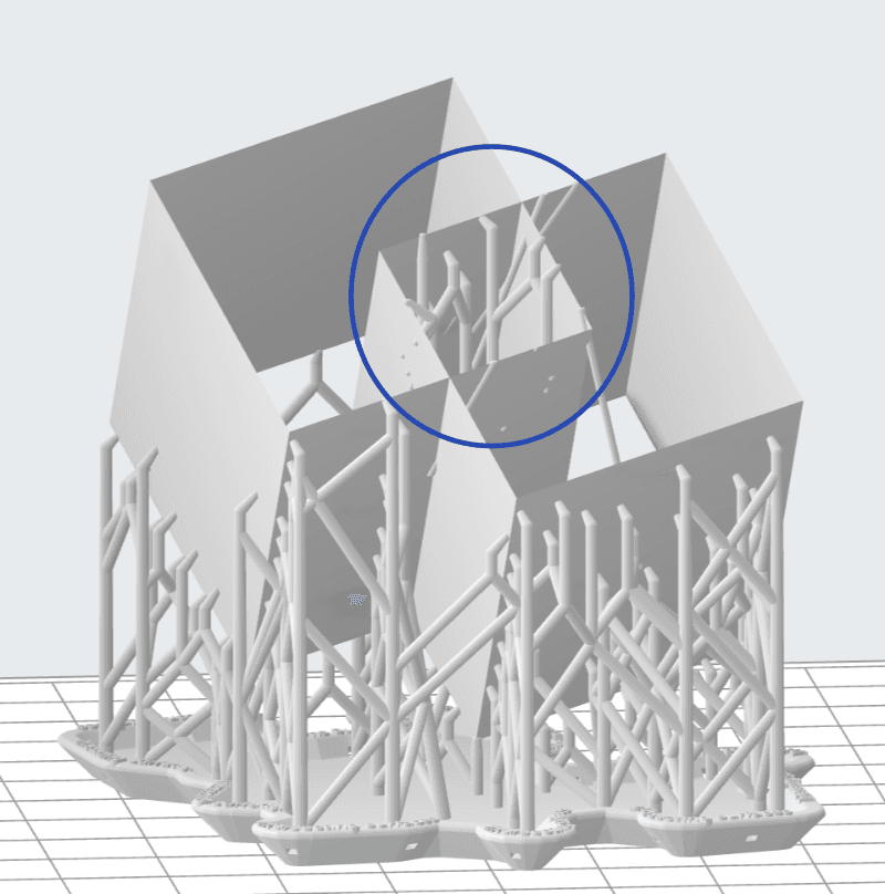

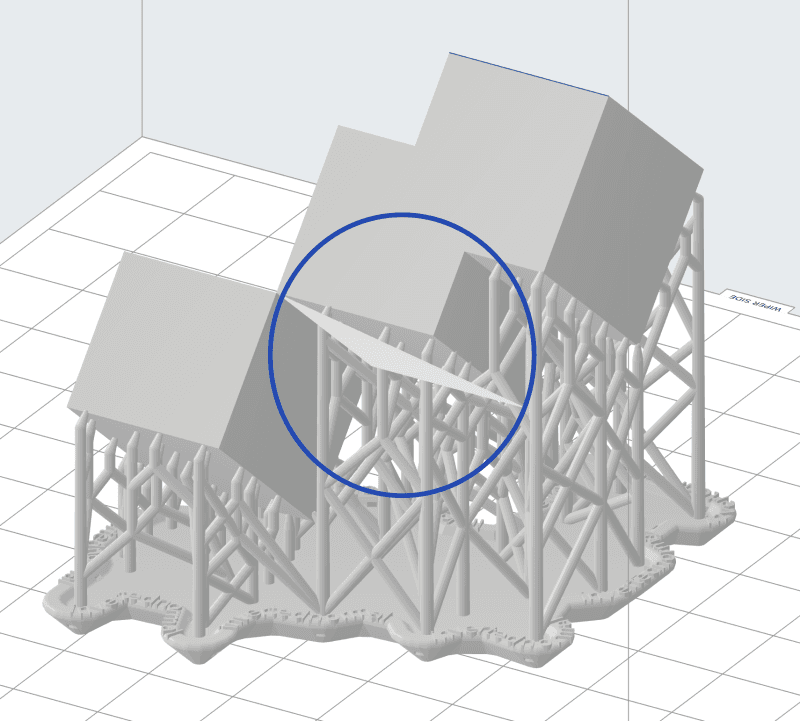

Avoiding two-dimensional features
Extrude features as solids instead of surfaces. During the design phase of your model, you may use planes, sketches, or other two-dimensional features that have zero thickness. 3D design packages allow these features during the modeling of a part, but they cannot physically be printed. A feature without thickness cannot exist in 3D space.
Tip:
PreForm attempts to repair models with integrity issues, but may rebuild the area incorrectly. Avoid unforeseen errors by defining the thickness of each feature in your model during the design phase.
An edge that is shared by more than two faces is non-manifold. Unexpected behavior can occur at these intersections, causing the support structure to pass through the model itself.

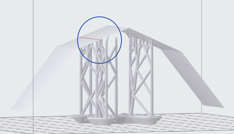

Correcting surface normal orientation
Every face has two sides: an inside and an outside. An accurate, complete model has all of its surface normals pointing outwards. If a face is reversed and the “inside” is pointing outward, then the end result can resolve itself as a hole in your model.
