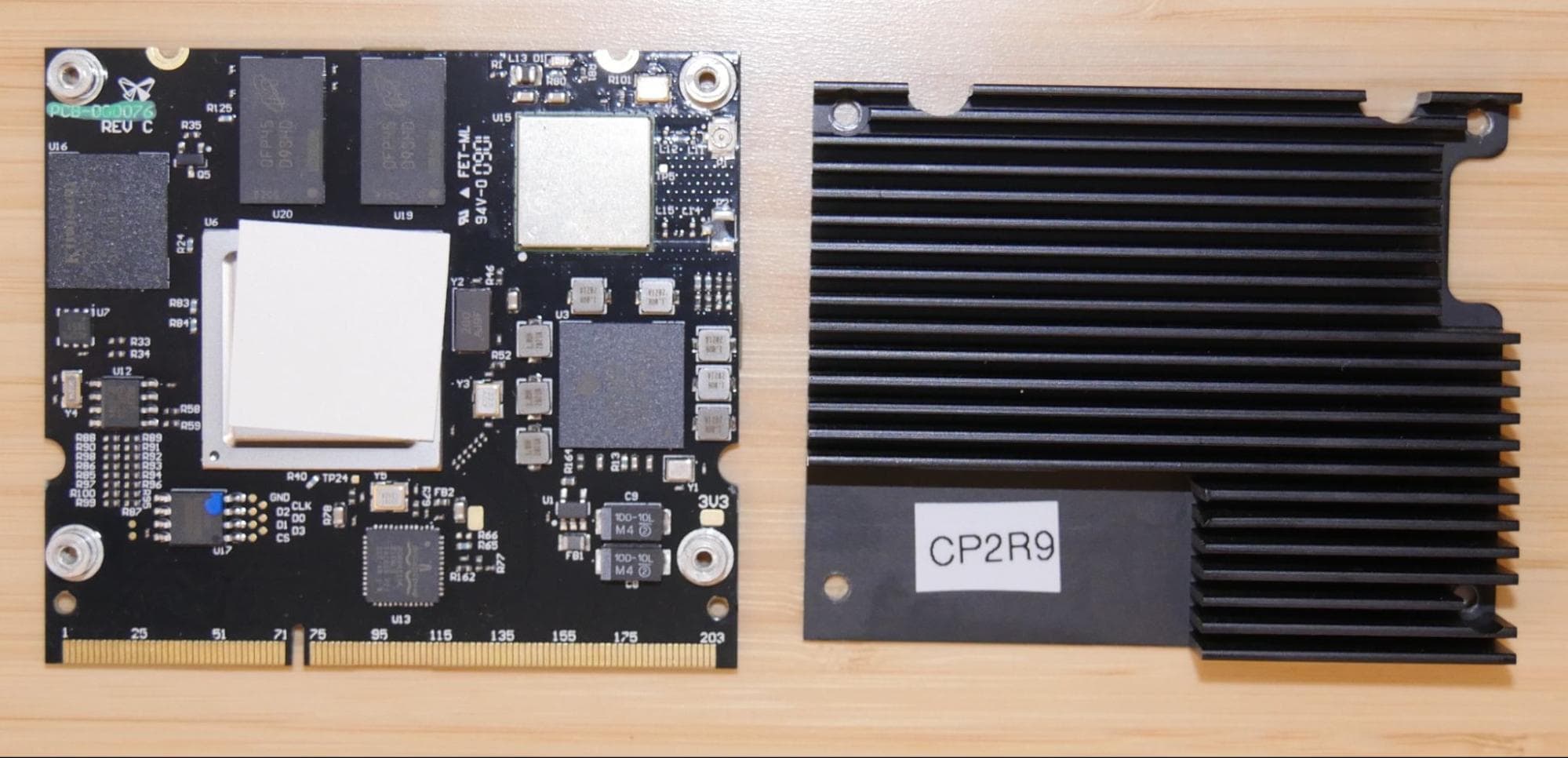

The Form Cure L V1 has Wi-Fi functionality for receiving firmware updates and uploading log files. Wi-Fi can be turned off via the machine’s touchscreen, but depending on your organization's security requirements, you may need to physically remove the Wi-Fi hardware before using the device. This hardware includes a component on the system on a module (SOM) plugged into the motherboard as well as a Wi-Fi antenna plugged into the SOM.

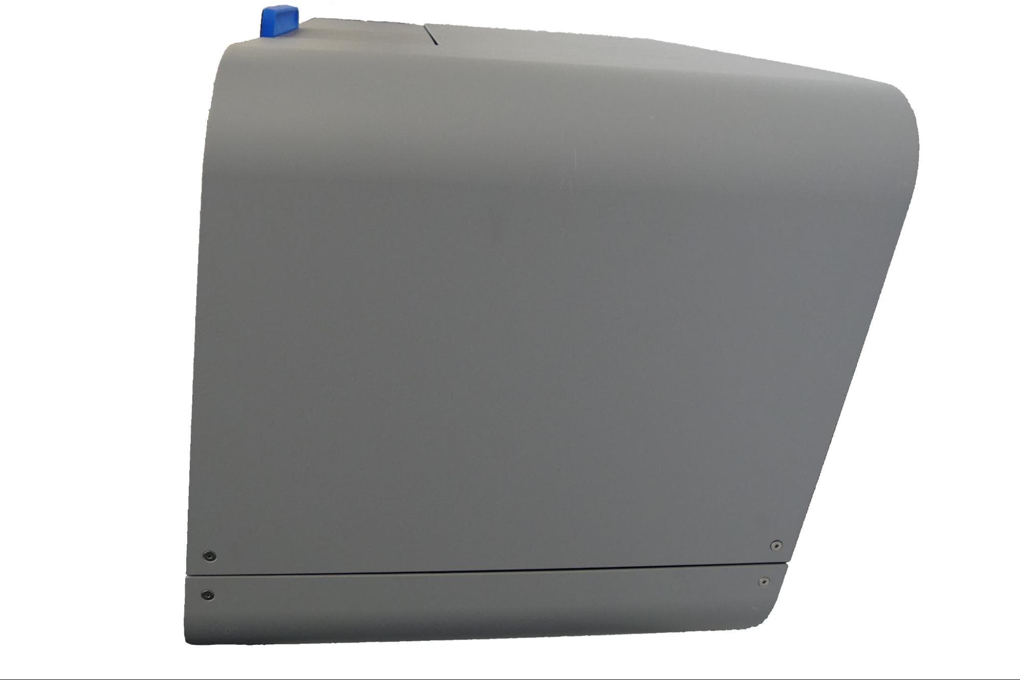

Removing the top shell

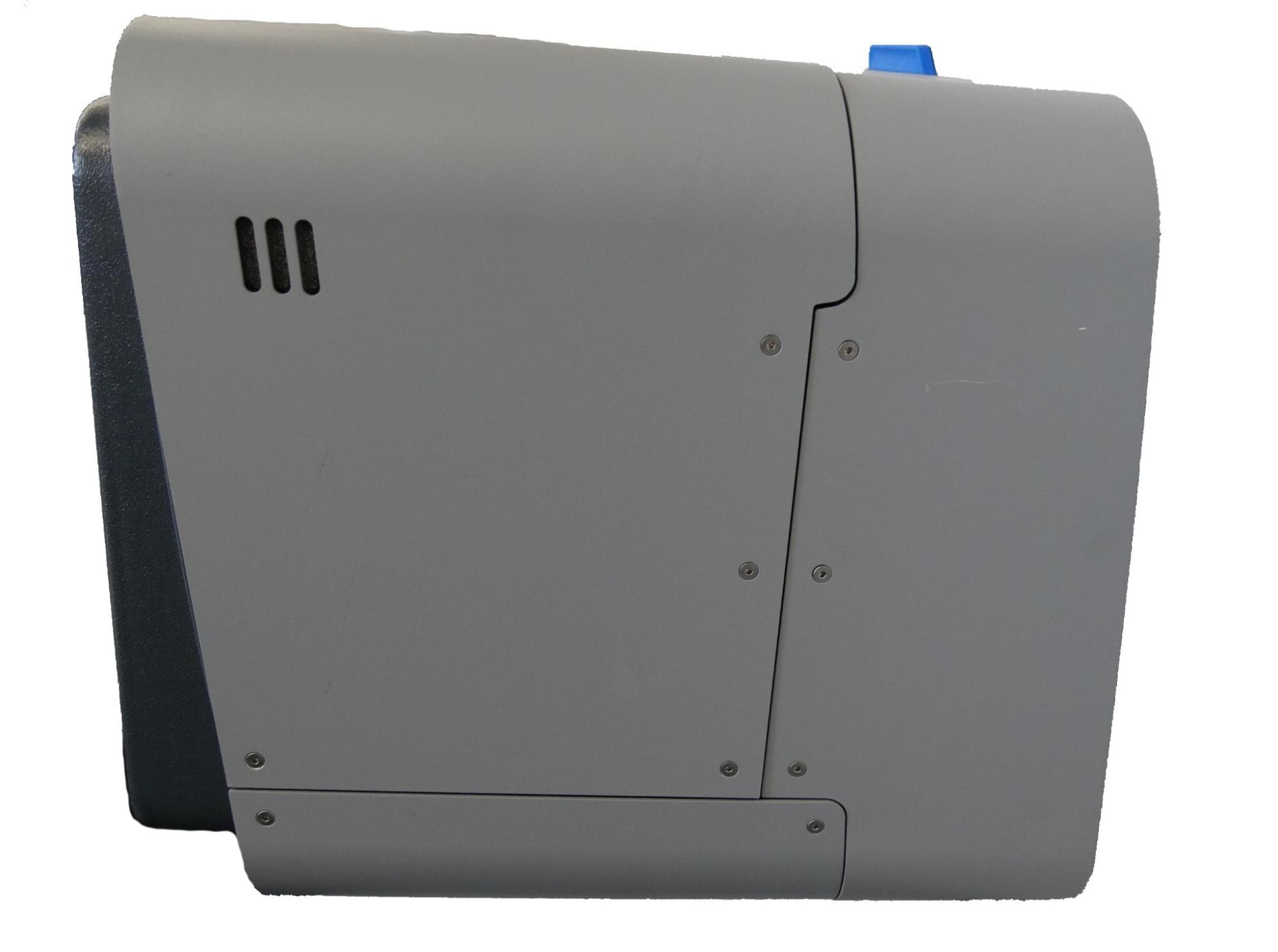

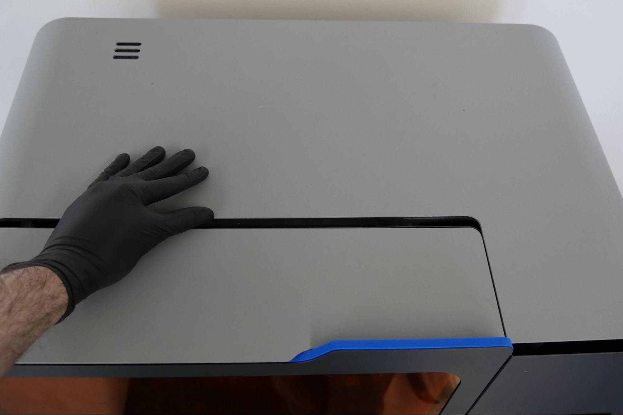

The top shell is secured to the frame of the machine with six hex screws. When facing the front of the Form Cure L, two screws are located on the right side and four are located on the left. Use a 2.5 mm hex driver to unscrew and remove the screws.
Step 2: Remove the top shell

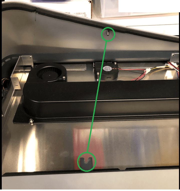

Slide the top shell towards the back of the machine to unhook it from the frame. Lift the top shell away from the machine and set it to the side.

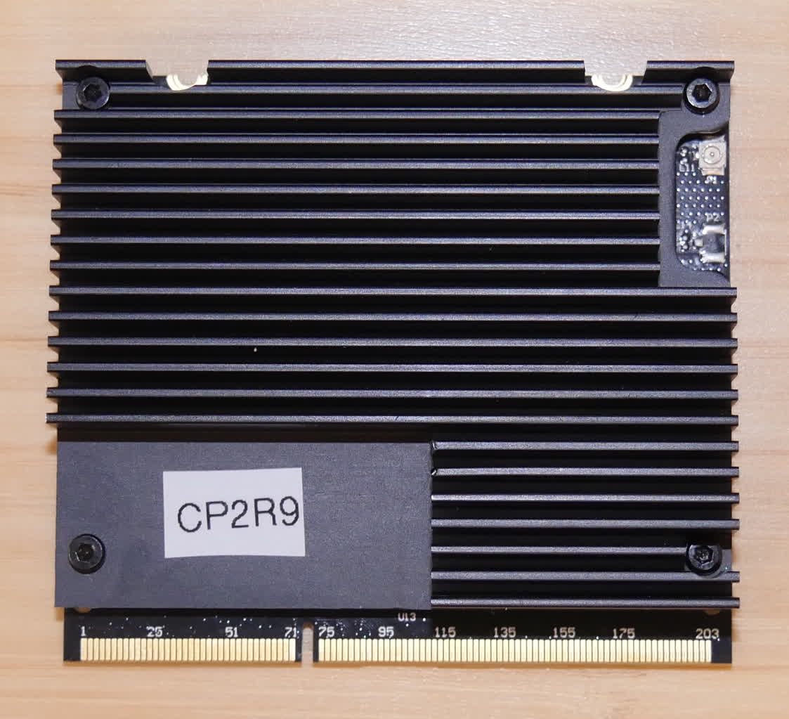

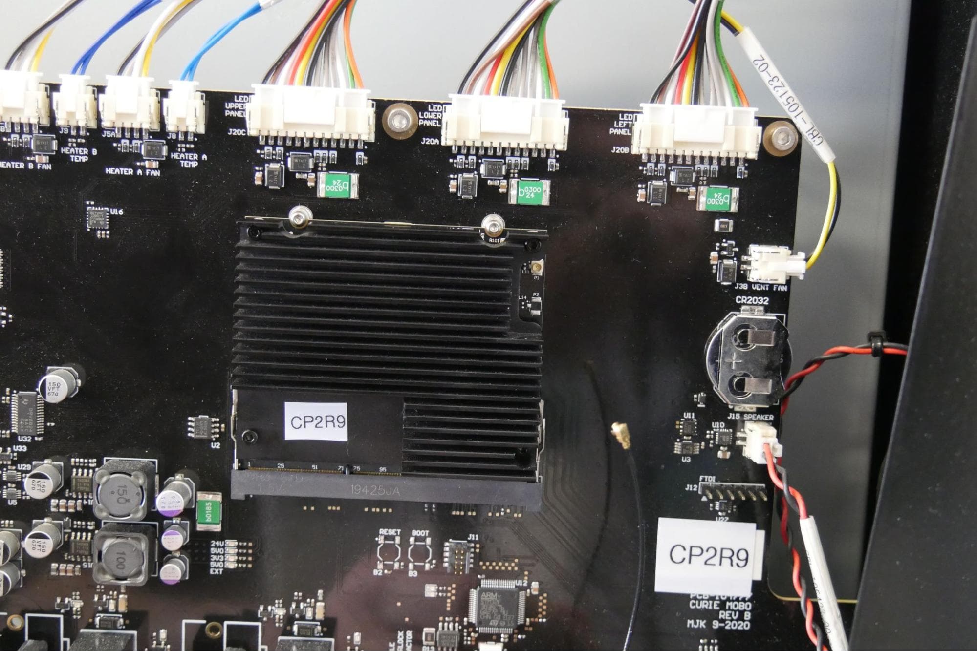

The Wi-Fi antenna is plugged into the SOM at the top- right corner of the board. The connector is accessible through a cutout in the heatsink. Grip the antenna’s connector by its housing and disconnect it from the SOM. Do not pull on the antenna itself.

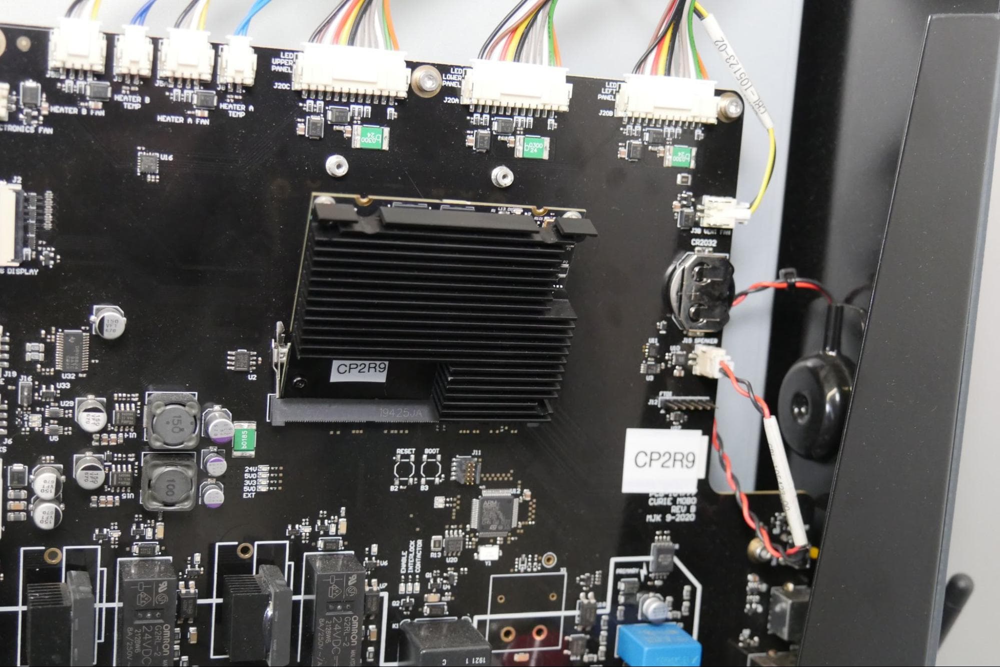

The SOM is plugged into the motherboard and secured with two screws on the top side of the module. Using a 1.3 mm hex driver, loosen and remove two SOM retention screws. Set the screws aside.
Step 2: Unlatch the SOM
Step 2: Unlatch the som

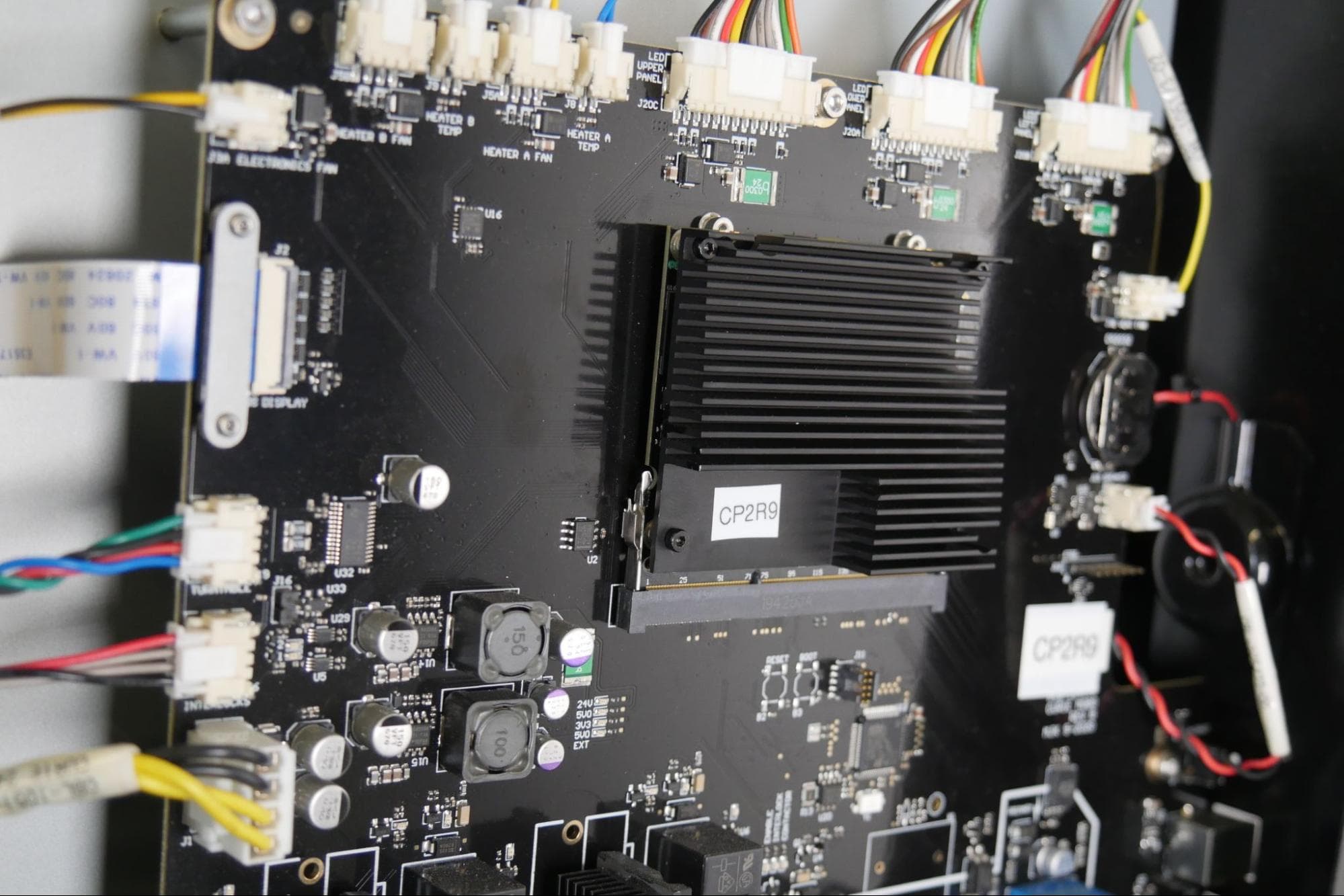

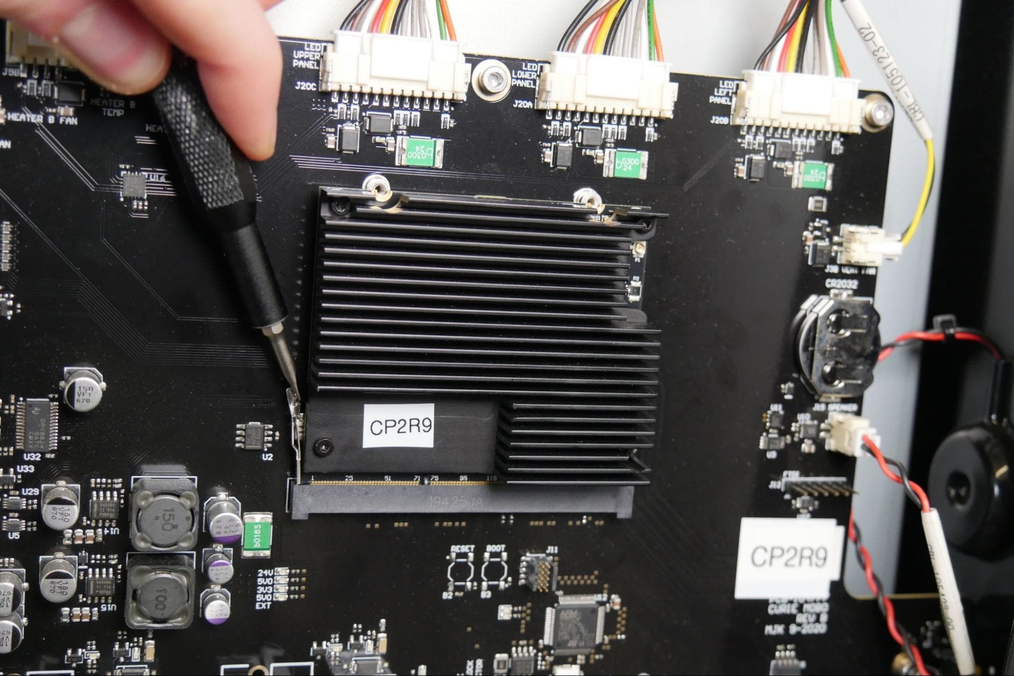

The SOM is additionally secured via two latches: one on the left side of the board and one on the right.
Using fingernails or a small flat-blade screwdriver, open the two latches securing the SOM into its socket. The SOM may tilt forward once you have opened both latches.
Step 3: Remove the SOM
Step 3: Remove the som

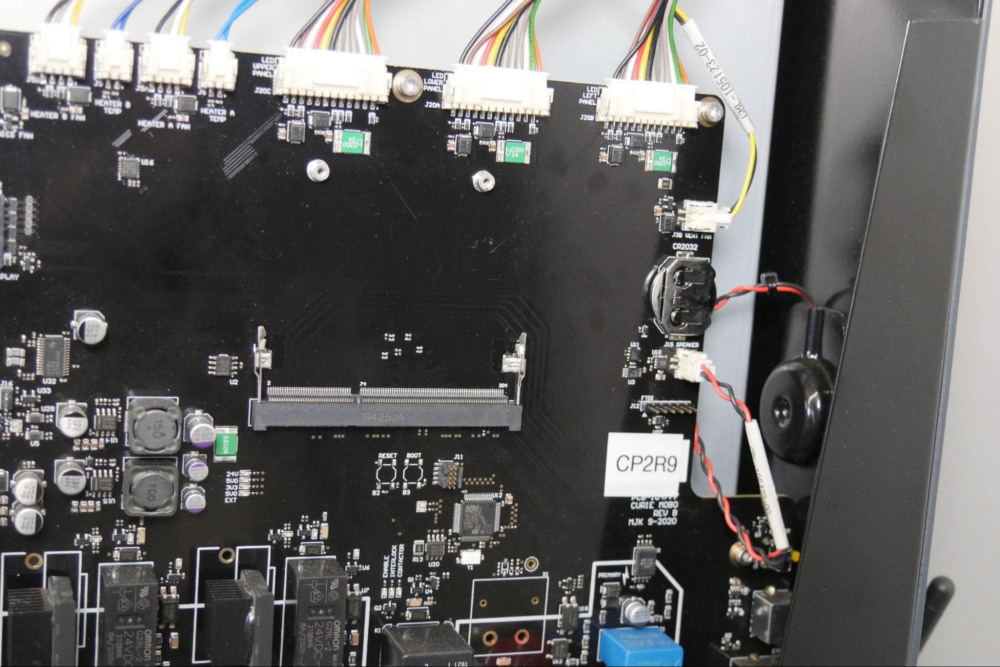

Lift the SOM up from the edge opposite its connector and carefully pull it free from the socket. Place the SOM on a static-free surface.

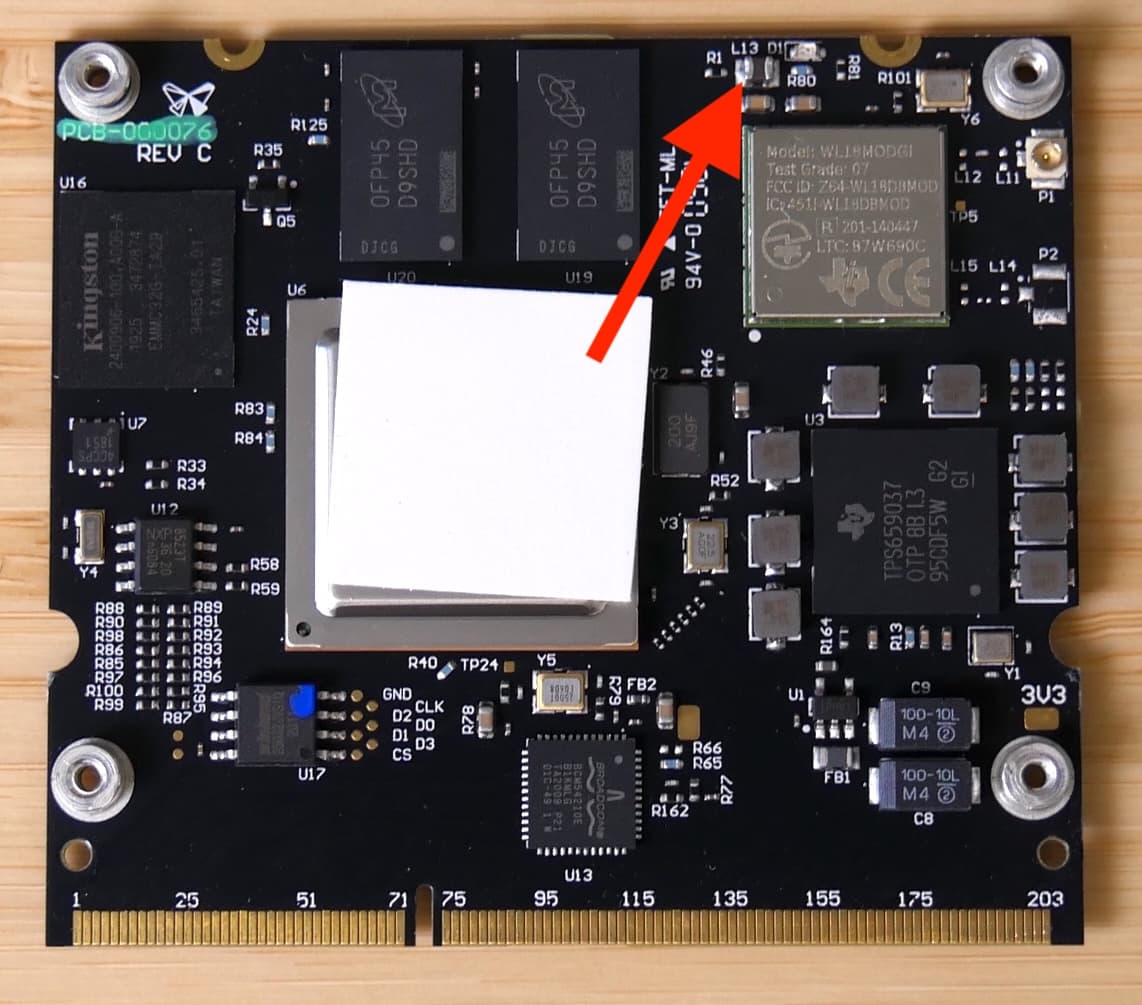

Overview: After removing the SOM from the machine, remove component L13.
Step 1: Unscrew and remove the heatsink
Using a 1.5 mm hex hex driver, unscrew and remove the four screws securing the heatsink to the SOM. Set the screws aside. Remove the heatsink and set it aside.
Step 2: Remove component L13
Using hot tweezers or other appropriate SMD soldering equipment, remove component L13 from the SOM. If you plan to reverse this procedure in the future, save component L13 for later reuse.

Step 1: Reinstall the heatsink

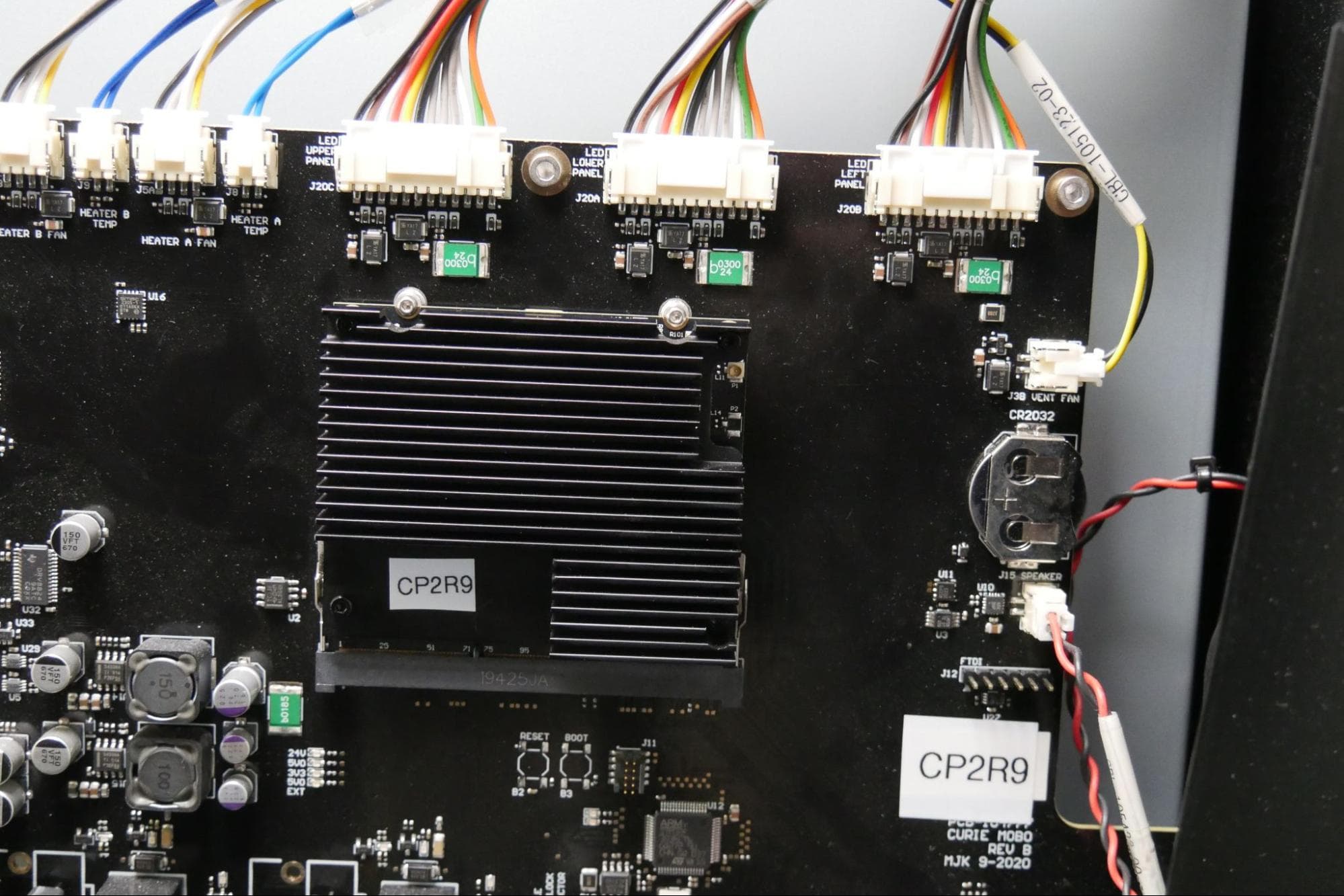

Reinstall the heatsink onto the SOM, making sure the thermal pad on the bottom of the heatsink covers the processor (the largest chip on the board, labeled U6). Ensure that the cutout on the edge of the heatsink allows access to the Wi-Fi antenna port and that the screw holes in the heatsink align with the holes in the SOM.
Insert one heatsink retention screw into each of the four screw holes in the heatsink. Using a 1.5 mm hex driver, tighten the four screws until finger tight. Do not overtighten.

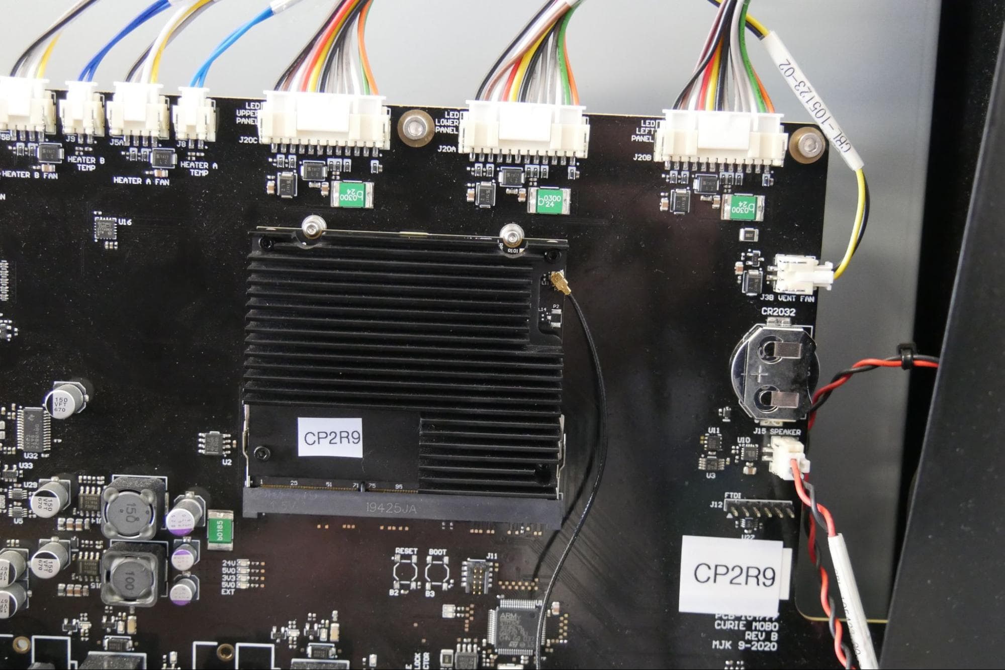

Insert the SOM into its socket on the motherboard. Close the two latches. Insert one SOM retention screw into both of the screw holes on the top edge of the SOM. Using a 1.3 mm hex driver, tighten the two screws until finger tight. Do not overtighten.

Lower the top shell onto the Form Cure L. Make sure you do not pinch any wires between the shell and the frame of the machine. Slide the top shell towards the front of the machine to hook it into place. Check that the screw holes in the top shell line up with the corresponding screw holes in the frame of the machine.
