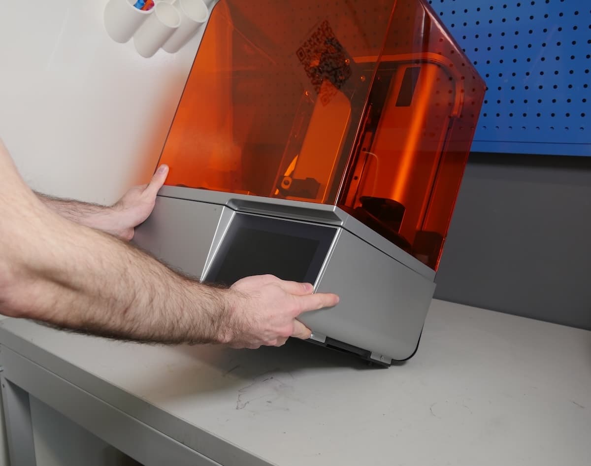

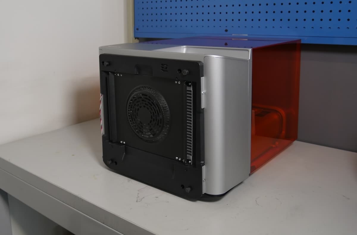

Step 1: Position the printer
Tilting the Form 4 printer onto its back
Form 4 printer resting on its back
Ensure that the build platform, resin cartridge, resin tank, and mixer have been removed from the printer to prevent damage. Carefully rotate the printer so that it is resting on the back surface with the bottom facing you. Leave at least 15 cm (6 in) of clear tabletop in front of the printer when it is lying down.

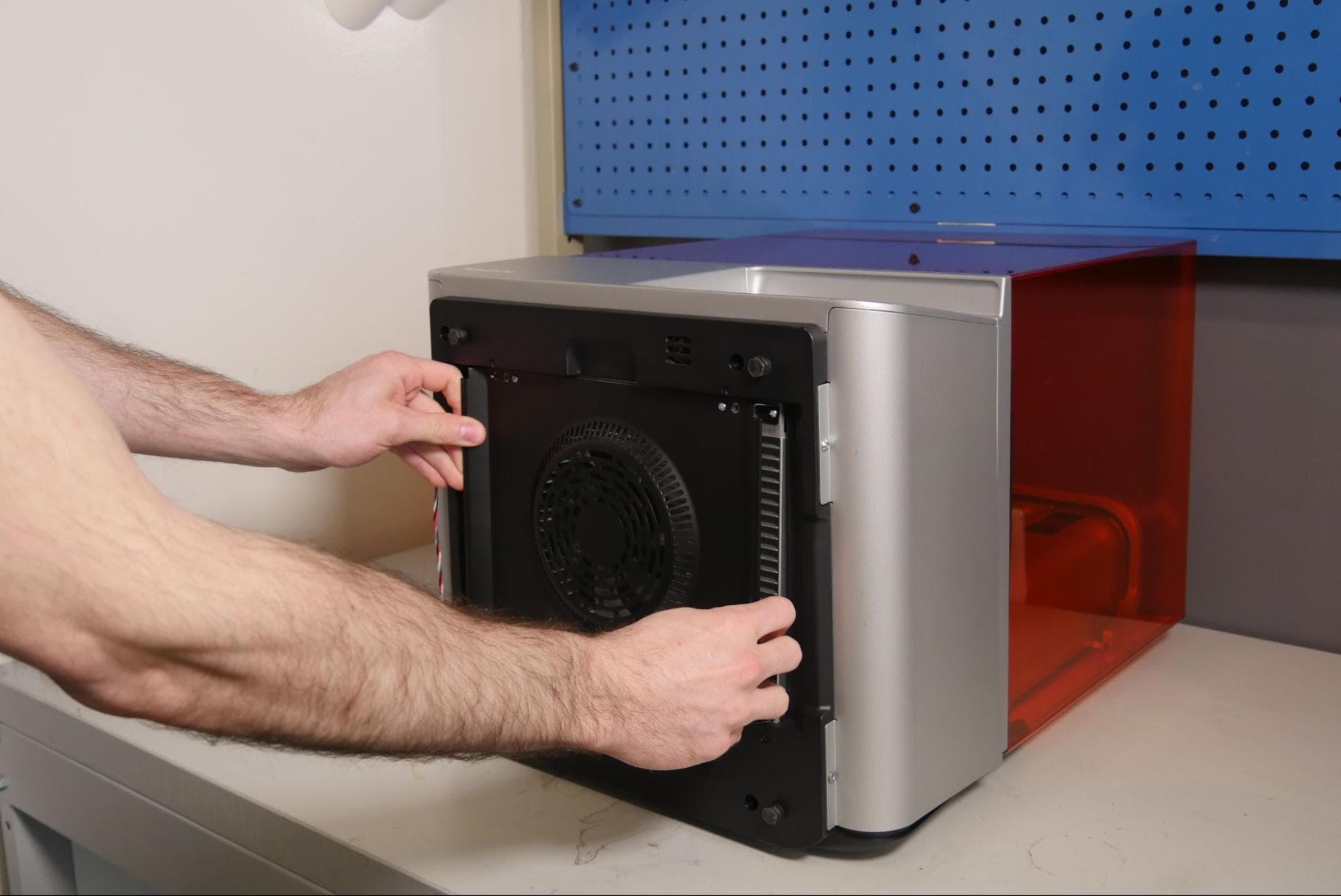

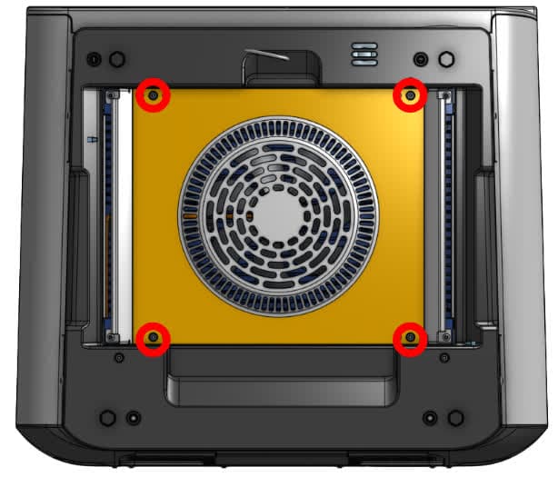

Step 2: Remove the Backlight Unit screws
Form 4 Backlight Unit screws location 1
Form 4 Backlight Unit screws location 2
Use a 2.5 mm hex driver to remove the four socket cap screws that secure the Backlight Unit to the bottom of the printer. Do not remove the button head screws. Set the screws aside.

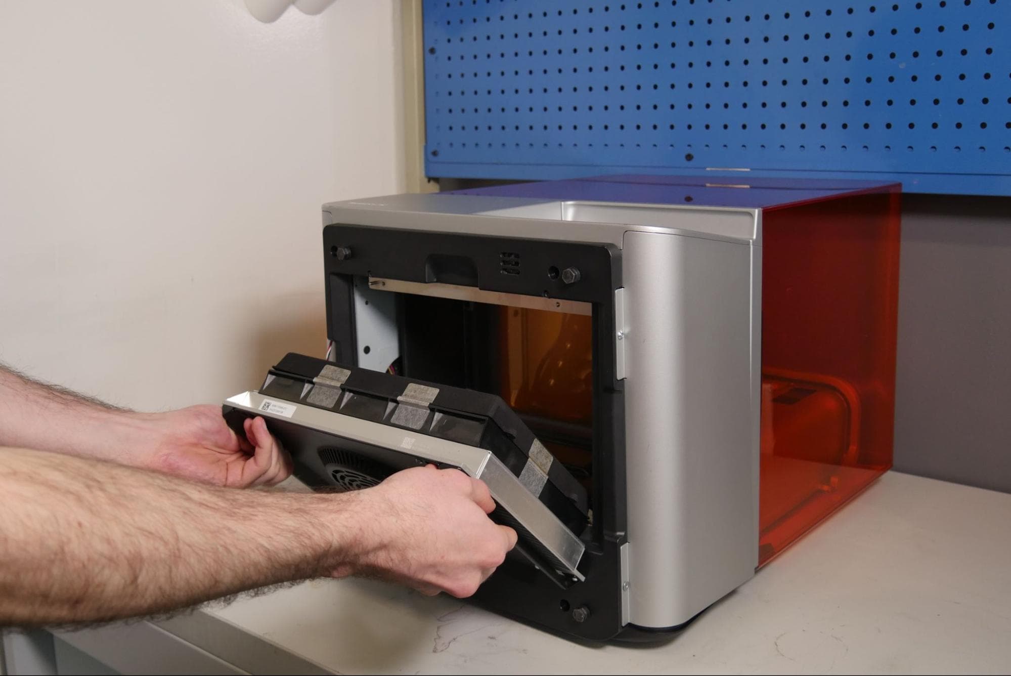

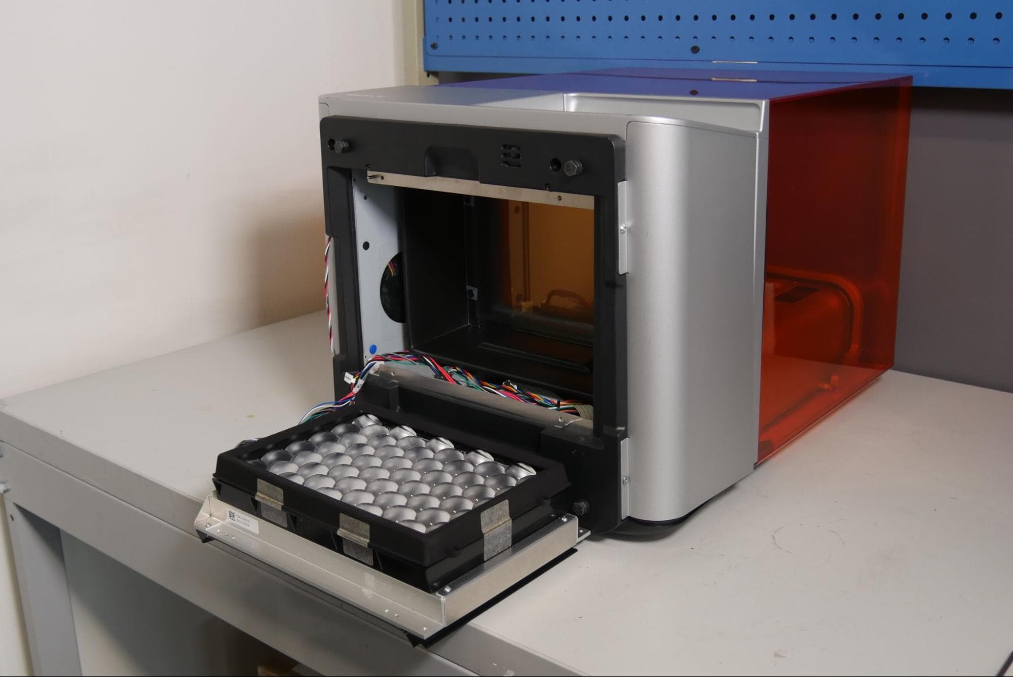

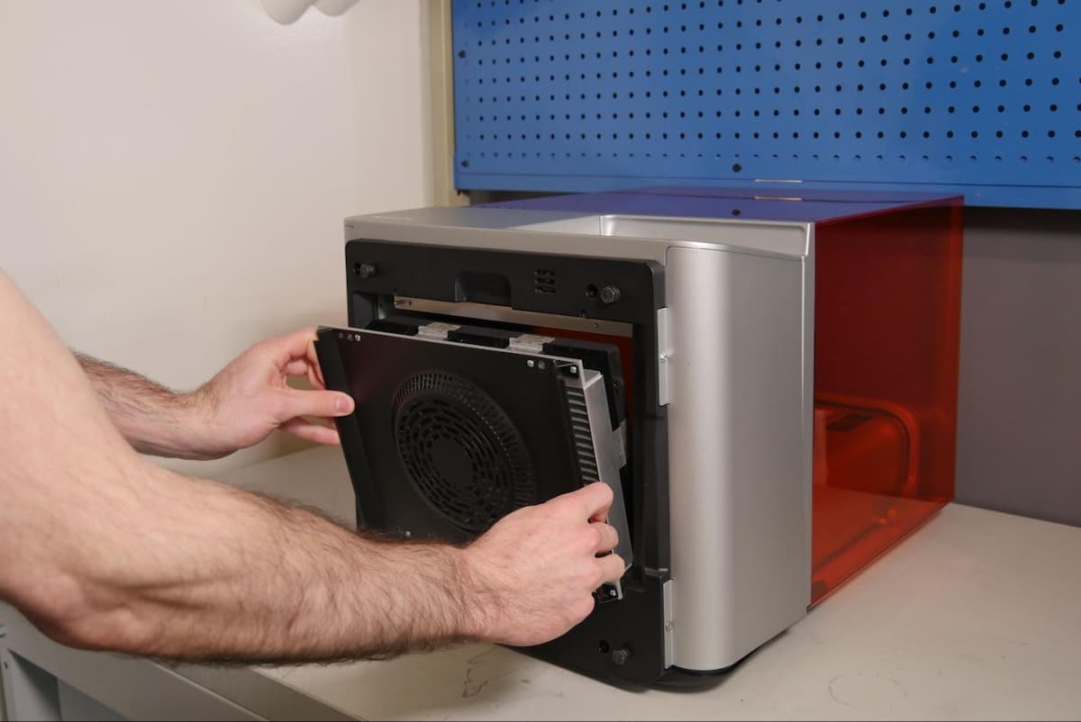

Step 3: Separate the Backlight Unit from the printer
Form 4 Backlight Unit grip handles
Pulling the Form 4 Backlight Unit away from the printer
Form 4 Backlight Unit pivoted open resting on work surface
Grip the two handles on the Backlight Unit. Carefully pull the Backlight Unit away from the printer and pivot it until it rests on the work surface.

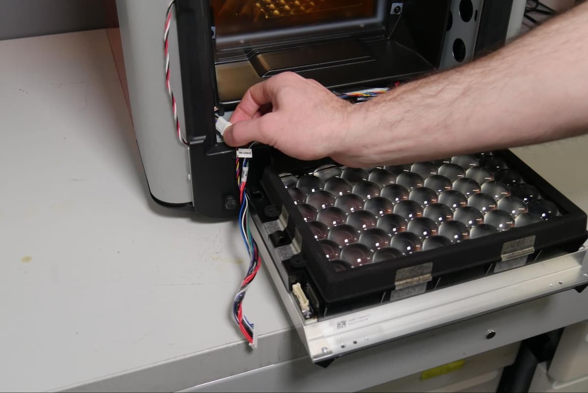

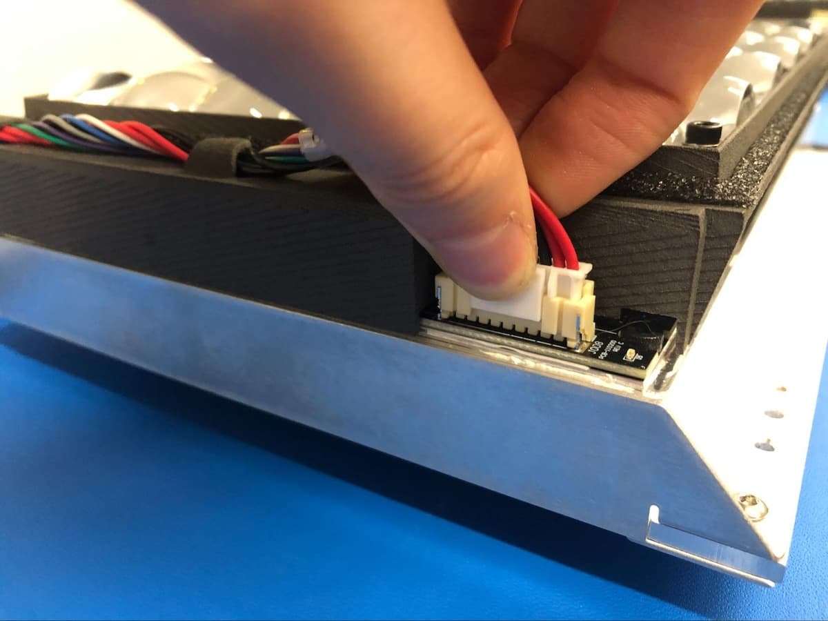

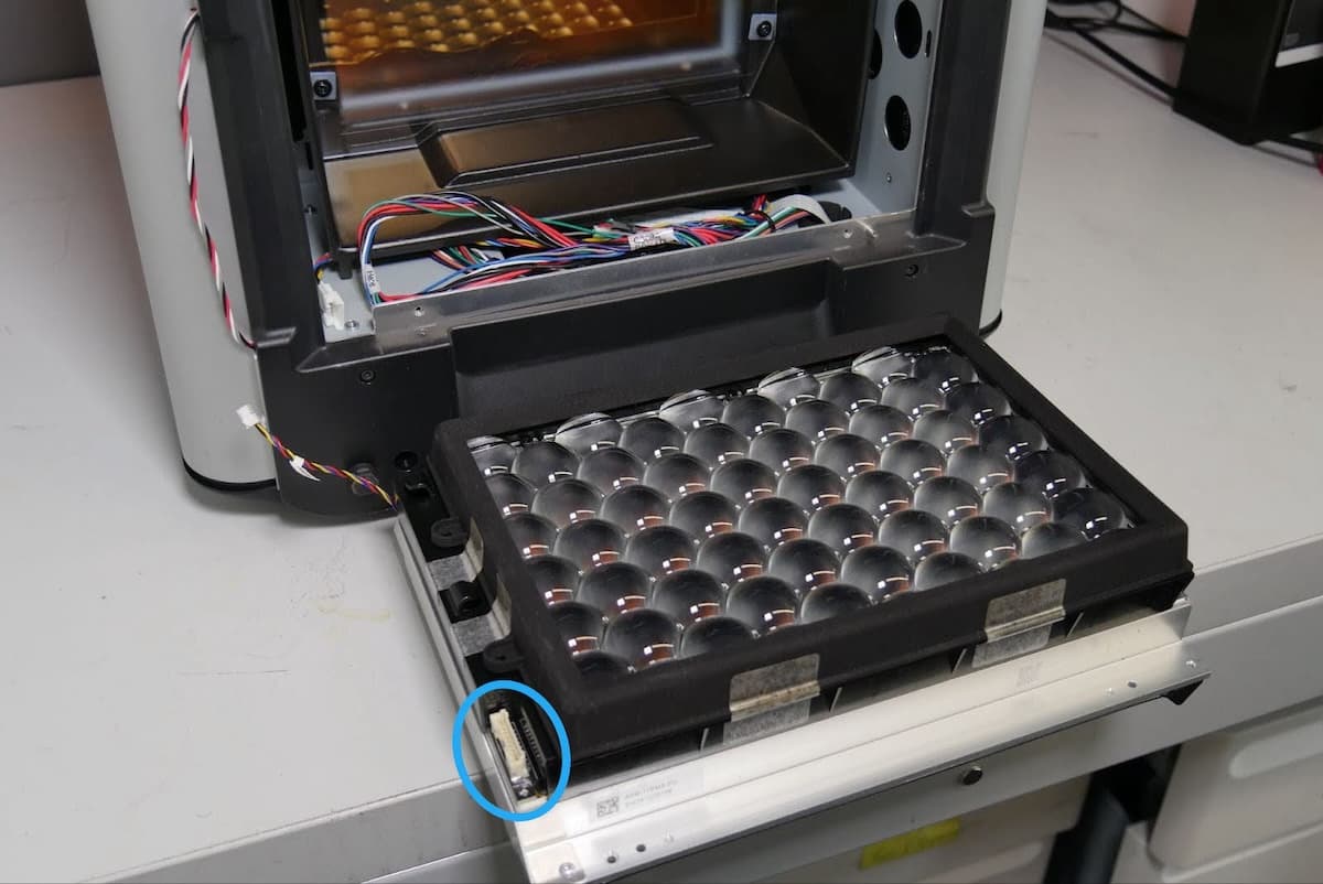

Step 4: Unplug the backlight driver cable
Unplugging the Form 4 backlight driver cable
Hold the connector by its plastic housing and gently squeeze the plastic tab to unplug the backlight driver cable from the Backlight Unit. Do not pull on the individual wires.

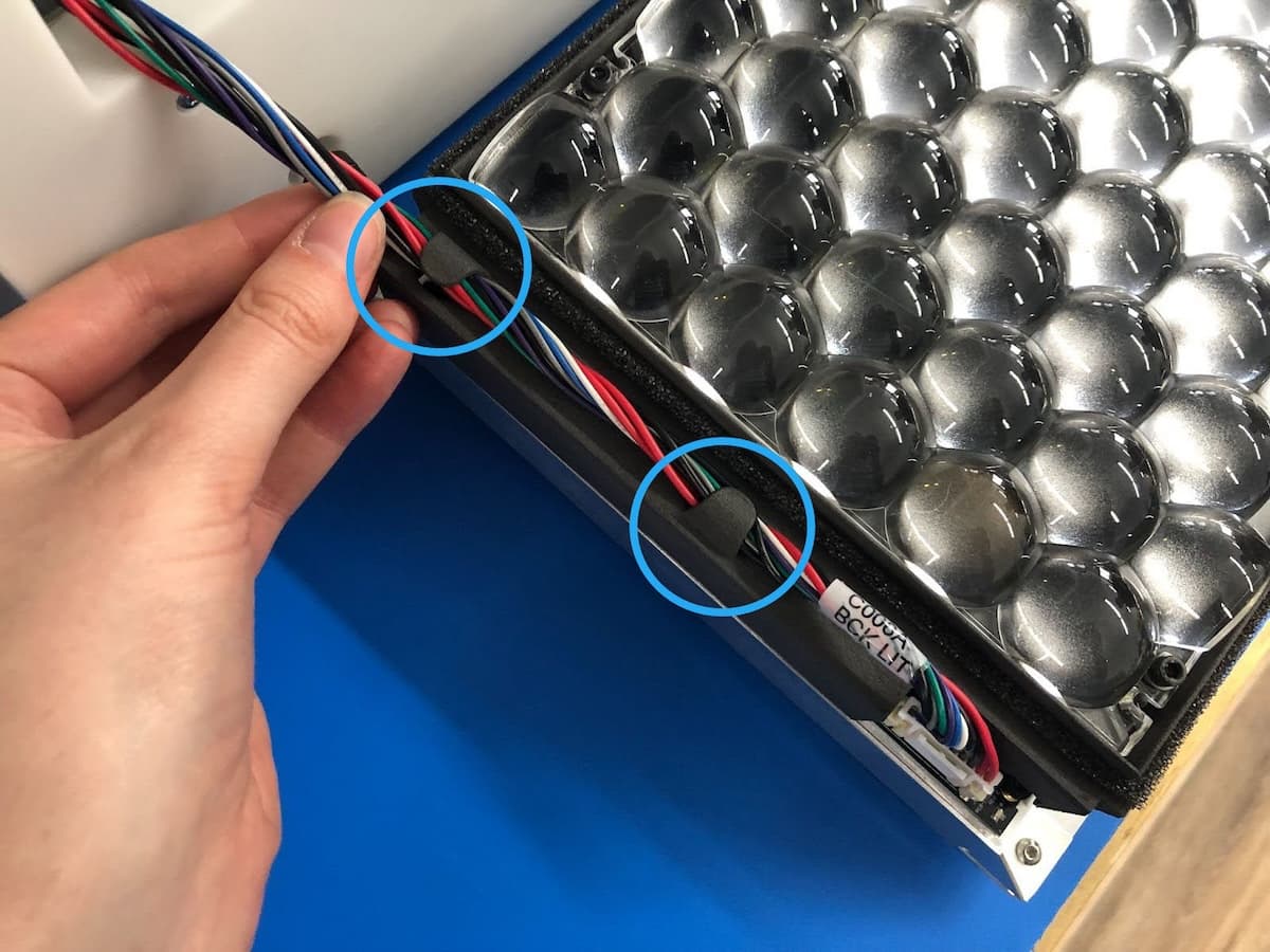

Step 5: Unhook the backlight driver cable
Unhooking the Form 4 backlight driver cable from clips
Unhook the backlight driver cable from the clips along the side of the Backlight Unit.
Step 6: Disconnect the LED fan cable
Disconnecting the Form 4 LED fan cable
The LED fan cable is located in the bottom-left of the optical cavity. Squeeze the plastic retaining clip and unplug the LED fan cable from the printer. Do not pull on the wires.

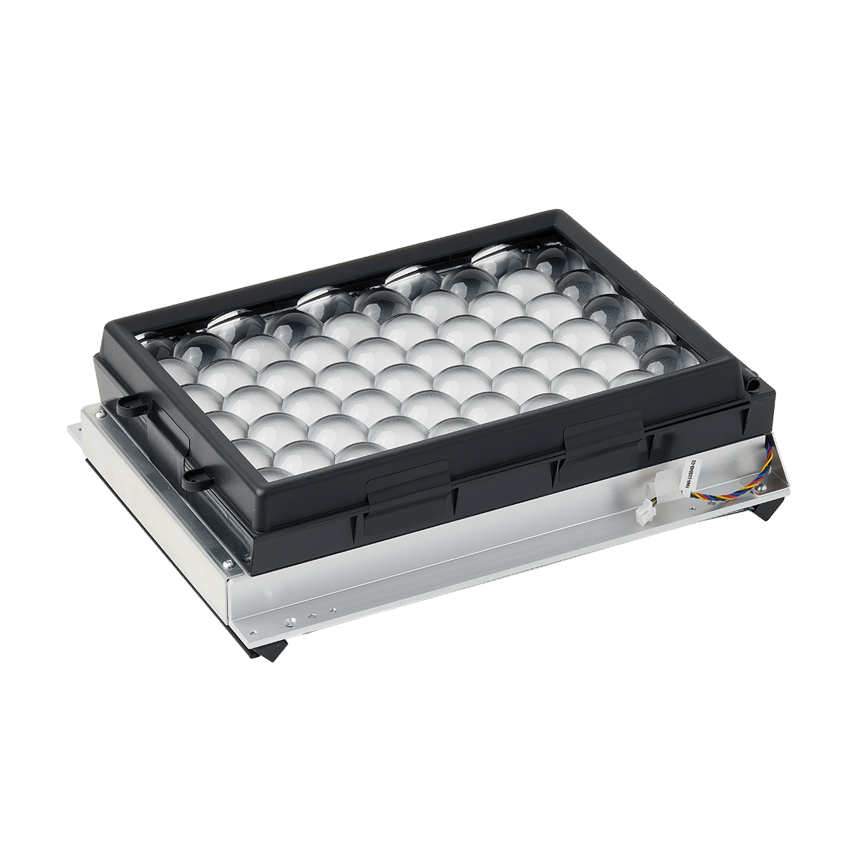

Installing the replacement Backlight Unit
Overview: Connect and install the replacement Backlight Unit.
Step 1: Position the replacement Backlight Unit in front of the printer
Orienting the Form 4 replacement Backlight Unit in front of the printer
Place the replacement Backlight Unit on the workspace in front of the printer. Orient the Backlight Unit with the backlight driver cable connected at the front-left.

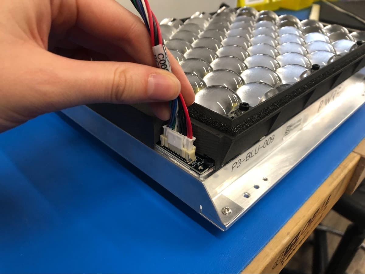

Step 3: Connect the backlight driver cable
Connecting the Form 4 backlight driver cable to the Backlight Unit
Connect the backlight driver cable to the Backlight Unit. The connector makes an audible and tactile click when secured.

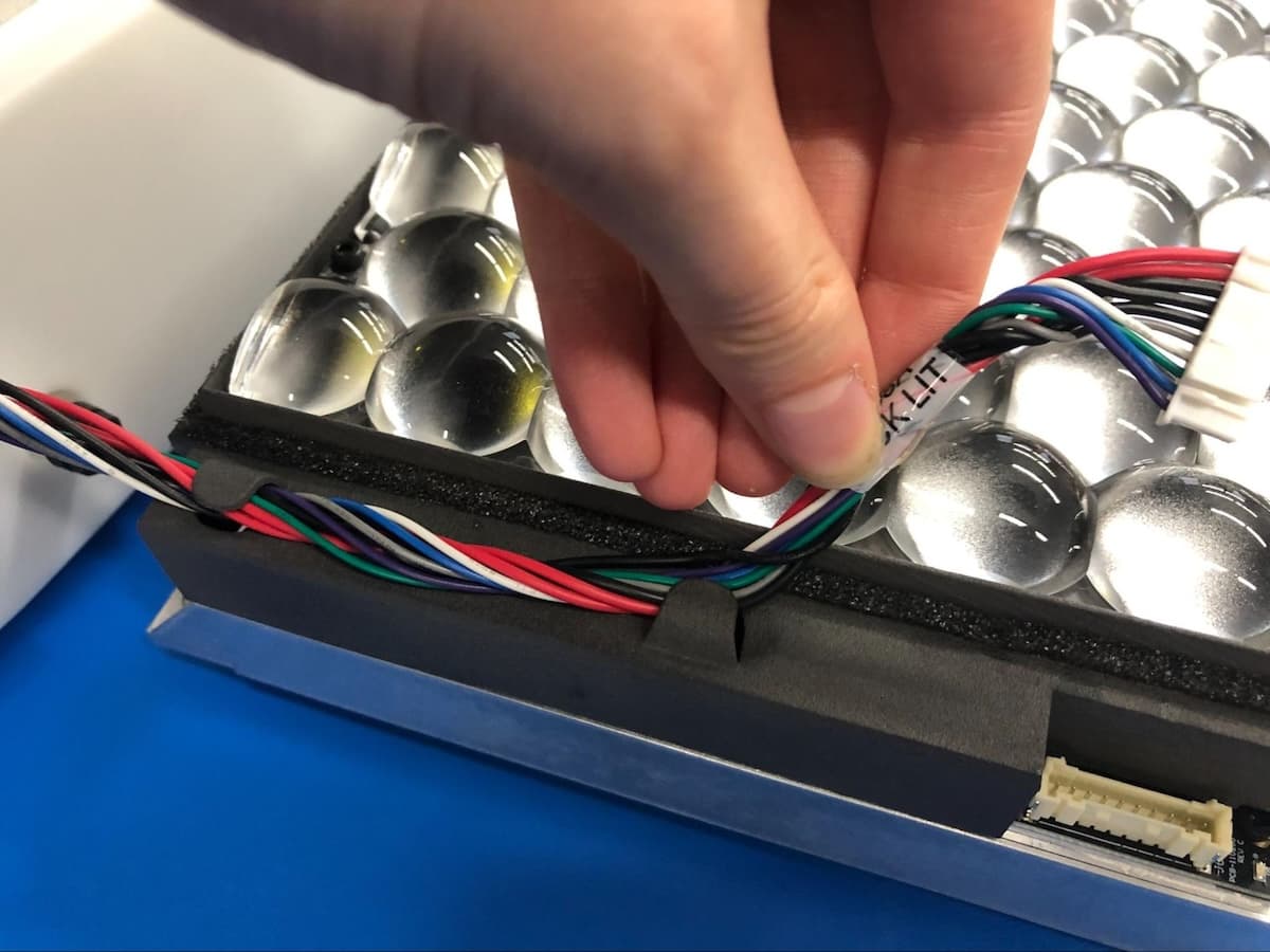

Step 4: Route the cable
Routing the Form 4 backlight driver cable along the Backlight Unit
Route the cable along the edge of the Backlight Unit and push it gently under the cable clips until the cable is flush with the surface of the Backlight Unit.

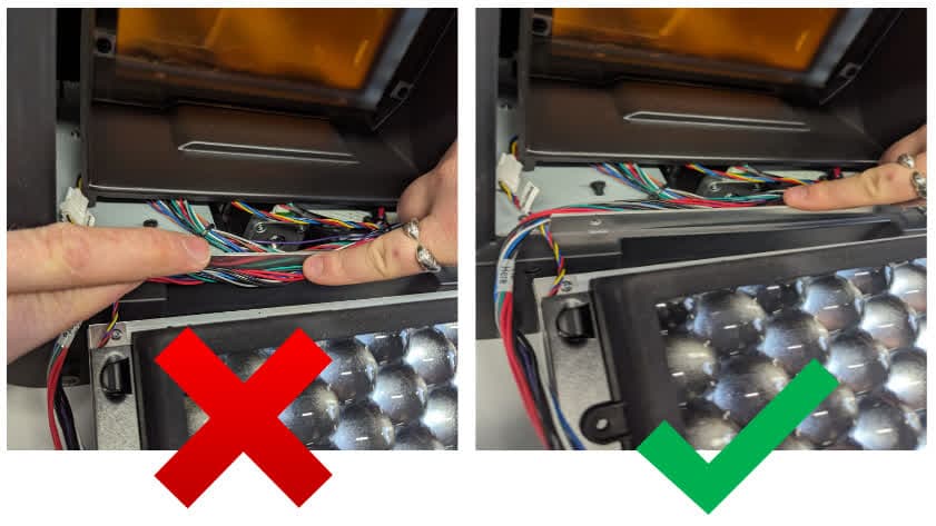

Step 5: Organize cables
Organizing Form 4 internal cables alongside the metal tab in the optical cavity
Some internal cables may have moved during the repair procedure. Move any loose cables so they are positioned alongside the metal tab in the optical cavity.
