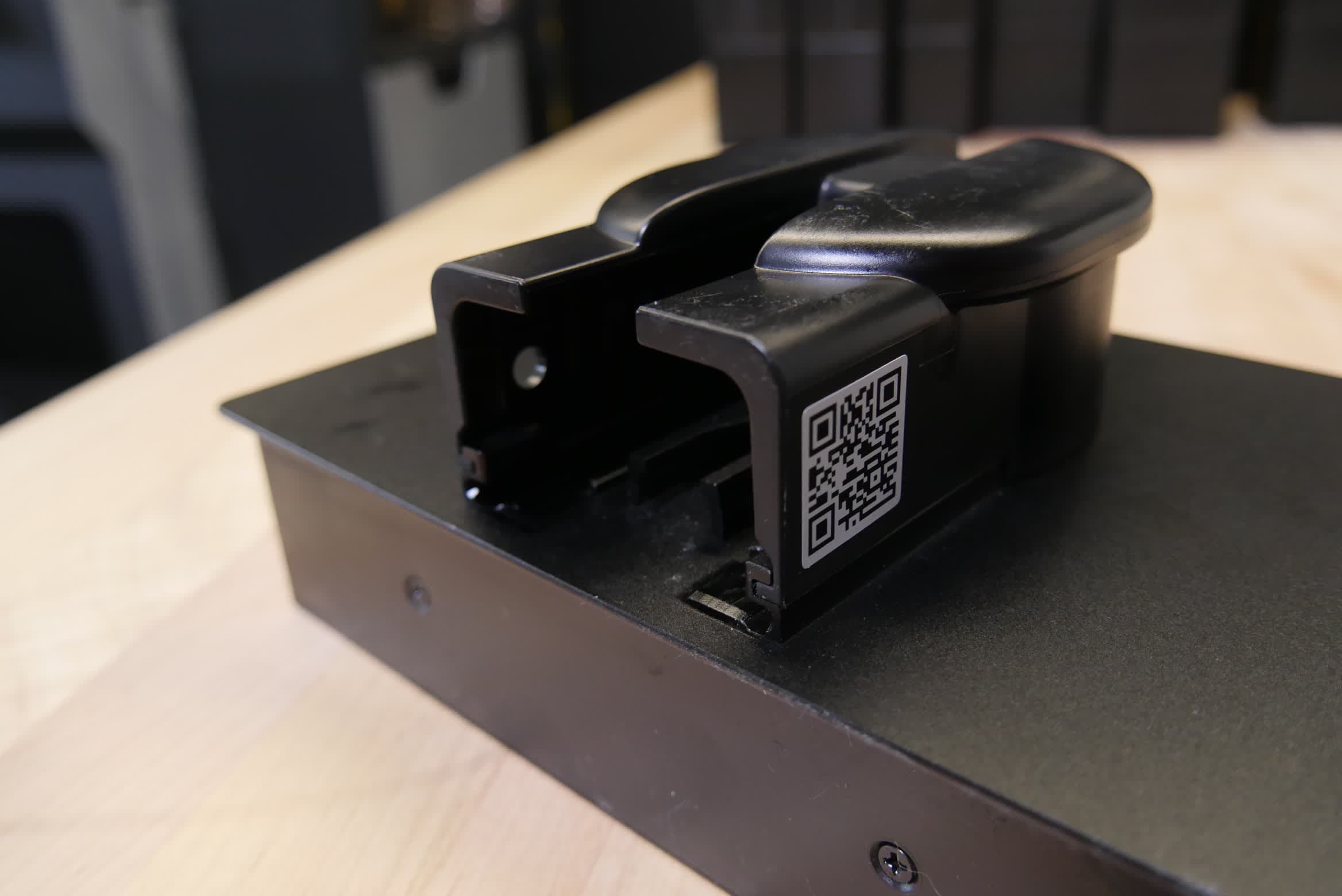

The Form 4 build platform has a plastic handle that slides onto to build platform mount in the printer, allowing the build platform to be locked in place during printing. If the handle is damaged or broken, the build platform cannot be used.
Use this guide to remove and replace the handle on a Form 4 build platform.

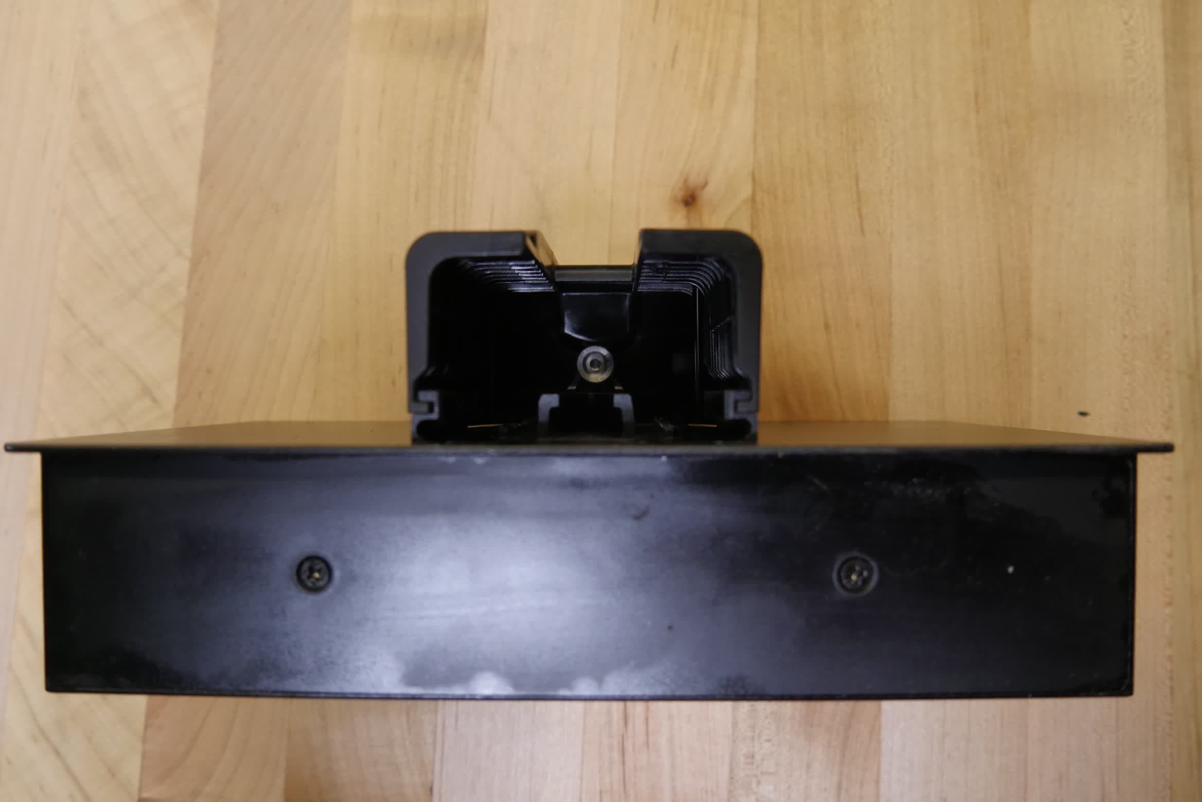

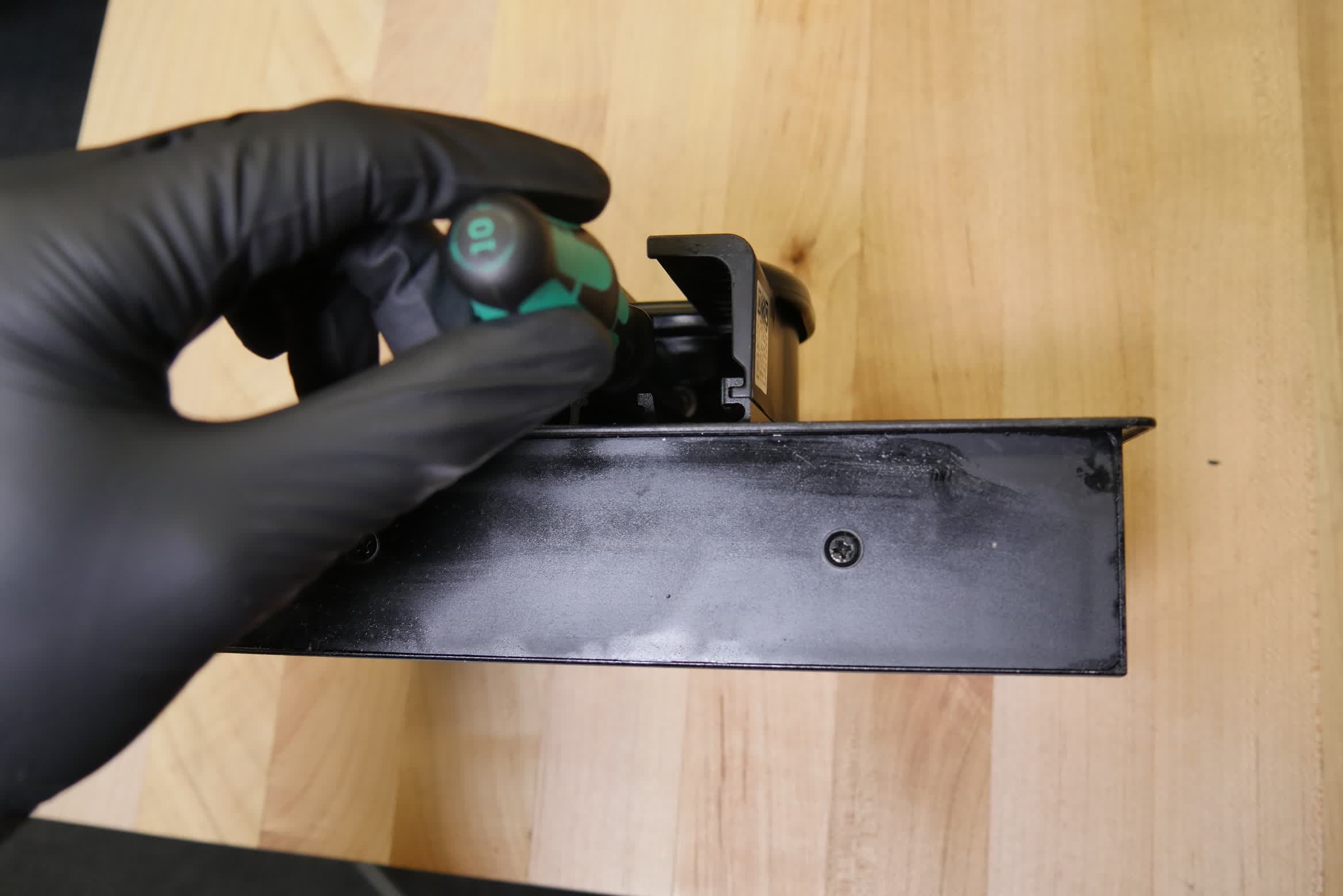

Step 1: Remove the build platform handle retention screw
The build platform handle is secured to the build platform body using a single T8 Torx screw, located inside the handle. Using a T8 Torx driver, loosen and remove the screw.

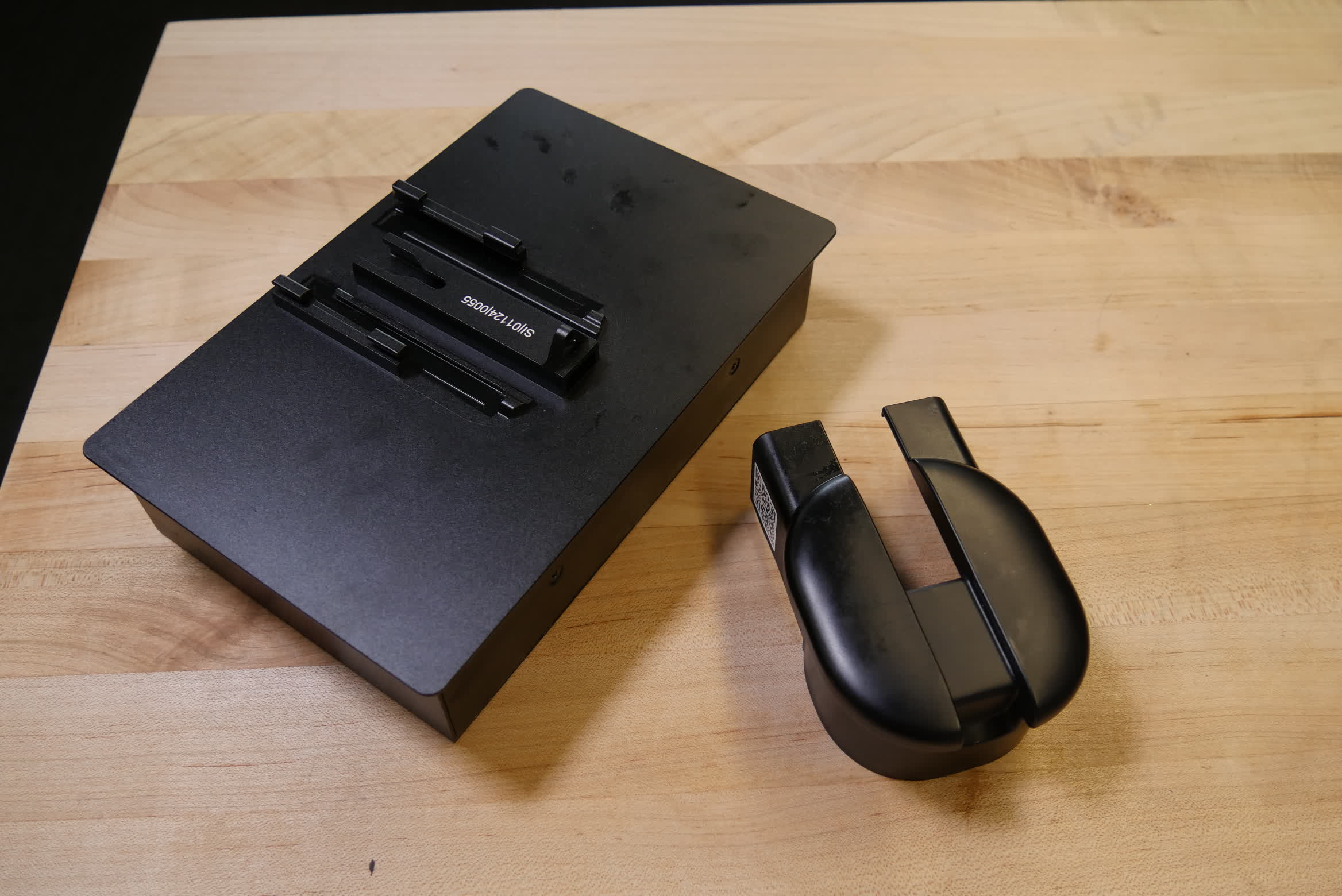

Step 2: Remove the build platform handle
Slide the handle towards the front of the build platform until it is free of the two tabs on the build platform body. Lift the handle upward, directly away from the build platform body. Discard the handle.

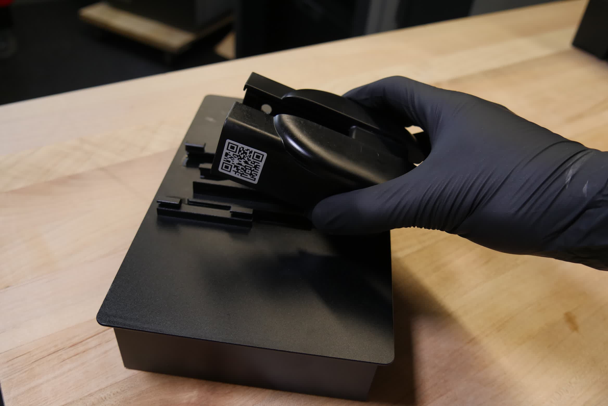

Step 1: Mount the build platform handle

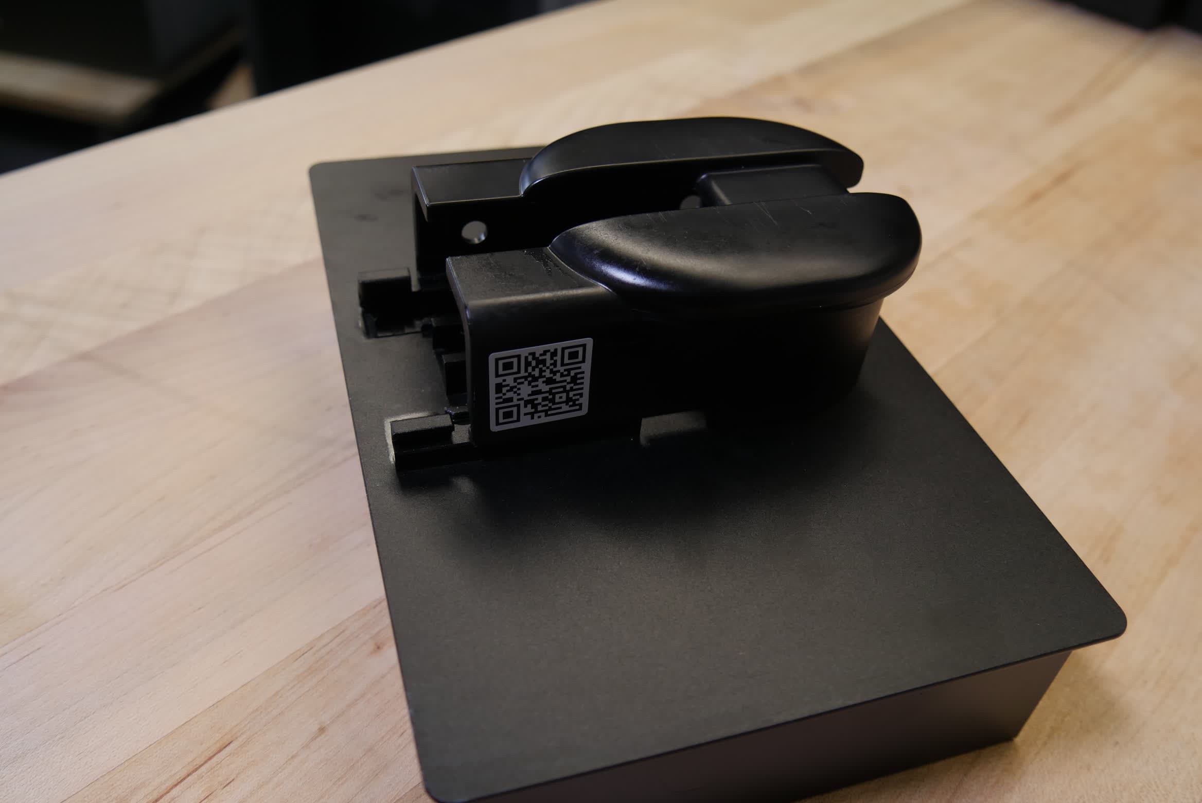

Align the build platform handle behind the tabs on the build platform body and press down firmly until the sides of the handle are touching the build platform body. Slide the handle towards the rear of the build platform until the handle fully covers the tabs.
Step 2: Secure the build platform handle
Thread the build platform handle into the screw hole in the handle. If needed, use tweezers to help position the screw. Using a T8 Torx driver, tighten until finger tight.
