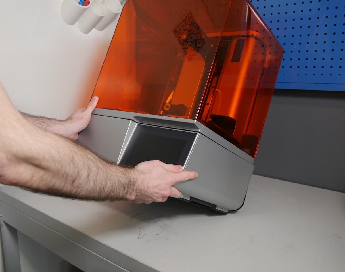

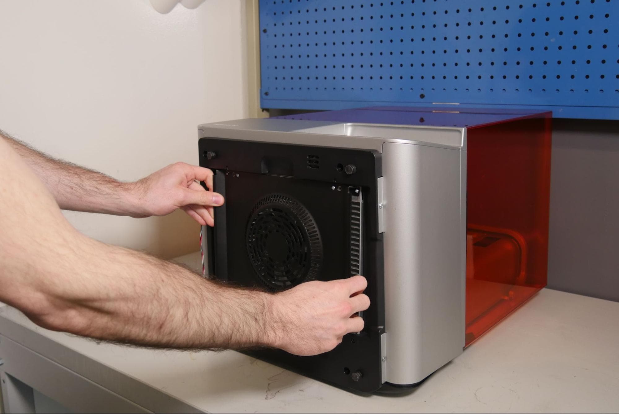

Step 1: Position the printer

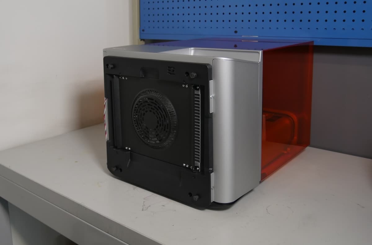

Ensure that the build platform, resin cartridge, resin tank, and mixer have been removed from the printer to prevent damage. Carefully rotate the printer so that it is resting on the back surface with the bottom facing you. Leave at least 15 cm (6 in) of clear tabletop in front of the printer when it is lying down.

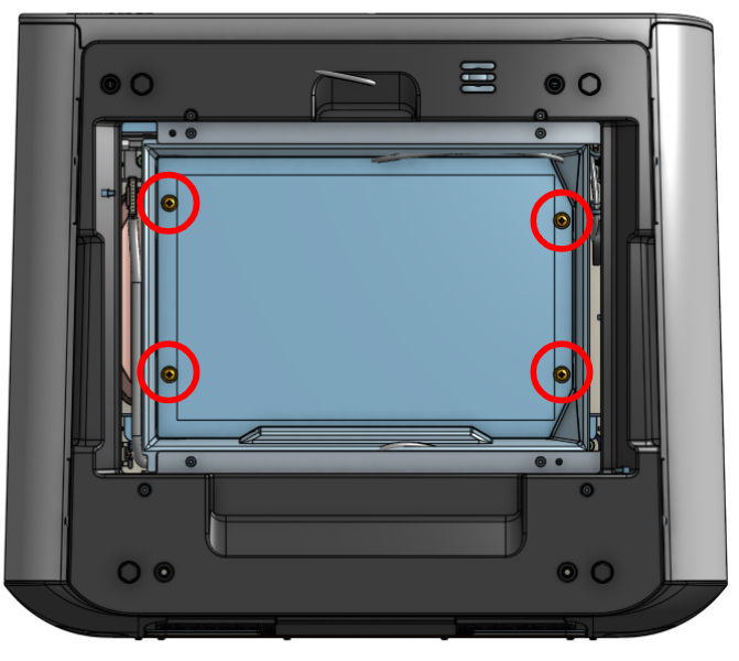

Step 2: Remove the Backlight Unit screws
Use a 2.5 mm hex driver to remove the four socket cap screws that secure the Backlight Unit to the bottom of the printer. Do not remove the button head screws. Set the screws aside.

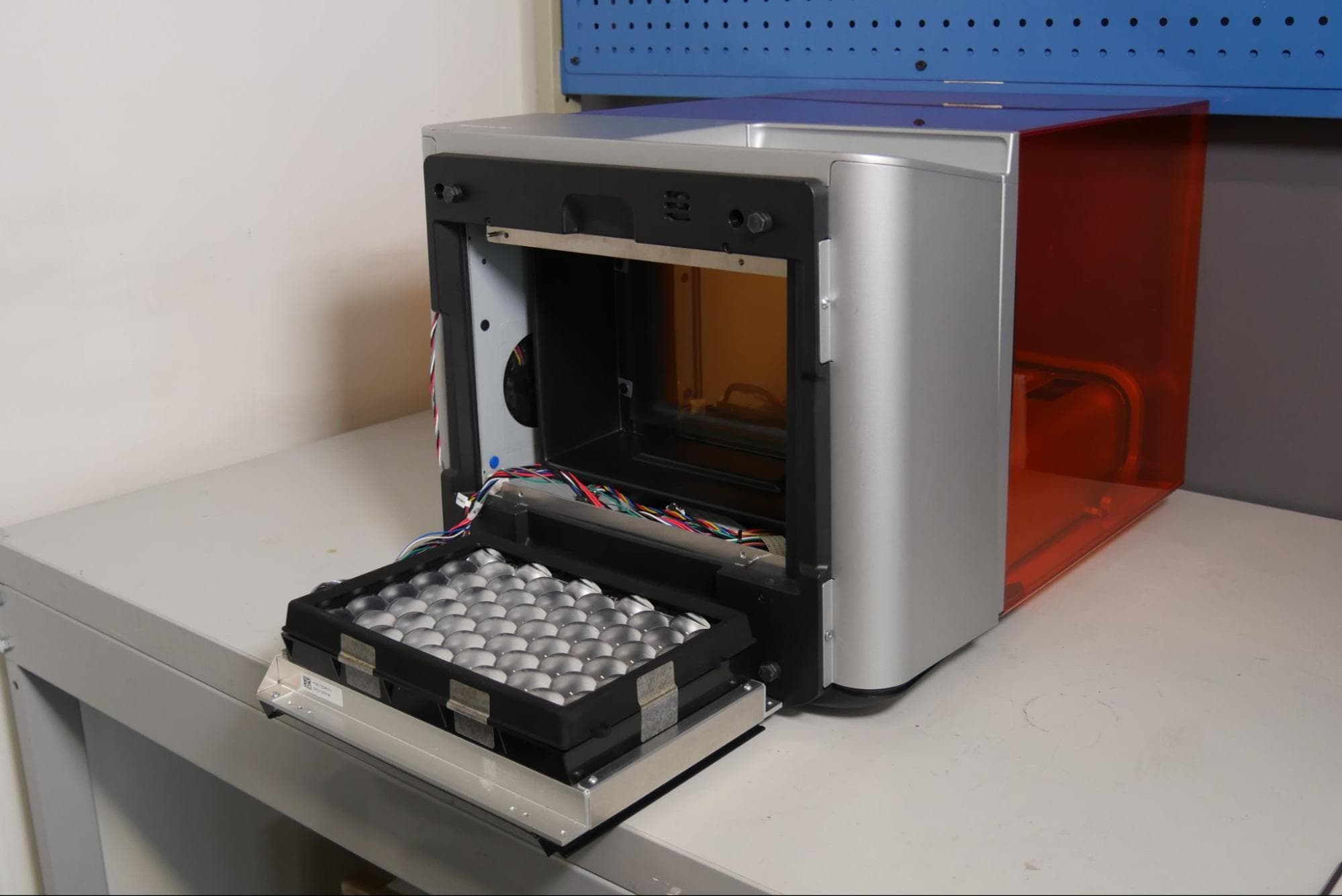

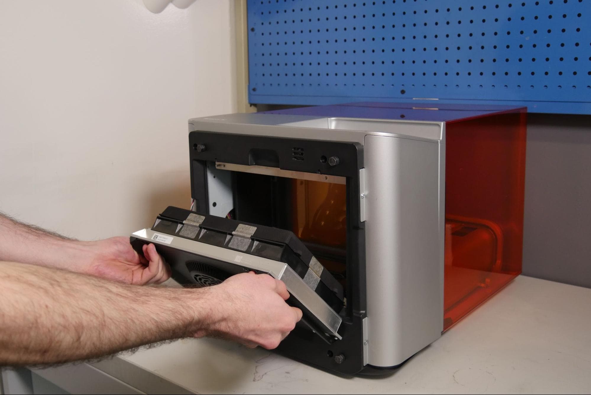

Step 3: Separate the Backlight Unit from the printer

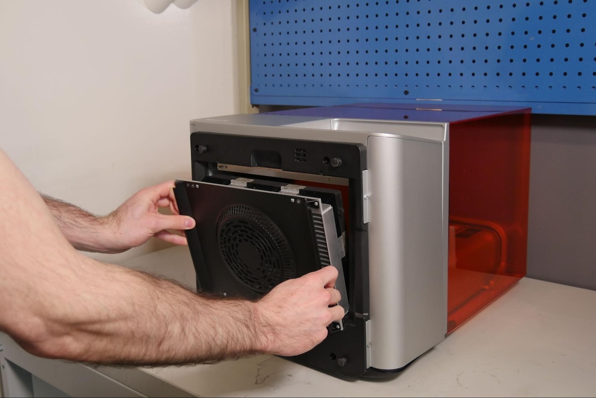

Grip the two handles on the Backlight Unit. Carefully pull the Backlight Unit away from the printer and pivot it until it rests on the work surface.
NOTICE:
Take care not to touch the components inside the exposed optical cavity.

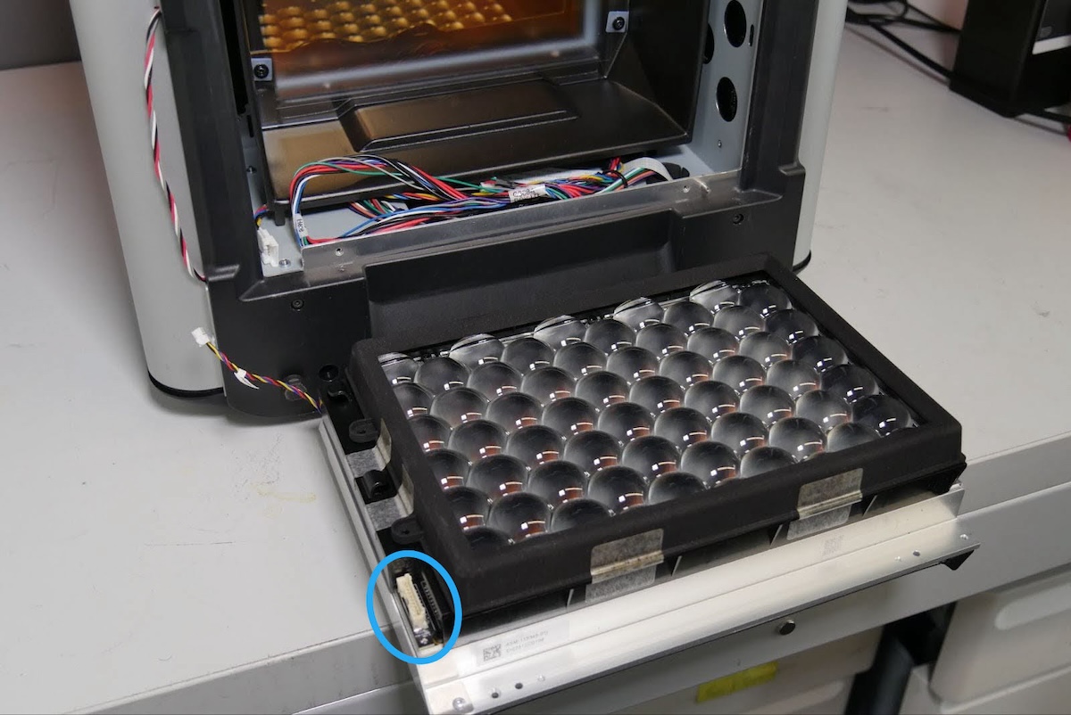

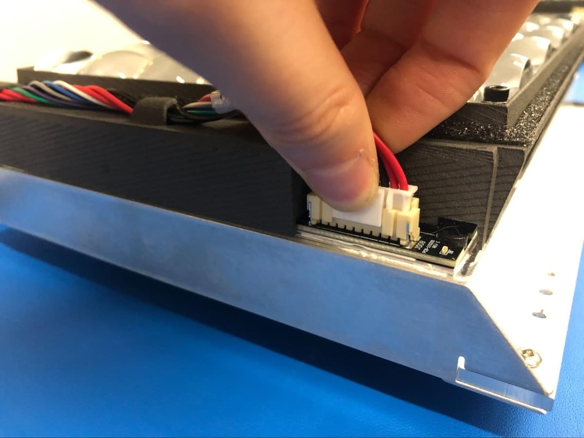

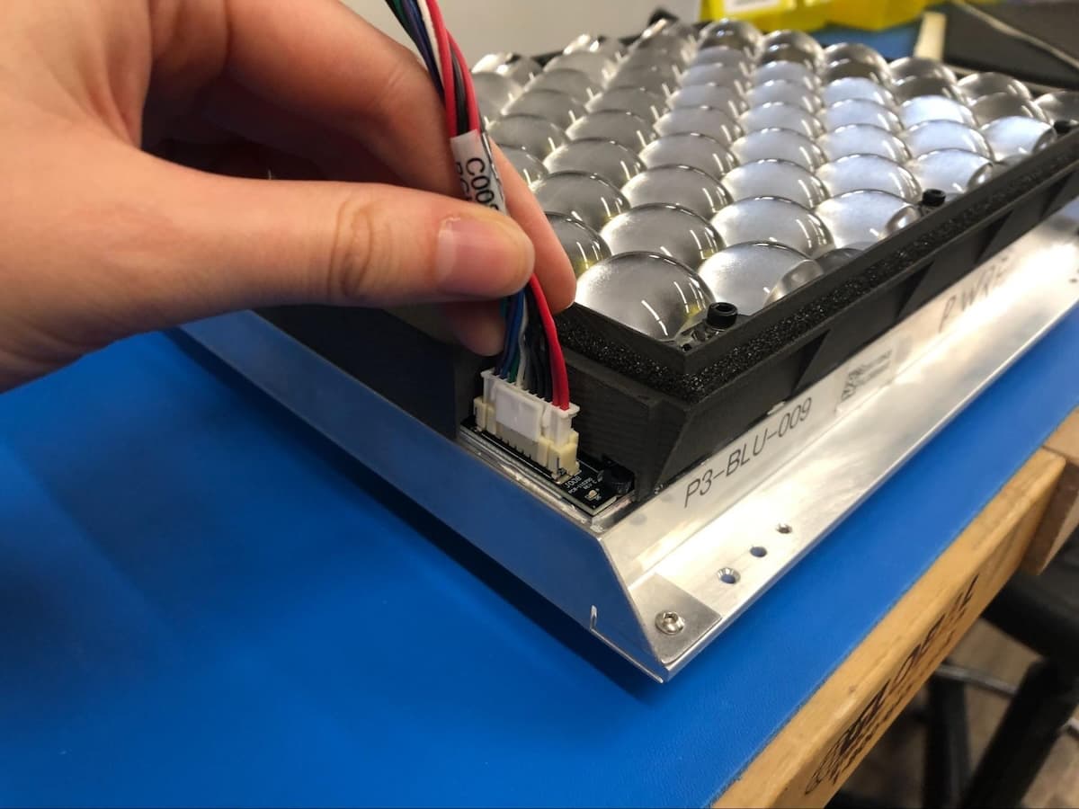

Step 4: Unplug the backlight driver cable
Hold the connector by its plastic housing and gently squeeze the plastic tab to unplug the backlight driver cable from the Backlight Unit. Do not pull on the individual wires.

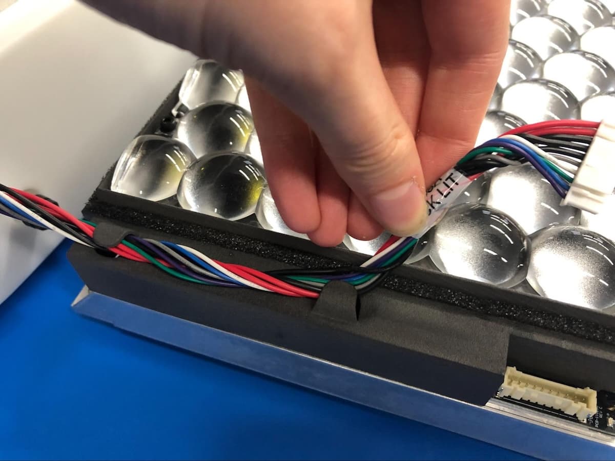

Step 5: Unhook the backlight driver cable
Unhook the backlight driver cable from the clips along the side of the Backlight Unit.

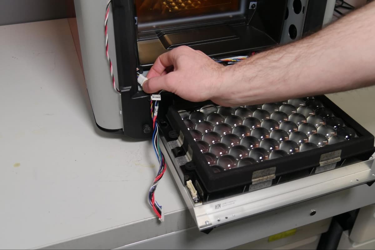

Step 6: Disconnect the LED fan cable
The LED fan cable is located in the bottom-left of the optical cavity. Squeeze the plastic retaining clip and unplug the LED fan cable from the printer. Do not pull on the wires.
Step 7: Remove the Backlight Unit
Once all the cables are disconnected, remove the Backlight Unit from the printer. Set aside for disposal with electronic waste.

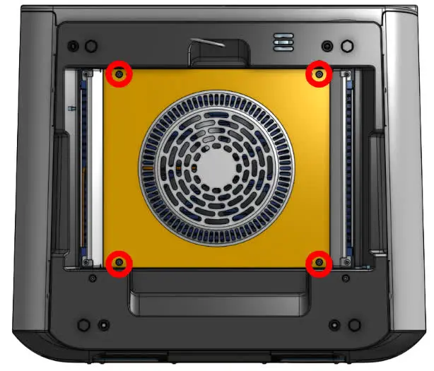

Step 1: Remove the diffuser panel screws
Use a Phillips head screwdriver to remove the four screws that secure the diffuser panel to the printer. Set the screws aside.

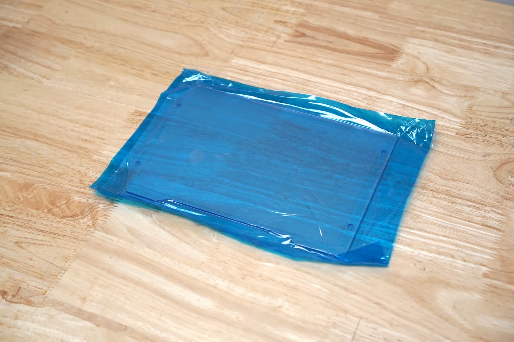

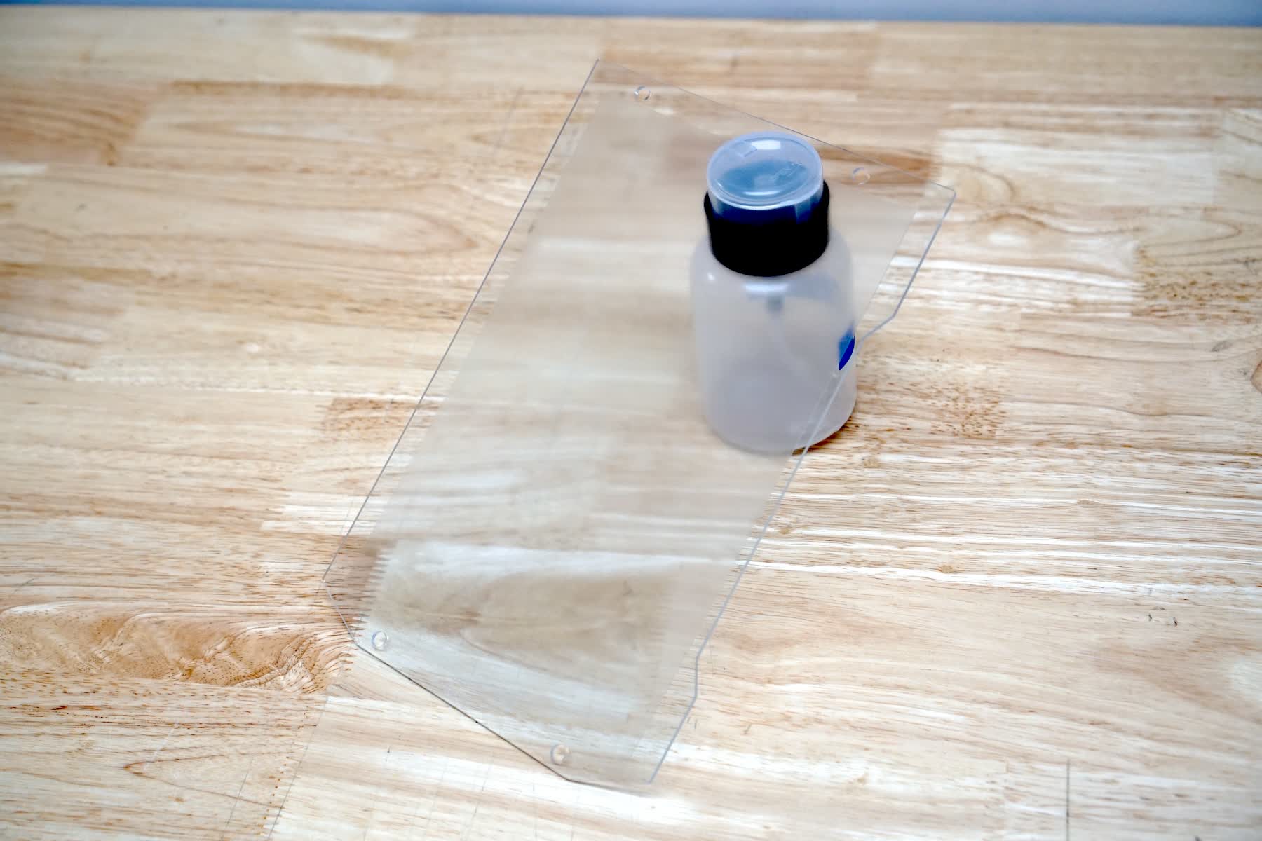

Step 1: Remove protective liners from the diffuser panel
The diffuser panel ships with plastic liners to protect the part from scratches or contamination during shipping. While wearing gloves and holding the diffuser panel at the edges, remove the protective liners from both sides of the diffuser panel. Do not set the diffuser panel down once the protective liners have been removed.
Form 4 diffuser panel with protective liners
Notice:
If the diffuser panel is contaminated during the repair procedure, apply a small amount of clean IPA to a lint-free cloth and wipe the surface of the diffuser panel to remove contamination or resin. Allow the diffuser panel to air dry before installing it.

Step 3: Connect the backlight driver cable
Connect the backlight driver cable to the Backlight Unit. The connector makes an audible and tactile click when secured.

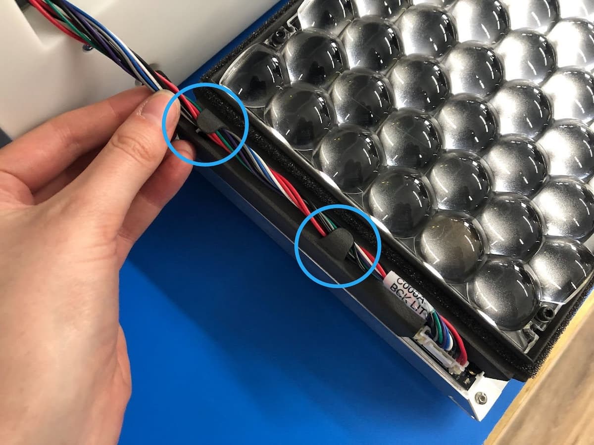

Step 4: Route the cable
Route the cable along the edge of the Backlight Unit and push it gently under the cable clips until the cable is flush with the surface of the Backlight Unit.

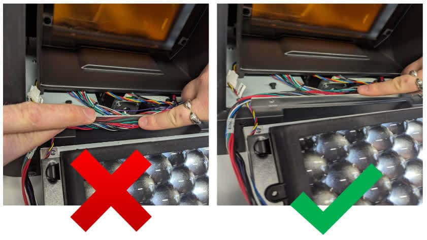

Step 5: Organize cables
Some internal cables may have moved during the repair procedure. Move any loose cables so they are positioned alongside the metal tab in the optical cavity.

Lifting with the two handles, gently slide the Backlight Unit into the printer. Ensure the Backlight Unit is fully seated.
