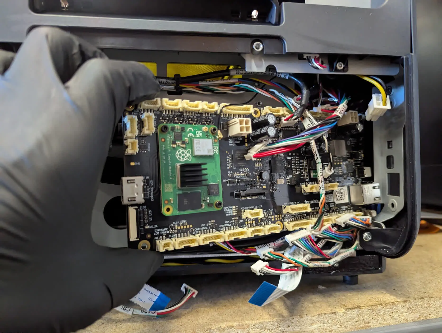

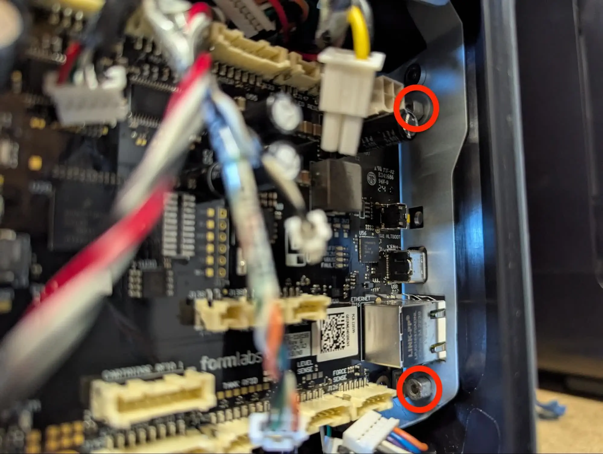

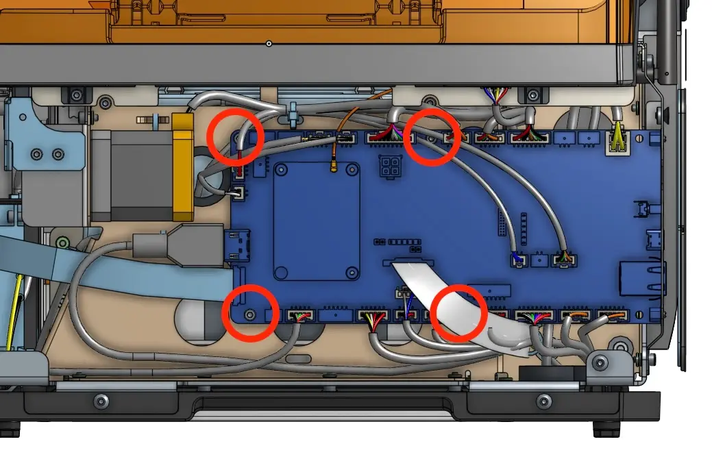

Step 3: Remove the motherboard mounting screws
Using a 2.5 mm hex driver, remove the four hex screws on the left side and the two hex screws on the back of the printer that secure the motherboard to the printer.
Set the screws aside.
Step 4: Remove the motherboard
Carefully slide the motherboard out of the printer. Take care not to drop the two studs used to secure the motherboard. Set the studs aside. Set the motherboard aside for disposal with electronic waste.

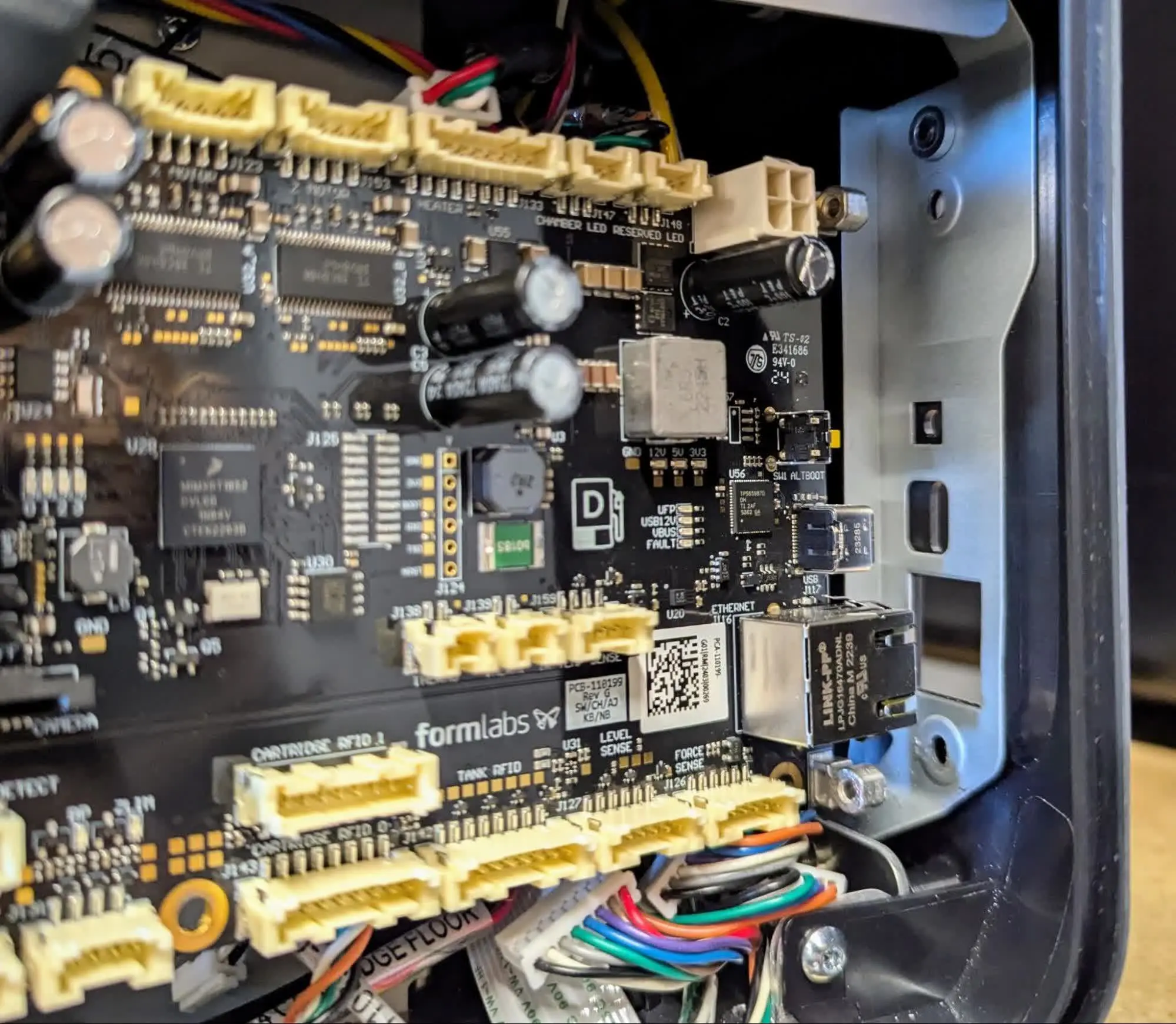

Align the stud holes of the motherboard with the slot holes in the printer. Thread the studs through the holes to secure the motherboard to the printer.
Step 2: Install the motherboard mounting screws
Position the motherboard on the right side of the printer so the screw holes are aligned. Using a 2.5 mm hex driver, install the four hex screws on the left side and the two hex screws on the back that secure the motherboard to the printer. Do not overtighten the screws.

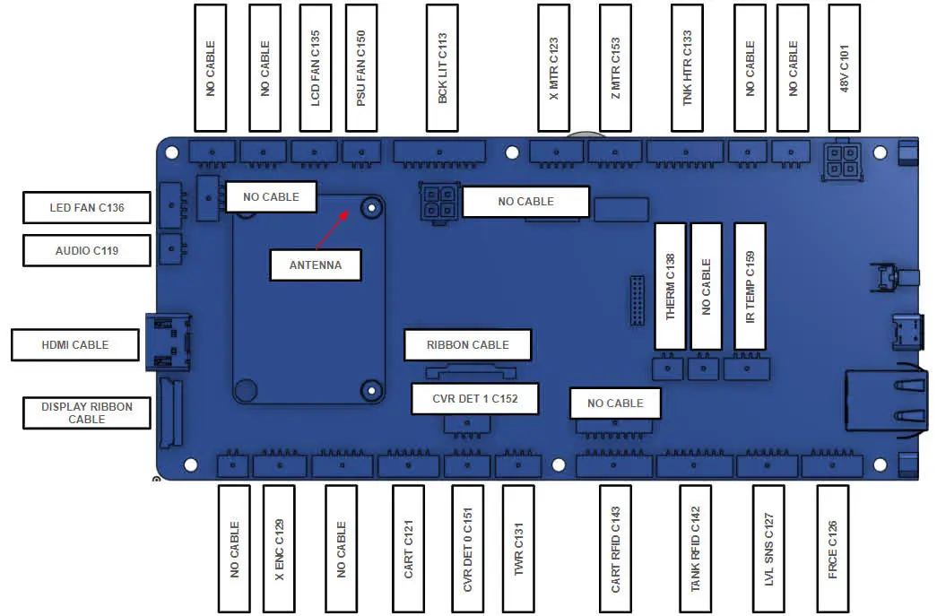

Step 3: Connect the cables to the motherboard
Reconnect all cables to the motherboard. Use the numbered labels on the cables and the matching labels printed on the motherboard.
