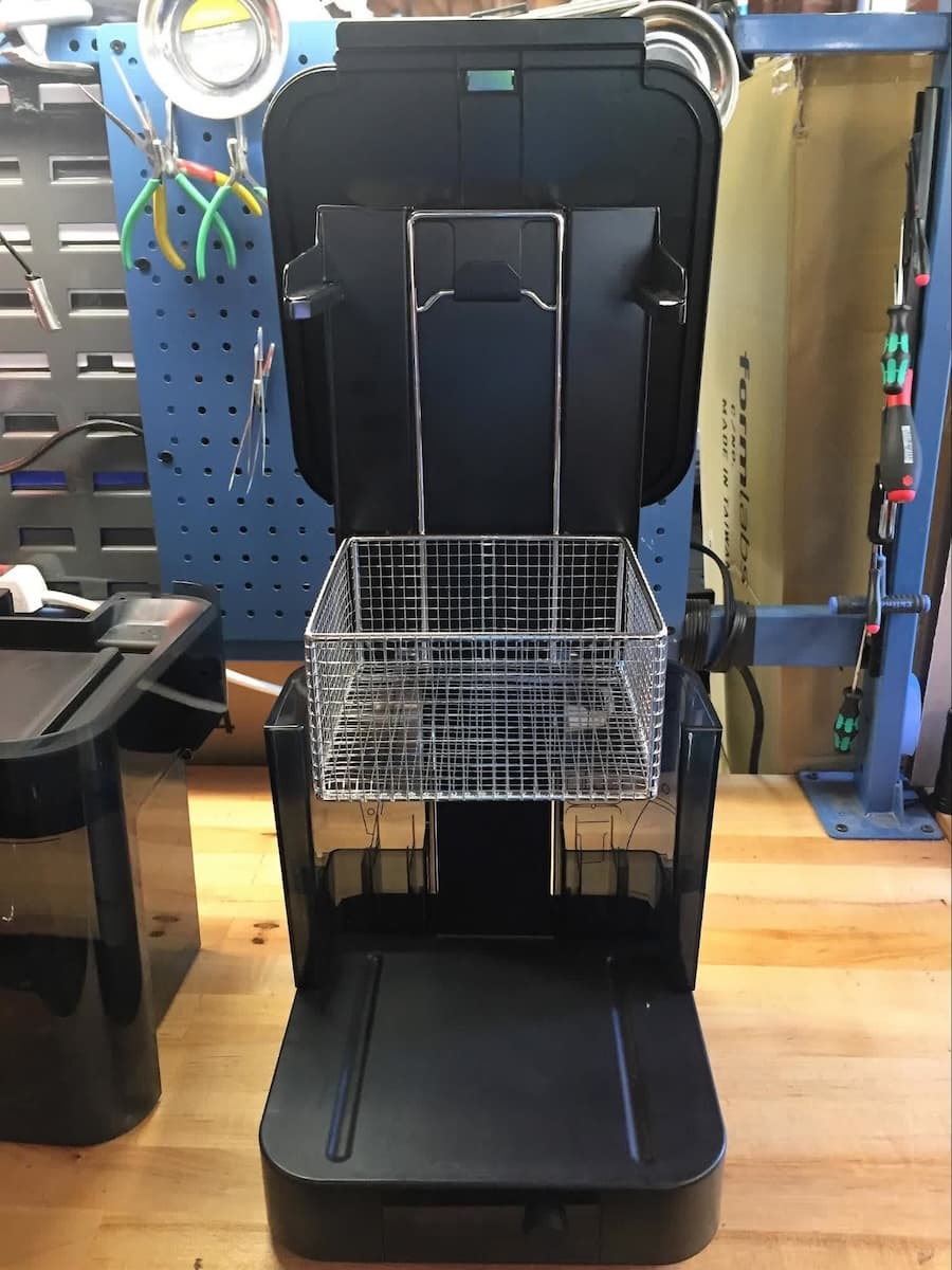

Lift the Form Wash by gripping its base, not the handles of the wash bucket. Move the unit to a well-ventilated area. Set the unit and the outer lid hinge on a level surface for easy access.

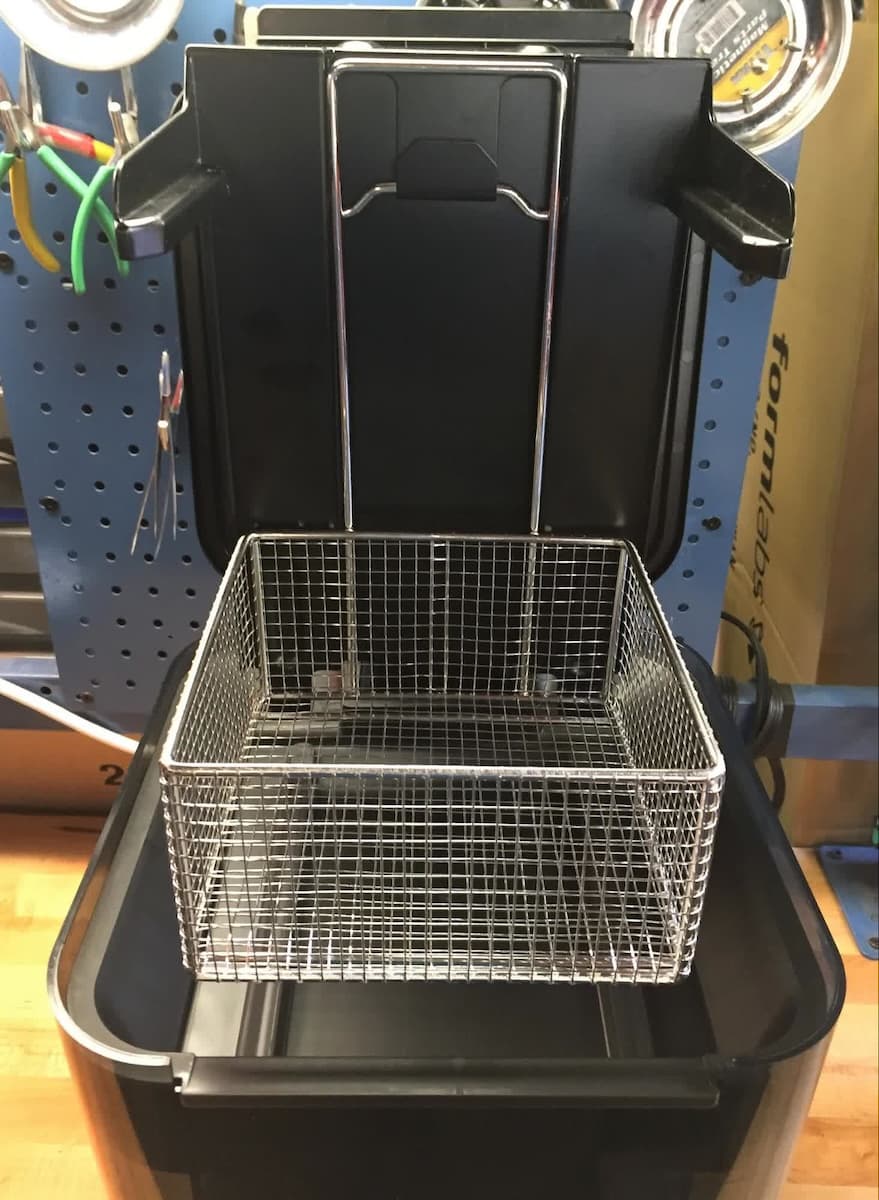

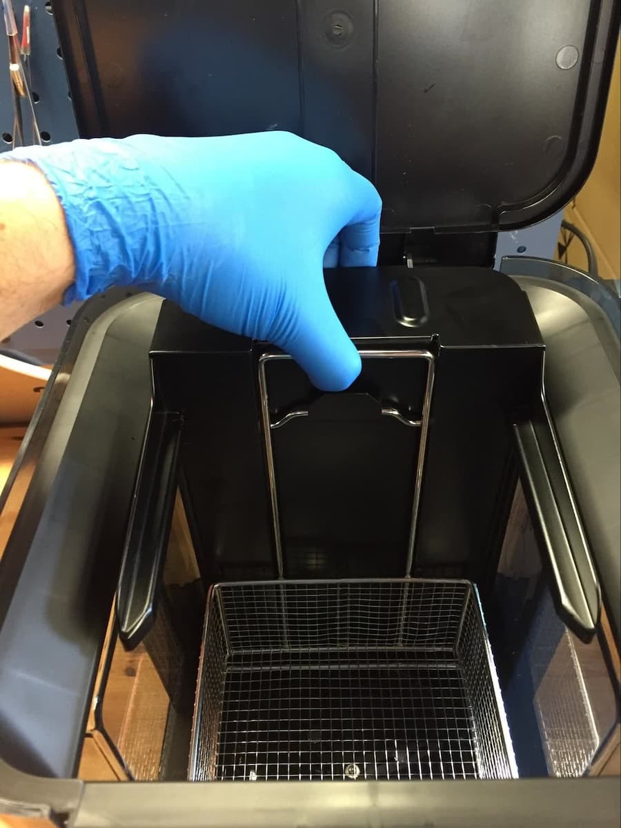

Lift the outer lid to expose the wash bucket and platform mount.
Step 4: Lift the platform mount
Lift the platform mount until it rests at the top of the lead screw. Some friction or shaking while lifting the mount is normal and should not affect the unit.

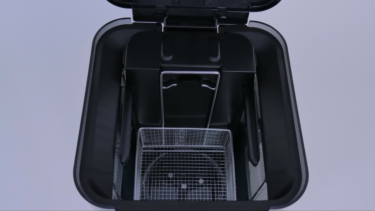

Step 5: Remove the wash bucket
Remove the wash bucket from the base and set the bucket aside on a stable, flat surface. To reduce the likelihood of spillage, remove the solvent from the wash bucket with a siphon pump.

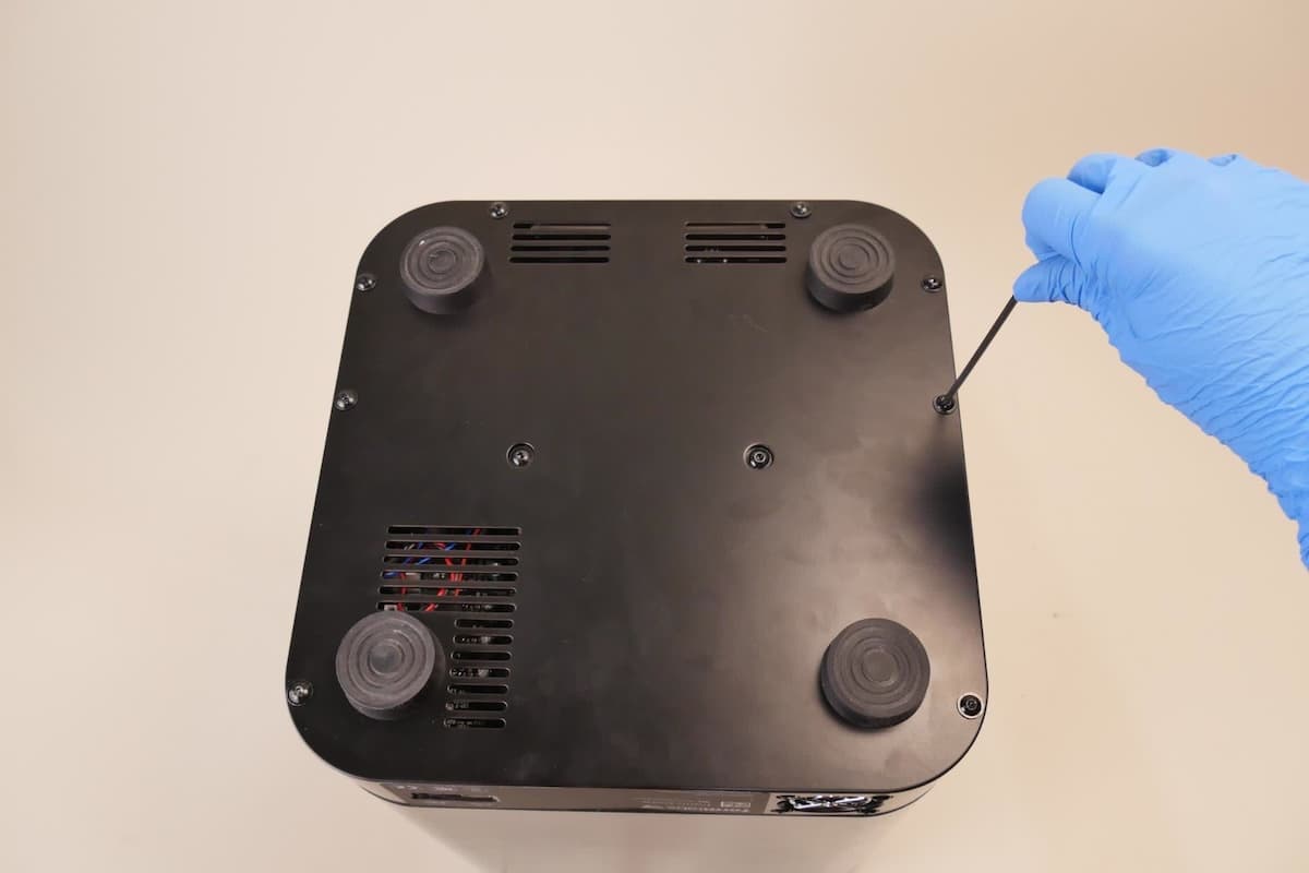

Overview: Close the cover and turn the unit over to rest on its back. Unscrew the outer screws in the bottom plate to remove it.

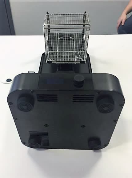

Close the cover and turn the unit over so that it rests on its top and the bottom plate faces up.

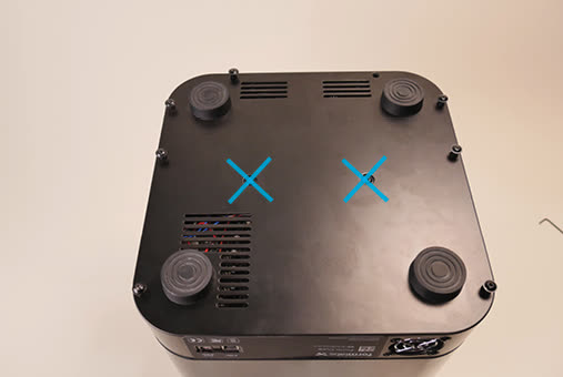

NOTICE:
Do not remove the two screws in the center of the bottom plate. The center screws secure the base assembly.

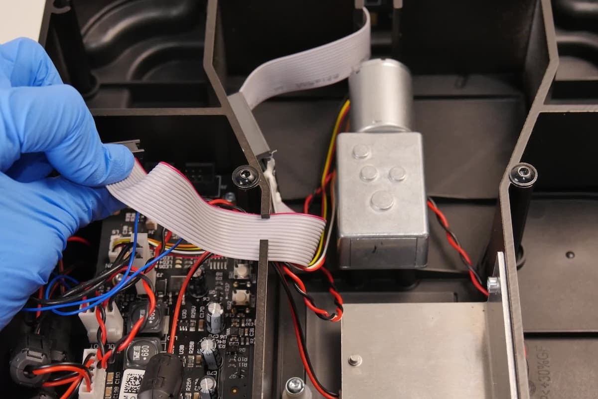

Overview: Remove the display assembly and disconnect the ribbon cable from the display assembly and the motherboard. Connect the ribbon cable to the new display assembly and the motherboard. Insert the new display assembly.

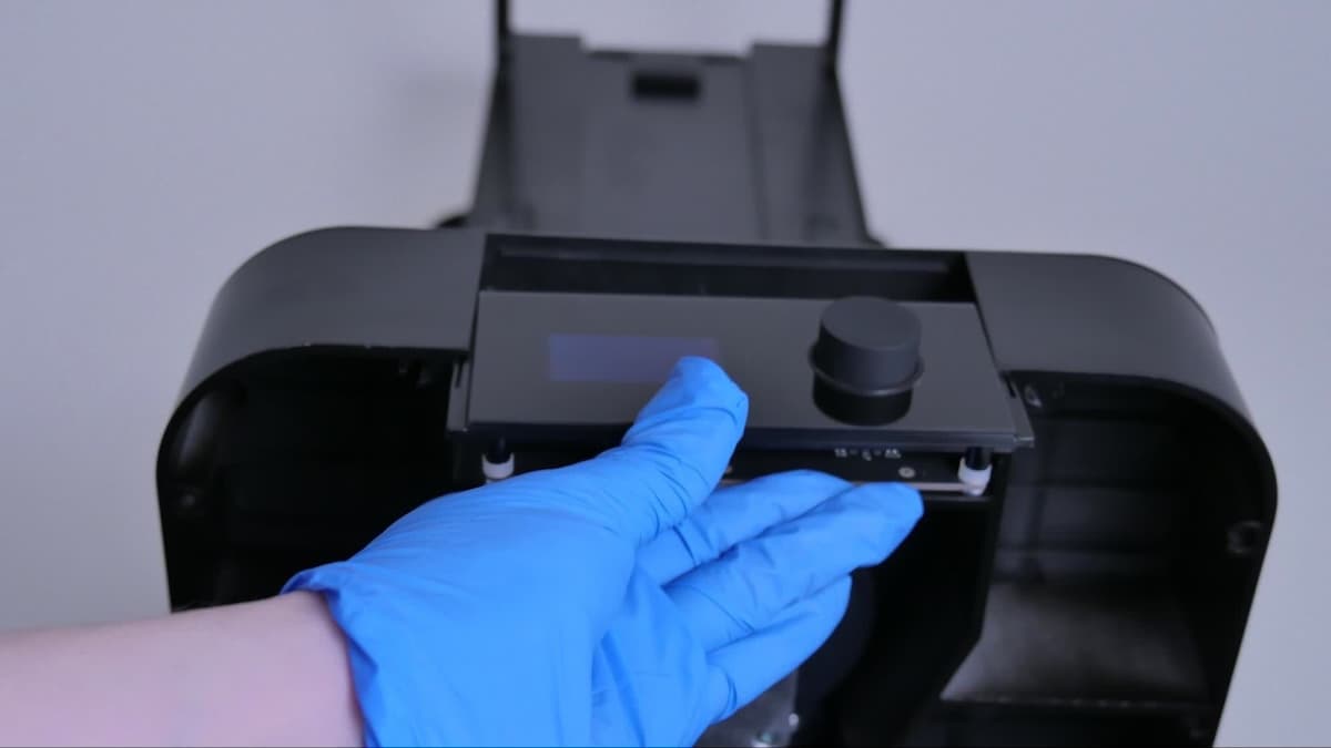

Pull evenly to slide out the display assembly.

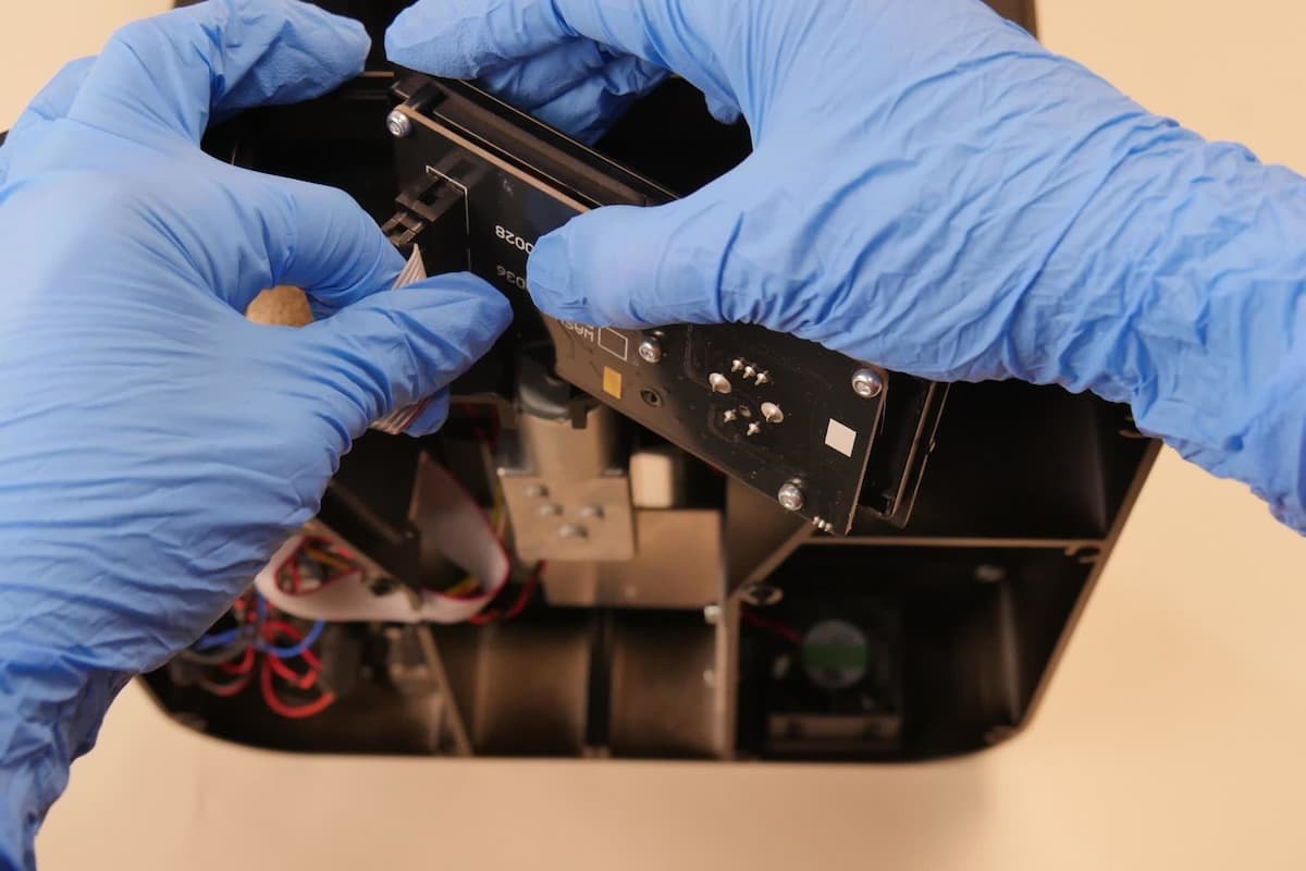

Disconnect the cable connector from the back of the damaged display assembly.
Push the remaining cable connector into the back of the new display assembly. Ensure the cable connector is fully seated.

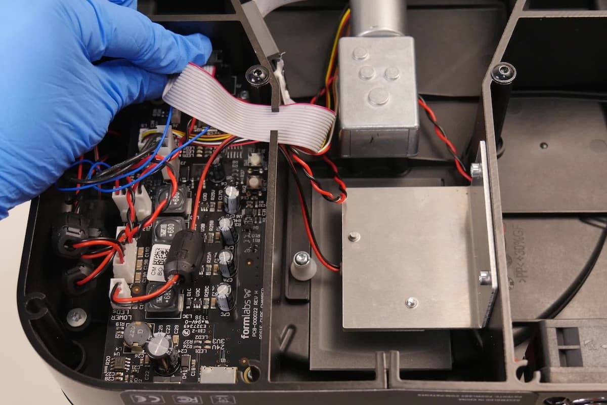

Step 4: Reseat the ribbon cable on the motherboard
Disconnect and reconnect the cable connector on the motherboard. Ensure the cable connector is fully seated.

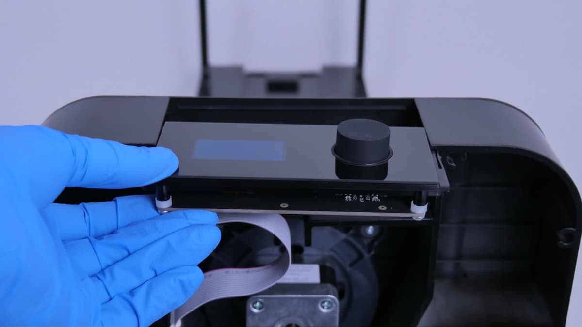

Push evenly to slide the new display assembly into the base.

Place the bottom plate on the unit with the feet pointing upward. Insert the eight screws along the edges of the bottom plate. Turn the 2.5 mm hex driver clockwise to tighten all eight screws until they are finger-tight.
