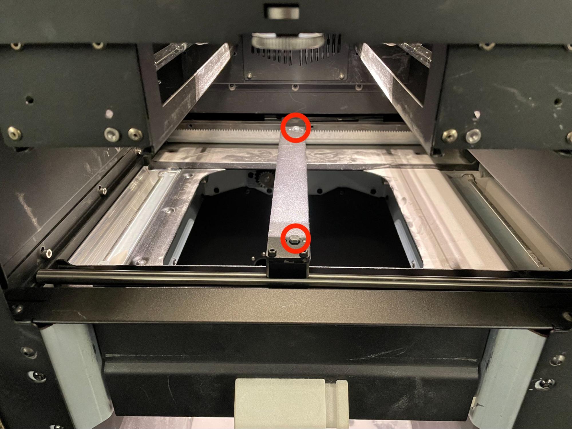

Step 2: Remove the recoater roller retention bolts
Use a 7 mm wrench to remove the two hex bolts holding the roller to the recoater arm.
Step 3: Uninstall the recoater roller
Remove the original recoater roller
Gently pick up the front of the recoater arm and tip it towards the back of the printer. If the roller does not drop off the arm, gently pull it downward and away from the arm. Remove the recoater roller and set it aside for disposal.

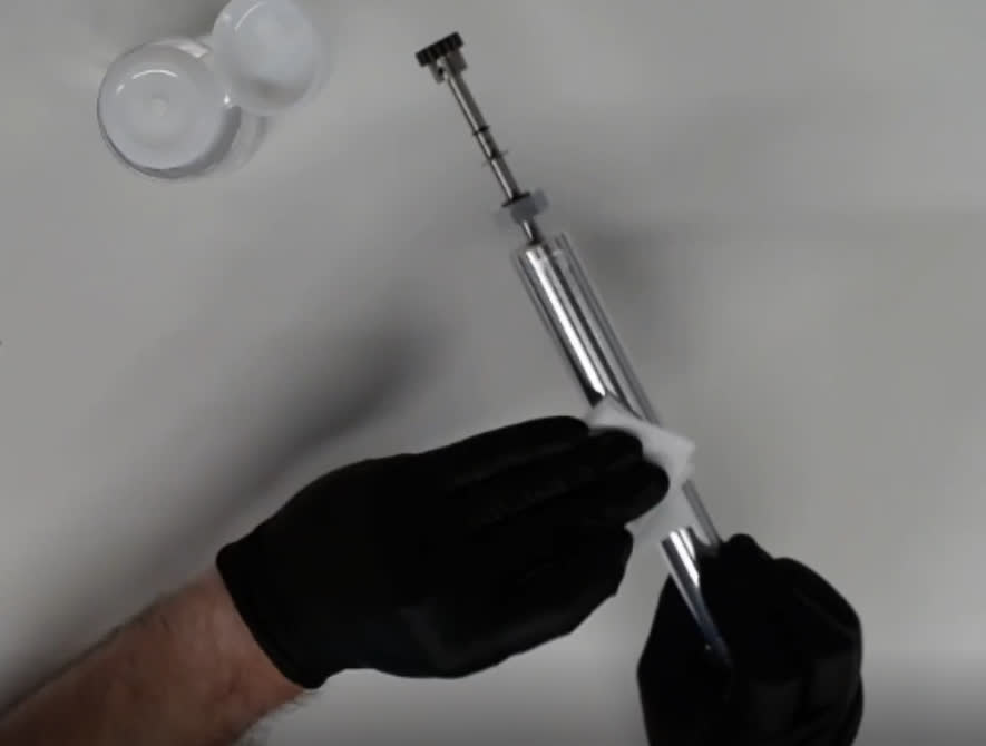

Step 1: Prepare the new recoater roller
Put on a new pair of nitrile gloves. Wet a nonabrasive cleaning cloth with ethanol or isopropyl alcohol. Thoroughly wipe down the roller, ensuring there is no remaining dust or residue.
