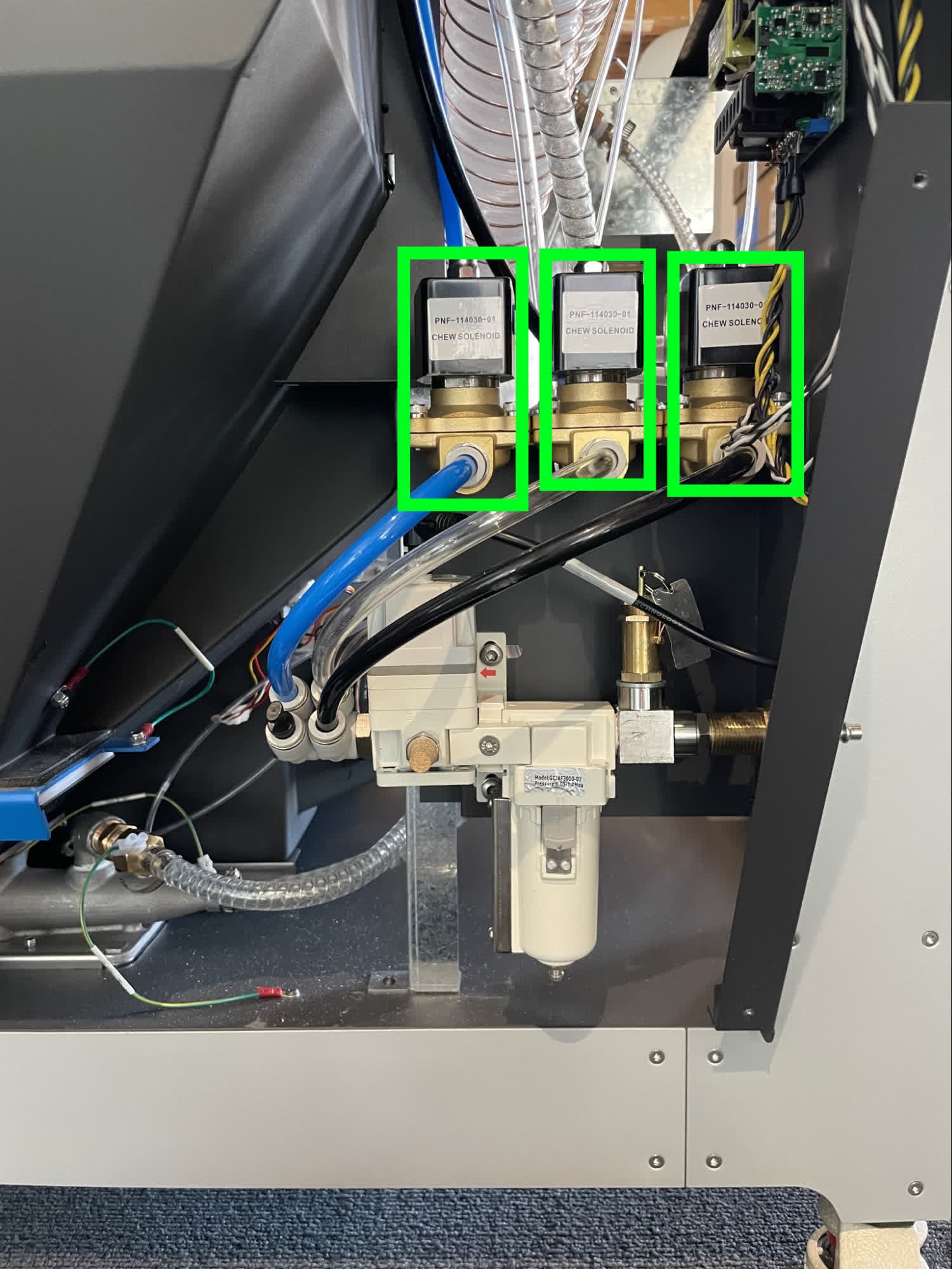

Locate the three solenoids, positioned at the lower-right corner of the machine behind the lower sidecar panel. For each of the three solenoids, reach behind the solenoid and disconnect the power cable and pneumatic tubing. Take note of which tube was connected to which solenoid—the tubing color depends on the age of your unit, so the pictures here may not match what you see.
For each power cable, squeeze the latch and pull the plastic connectors apart. Do not pull on the wires themselves.
For each of the pneumatic tubes, press on the push-to-connect fitting, then pull the tube out.

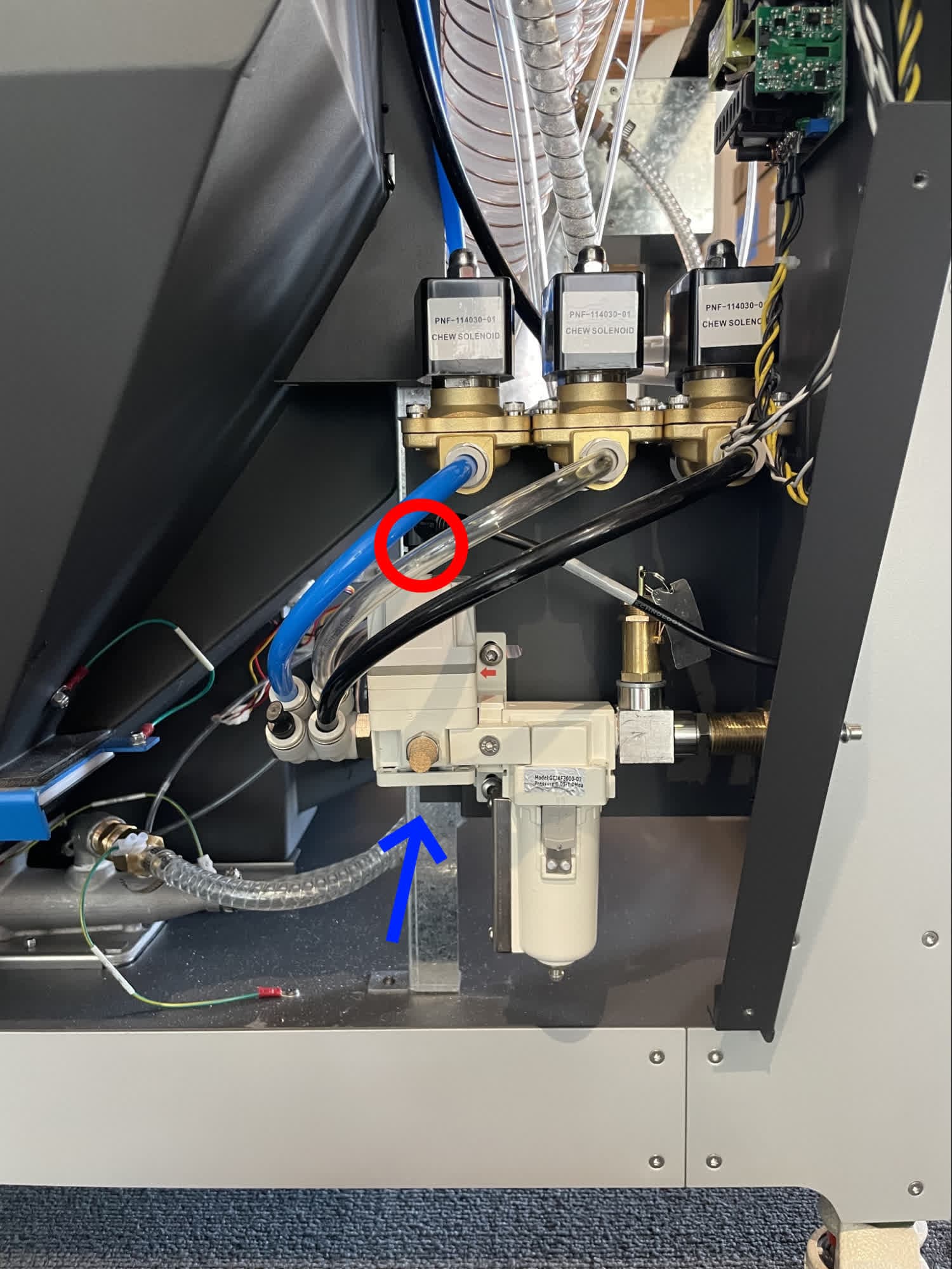

Step 2: Disconnect the pressure regulator power cable
Unscrew and disconnect the pressure regulator’s power cable, circled in red here. It is located at the top of the pressure regulator.
Step 2: Unscrew the pneumatic cassette mounting nut
Using a 7 mm nut driver or box wrench, remove the 7 mm nut from the bottom of the pneumatic cassette, shown here with an arrow. Set the nut aside.

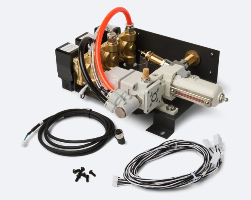

Installing the replacement pneumatic cassette
Overview: Mount, secure, and connect the new pneumatic cassette
Step 1: Mount the replacement pneumatic cassette
Insert the replacement pneumatic cassette into the bottom of the sidecar. Align the screw holes in the side of the cassette with the corresponding screw holes in the back of the machine.

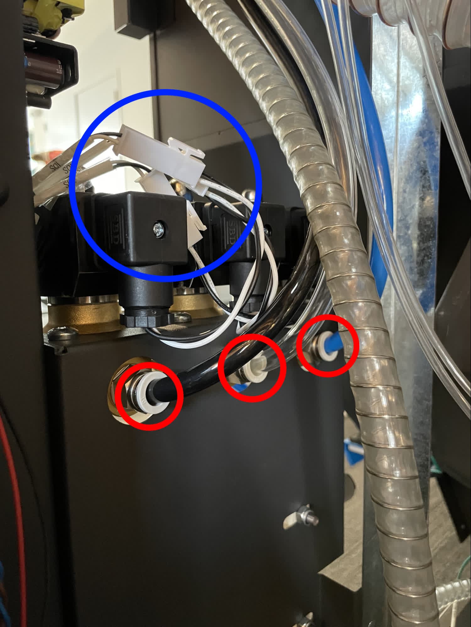

Step 4: Reconnect the solenoids
Reconnect the Solenoids
Reaching behind the solenoids, reconnect the power cables and pneumatic tubing to each of the three solenoids.
Ensure the correct power cable and pneumatic tubing is connected to the correct solenoid.
Solenoid Cable Tubing Color Location
Chamber Rinse CHM SOL Depends on your unit Right
Part Rinse PRT SOL Depends on your unit Center
Blast BST SOL Depends on your unit Left
