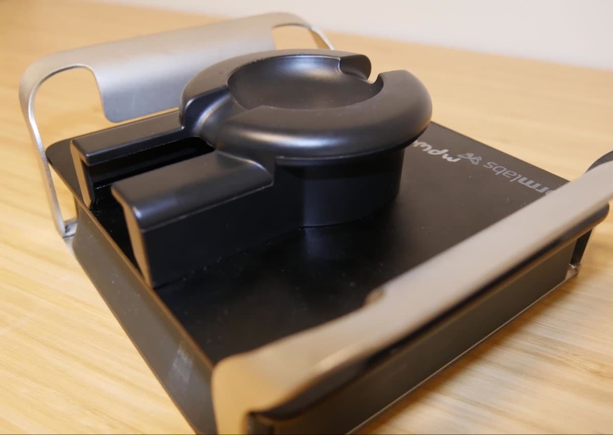

The build platform handle is secured to the build platform body using a single screw, located inside the handle. On a standard Build Platform, the handle is secured using a Phillips head screw. On a Build Platform 2, the handle is secured using a 2 mm hex screw. Using the appropriate driver for your build platform, loosen and remove the screw.

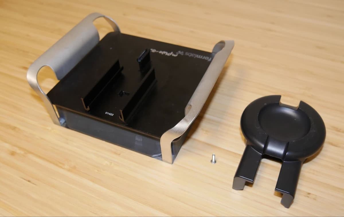

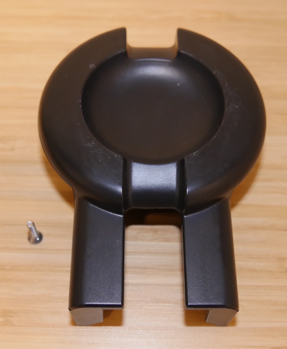

Step 2: Remove the build platform handle
Lift the handle upward, directly away from the build platform body. Discard both the handle and the retention screw.

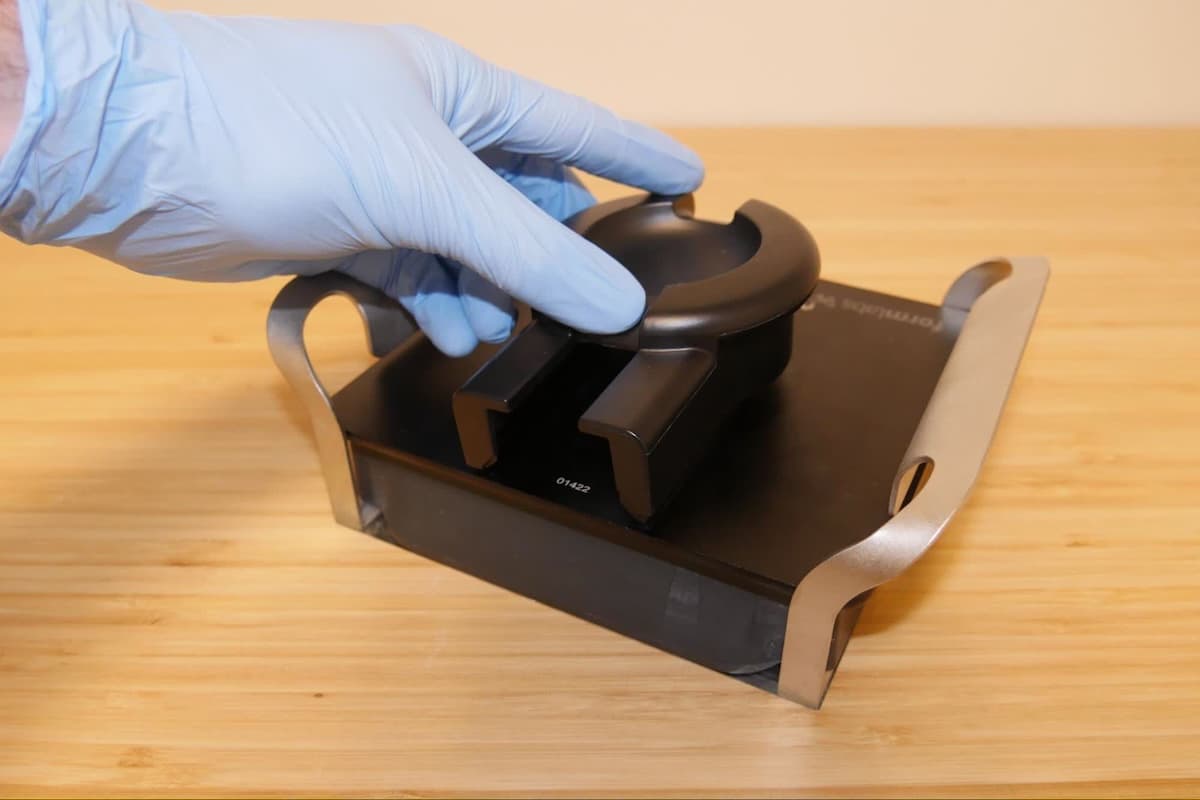

Step 1: Mount the build platform handle

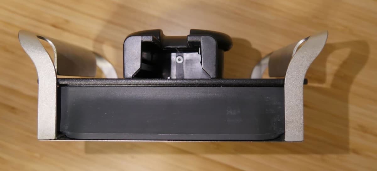

Align the build platform handle with the flanges on the build platform body and press down firmly until the sides of the handle are touching the build platform body. Ensure that the screw hole in the build platform handle aligns with the corresponding hole in the build platform body.

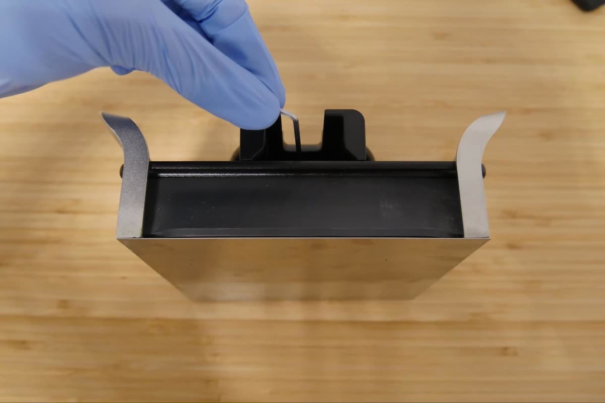

Thread the included build platform handle into the screw hole in the handle. If needed, use tweezers to help position the screw. Using the appropriate driver for your build platform, tighten until finger tight.
Notice:
Do not overtighten. Overtightening the build platform handle retention screw can damage the handle or its mounting point.
