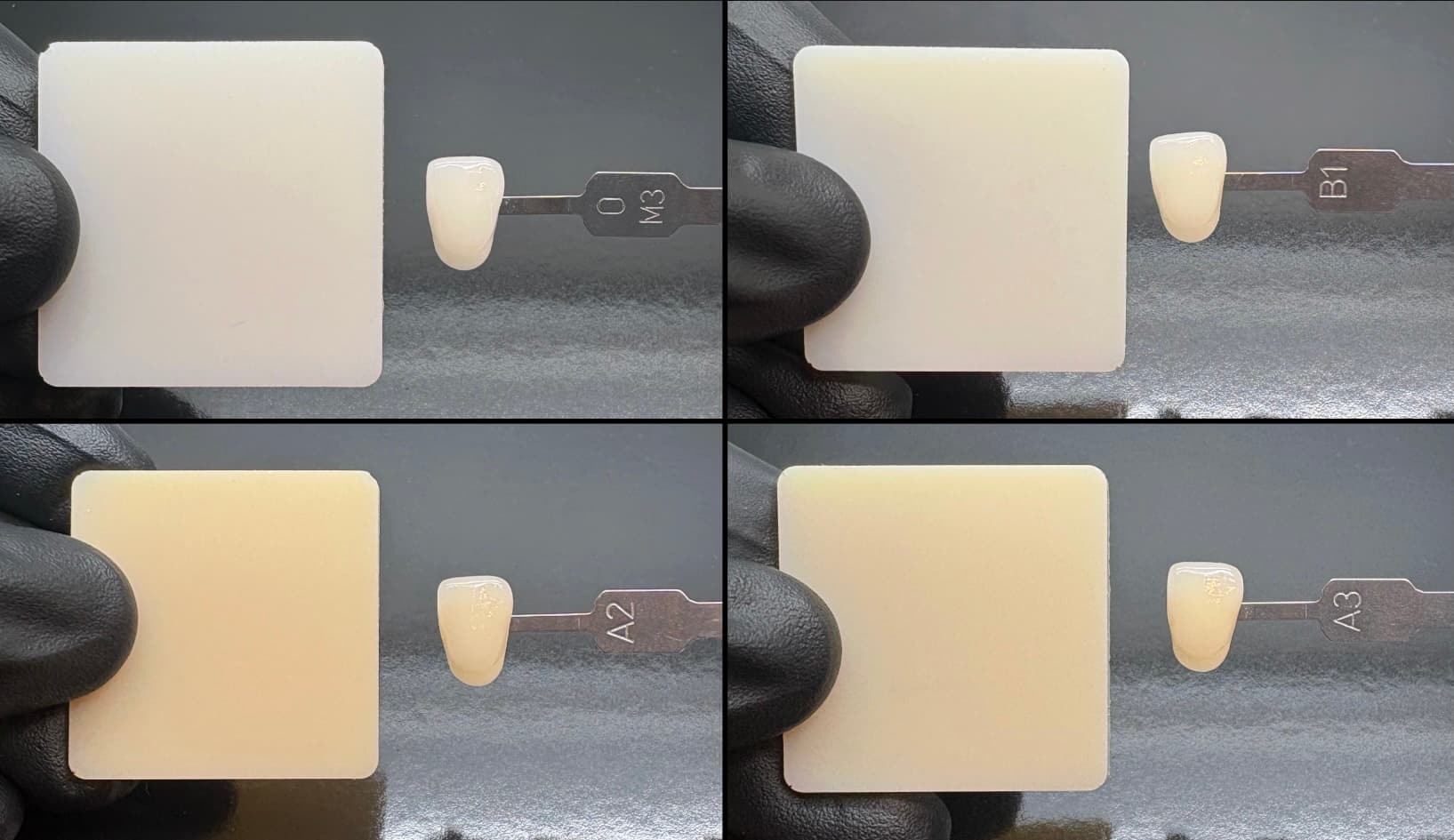

Premium Teeth Resin shade matching
Premium Teeth Resin shade match (2 mm thick, D65 illuminant, Form Cure V2 post-cure)
Top Left: Bleach, Top Right: B1, Bottom Left: A2, Bottom Right: A3

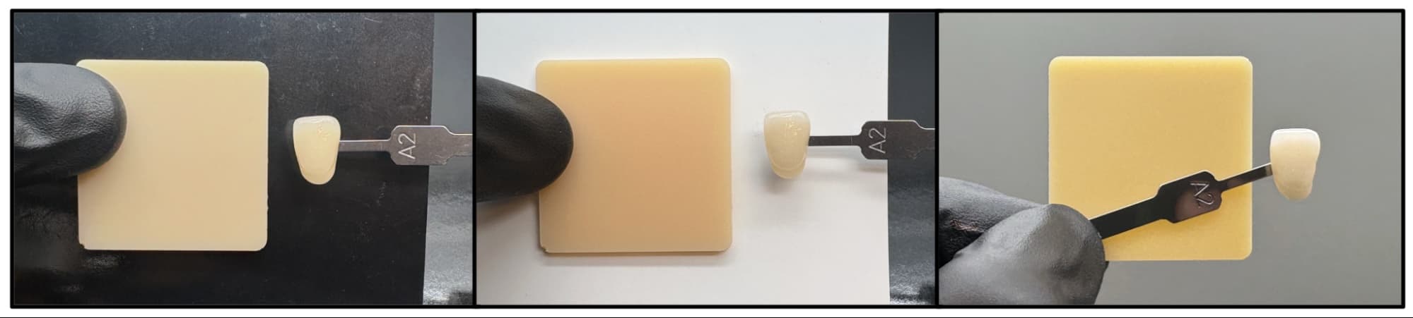

Impact of background color on Premium Teeth Resin
Impact of background on color (2 mm thick, D65 illuminant, Form Cure V2 post-cure)
Left: over black background (color match target condition), Middle: over white background (not representative of the mouth), Right: light transmission (not representative of the mouth)
Evaluating the color match under different lighting conditions (especially ones with varying amounts of ultraviolet light) can also result in slight color match differences due to color metamerisms.

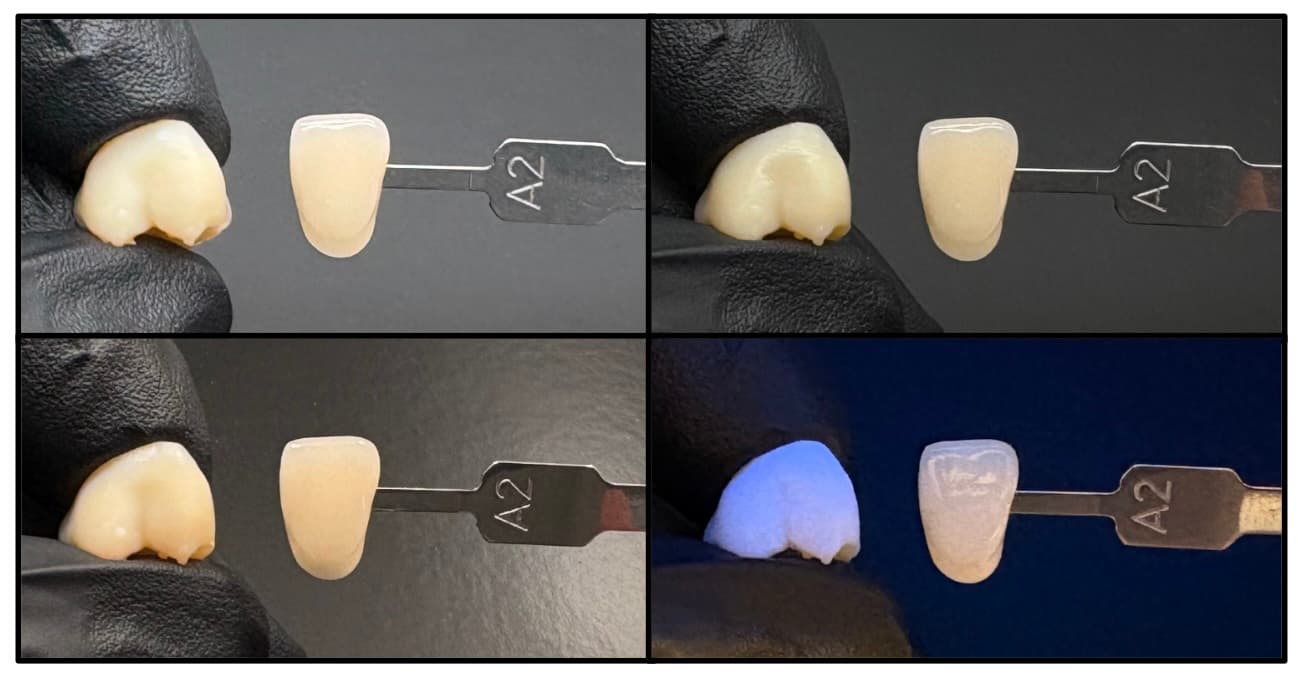

Metamerisms and illuminant impact on Premium Teeth Resin color
Metamerisms and illuminant impact on color (1–3 mm thick crown model, Form Cure V2 post-cure)
Top Left: D65 illuminant, Top Right: TL84 illuminant, Bottom Left: tungsten filament illuminant,
Bottom Right: ultraviolet illuminant (shows fluorescence)

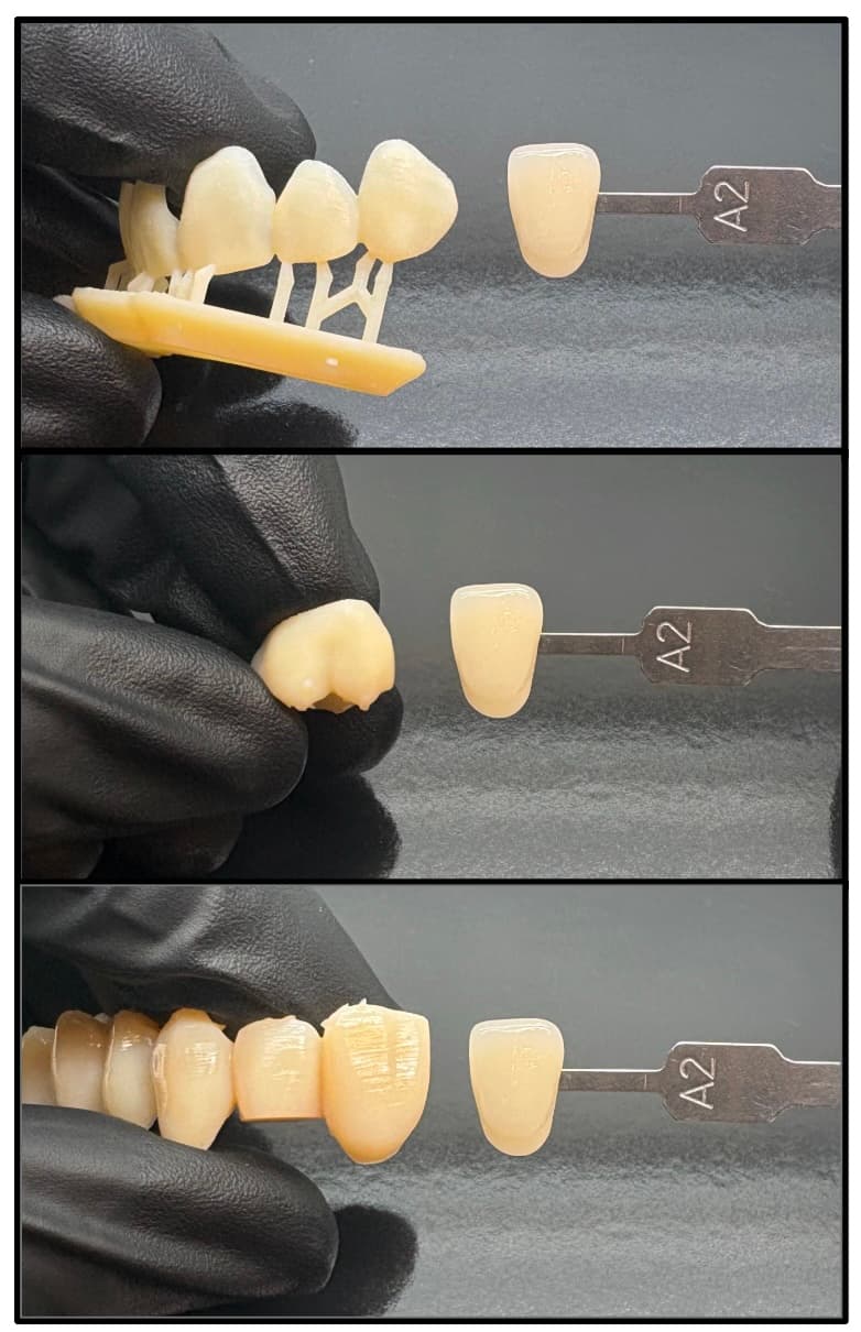

Premium Teeth Resin is a translucent resin, which means the perceived color is highly dependent on the thickness of the sample. Thicker geometries are perceived as darker and more orange/red. Premium Teeth Resin is recommended for use in geometries greater than 1 mm in thickness. Color match to the Vita shade tabs was prioritized for thicknesses between 2–3 mm.
Impact of thickness on Premium Teeth Resin color
Impact of thickness on color (D65 illuminant, Form Cure V2 post-cure)
Top: 1 mm thick veneer model, Middle: 1–3 mm thick crown model, Bottom: 3–10 mm thick bridge model (darkness due to model thickness)

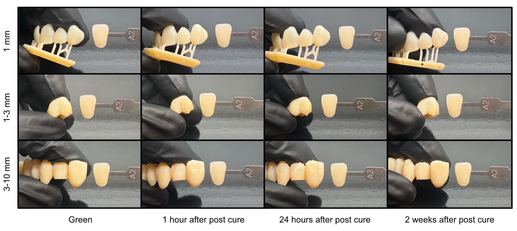

Impact of time after post-cure on Premium Teeth Resin color
Impact of time after post-cure (D65 illuminant, Form Cure V2 post-cure)

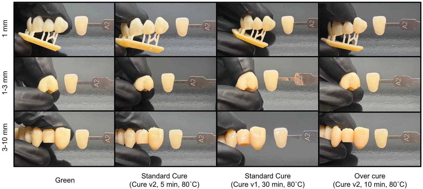

Impact of post-cure cycle and additional UV exposure on Premium Teeth Resin color
Impact of post-cure cycle and additional UV exposure (D65 illuminant, 24 hours after post-cure (except for green))
