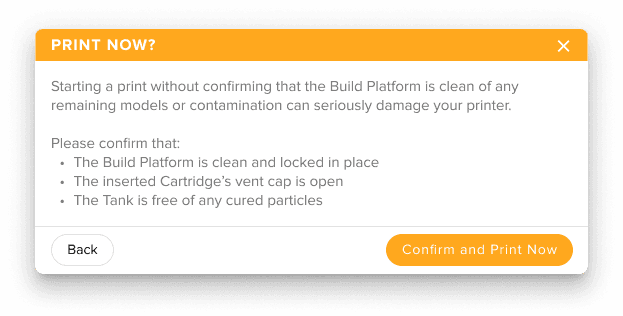

Uploading a print job to a Formlabs SLA printer (Form 3 and later)
To upload a print job from PreForm 3.29 or later to a Formlabs SLA printer (Form 3 and later):
  1. Import your models and set up your print job.
  2. Click Edit Job Setup. The Job Setup window opens.
  3. Select the Printer and the Job Settings. Click Apply.
  4. Click Print Now to start the print immediately if the printer is ready or Upload to Queue to add the print to the printer or Printer Group’s queue.
  • If you did not confirm that the build platform is ready to print on the printer’s touchscreen, the Print Now? window opens. Verify that the build platform is clean and locked into position, then click Confirm and Print Now. The model is sent to the printer.
Build platform readiness confirmation notice in PreForm 3.29.0
Build platform readiness confirmation window in PreForm 3.29.0
Note:
Do not disconnect your printer while the upload is in progress.

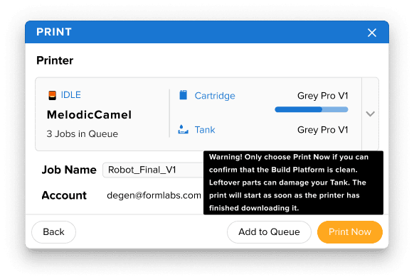

Print Now or Upload to Queue is unavailable in PreForm
The Print Now option is only available if you are sending a print job to an individual printer whose status is Ready to Print and whose inserted resin cartridge and resin tank match the resin type for your print job. Otherwise, PreForm will display Upload to Queue. If the Print Now button is unavailable in PreForm:
  • The printer may be missing consumables, such as a resin tank or a resin cartridge. Check that the job resin matches the one the printer is set up for.
  • The printer may not be ready to print or currently printing another print job. Click Upload to Queue to send the job to the printer’s local queue. Check the printer to verify its current status.
  • Check if you are sending your print to an individual printer or to a Printer Group. When sending a print to a Printer Group, only Upload to Queue is available.
If the Upload to Queue button is not selectable, make sure you have selected a printer. Manually add the printer to PreForm if necessary.
