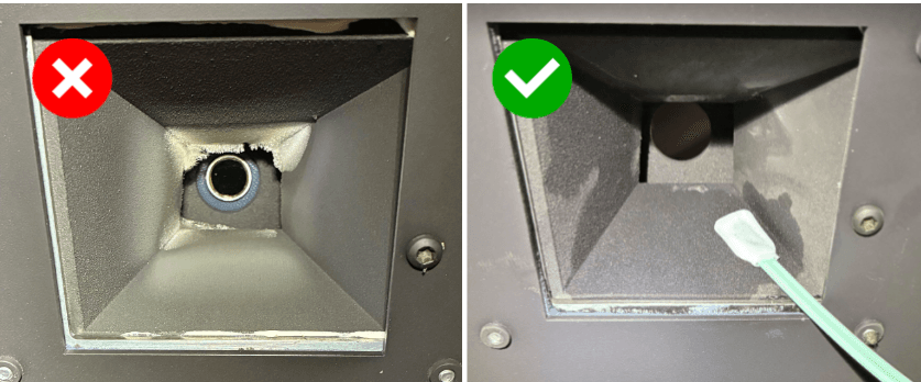

  2. Use a telescoping mirror wand to locate the inside of the IR sensor purge housing (item 19 in the figure below).
Fuse X1 product components - print chamber
  1. Use a polyester swab wetted with ethanol to wipe the inner surface of the purge housing.

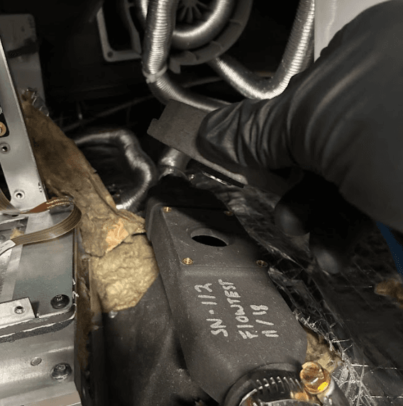

  1. Using an 8 mm hex driver, unlatch and open the maintenance access door, above the print chamber door.
  2. Unlatch the IR sensor from the printer.

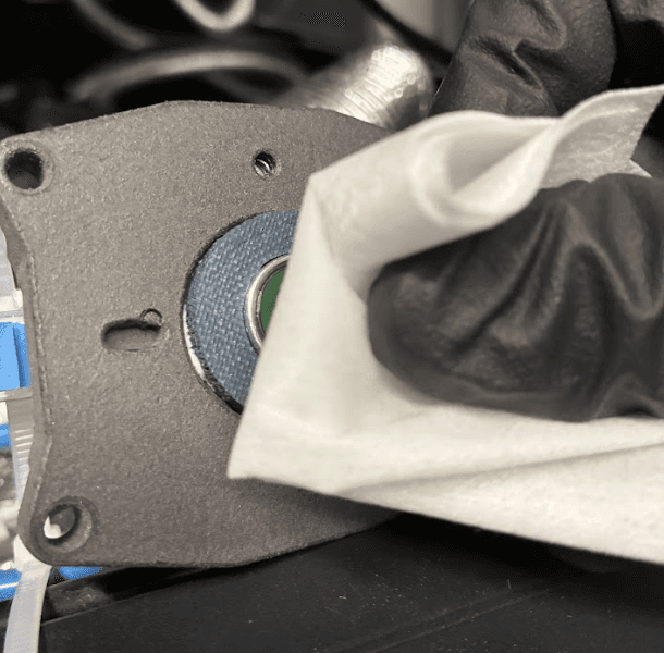

  3. Remove the IR sensor and use a microfiber cloth wetted with ethanol to wipe the surface of the lens.
