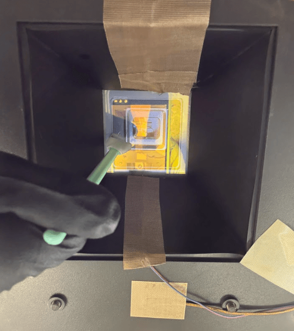

To clean the lower laser window:
Open the print chamber door.
Use a telescoping mirror wand to locate the lower laser window (item 18 in the figure below).
Use a polyester swab wetted with Alconox to wipe the surface of the window.
Use a new polyester swab wetted with distilled water to wipe the surface of the window and remove any Alconox residue.
Use a new polyester swab wetted with ethanol to wipe the surface of the window. Allow the ethanol to evaporate before continuing to use the printer.
