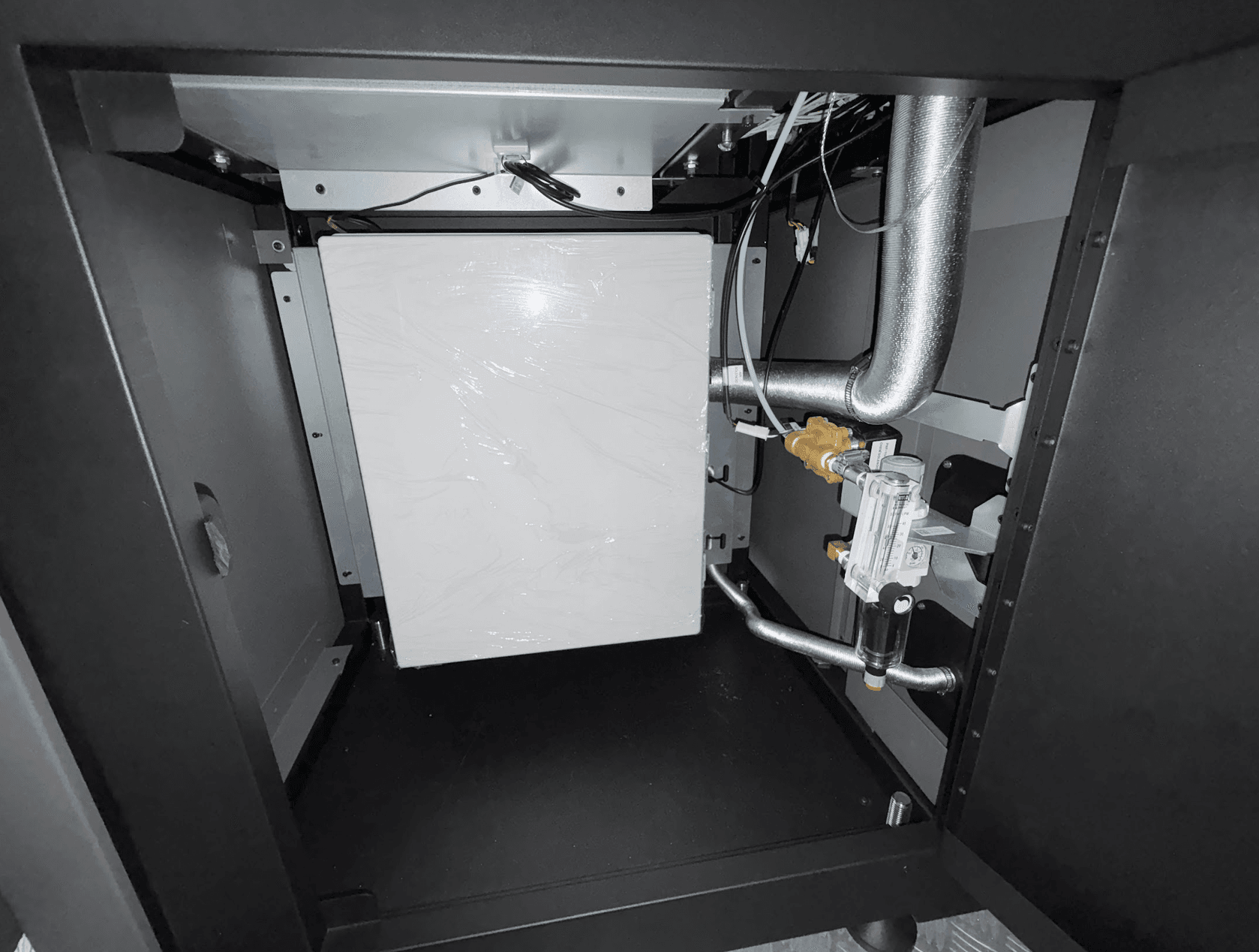

  1. Using an 8 mm hex driver, unlatch and open the air handling access door, on the right side of the printer.

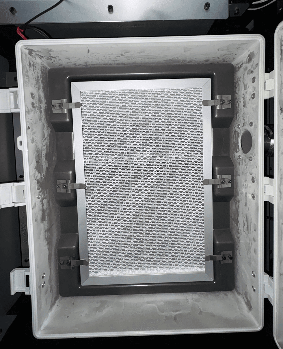

  2. Unlatch and open the exhaust filter box.
  1. Unlatch and remove the exhaust filter.
  2. Remove the exhaust filter and set it aside.

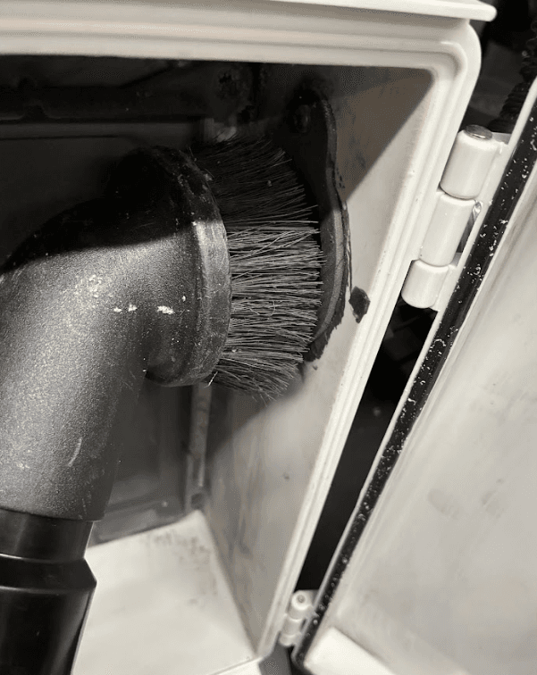

  3. Turn on your vacuum and hold the inlet to the exhaust tube for at least 30 seconds.
  1. Turn off the vacuum.
