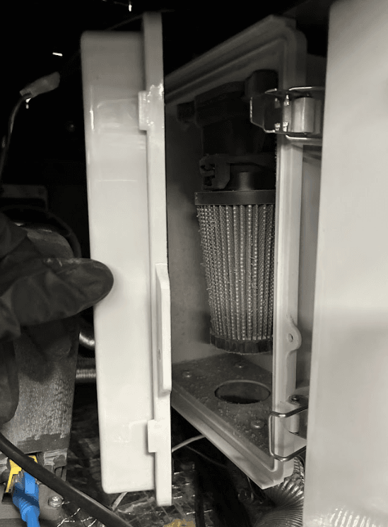

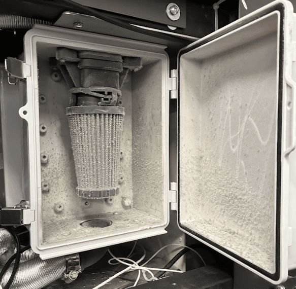

  3. Unlatch and open the IR sensor or camera purge filter box.

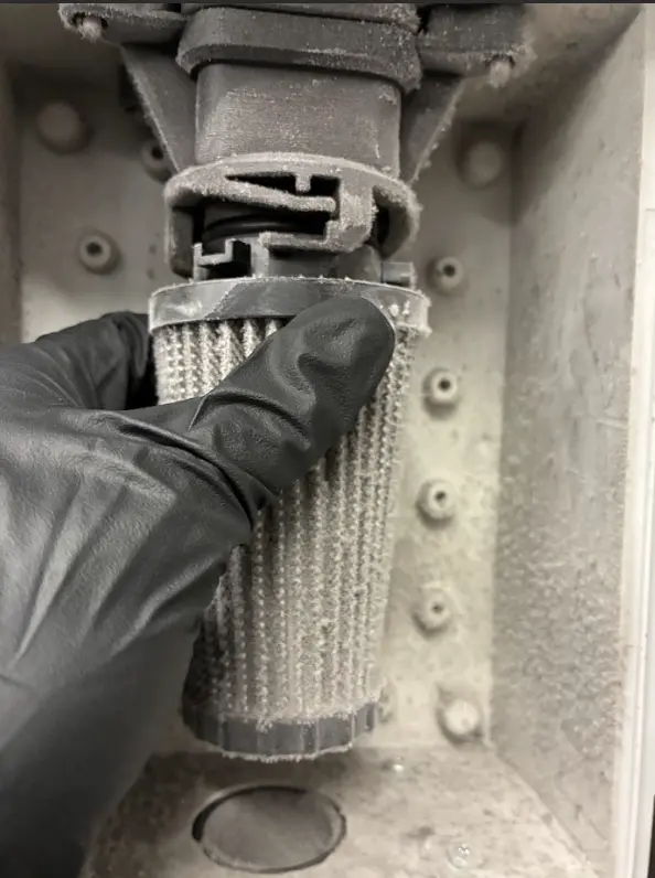

  1. Twist and pull downward to remove the cone filter

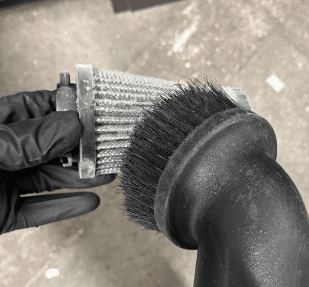

  1. Use a vacuum with a brush attachment to clean the pleats of the filter and the inside of the filter box.
