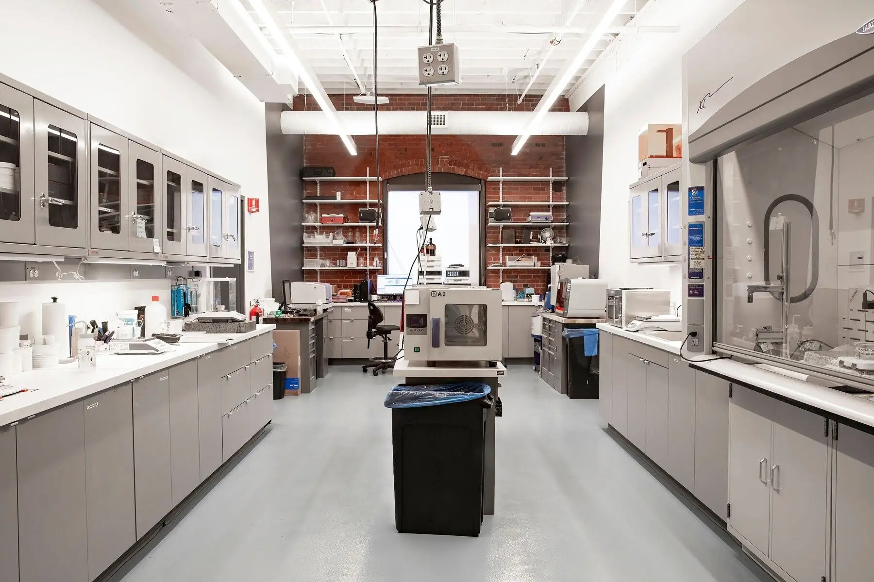

Formlabs employs more than 40 materials scientists and engineers who research, develop, and test the materials.
Formlabs Materials Lab in Somerville, USA

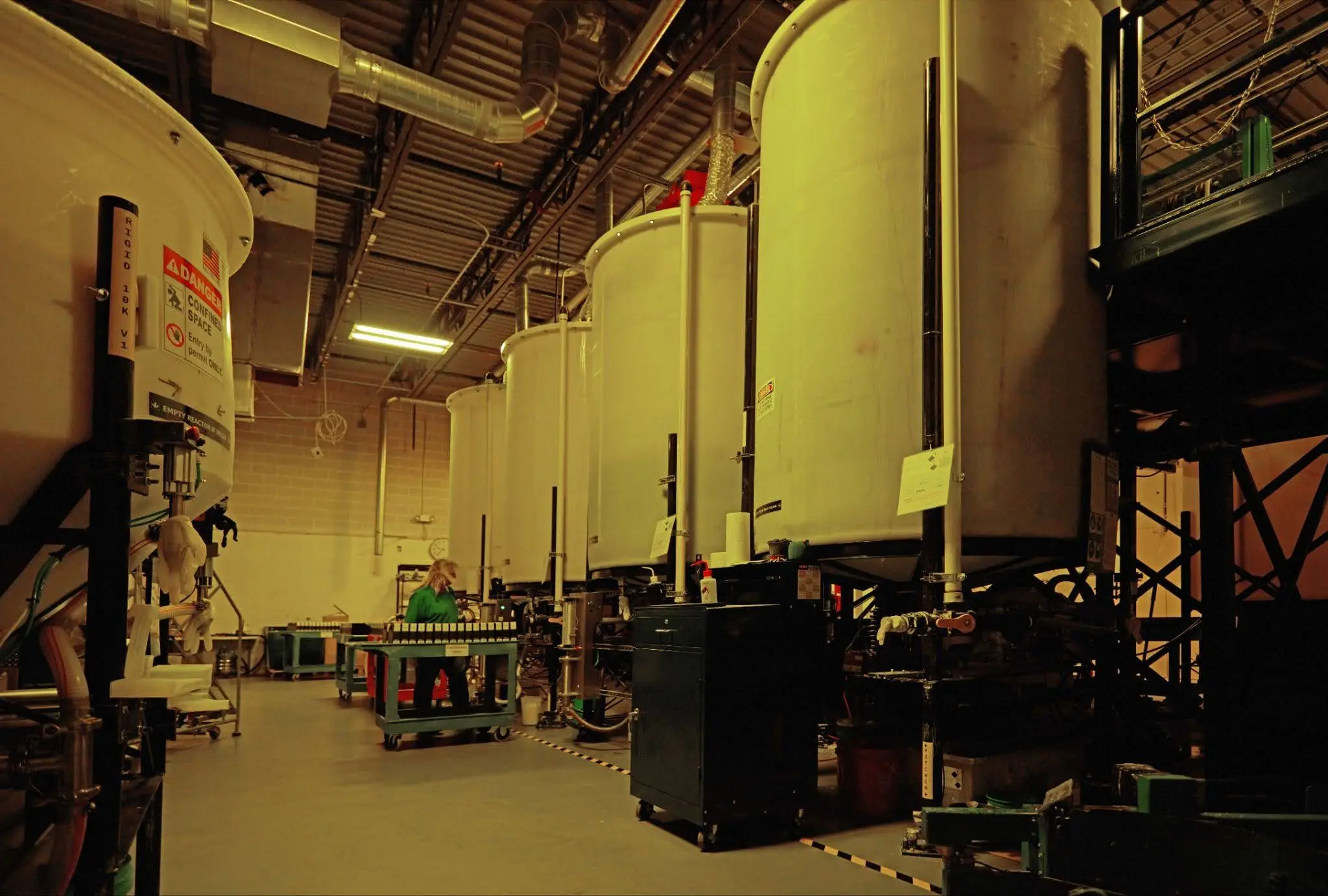

Formlabs resin manufacturing facility in Ohio, USA
Our commitment to quality and reliability doesn't stop at the printer. That means holding our materials manufacturing to the same standards, which is why we produce all of our resins in our own facility in Ohio. Our biocompatible materials are made in a fully regulated environment from start to finish. These materials are designed and manufactured within our robust Quality Management System that is ISO 13485 and EU MDR certified. A dedicated team of operators and quality assurance professionals makes the resins inside a certified ISO Class 8 cleanroom.

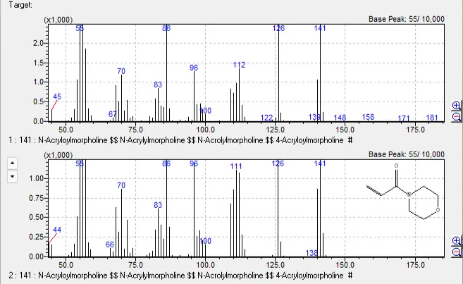

Method
To identify ACMO in 3D printing resins we use Gas-Chromatography Mass-Spectrometry (GCMS). In this process resin is separated into its pure constituent components and analyzed with a mass spectrometer. The mass spectrometer ionizes molecules and measures the abundance of fragments at different mass-to-charge ratios (m/z). This produces a chemical fingerprint (trace) in the form of a mass spectrum for each ingredient in the mixture, which can be compared to known references for identification. In all the resins tested in which ACMO was identified, the relevant mass spectrum was more than 95% similar to the reference spectrum (see below)
Mass spectrometry trace (abundance vs m/z) of a target monomer (top) as compared to the known ACMO Reference (bottom).
