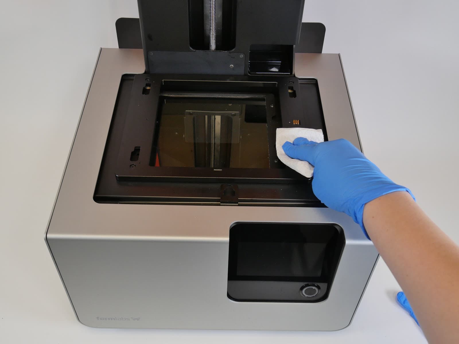

Step 1: Prepare the printer
1. Disconnect the power cable from the printer.
2. Remove the build platform first to avoid dripping resin onto the optical window.
3. Wipe off any resin on the build platform surface. Ambient light cures liquid resin left on the build surface, which renders the build platform unusable.
4. Remove the resin cartridge and close the vent cap.
5. Remove the resin tank and cover it with the plastic lid. Make sure the tank is not leaking and set it aside on a clean paper towel.
6. If the resin spill is extensive, take photos of the spill to share with Formlabs Support.

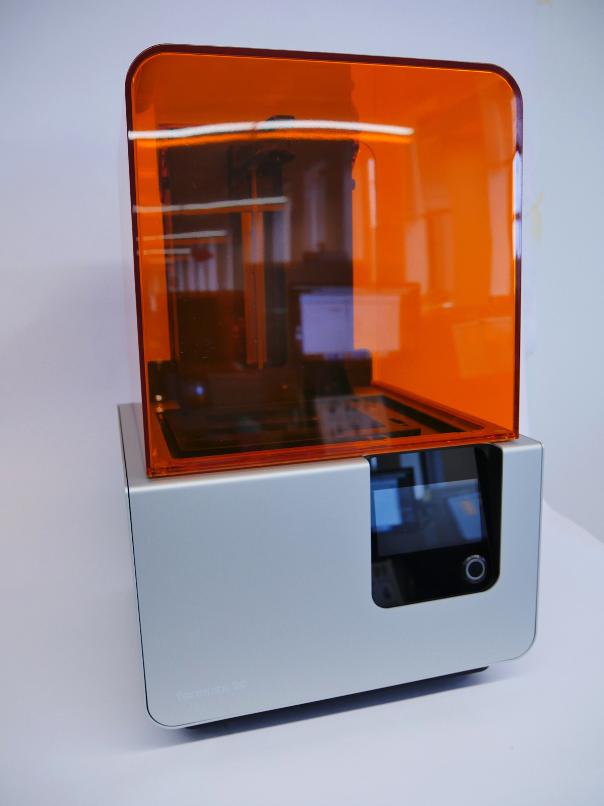

Orange cover
1. Inspect both the inside and the outside of the orange cover.
2. Clean any liquid resin from the orange polycarbonate with soapy water and paper towels.
Notice:
Do not clean the polycarbonate orange cover with IPA or other chemicals because this can cause cracks. To prevent damage to the cover, use only Novus 1 or a similar plastic cleaner.

  1. Absorb liquid resin on external surfaces of the shell with paper towels. Allow the paper towel to absorb the resin. Avoid smearing resin across the surface.
  2. If resin has cured on the surface of the shell, scrape off the cured resin using a plastic spatula. A metal spatula may scratch the aluminum shell.
  3. Clean remaining resin off external surfaces with soap and water.

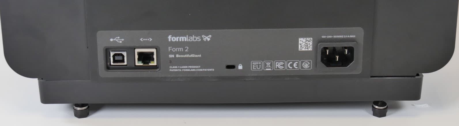

USB port, ethernet port, power jack
  1. Inspect the USB port, Ethernet port, and power jack on the back of the printer for resin contamination.
  2. If needed, clean the contacts inside the ports or power jack using cotton swabs and soapy water.

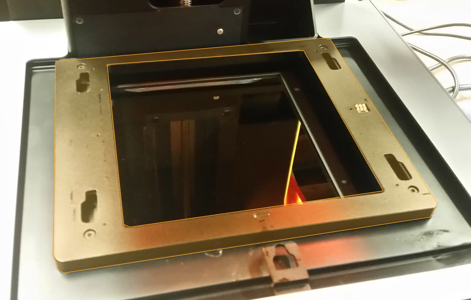

Step 3: Inspect and clean components under the cover
Open the cover to inspect the following components under the cover: the tank carrier, the shuttle cover, the tank spring fingers, the LevelSense board, and the optical window.

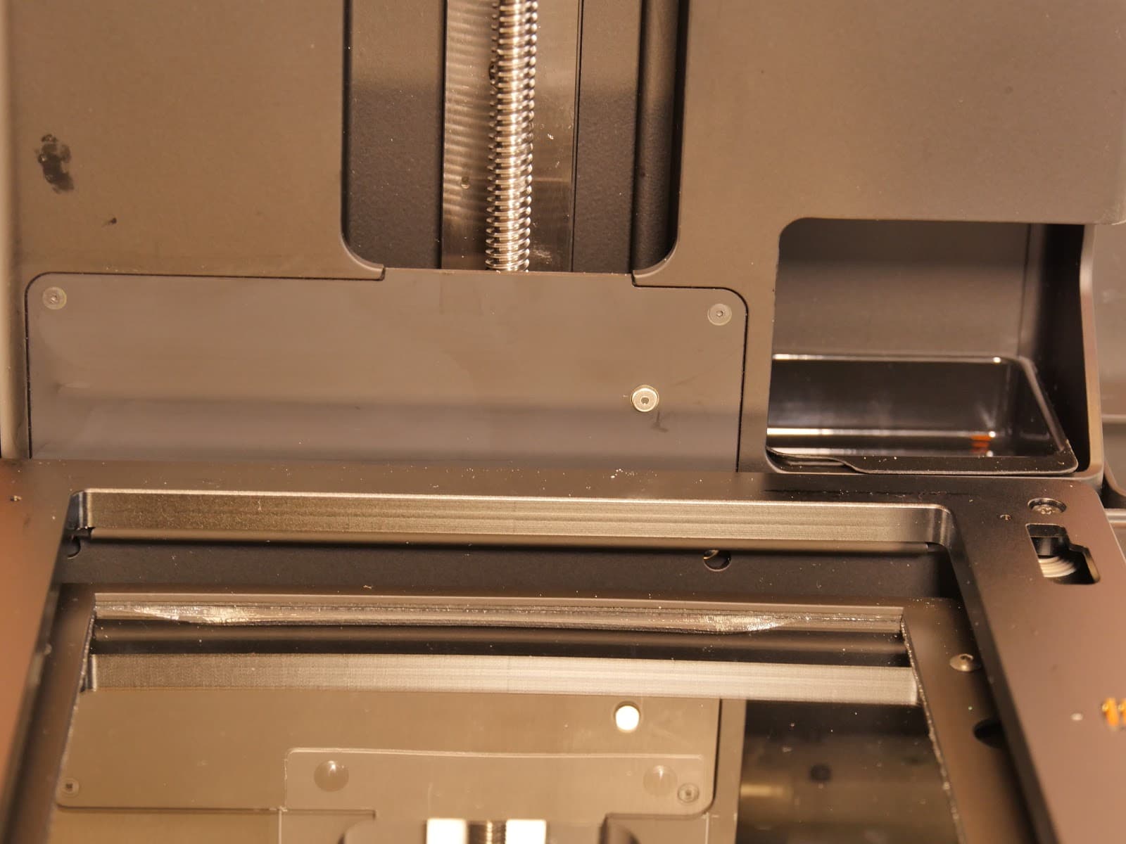

Tank carrier and shuttle cover
  1. Apply paper towels to absorb and wipe up liquid resin on the tank carrier and shuttle cover.
  2. Clean surfaces with soap and water.
Notice:
Never tamper with the star-shaped Torx screws or attempt to remove the tank carrier. Tampering with the tank carrier screws may void your warranty and may require returning the Form 2 for re-calibration.
  1. Push the tank carrier from side to side to access the areas under the edges.
  2. Check for resin in the reservoir located on the front left corner of the shuttle cover. Use a syringe to remove excess resin from the reservoir.
  3. If resin has spilled into the printer body, contact Formlabs Support.

Optical window
  1. Visually inspect the optical window with an oblique light source. Follow Formlabs instructions for Cleaning the glass optical window.
Step 4: Inspect the Z axis
Z-tower and drip catcher
  1. Clean any resin droplets on the Z-tower with a paper towel or cotton swab dampened with soapy water.
  1. Shine a flashlight on the drip catcher in the base of the tower and visually inspect it for spilled resin.
  2. Soak up any resin with a paper towel.
  3. Remove pooled resin using a syringe.
  4. Clean any final traces of resin with a small amount of soapy water and a clean paper towel.

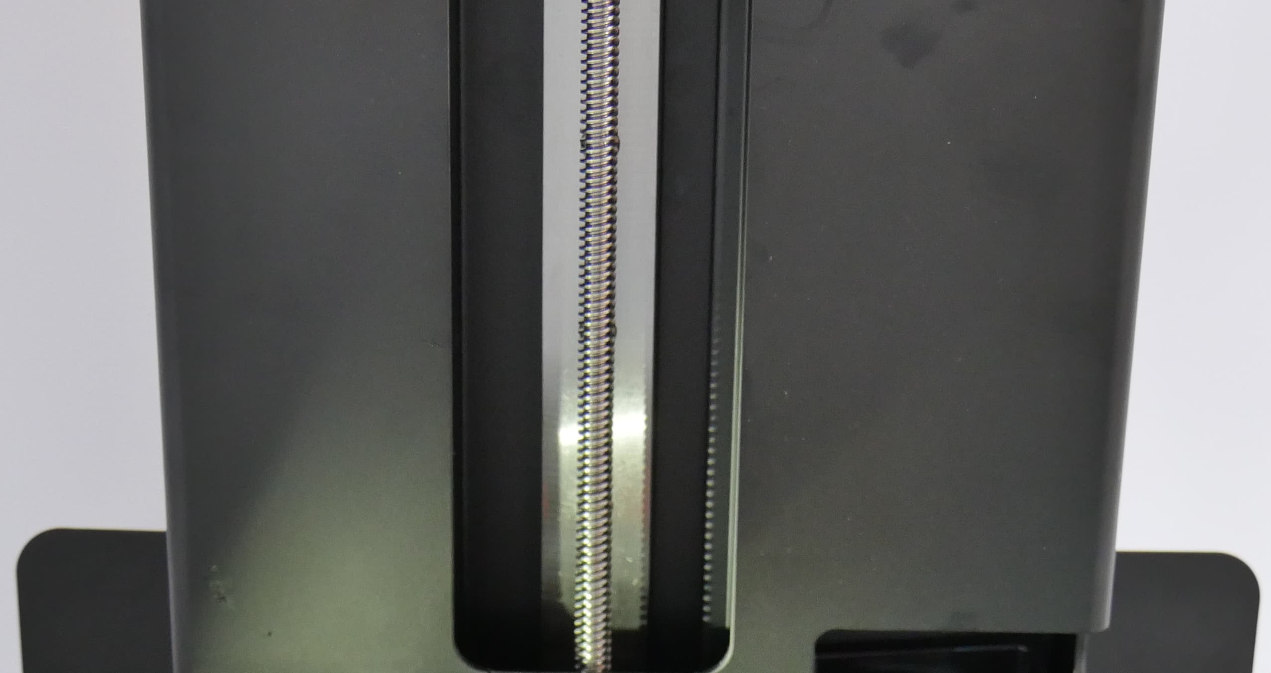

Z-motor and lead screw
  1. Shine a flashlight down the lead screw and inspect the Z-motor inside the bottom of the tower to determine whether resin has seeped down the lead screw and into the bearings. If resin has seeped into the bearings or motor, take photos and contact Formlabs Support or your authorized reseller for additional assistance.
  2. If there is resin on the lead screw, but the Z-motor itself is clean, remove the resin on the lead screw with a paper towel or cotton swab and a small amount of IPA.
Tip:
If the lead screw is cleaned with IPA, lubricate the lead screw with Super Lube with Syncolon or another PTFE lubricant grease of any brand before printing again to prevent build platform movement issues.

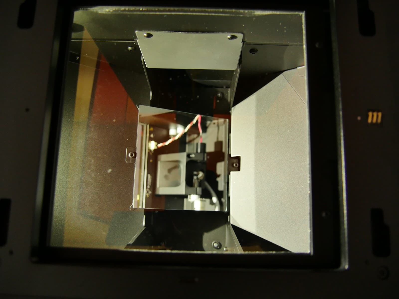

Step 6: Inspect the optical cavity
  1. With the cover open, look through the optical window to inspect the optical cavity.
  2. Check for any resin inside the printer, particularly on critical components such as the main mirror.
  3. If you see resin inside the printer, contact Formlabs Support or your authorized reseller for additional assistance.
