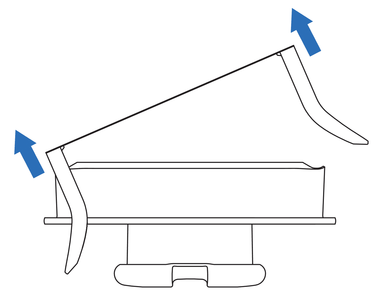

  2. Place the build platform on your work surface. Lift one side of the print surface by the part release paddle.
Lifting one side of the print surface

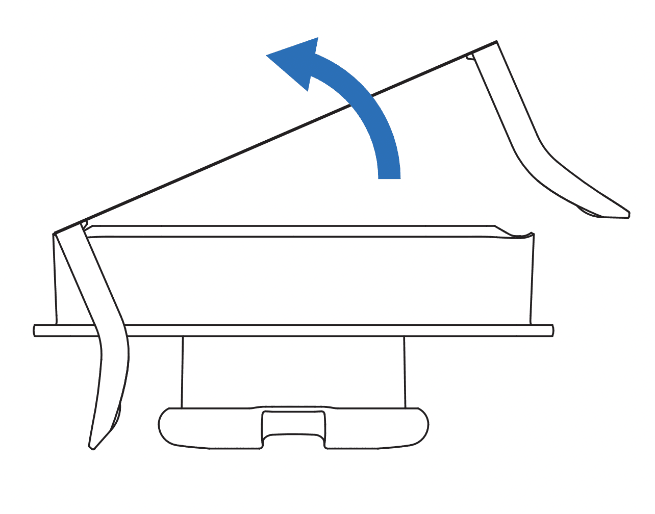

  1. Push up on both part release paddles to disengage the print surface from the build platform body.
Pushing up on paddles to disengage print surface
  1. Continue pulling the print surface off of the build platform to fully separate the two components.
Separating print surface from build platform body

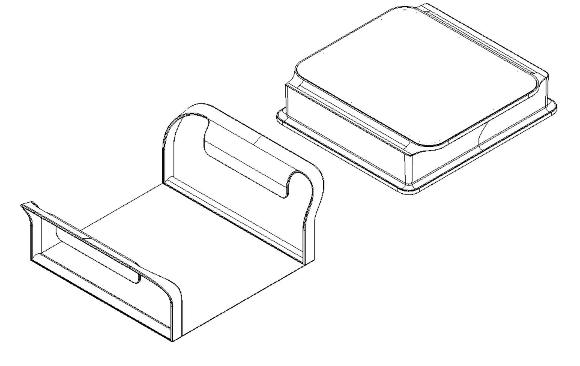

Step 2: Clean the Build Platform 2
  1. Place the print surface in a Form Wash or Form Wash L basket.
  2. Insert the build platform body into the build platform mount of the Form Wash or Form Wash L.
  3. Wash the build platform body and the print surface with Isopropyl alcohol (IPA) or tripropylene glycol monomethyl ether (TPM) for 5 minutes.
  4. Make sure the build platform body and print surface are completely dry and clean of any resin or solvent.

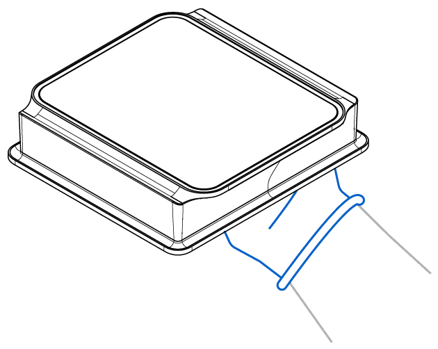

  1. Hold the build platform body by the center handle or secure it on a build platform jig.
Holding build platform body face up

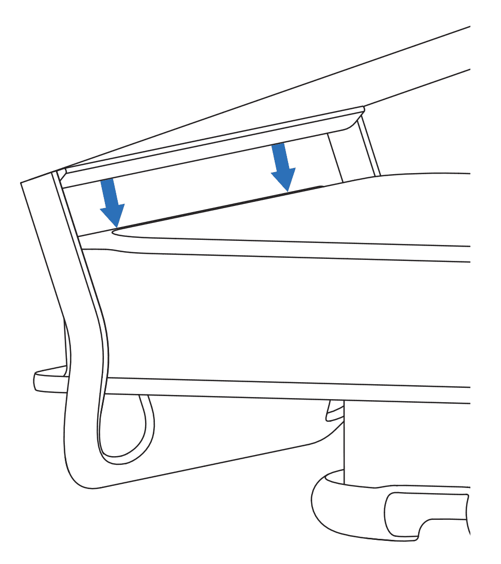

  1. Align the edge of the print surface with the alignment channel. Magnets within the alignment channel help to properly position the print surface’s alignment rod. The alignment rods must sit in the alignment channels for the Build Platform 2 to operate as intended.
Aligning print surface edge with channel
  1. Rotate the print surface downward onto the build platform body.
Rotating print surface downward
  1. Squeeze the part release paddles to fully seat the print surface alignment rods into their respective alignment channels. Ensure the print surface is clean and properly aligned.
