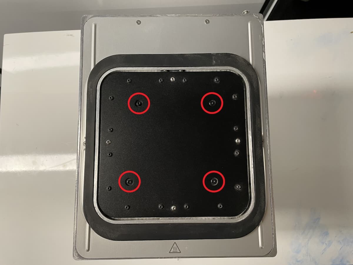

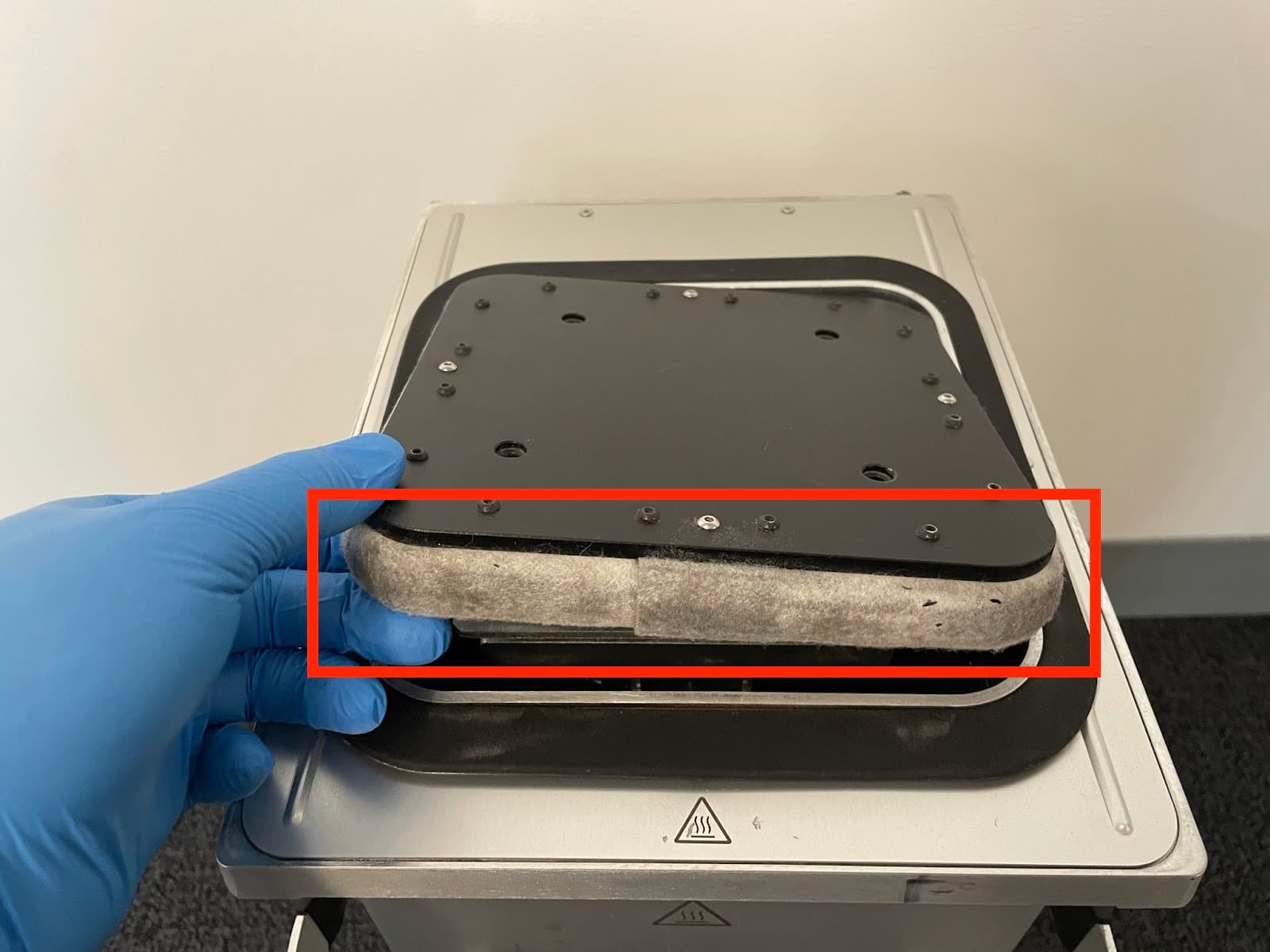

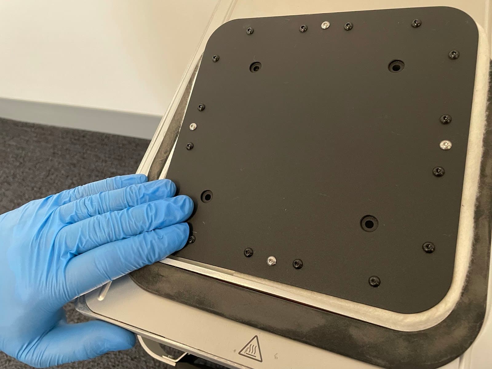

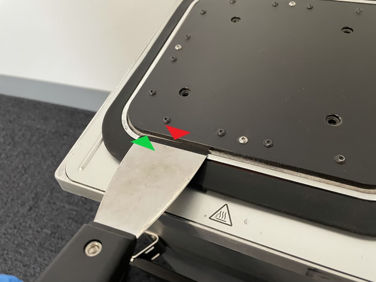

Step 2: Remove the print bed
Step 3: Vacuum the felt seal
Using a vacuum cleaner with a crevice attachment, vacuum as much powder from the felt seal as possible. You may need to use a scrubbing motion to break apart clumps of powder.

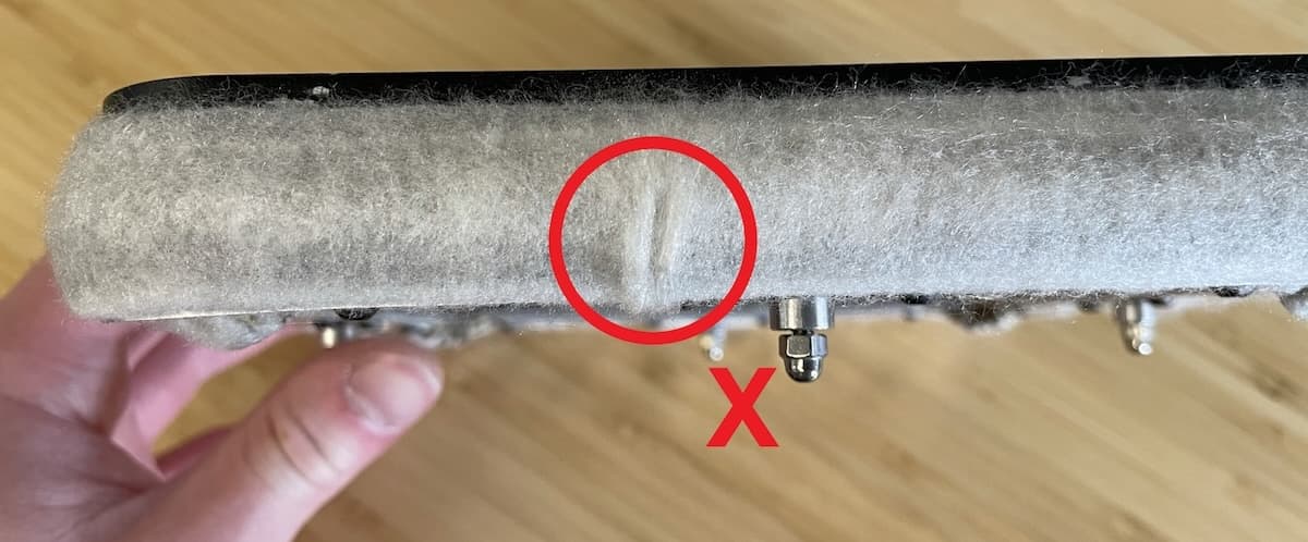

If there is obvious damage to the felt, such as a tear or melted material that is impossible to remove, replace the print bed assembly. The print bed assembly is available from the Formlabs Store. Follow the guide Replacing the Fuse 1 generation build chamber print bed [EN] [DE] [ES] [FR] [IT] [JA] [ZH] to replace the component.

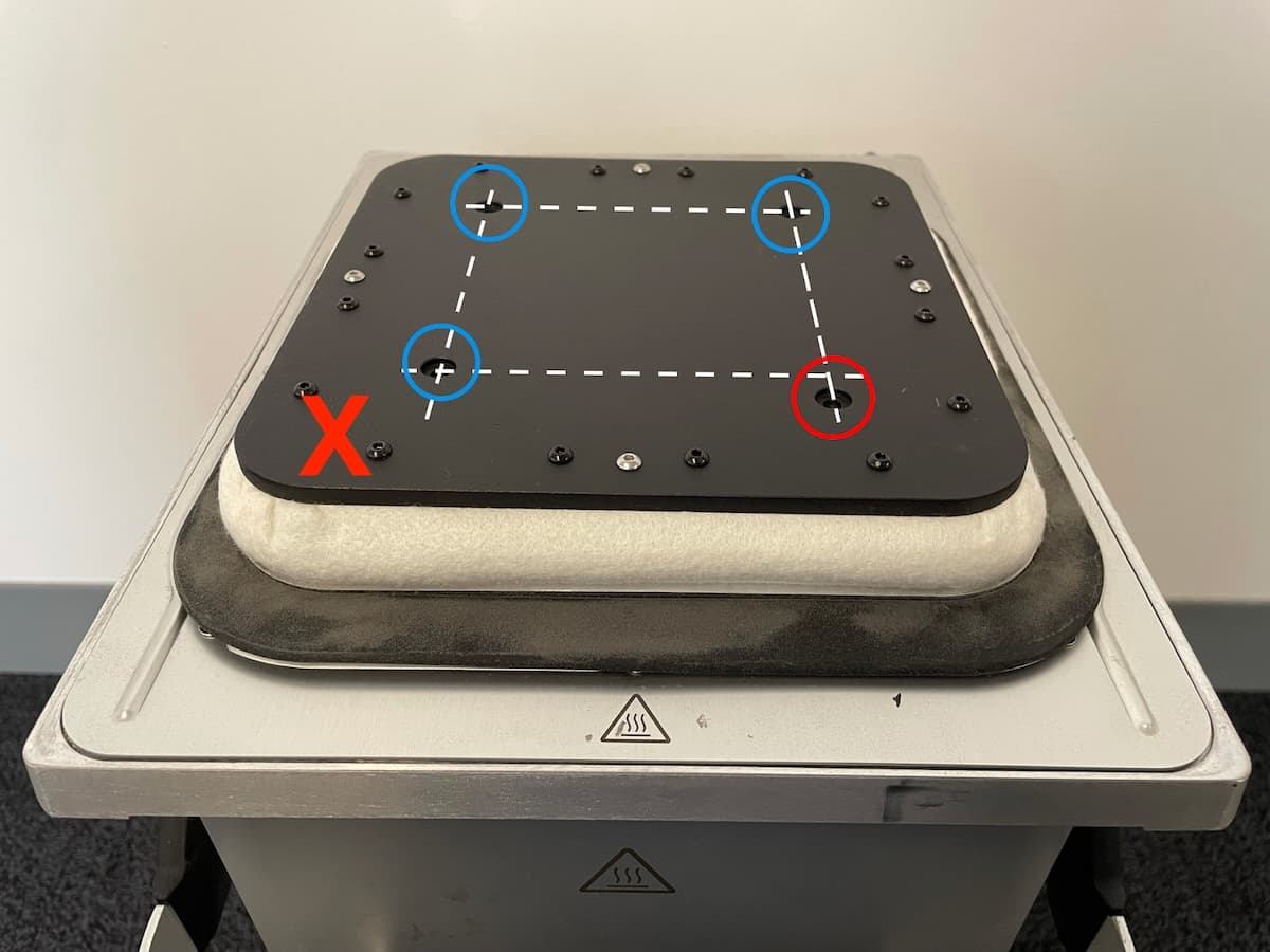

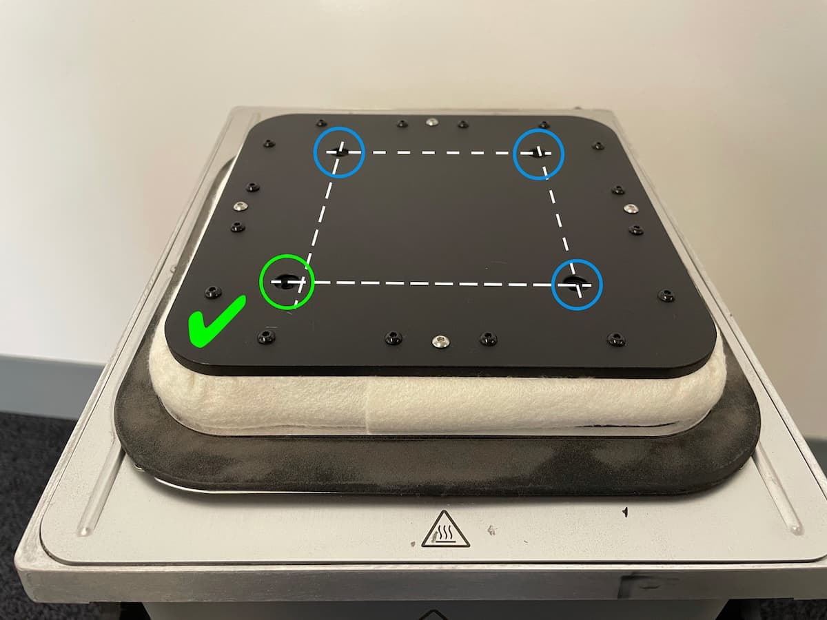

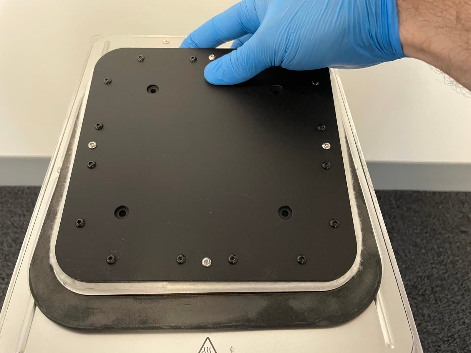

Step 4: Replace the print bed
