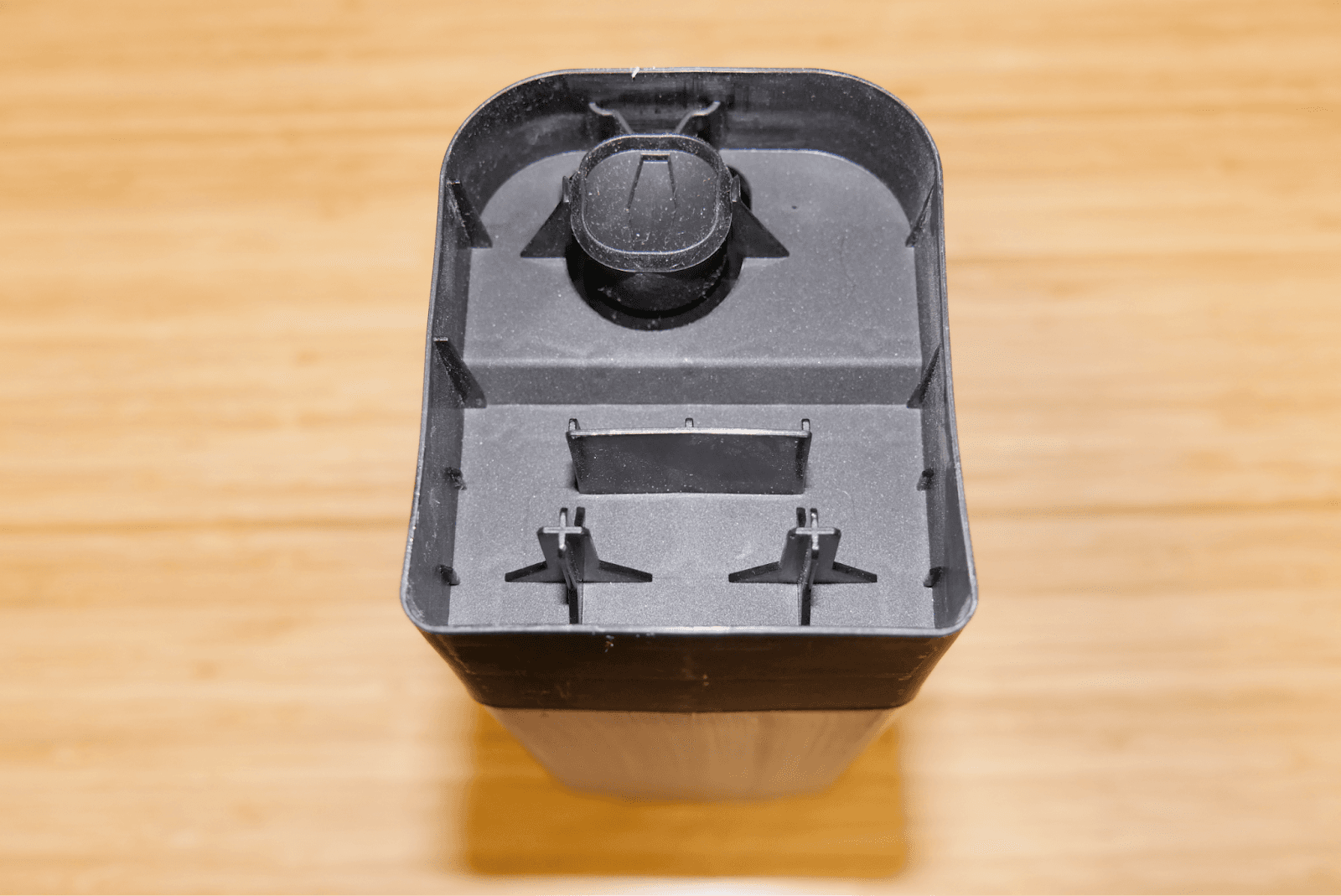

Resin cartridges (Form 4 and Form 4L generation)
Form 4 and Form 4L generation resin cartridges do not use ID chips, but contain RFID stickers that should not require maintenance. Contact Formlabs Support or your authorized reseller if the printer is unable to detect the cartridge.
When you insert a resin cartridge into a Formlabs SLA printer and start a print, the printer reads the sticker to check that the resin in the cartridge matches the resin in the tank and the resin type of the FORM file.
When printing, the resin dispensing system writes data to the RFID sticker as it dispenses resin from the cartridge. This allows any printer that prints with the cartridge to know how much resin is left and whether there is enough to complete the print job.
The bottom of a Form 4 resin cartridge showing the bite valve
Adjacent to the ID chip is a bite valve. When compressed, the bite valve opens slightly. If the cartridge vent cap at the top of the cartridge is also open, resin flows from the cartridge into the tank.

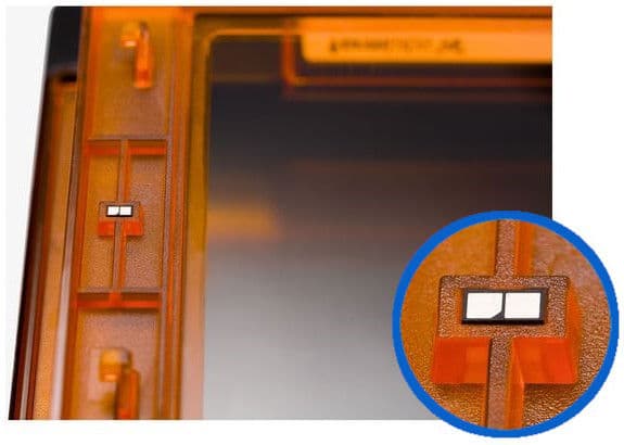

Form 2
Form 2 standard resin tank ID chip.
Maintain the Form 2 standard resin tank ID chip and Form 2 Resin Tank LT ID chips to ensure that the printer can recognize and interact with the resin tanks.

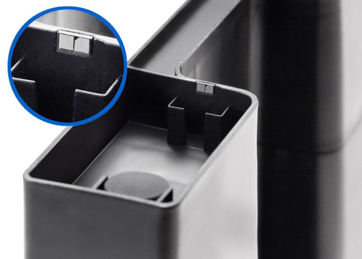

Form 3/Form 3B
Form 3/Form 3B resin tank ID chip.
Maintain the Form 3 resin tank ID chip to ensure that the printer can recognize and interact with the resin tank.

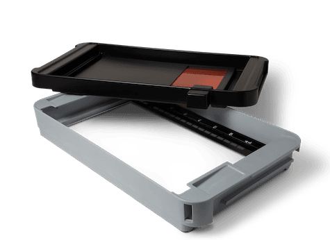

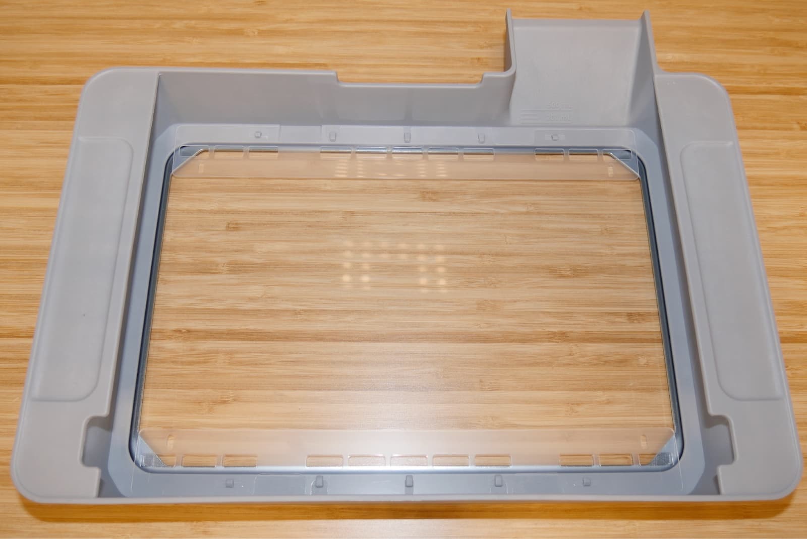

Form 3L/Form 3BL
Form 3L/Form 3BL resin tank.
The Form 3L resin tank stores data on an RFID sticker. The RFID sticker does not need regular maintenance.

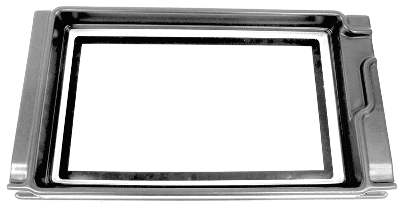

Form 4/Form 4B
Empty Form 4 resin tank
The Form 4 resin tank stores data on an RFID sticker. The RFID sticker does not need regular maintenance.
Form 4L/Form 4BL
Form 4L/Form 4BL resin tank.
The Form 4L resin tank stores data on an RFID sticker. The RFID sticker does not need regular maintenance.

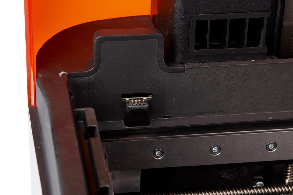

Formlabs SLA printers have a component known as LevelSense, that measures the amount of resin in the resin tank during a print. By monitoring the resin level, the printer can automatically dispense resin from the cartridge into the tank whenever the resin in the tank begins to run low. As long as the cartridge isn’t empty, the print won’t pause or fail because there isn’t enough resin in the tank.

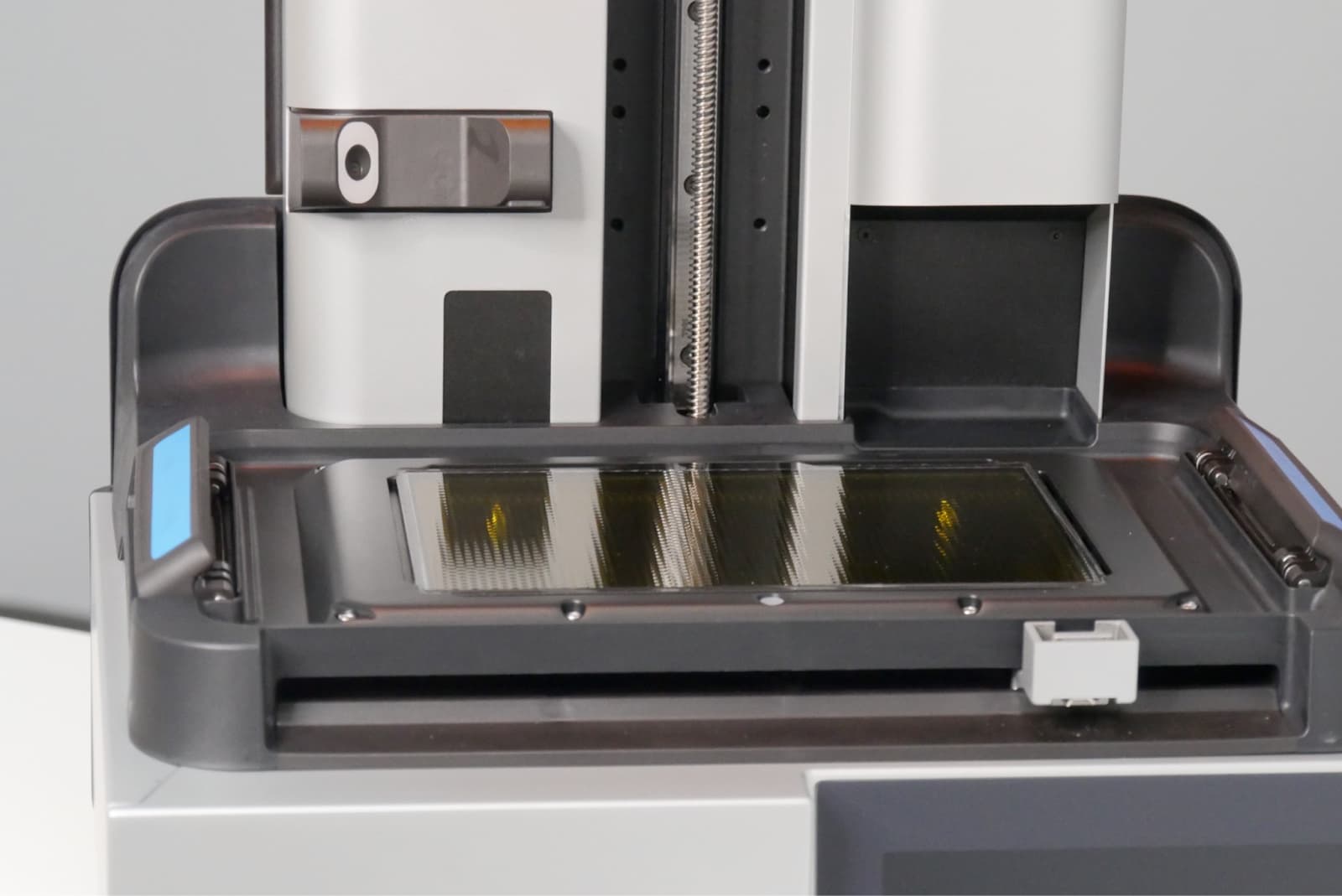

Form 2
The LevelSense board in the Form 2 is located behind the resin tank, at the base of the Z-tower. It measures the height of the resin in the tank.
Form 2 LevelSense board

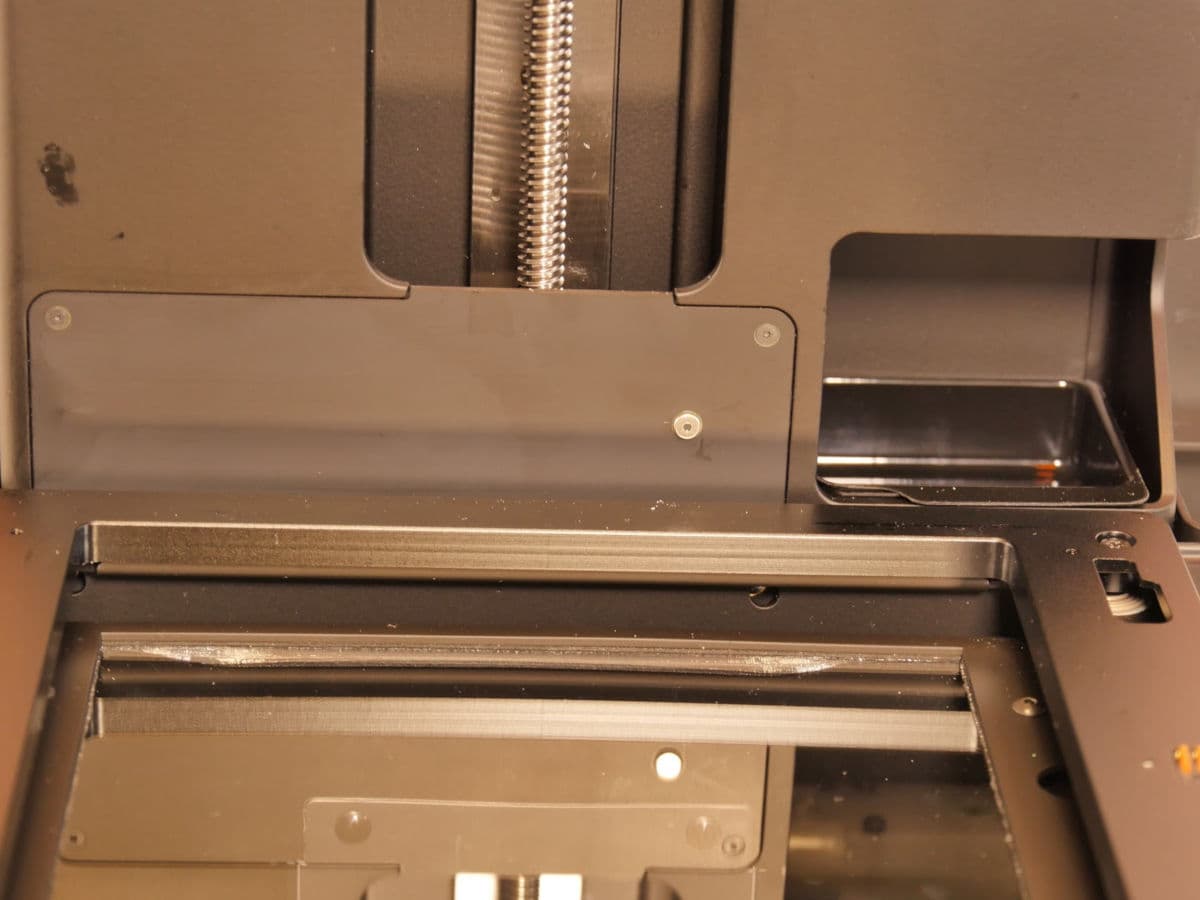

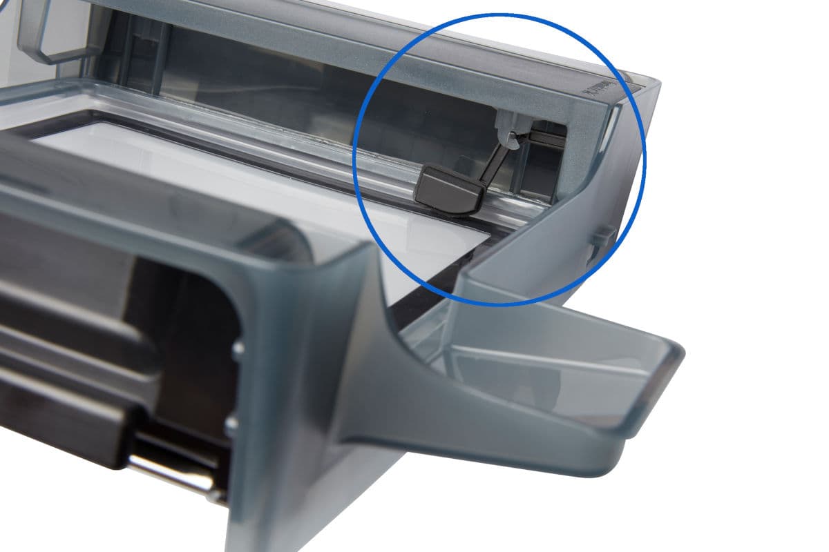

Form 3/Form 3B
The LevelSense board in the Form 3/Form 3B is located behind the resin tank, at the back-left of the printer.
Form 3/Form 3B LevelSense board
The LevelSense board tracks the height of the float, located in the mixer case on the left side of the resin tank.
Form 3/Form 3B resin tank float

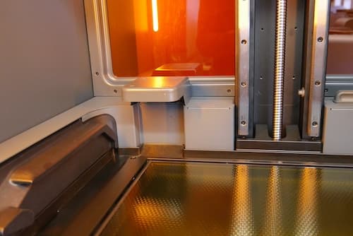

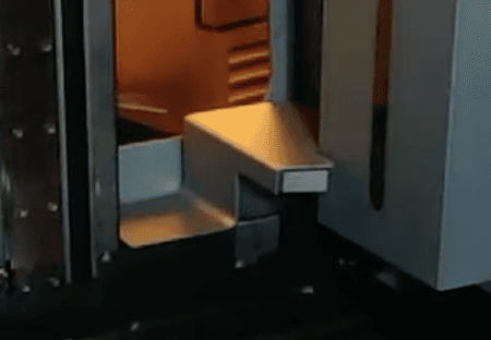

Form 3L/Form 3BL
The LevelSense system in the Form 3L/Form 3BL is located above the rear right-hand corner of the resin tank. The LevelSense system points down into the resin tank to measure the amount of resin in the resin tank.
The LevelSense board on the Form 3L/Form 3BL is located on the right side of the printer and points directly down into the resin tank.

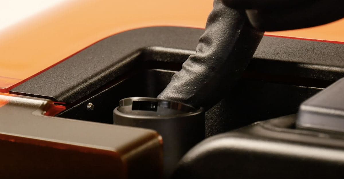

The LevelSense ultrasonic sensor is located above the rear left-hand corner of the resin tank.
Form 4 LevelSense ultrasonic sensor location

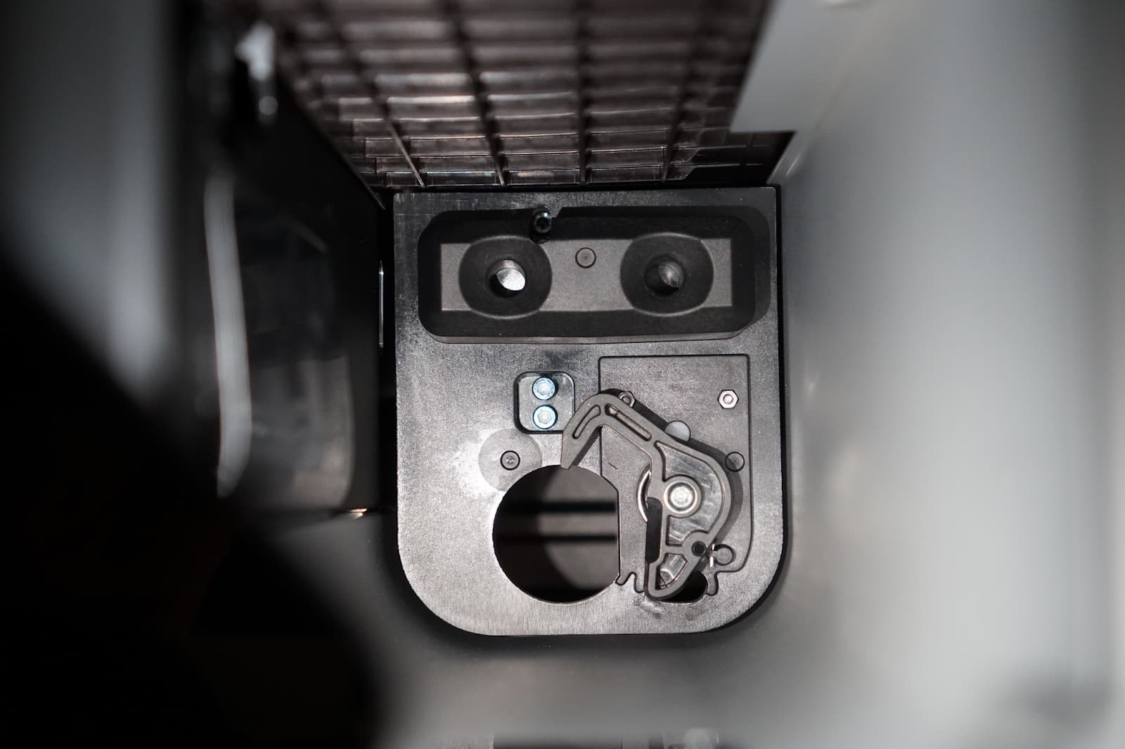

Resin dispensing

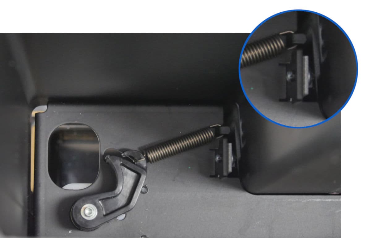

The cartridge floor contains a set of spring fingers that read the cartridge ID chip and a motorized dispense arm attached to a spring.
Note:
The cartridge floor on Form 3L and Form 4L printers has two sets of spring fingers and dispense arms so that two cartridges can be inserted into the printer at the same time.
Closeup of the Form 2, Form 3/3B, and Form 3L/3BL cartridge floor with an inset of the spring fingers
The Form 4 cartridge floor
Using measurements from the LevelSense system, the printer determines if the resin tank needs to be refilled and activates the dispense arm underneath the resin cartridge.
The dispense arm, driven by a motor underneath the cartridge floor, squeezes the bite valve on the bottom of the resin cartridge. Once the tank is refilled, the spring attached to the dispense arm pulls it out of the way so that no resin is dispensed inadvertently.
