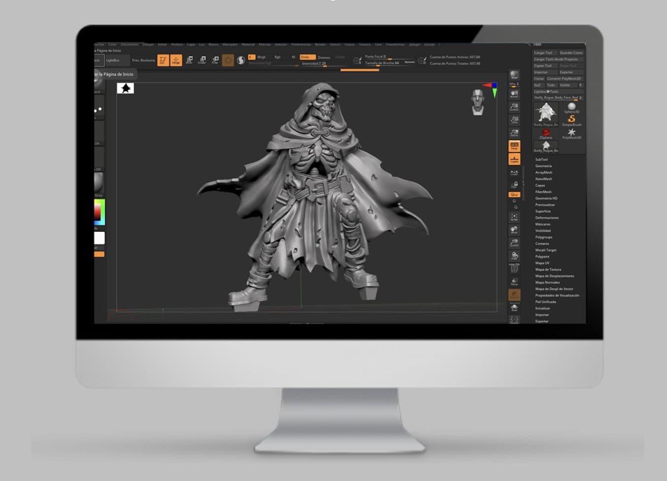

1. Digital Moldel Design
3D model design from Broken Anvil Miniatures.
Using CAD software, the designer models the parts in as much detail as possible, as those will be reflected in the 3D printed part, and then later transferred to the SiOCAST mold, and further to the molded parts. Designs with heavy undercuts are also possible to manufacture with the SiOCAST process. Currently, the maximum thickness of the final parts done with the SiOform1 is 40 mm. During the process, the injection molding gates are also added from their standardized file library.

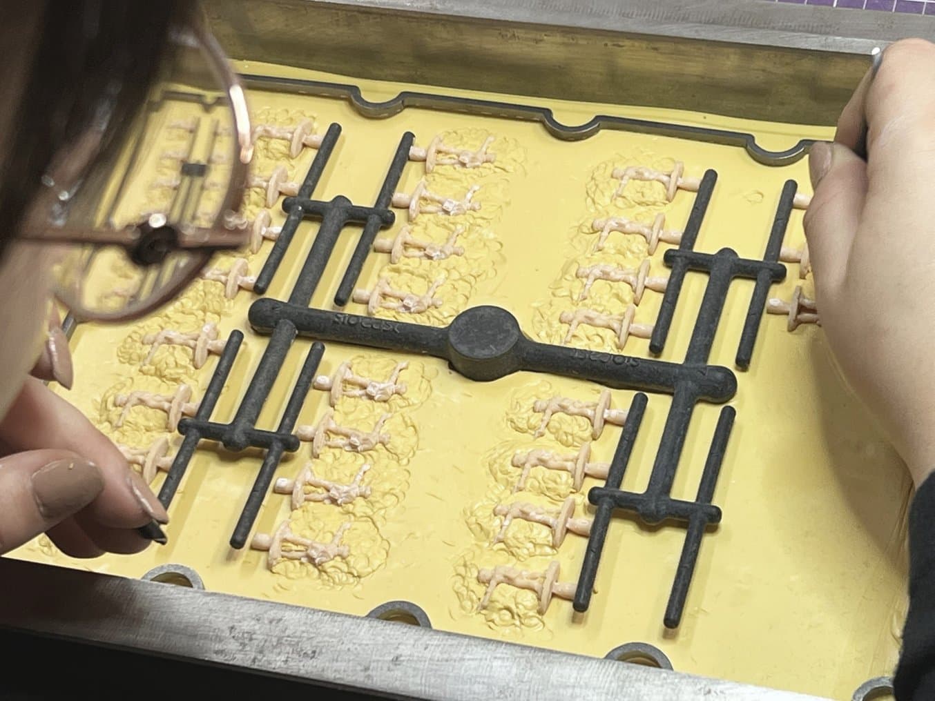

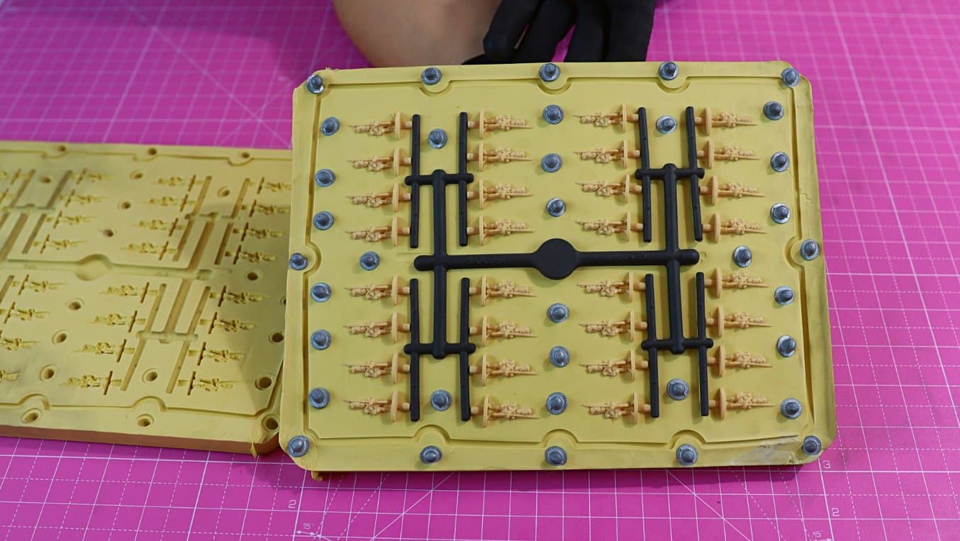

With the 3D printed masters and runners in hands, the next step is to create the molds with the SiOmold silicone rubber. They are SiOCAST’s hard HTV (high-temperature vulcanization) silicone material with 65 or 80 Shore A hardness, composed of an elastomer custom-made by the CONIEX group with extraordinary thermal and mechanical resistance. The silicone laminate is placed inside a stiff and precise metal frame, made with CNC machining, and then the 3D printed masters are evenly set on top of the silicone and carefully settled by adding more silicone around it to find the desired parting line. The 3D printed SLS runners are also added and pressed into a nascent slab.

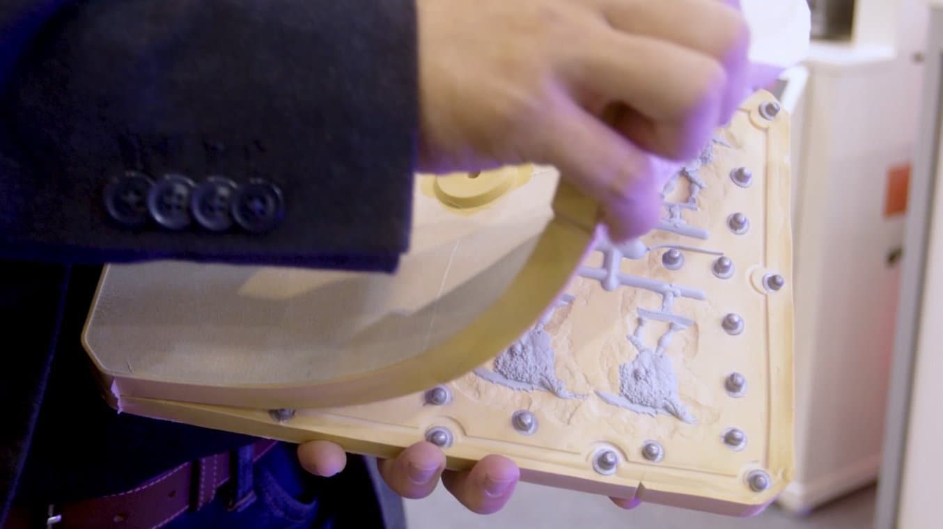

The centering guides are added to hold the two parts of the mold together. Then talcum is spread on top as a releasing agent that will prevent both sides of the silicone from sticking to each other. The top layer of silicone is added, and the metal box frame is closed. Depending on the mold complexity, this process can take from ten minutes to two or three hours.
The metal box then goes inside the vulcanizing press SiOpress, in which the silicone and 3D printed masters are pressurized at 10 bars to release the air, and heated at 120 degrees Celsius. During the 40-60 minutes vulcanization process, the silicone will become liquid, and at this moment, it is copying every single detail from the 3D printed masters before bonding the elastomer chains and becoming a vulcanized mold.
After cooling off, the mold is opened and the 3D printed masters are removed from the cavities, resulting in the final mold that will be used in the SiOCAST machine. The 3D printed masters can then be re-used in additional rounds of vulcanization.
We use a special releasing agent so the 3D printed masters won’t stick into the silicone after the vulcanization and they can be re-used to make the next mold. In general, a Formlabs 3D printed master is able to make three to four vulcanizations in total or several more.

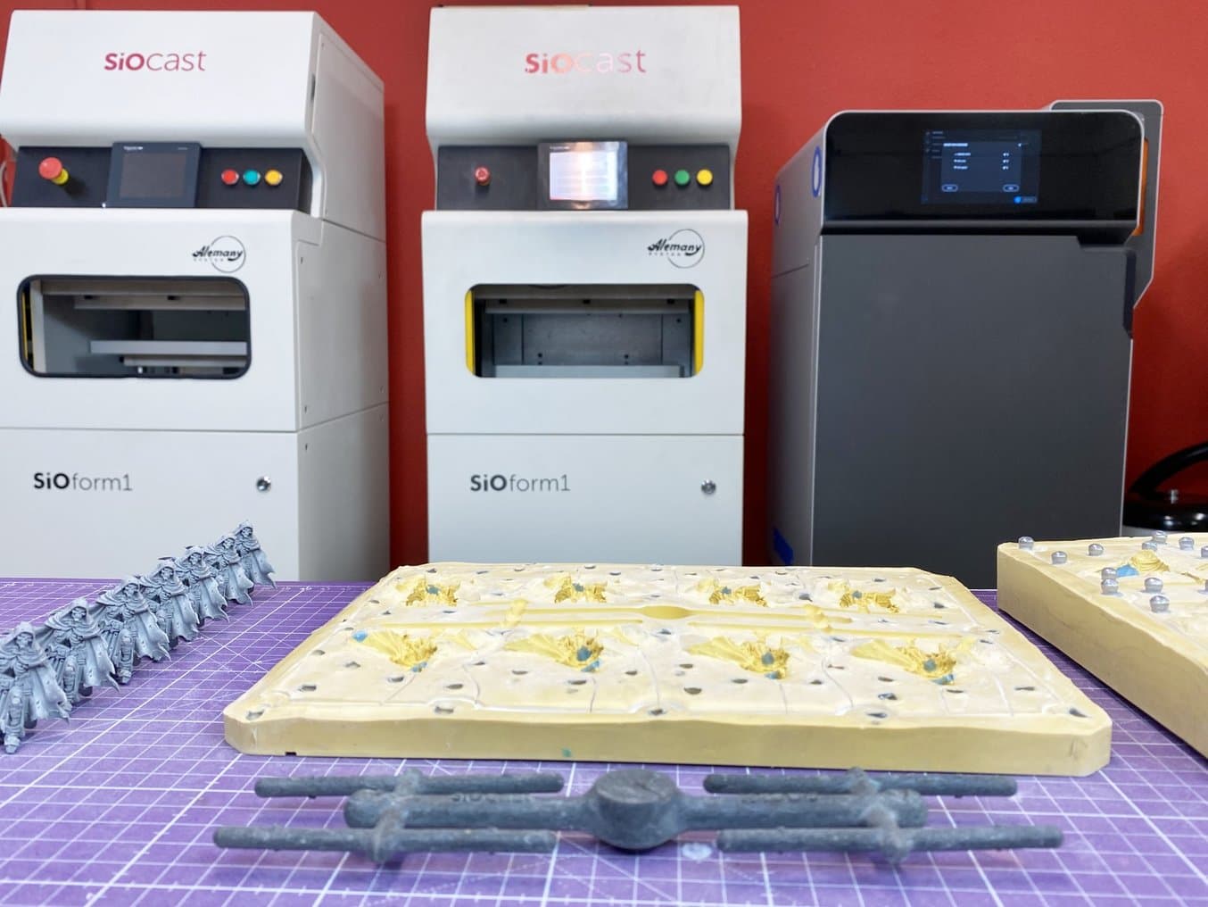

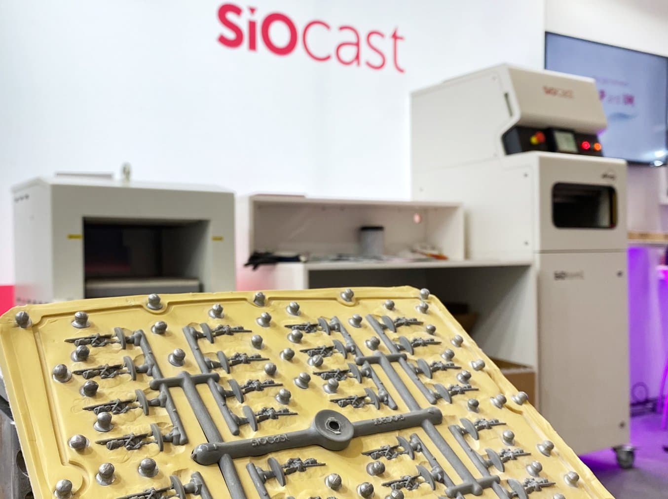

4. Miniature Production With the SiOform1
In the SiOform1, the two halves of the vulcanized rubber mold are fitted together and placed inside, the injection recipe is selected, and after the click of a button, the machine is already working: It removes the air from the mold and injects the liquified thermoplastic resin at 240 degrees Celsius.
Once the mold cools off, it can be removed from the machine. This whole part of the process takes only about 30 seconds (up to 1 minute if it’s a thicker mold), and a new mold can be inserted right away for the next batch.
After a few seconds of cooling off outside the machine, the first batch of miniatures can be removed from the mold and unsprued. The combination of SiOCAST’s thermoplastic resin with their internally developed silicone rubber makes the miniatures come out of the mold easily.
Each cast produces on average 4 to 64 miniatures, depending on the size of the parts and the volume, which is limited to 100g per shot, and the whole process is about 10 to 20 times faster than traditional resin casting.
You can rotate molds while you let them cool off before using them again in the machine. Normally you work with three to nine different molds that are rotating. You can do 25-40 castings an hour. And if there is an automation system, we can go up to between 60-80 injections per hour, making from 100 to 1000 parts per hour, all with the same detail level of the original 3D printed master.

Each silicone mold is 210 x 270 millimeters and can be up to 50 millimeters thick, which would accommodate final parts of up to 40 millimeters thickness. The molds can withstand about 300-500 castings, making this a viable option for both short-run and series production.
SiOCAST clients can either buy the final silicone molds directly from them with the readyCAST service or make their own molds in-house which is the standard preferred solution. The company offers a complete training package to capacitate beginners each step of the way.

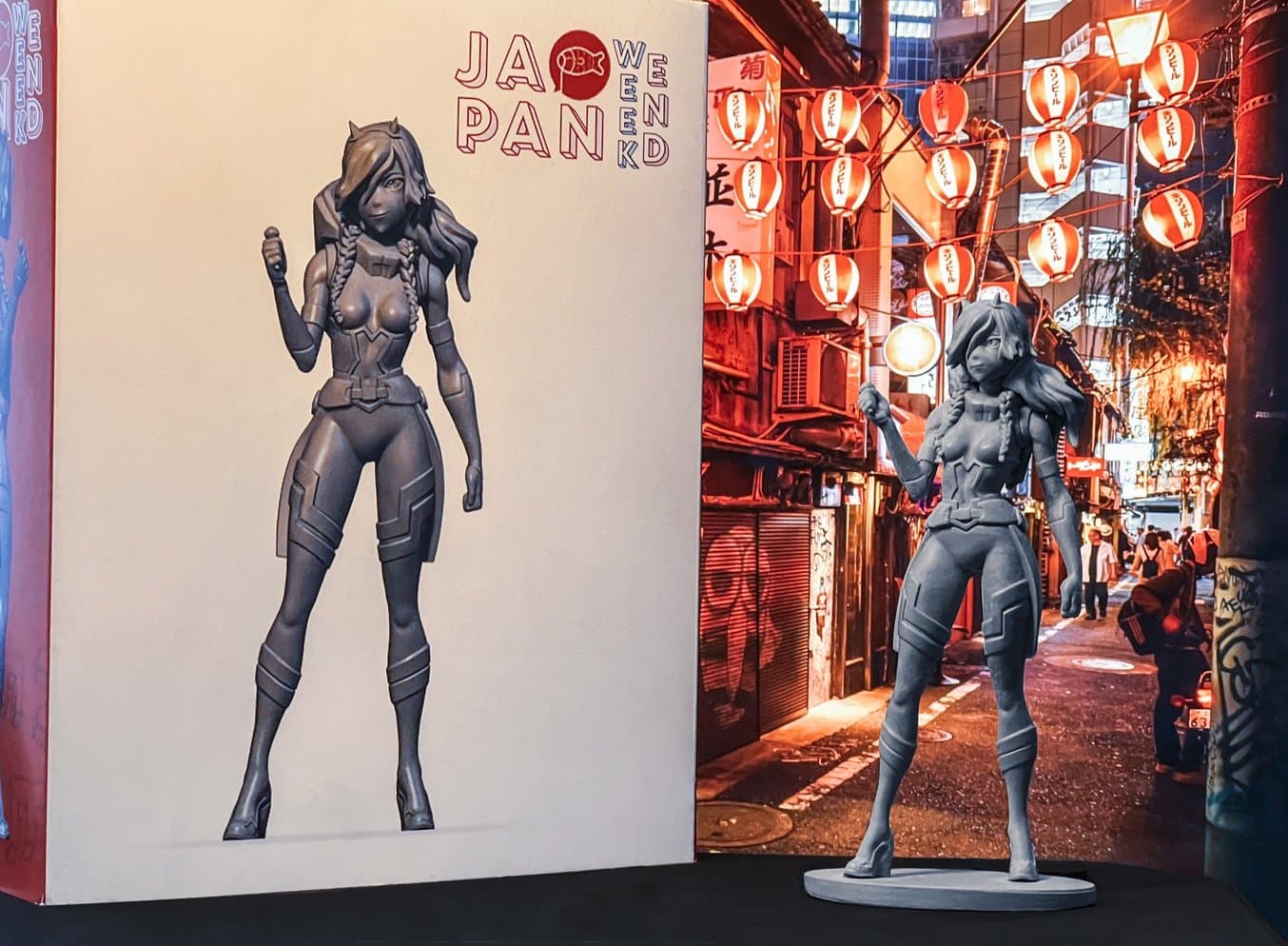

SiOCAST’s system reception in the miniature market has been great but also in the Anime and Manga industry.
Japan Weekend’s miniature made with SiOCAST.

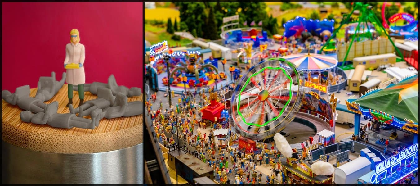

The company is also expanding into the model landscape market and has already worked with some of the main manufacturers of landscape modeling.
Model landscape from Miniatur Wunderland.

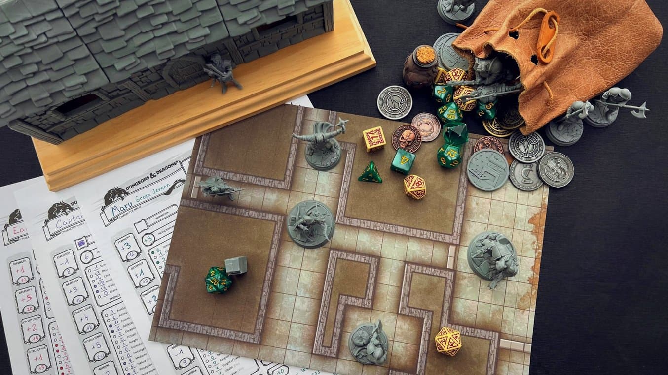

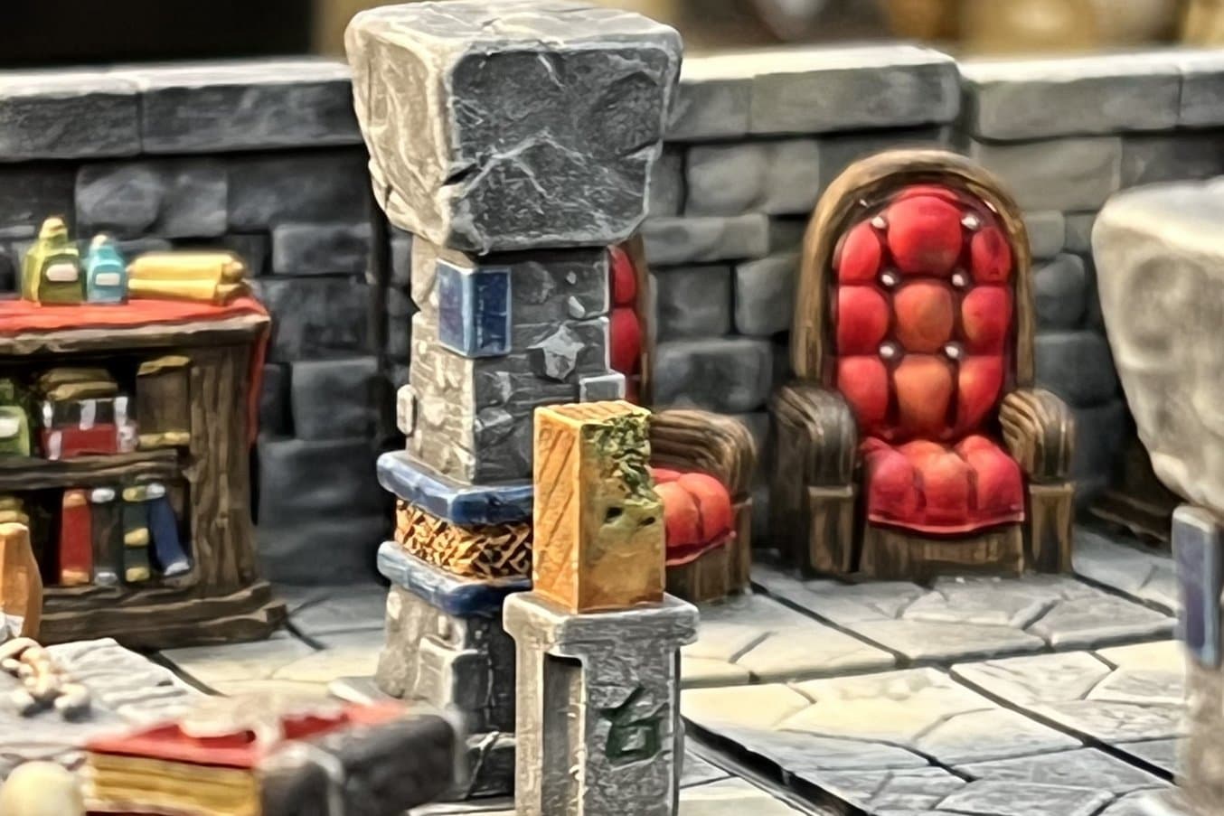

Some manufacturers of role-playing games, like Galladoria Games, expand the benefits of the SiOCAST system to the terrain and scenography market. The examples of companies that are moving to the SiOCAST system from out of the miniature market are growing every day.
Galladoria’s D&D terrain.
Dungeons & Dragons parts made with SiOCAST.

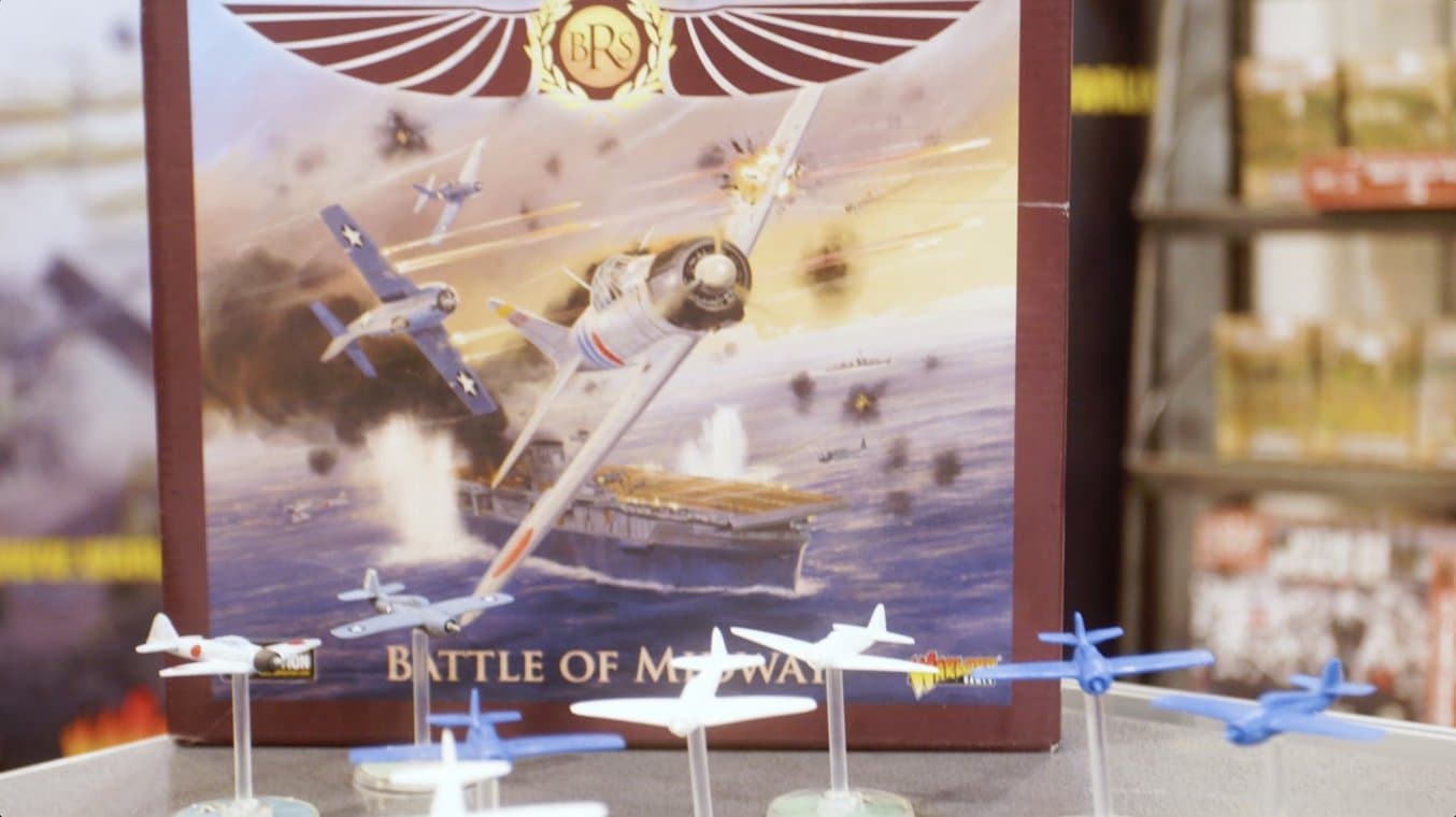

Another successful case is Warlord Games, in which they were able to produce over 400,000 units of the plane for Blood Red Skies, using SiOCAST’s process in 4 different colors. Traditionally, this type of big batch production would only be feasible with injection molding, and the level of detail wouldn’t be the same.
Over 400,000 units of the Red Blood Skies plane were produced with SiOCAST.

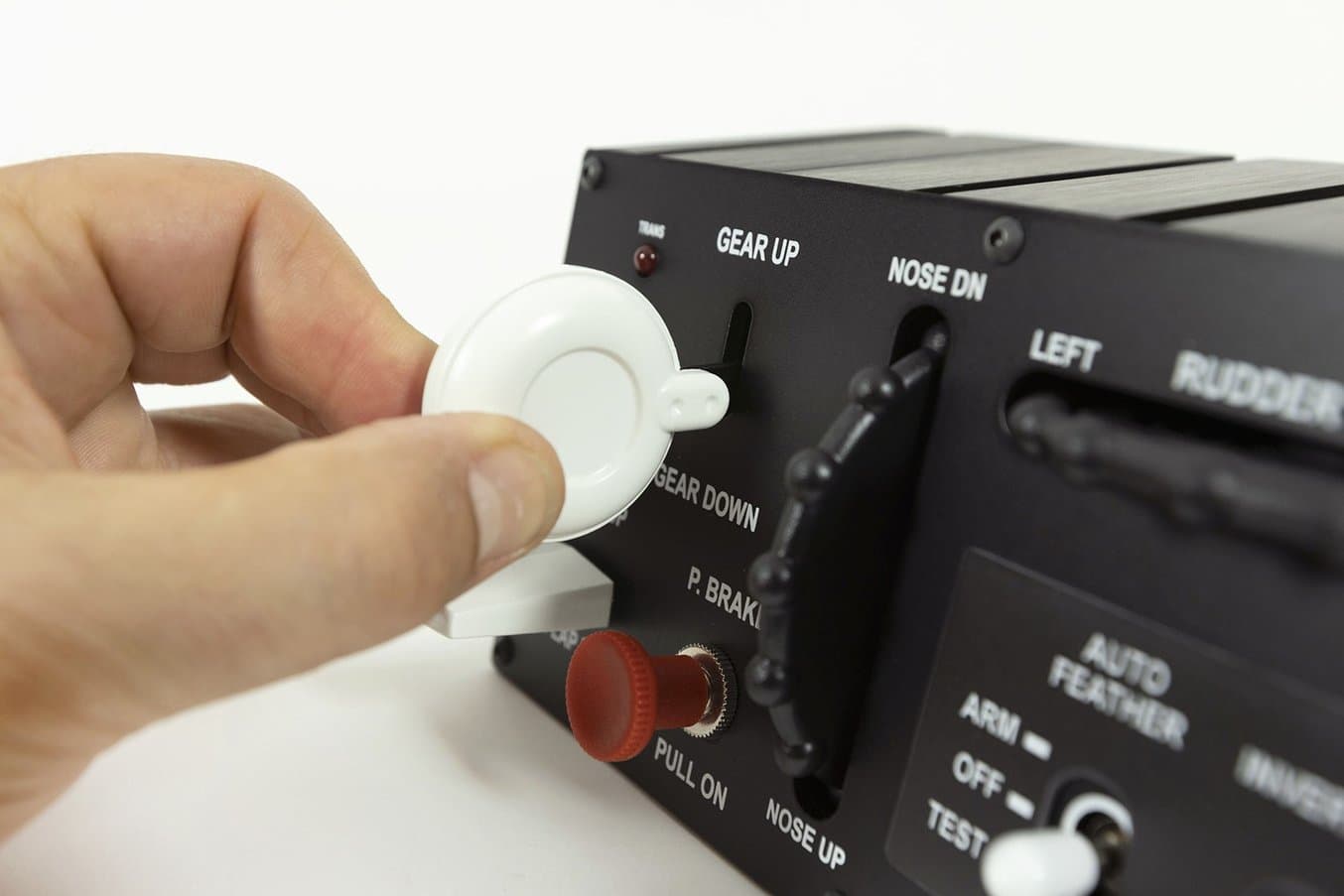

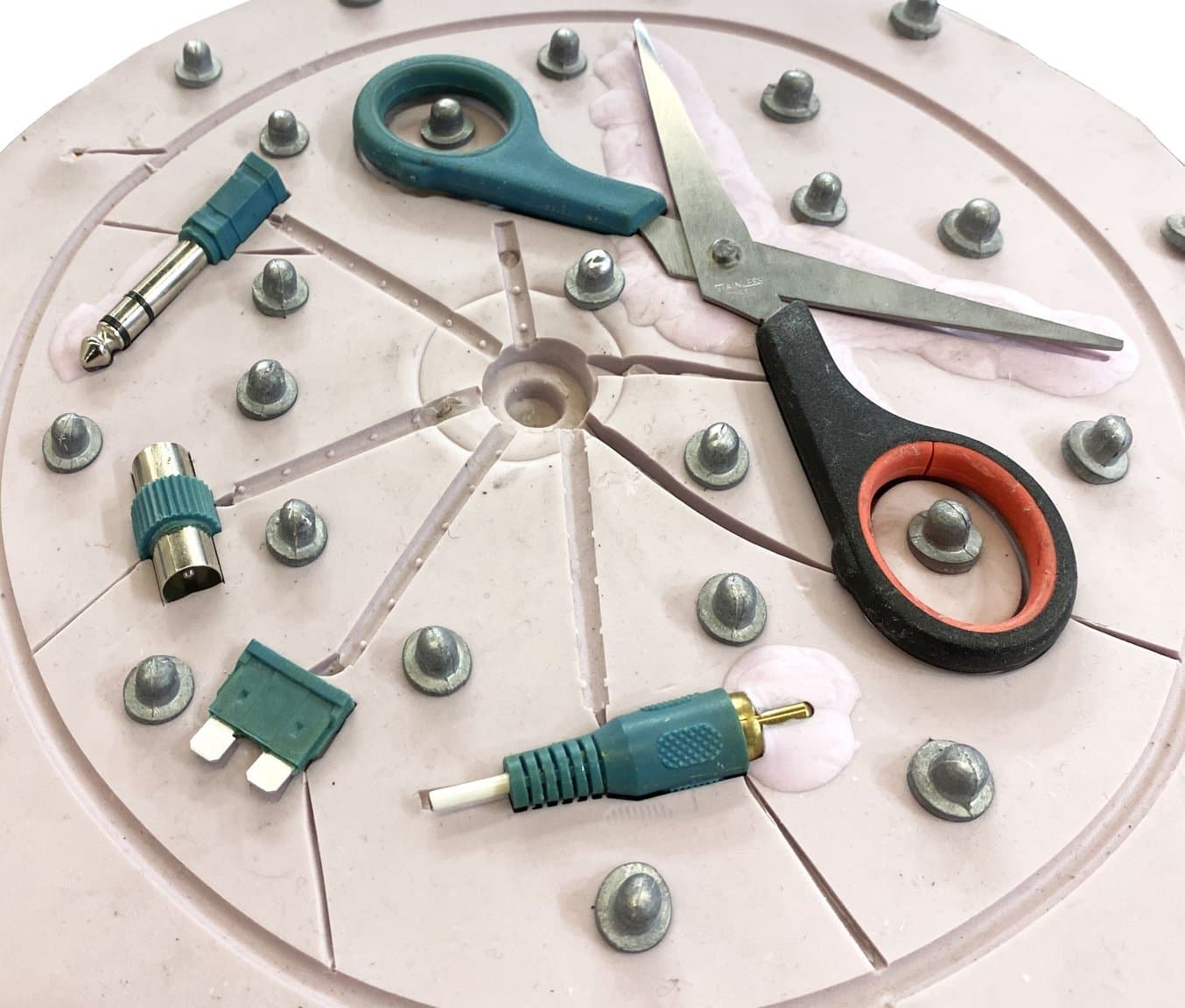

The SiOCAST system was also well received by other industries and applications, such as footwear, keycaps, medical connectors, overmolding components, and different types of soft and durable parts. For example, one of their customers made wheels and switches for a flight simulator, using masters printed on the Fuse 1 and Form 3+. The advantages of SiOCAST for this company allow the production of end parts, with excellent surface quality at low cost in a quick turnaround local manufacturing. No other technology currently meets those requirements.
Aplica Design’s flight simulator part made with SiOCAST.
Overmolding with SiOCAST molds.
“The fact that miniature was our first business sector was because that’s the one we knew already, but there are thousands of applications out there”, says Ferran.
