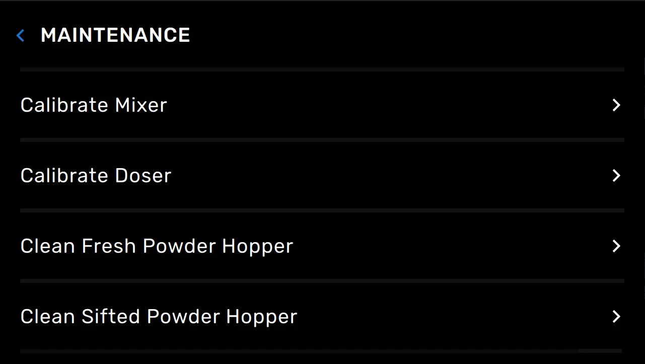

- On the touchscreen, tap Maintenance > Calibrate Mixer.
- Follow the instructions on the UI to complete the calibration procedure.
