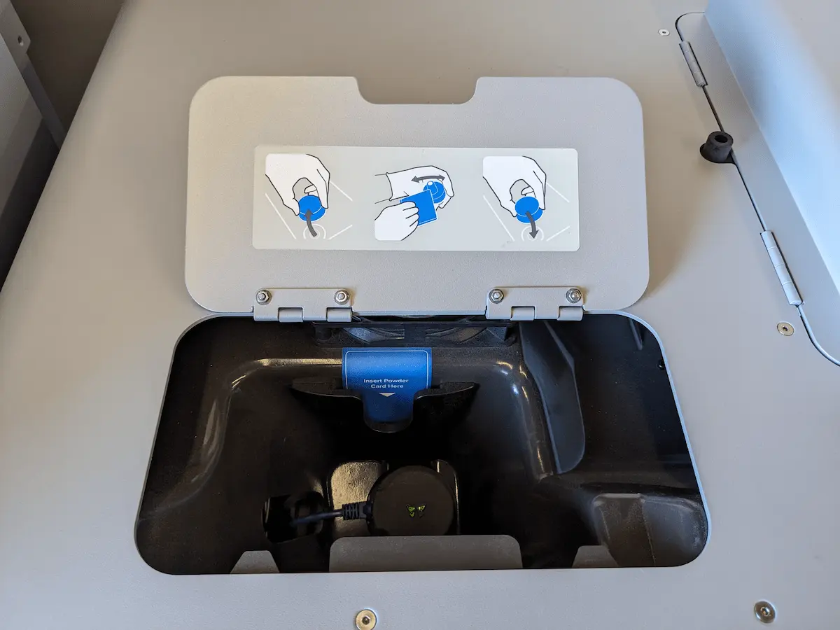

The IR sensor is located in a compartment at the top of the Fuse 1, above the touchscreen and next to the hopper. It may be difficult to reach, so consider keeping a step-stool nearby.

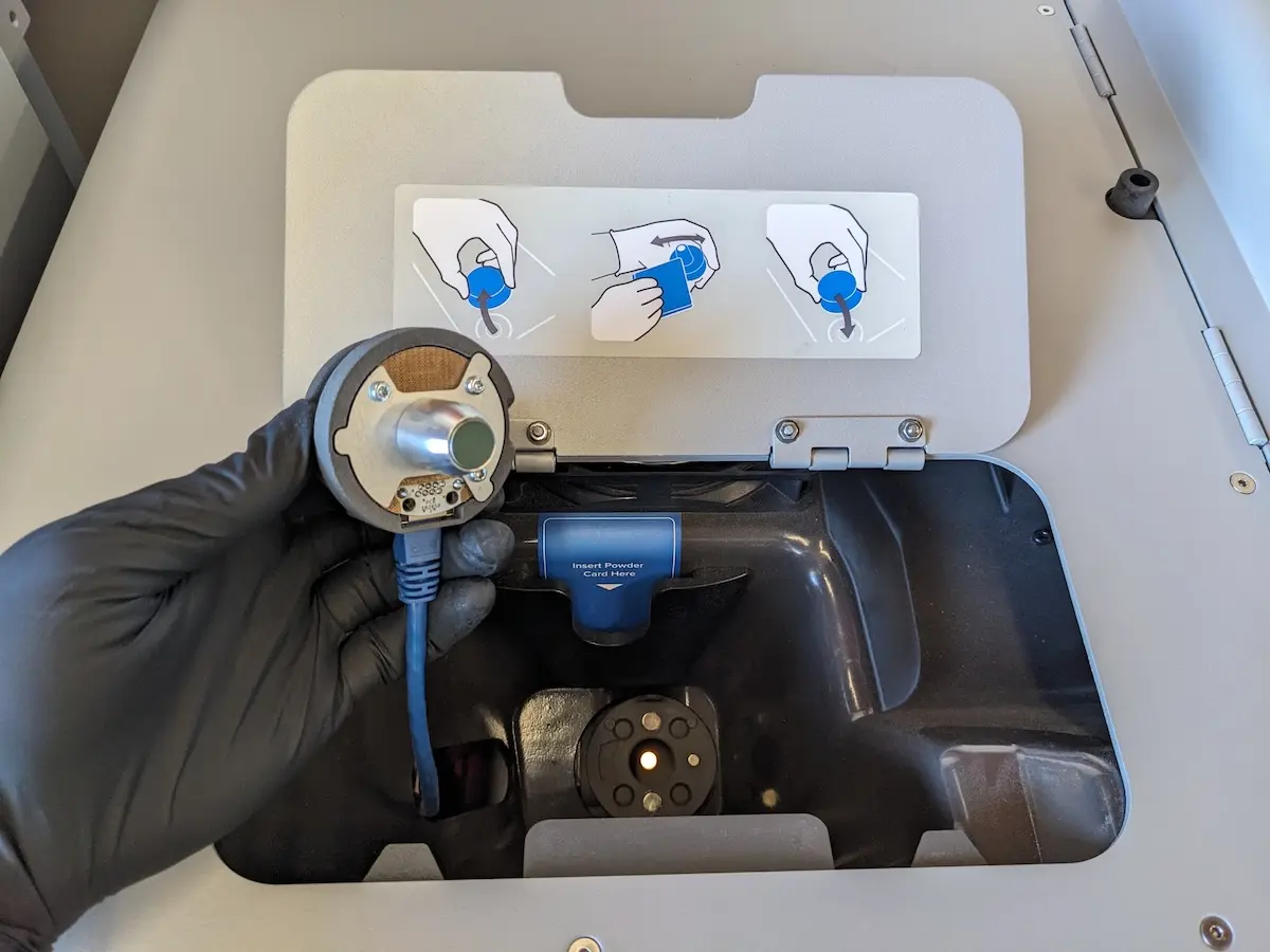

The IR sensor panel door at the top of the Fuse 1 printer is open to display the IR sensor.
The IR sensor cabinet is open to reveal the card reader and IR sensor.

  1. Open the IR sensor door in the compartment at the top of the printer.
  2. Grip the IR sensor cap and pull. The IR sensor is held in place with magnets and comes out with little force.

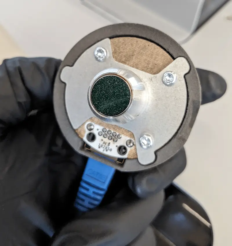

  3. Inspect the lens on the underside of the IR sensor cap:
The IR sensor is held so that the opening and lens are clearly visible.
Debris is located on the lens and must be cleaned with polyester swab wetted with ethanol.

If the IR sensor looks dirty or contaminated during inspection, wet a polyester swab with ethanol and use it to clean the lens.
To clean the IR sensor lens:
  1. Check the IR sensor lens for dust, powder, or other contamination.
  2. Wet the polyester swab with ethanol and wipe the lens.
  3. Check the lens to ensure that there are no streaks and that the contamination has been fully removed.

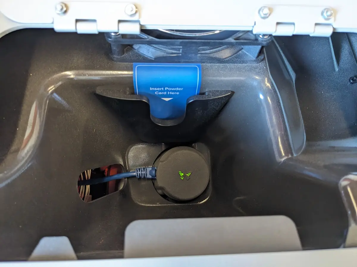

The IR sensor is connected to its mount with magnets. Push in the cap until you feel a click and the LED turns green.
To reinstall the IR sensor:
  1. Push the IR sensor cap into the mount. The LED turns green when it is fully connected.

The LED in the cap of the IR sensor displays green.
The LED in the center of the IR sensor cap turns green when it is properly mounted.
