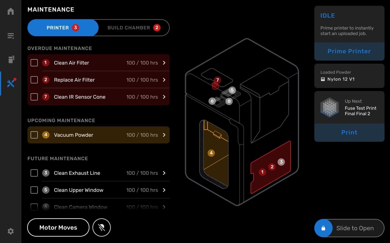

Note:
Filter cleaning frequency and filter lifetimes are tracked and prompted automatically via the touchscreen. Follow the prompts on the touchscreen when cleaning filters in order to properly track frequency and prevent print failures.

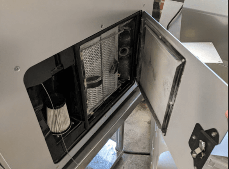

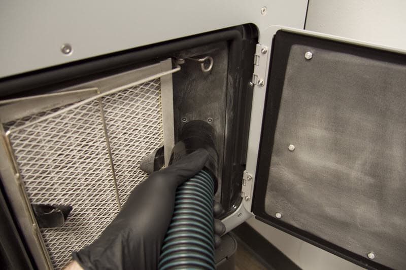

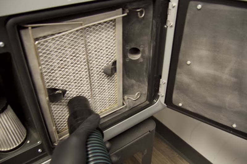

Cleaning the exhaust filter
The exhaust filter is located behind a cabinet door on the right side of the printer. Clean the filter after 30 hours of printing.
To clean the exhaust filter:

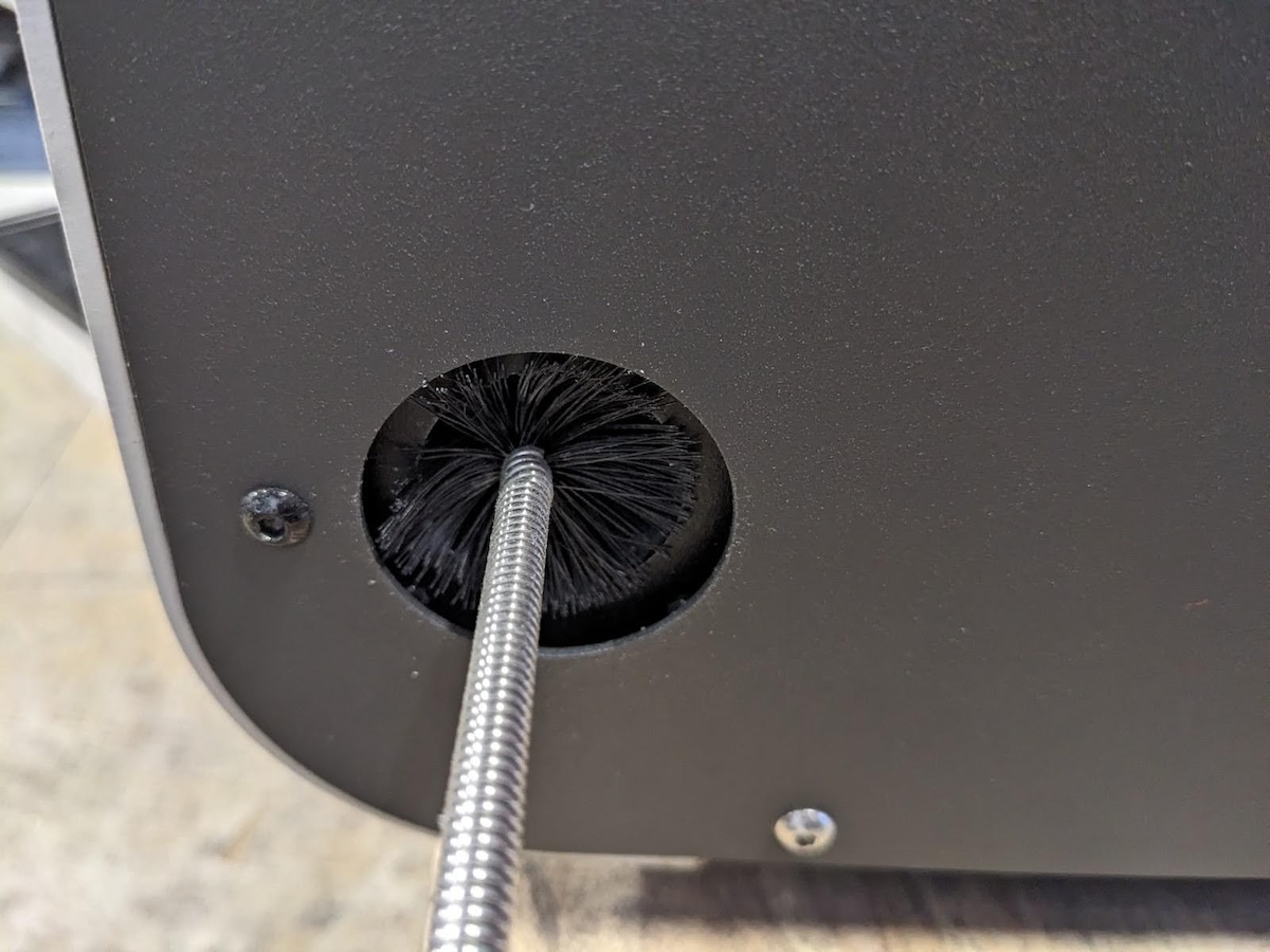

Purging the exhaust line
With typical use, marginal amounts of powder and laurolactam can accumulate in the exhaust line. It is important to periodically purge the exhaust line to maintain airflow out of the print enclosure.
https://www.youtube.com/watch?v=A-JEWVUwwT4
Notice:
To purge the exhaust line:

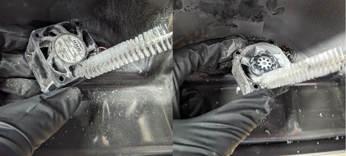

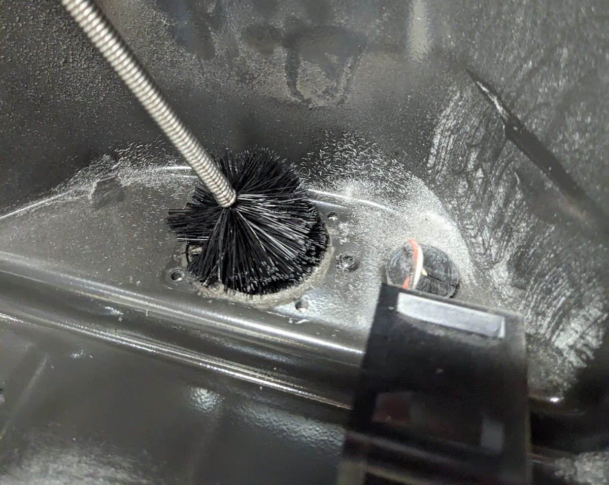

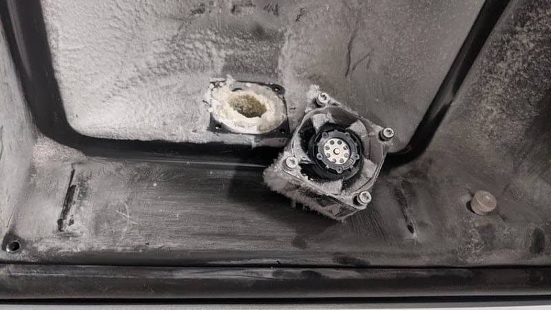

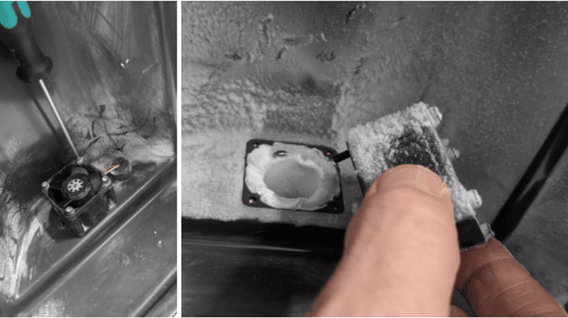

Cleaning the exhaust fan and exhaust tube
Laurolactam buildup on the exhaust fan and the lower exhaust tube (Fuse 1 only) prevents the print enclosure from reaching the correct pressure. If you see a Chamber Pressure Too High error (Fuse 1 only), remove this buildup so the printer can reach a low enough chamber pressure and pass preprint checks. Other issues, such as global melting at the end of a long print, can also be connected to a dirty exhaust fan, line, or filter.
To clean the exhaust fan:
| Fuse 1 only: Clean the exhaust tube | Fuse 1+ 30W only: Clean under the exhaust fan |

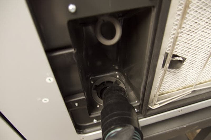

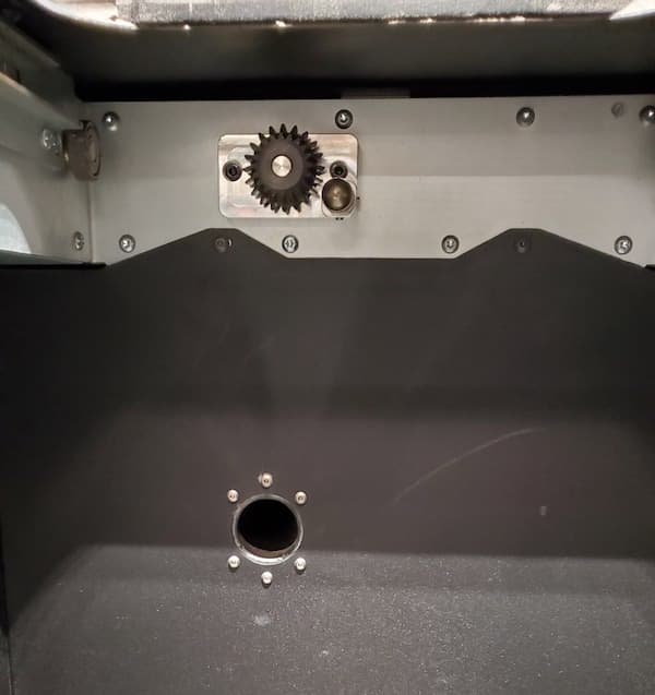

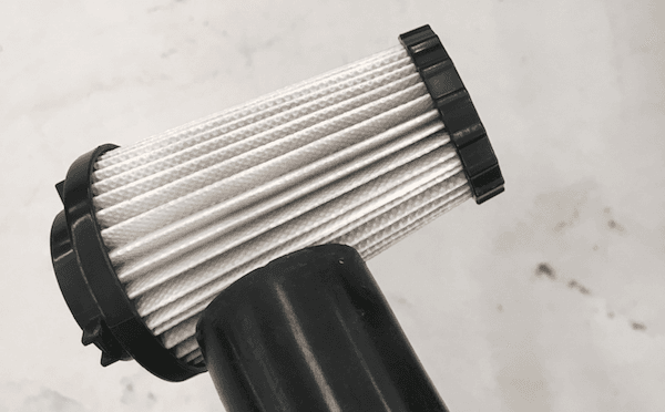

Cleaning the intake filter
The intake filter is located behind a cabinet door on the right side of the printer. Vacuum the filter if the printer is showing low pressure warnings.
To clean the intake filter:

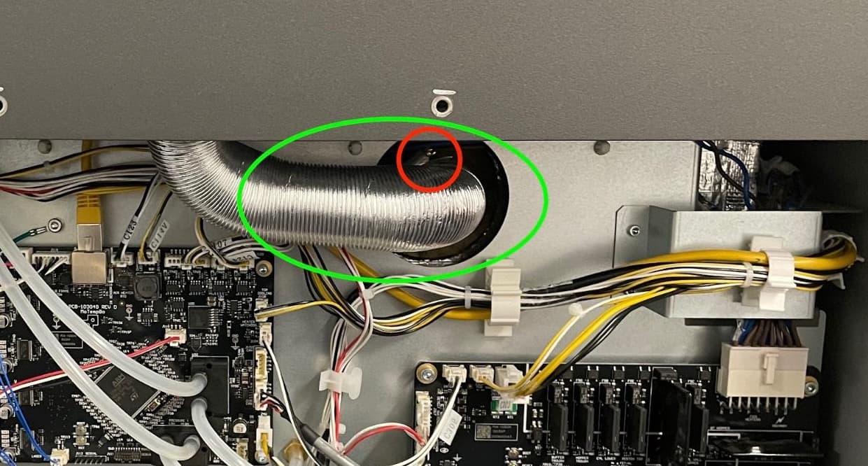

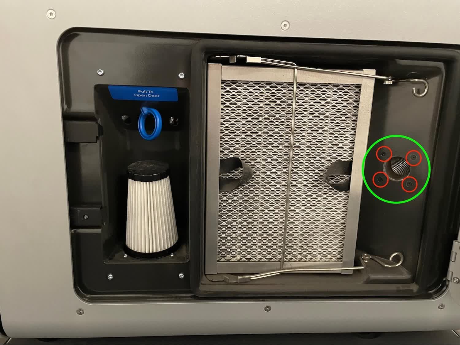

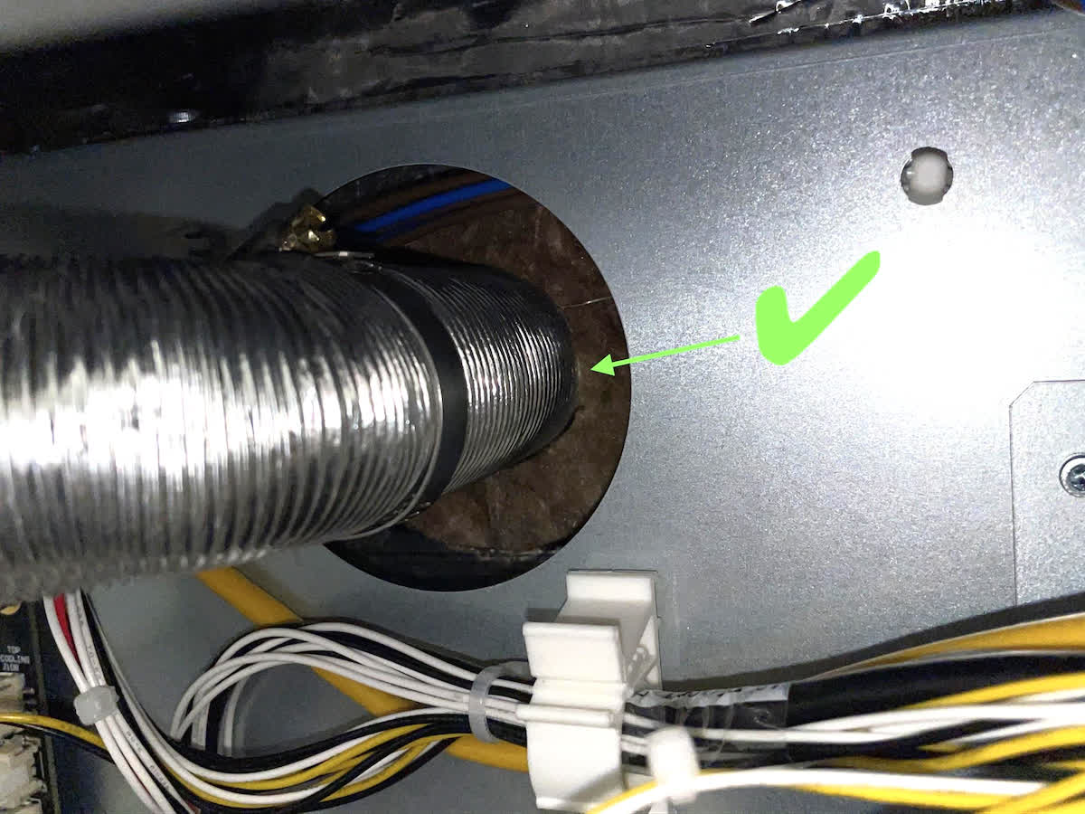

Repairing the exhaust tube
It is possible to tear the exhaust tube during cleaning. You may feel the tube tear or notice pressure-related errors during subsequent prints. To repair a torn exhaust tube:
Notice:

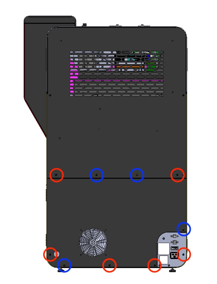

The placement of the chrome screws is critical to the printer's electrical grounding. Refer to the image on the right for the correct locations of the black screws (circled in red) and chrome screws (circled in blue).
Notice:
Check the seal of the exhaust duct by shining a flashlight around the inlet inside the filter cabinet. If light is visible behind the filter cabinet, the duct is not properly sealed.
