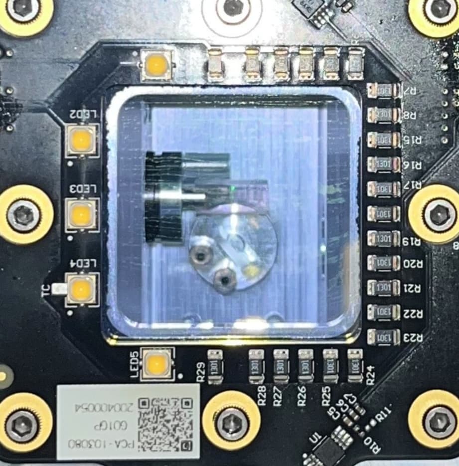

The upper laser window is contaminated and smudged
Using your telescoping mirror, look for a dirty upper laser window like the one pictured above.

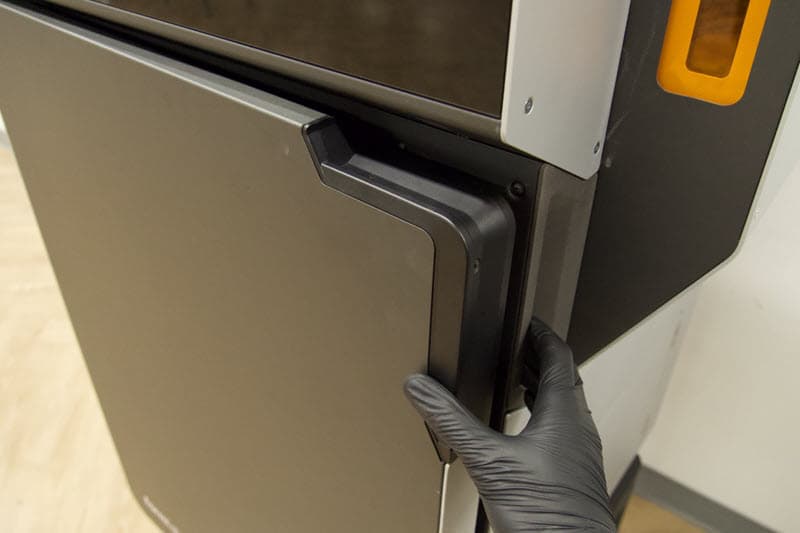

Step 3: Open the print enclosure door
On the touchscreen, drag the Unlock Door slider. The print enclosure door unlocks. Open the print enclosure door.
Someone is reaching out to grip and open the print enclosure door

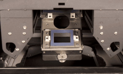

Step 4: Open the cassette tray
On the ceiling of the print enclosure, loosen the thumb screw in the front-center of the printer cavity. The cassette tray swings down.
The thumb screw at the top of the print enclosure is circled in red
The cassette tray is open to reveal the optical cassette inside

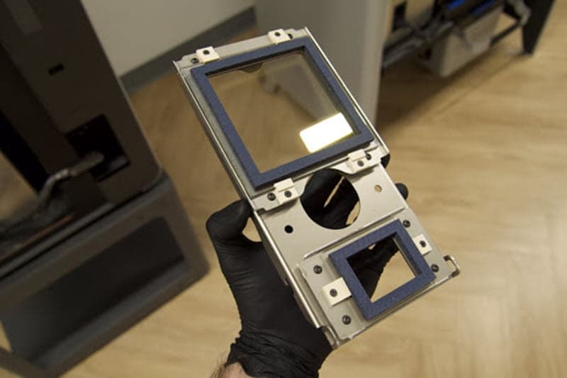

Step 5: Remove the optical cassette
Slide the optical cassette out of the cassette tray.
Someone is holding an optical cassette up to the light

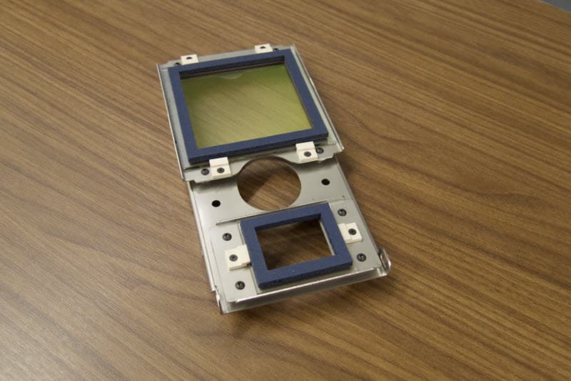

Step 6: Set optical cassette aside
Set the optical cassette aside on a clean, flat surface with the gasket facing upward. Ensure that nothing is directly touching either glass window of the optical cassette.
An optical cassette is resting on a clean wood surface

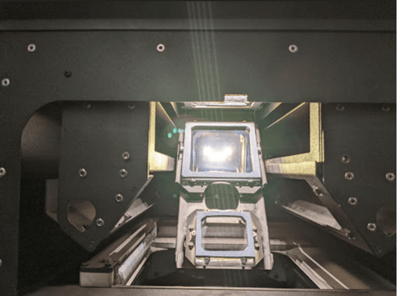

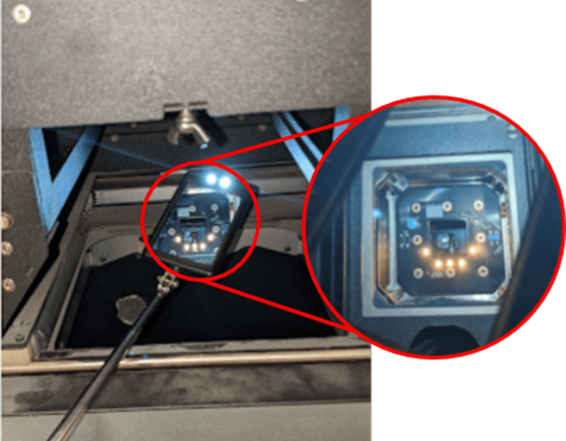

After the optical cassette is removed, wet a polyester cloth swab with ethanol and use the telescoping mirror to guide your cleaning of the upper laser window.
Step 1: Locate the upper laser window
Using the provided telescoping mirror, visually locate the upper laser window. The upper laser window is located in the enclosure ceiling and corresponds to the larger window in the optical cassette.
Tip:
Remember the position of the upper laser window for later in the procedure.
The mirror wand is inserted into the print enclosure and an annotation zooms in on the reflected image of the upper laser window

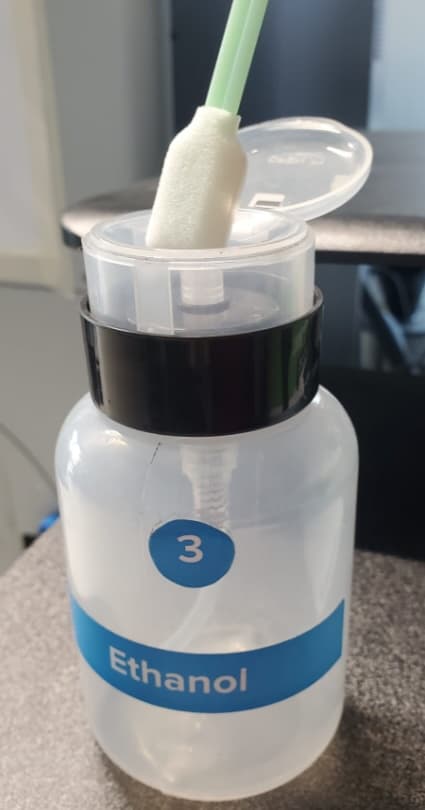

Step 2: Wet a swab with ethanol
Wet a polyester cloth swab with a small amount of ethanol.
A swab is being pressed against the top of an ethanol dispenser.
Step 3: Place the swab against the upper laser window
Using the telescoping mirror to guide your hand, place the tip of the wet swab against the upper laser window.
A mirror wand is inserted into the print enclosure as someone brings a swab to the upper laser window

Step 1: Open the cassette tray
Once confirming that the upper laser window is clean, loosen the thumb screw on the ceiling of the printer cavity. The cassette tray swings down.
Step 2: Reinstall the optical cassette
Place a clean optical cassette into the cassette tray.
An optical cassette rests in an open cassette tray
Step 3: Close the cassette tray
Return the cassette tray to its closed position and tighten the thumb screw.
A close-up view of the thumb screw on the cassette tray
Step 4: Close the print enclosure door
Close the print enclosure door. Press firmly to ensure that the door is fully latched. If necessary, squeeze the front of the door using the cutout on the right side of the printer for leverage.
