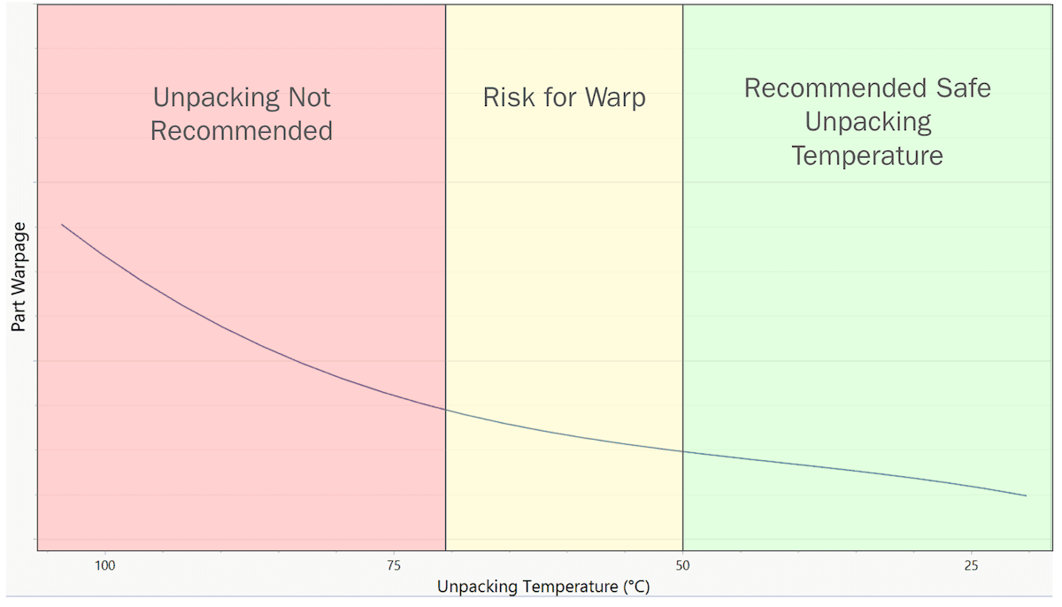

Impact of varying cooldown times on warpage
Relationship between unpacking temperature and part warpage on a build chamber cooled outside the printer
The Formlabs team tested the impact of cooldown time and unpacking temperature on part warpage using Nylon 12 Powder on a Fuse 1+ 30W printer. The build chamber was filled with a variety of different parts at a packing density of 15%. Parts from all corners of the build chamber were tested. Multiple identical builds were printed, and build chambers were removed from the printers at varying temperatures, ranging from 100 °C to 25 °C. The parts were measured for warpage, and the variance from their intended shape was plotted against the temperature at which their build had been unpacked.
  • Parts unpacked at temperatures higher than 70 °C showed consistent warping.
  • The most consistently dimensionally-accurate parts were those unpacked at room temperature.
  • Parts unpacked when the build chamber reached 50 °C were not significantly more warped than those unpacked at room temperature.
  • Certain types of parts, such as vertically-oriented long and thin parts and on parts placed near the outer corners of the build chamber, typically require longer cooldown times. Builds with these parts typically need to remain in the printer until they are 50 °C to prevent warping. Your results may vary based on pack density, material, part geometry, and your own part acceptance criteria.
Creating a production schedule that allows for a complete cooldown to 50 °C, or at least between 50 °C and 70 °C, will improve your chances of producing quality, consistently accurate parts. The Fuse Sift shows the current temperature of an inserted build chamber to help in your testing and decisionmaking.

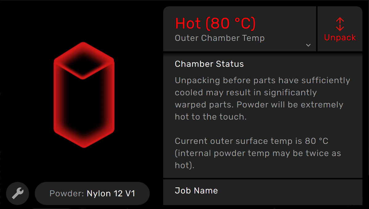

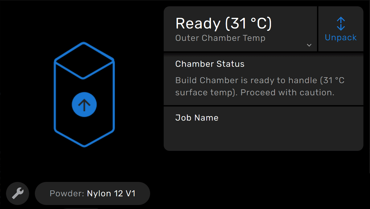

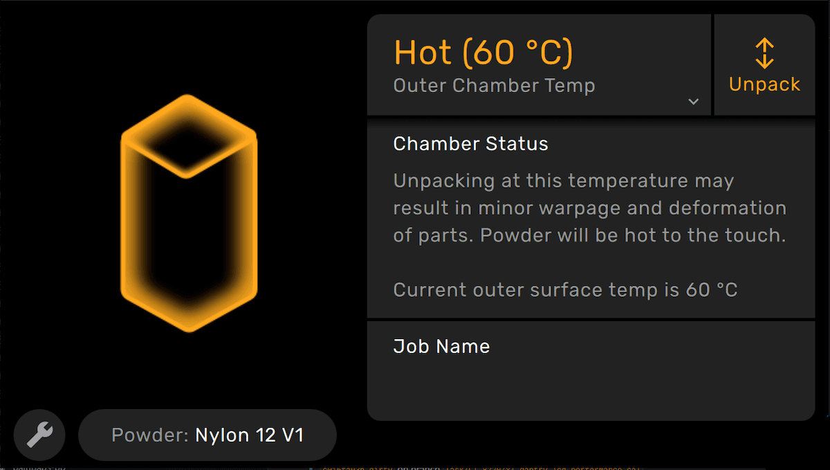

To cool a build chamber in the Fuse Sift, check the status of the build chamber on the Fuse Sift’s touchscreen.
  • If the build chamber graphic and icon are highlighted red and the Fuse Sift’s touchscreen displays the status Hot, the powder cake is still above 70 °C. Allow the build chamber to continue cooling before ejecting the cake.
  • If the build chamber graphic and icon are highlighted yellow and the Fuse Sift’s touchscreen displays the status Hot, the powder cake is between 50 °C and 70 °C. Your parts can be unpacked but are at an increased risk for warping.
  • When the Fuse Sift’s touchscreen displays the status Ready, the powder cake is below 50 °C. It is safe to recover and process your printed parts. Further cooling is unlikely to impact warping.
A Fuse Sift showing the inserted build chamber is too hot to unpack
A Fuse Sift showing the inserted build chamber is too hot to unpack without risk of part warpage
A Fuse Sift showing the inserted build chamber is ready to unpack
