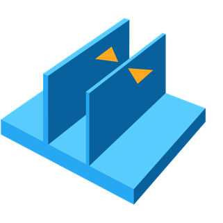

Minimum supported wall thickness
Recommended: 0.2 mm/200 microns
A supported wall is one that is connected to other walls on two or more sides. A supported wall with a thickness of 0.2 mm or less may warp due to the peel forces exerted on the part during the peel process.

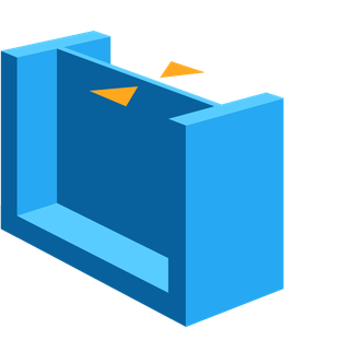

Maximum horizontal support span length
Recommended: 29 mm/29,000 microns
(5 mm width × 3 mm thick)
Span is the distance between two supports. Printing horizontal spans is discouraged, but certain geometries may print successfully. For a 5 mm wide and 3 mm thick beam, spans longer than 29 mm are more likely to fail. Wider beams must be kept shorter to avoid print failures.

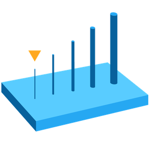

Minimum vertical-wire diameter
Recommended for a 7 mm-tall wire: 0.2 mm/200 micron diameter
Recommended for a 30 mm-tall wire: 1.5 mm/1500 micron diameter
A wire is a feature whose length is at least two times greater than its width. A wire with a 0.2 mm width can be up to 7 mm tall before it begins to deform. Similarly, a wire with a 1.5 mm width can be up to 30 mm tall before it begins to deform.
