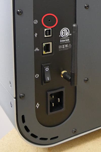

Factory reset instructions
A factory reset may correct unusual Form Cure L behavior. Unusual behavior may include unknown error messages, incomplete firmware updates, or an unresponsive touchscreen. A factory reset erases all custom settings and network connections.
Notice:
A factory reset erases all custom settings and diagnostic logs. Upload diagnostic logs before performing a factory reset.
To manually perform a factory reset:
  1. Unplug the Form Cure L.
  2. Reconnect the machine’s power cable.
  3. When the Formlabs logo appears, push and hold the reset button located above the USB and Ethernet ports in the rear of the Cure L until Resetting to factory defaults appears on the touchscreen. You may need to use a paperclip or other small tool to push the reset button.
  4. Release the button.
  5. The touchscreen displays Factory reset complete before initializing the machine.
Close up of the rear of the Form Cure L; red circle highlighting Factory Reset button.
If the reset does not resolve the behavior, contact Formlabs Support or your authorized reseller.
