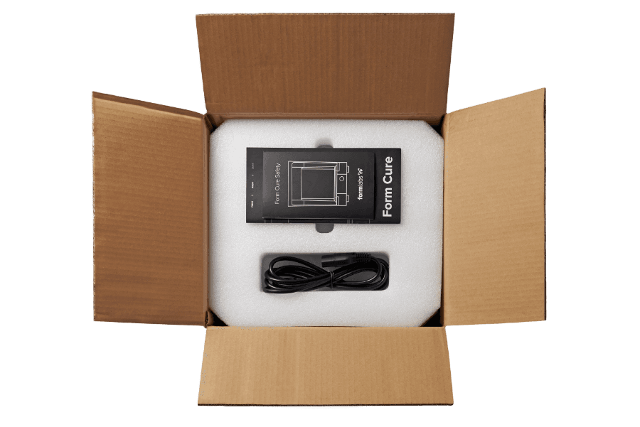

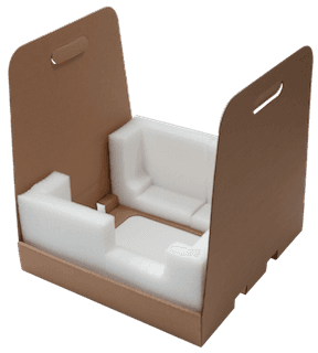

The Form Cure ships in a cardboard carton protected by foam inserts above and below the unit.
The upper foam insert contains the power supply and the Form Cure Safety Booklet (English only).
During unboxing, inspect the Form Cure for any damage or missing items. In the case of damage or missing items, contact Formlabs Support or your authorized reseller.

The machine’s power cord is included on top of the foam inside the box. If you cannot locate the power cable, be sure to check all boxes in your shipment, as it may have been packed separately.
Notice:

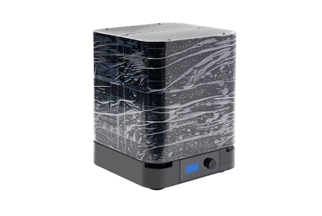

Remove all packaging material before connecting power. Retain all packaging and inserts for warranty service. Refer to the manual for the repackaging instructions.

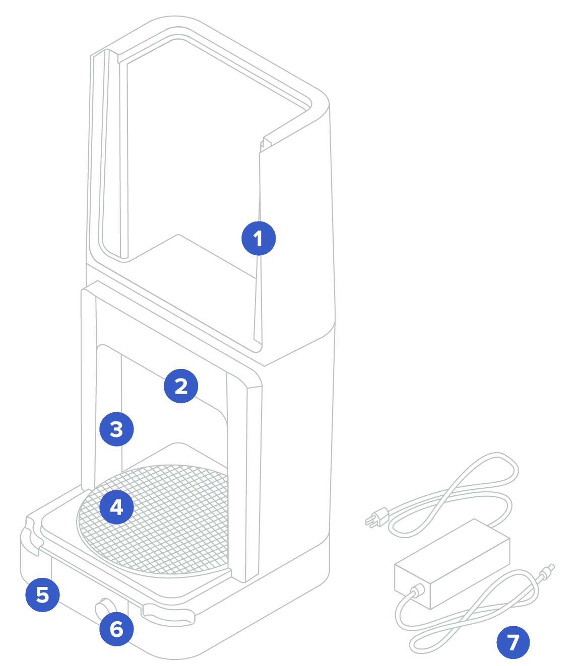

Form Cure components

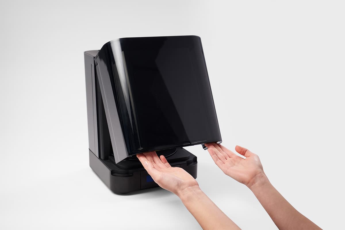

Step 1: Install the turntable
Lift the cover and place the turntable on the circular wheel mount at the base of the cure chamber.

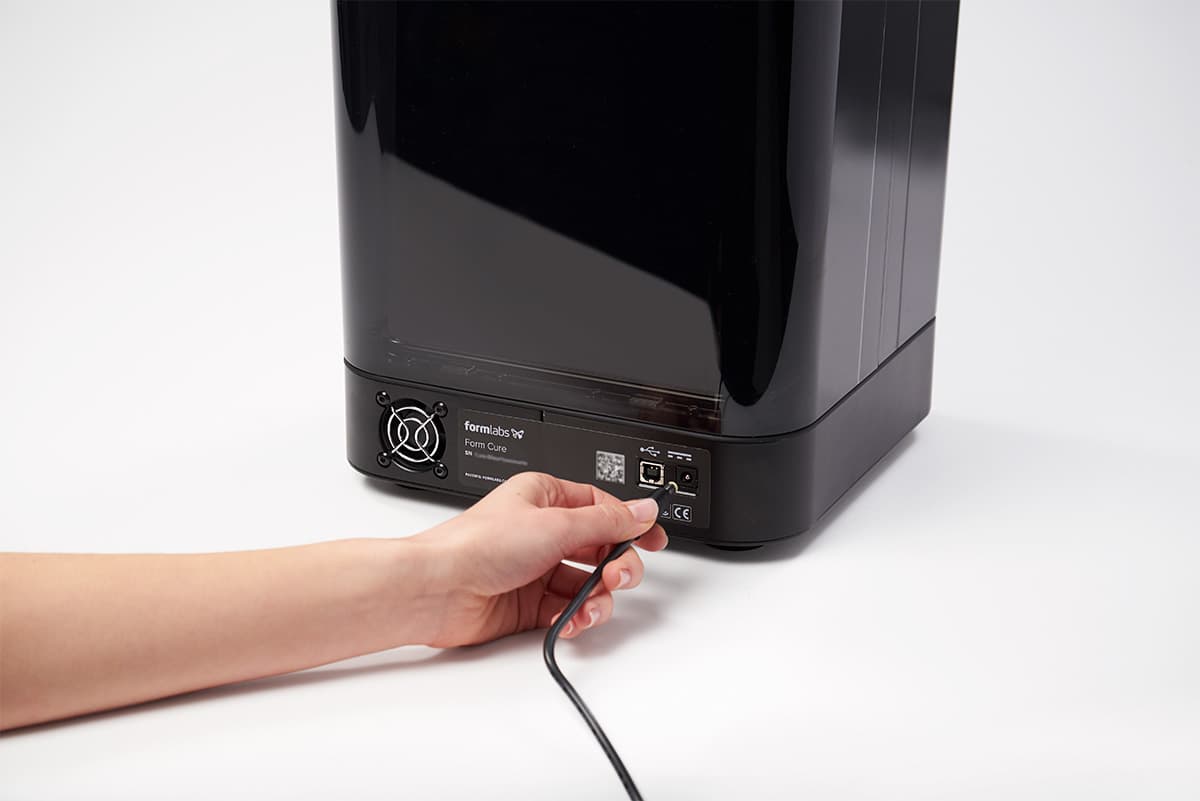

Step 2: Connect the power supply
Connect the power cable and external supply to the Form Cure and a power source. The Form Cure includes a USB port to facilitate firmware updates.
